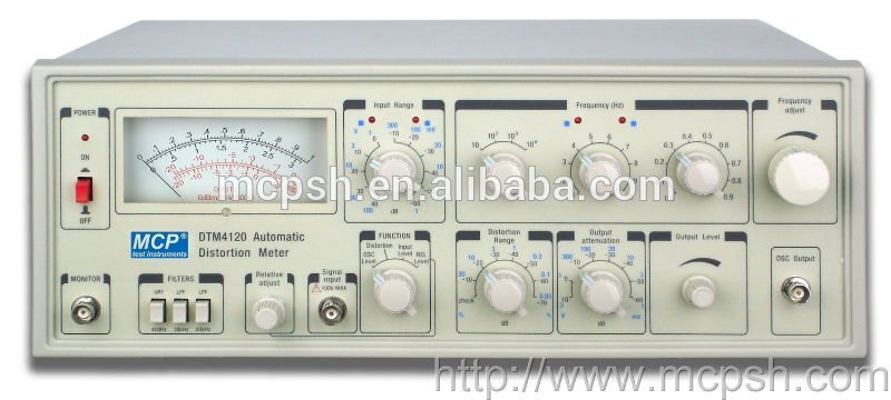

New price quote = $560 USD
There is an Asian made clone of the HP-339A now. It does not look exactly like the 339A but similar and has all the same features and controls.
MCP DTM4120 - distortion meter, View distortion meter, MCP Product Details from Shanghai MCP Corp. on Alibaba.com
I have inquiry in to mfr as to their selling cost.

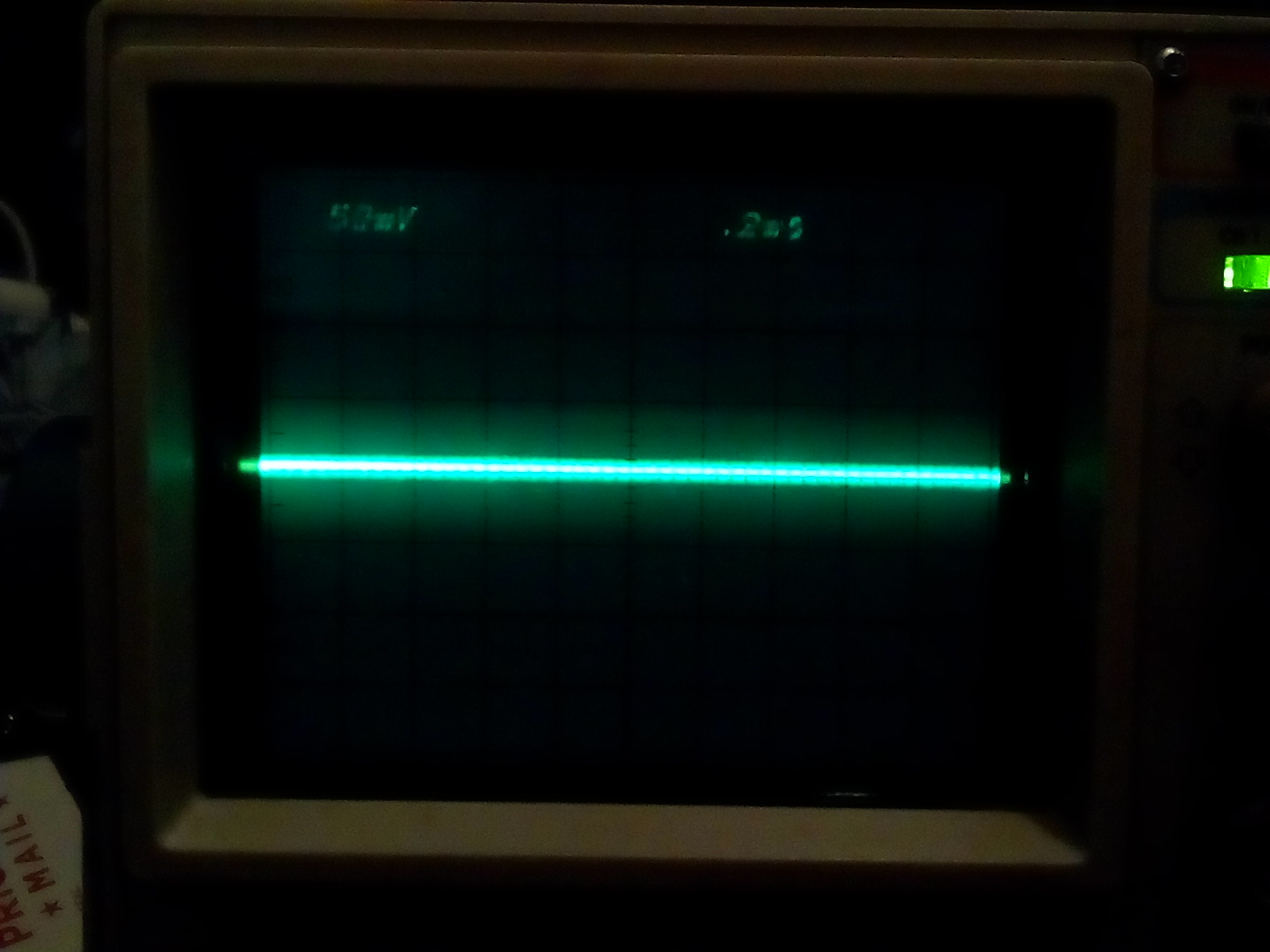

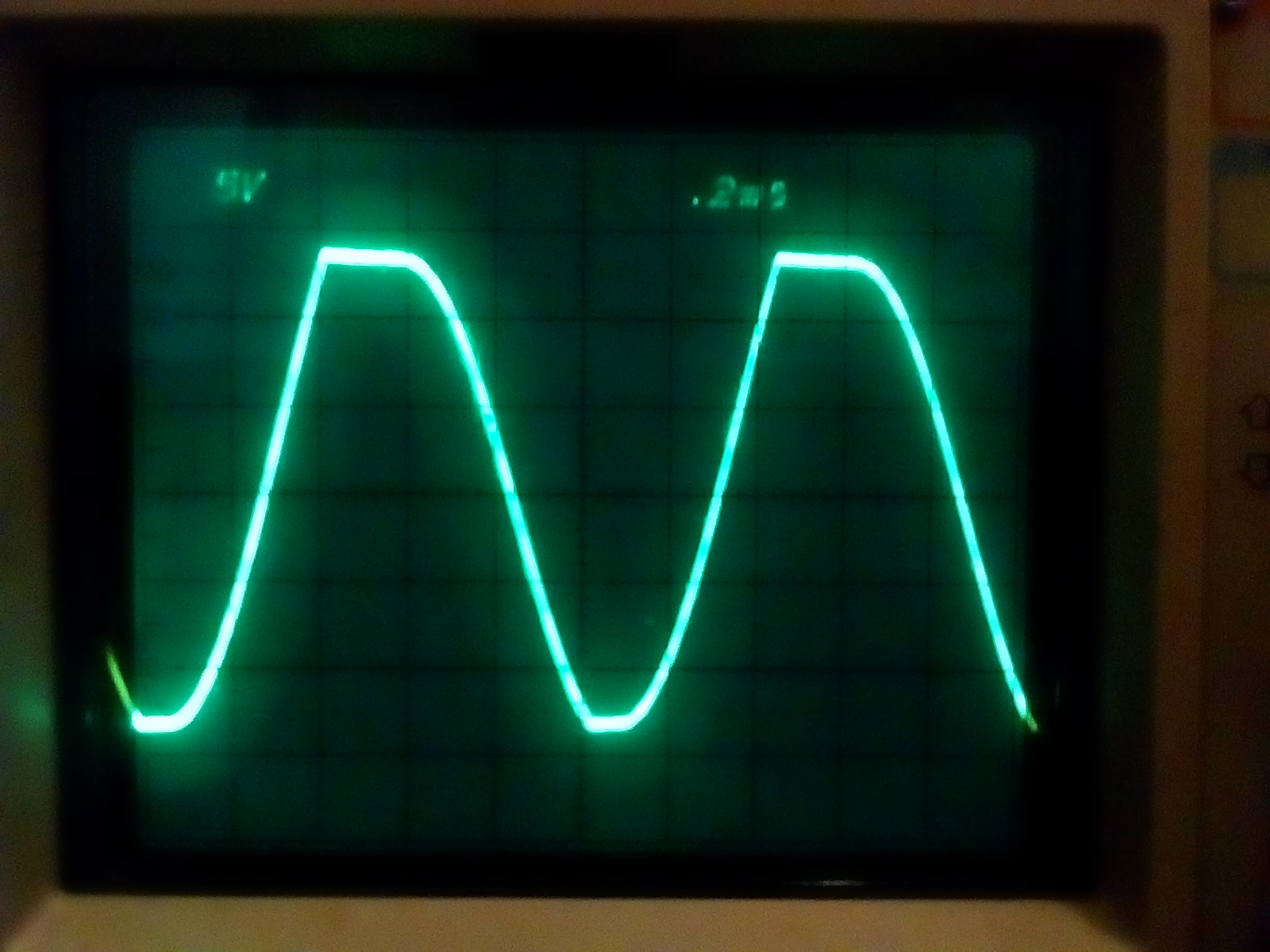

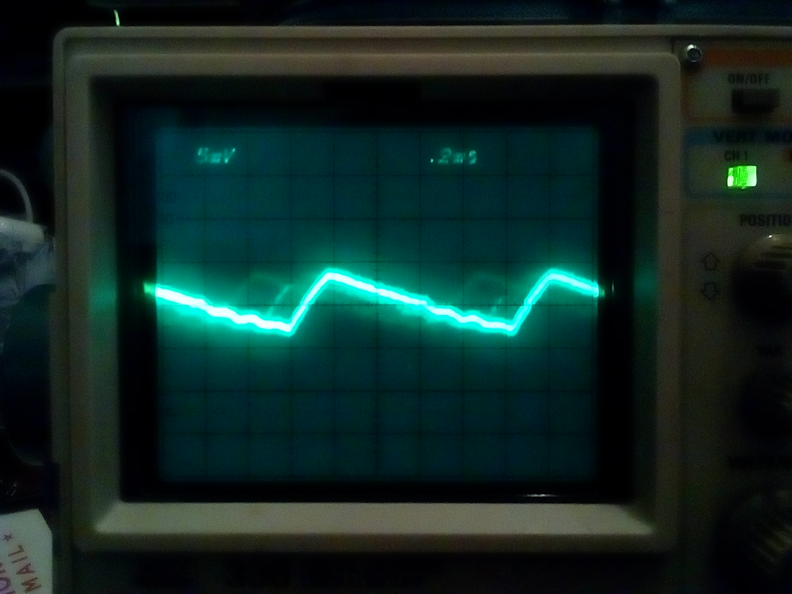

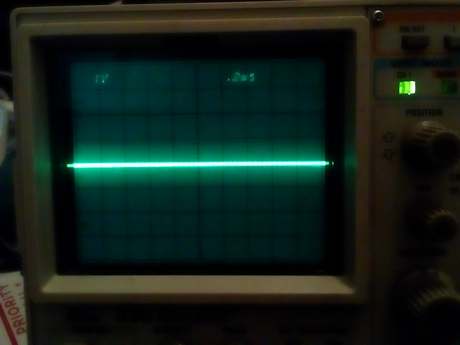

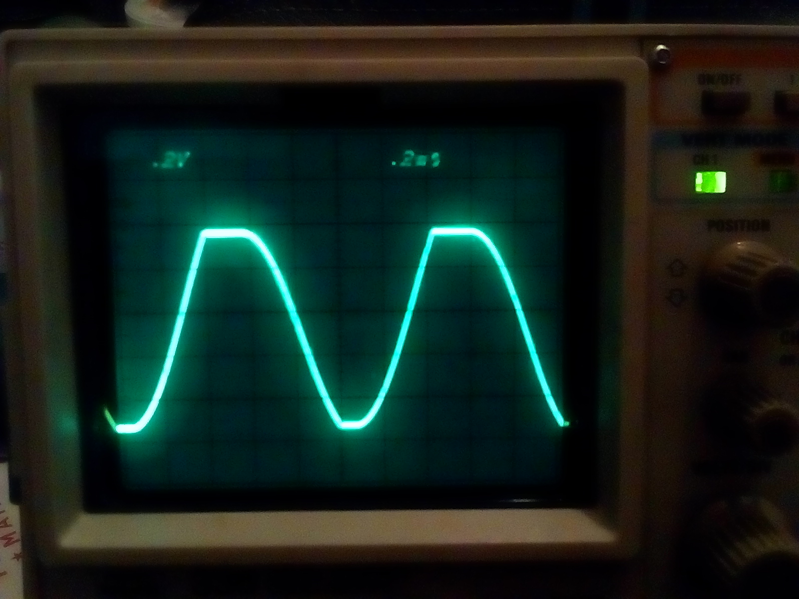

A few days later, distorted HP 339a
Hi BSST

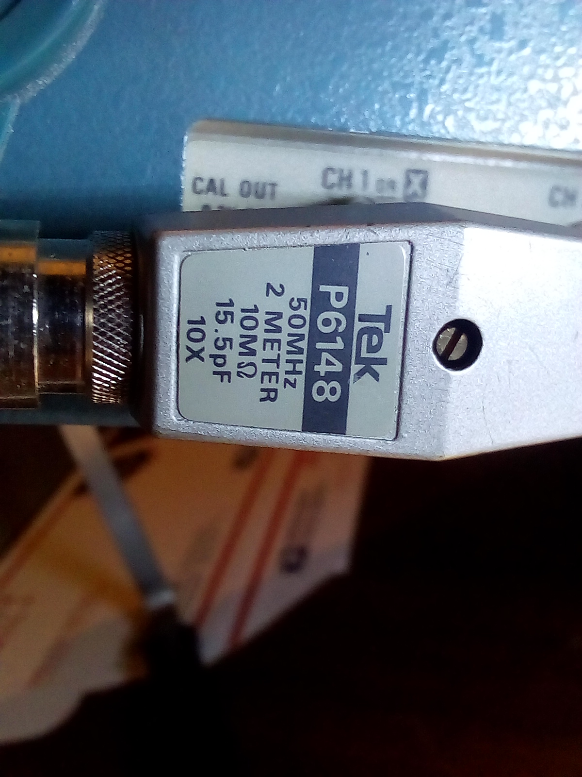

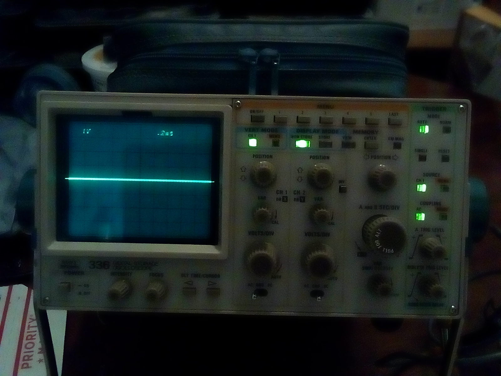

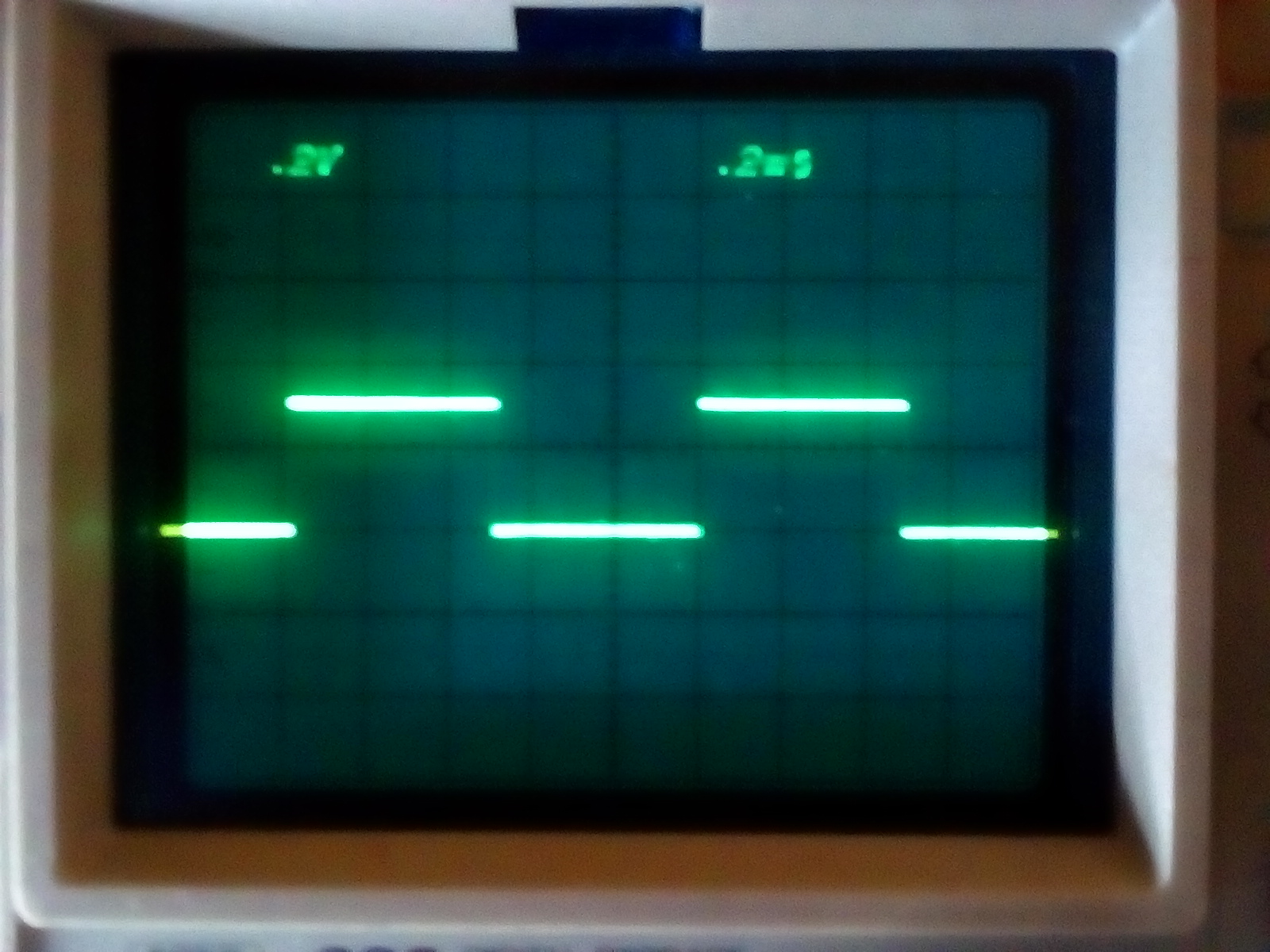

OK, I have the set and a Sony 336 scope setup and I am using the 50 MHz. 10x scope probe within the A1 osc area.
Probe is currently calibrated and the Sony AC coupled.
Going to show waveforms on the testpoints. The photos in order are:
Front of Sony 336 scope
Body of Tek P6148 probe
Cal signal optimized on probe
TP1
TP4
TP5
TP6
TP8
(Somehow I lost TP3 when uploading them, hmmm.) Is it needed?

The oscillator is not stabilizing for some reason. Check the TP for Jfet gate, what dc voltage do you have there?
It would be more telling to use dc coupling for now.

Hi Steven,
David is right. DC voltages will be more telling at this point. Even voltmeter readings may suffice.
TP8 DC volts will tell us a lot. A wild guess is that TP8 will be a large negative voltage.
If so, a couple simple experiments:
If you use a grounded meter probe (or similar technique) to short the junction of R52 and C30, the oscillator should stop. (I've seen lots of warnings to not short Q2 case, so exercise caution.)
Similarly, if you ground TP8, the oscillator should also stop, as that will put Q2 into a low resistance state. If these tests behave as they should, then Q2 is probably OK. Would then measure U2C voltages at pins 12, 13, 14?
Hi Steven,
I’m having erratic internet access at home and am uncertain I’ll be able to get onto the forum this evening. So I’m going to outline some thoughts and offer a few tips.
Based upon the TP8 scope waveform in your post, my best guess is that Q2 is biased into the off state, hence the guess that TP8 will have a large negative voltage near the -15V rail. The “short-to-ground” tests I suggested earlier are intended to test health of Q2, assuming TP8 is in fact a large negative volts as imagined. If TP8 is large and positive, Q2 is likely open, but I doubt this failure mode because of the TP8 waveform.
If Q2 is confirmed operable, the most likely culprit is U2 and the hope is to catch it “misbehaving” in-circuit. To this end, I suggest re-measuring the test points with DC coupling on the scope. Given that the oscillator is in clipping/overload, the anticipated waveform at TP4 is a replica of the TP3 ripple but larger in amplitude (x 2.47) and riding on a DC voltage of several volts. (BTW, once the oscillator is working properly, the saw tooth ripple will remain but average voltage at TP8 will be 0V.) If you don’t see a waveform approximately as described, U2 is highly suspect.
If U2A works correctly, I suggest exercising U2B and U2C using a troubleshooting technique I use frequently:
To test U2B, try to position your scope probe (or voltmeter probe) so that it joins pins U2 pins 6 and 7 simultaneously. This converts the stage into a unity gain opamp. The measured voltage should be a replica of the voltage of the + input--- in the case of the U2B integrator, 0V. Similarly, shorting together pins 13 and 14 should generate a replica of the TP6 waveform.
I hope some of this will point to the problem. Please let me know what you observe/find. Good luck!
