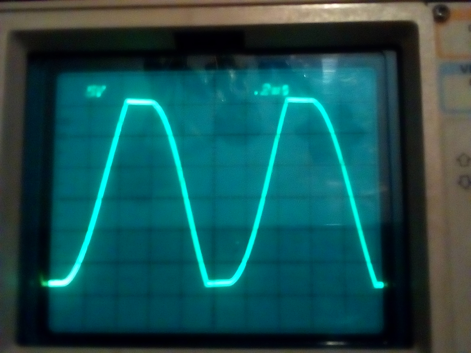

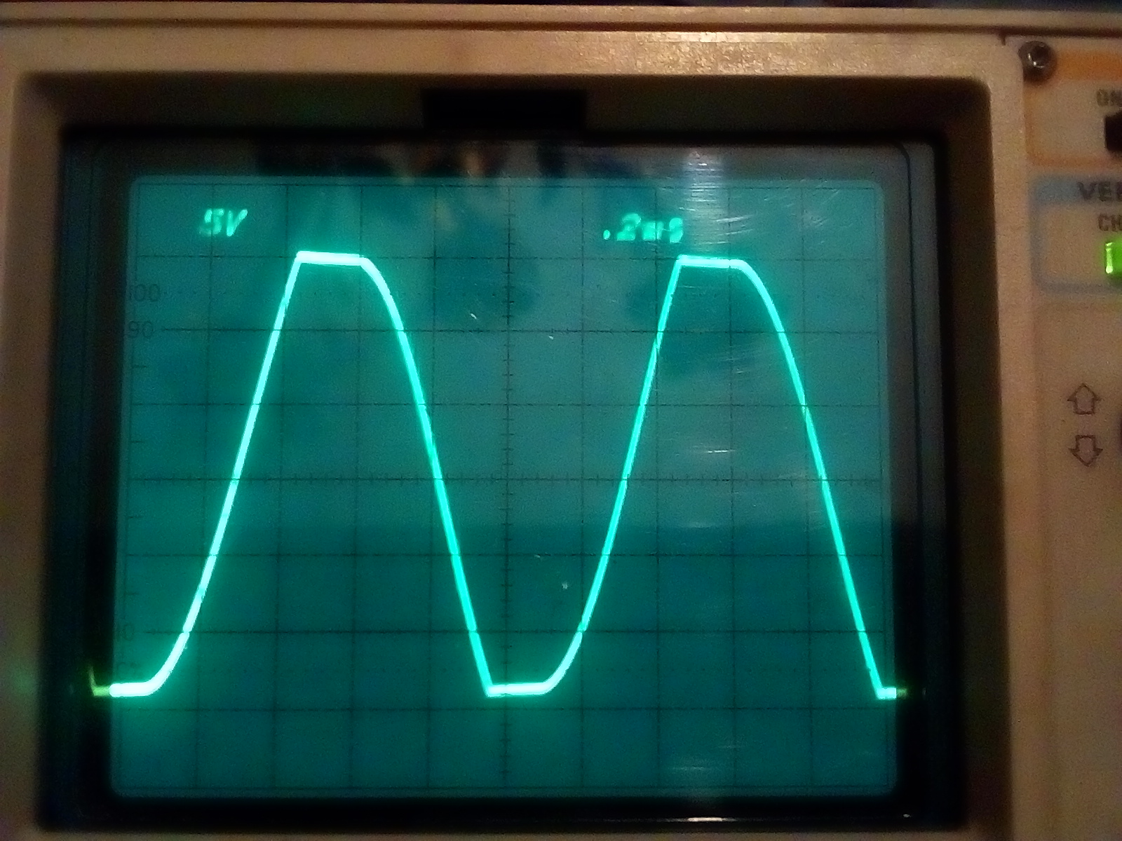

Voltage on TP8 is too high. should be less than 1Vdc. There is way too much offset on TP1. U2 doesn't matter at this point. Your problem is with the oscillator or control. Show the wave form on TP1 again. Is it still clipped.
Short TP8 to ground and see if the oscillator stops.
It is almost 30 vp-p!
Here is current TP1 still clipped.
Then TP8 shorted to the Gnd pin. No change it doesn't stop!
-Steven

Before I noticed that U1 (on the 1468) pin #5 was not in the socket, bent under, I pulled the IC and corrected that, still no change, voltages remained the same on all test points.. and on U2 Does that help at all?
Again, here is current TP1. Then TP8 shorted to Gnd. 28v p-p. Much more than the signal (20vp-p) is on the schematic in the manual.
I am thinking there is a resistor that is open, and the gain is too high on U1.
-Steven

It appears that Q2 may be open. The reported gate voltage (TP6) should turn the FET to low resistance, but seemingly doesn't because the oscillator hasn't stopped. The gate voltage is also oddly high. I would expect the gate-channel junction to forward bias at around 0.7V, so this is also suggestive of a defective FET. (By way of confirming proper proper U2, if TP5 and TP6 voltages remain as reported, U2 pin 8 should be around +8V. It would be good to confirm all is well with U2.)
Back to confirming suspected Q2 failure: Adjust R30 to maximum resistance, as this is least challenging for Q2 on-state resistance. Then try shorting the R52-C30-Q2 (i.e. across FET) node to ground. If the oscillator stops, the implication is an open Q2.
If this test does not stop the oscillator, first order of business is to find out why it doesn't. If you arrive at this unhappy spot, perhaps you could show a new picture of TP8 with DC coupling.
Good luck!
Followup speculation: a shorted gate-channel Q2 failure would also explain the slightly elevated TP1 bias voltage David noted in his post.
