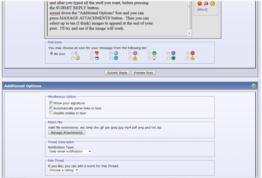

Another attempt. View attachment 691890
BSST, that is one way to attach images to the your post. Another way, after you press the QUOTE button to reply to a post and after you typed all the stuff you want, before pressing the SUBMIT REPLY button,
Scroll down the "Additional Options" box and press MANAGE ATTACHMENTS button.
Then select up to ten (I think) images to append at the end of your
post. I'll try it and post it below. The image is handy and create a small preview as shown below.
