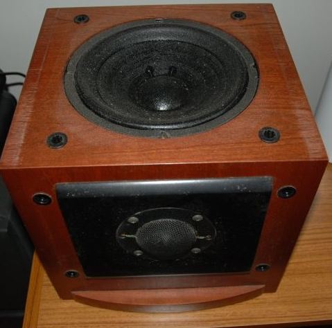

I got thoroughly interested in the omni sound. Wondered if it worked:
599576d1487227785-hegeman-crossover-mystery-help-modified-bw3-monitor-audio-r300-md.jpg
Surprisingly good. 🙂

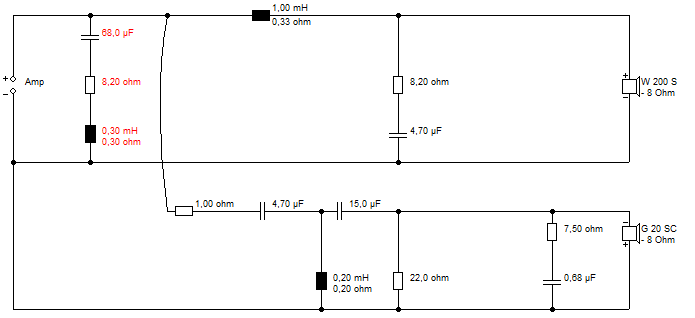

But I did a little trick in making the crossover what is called Third order Butterworth or BW3:
Works like this on phase:
591254d1484013729-flat-impedance-flat-power-response-design-flat-impedance-flat-baffle-phase-png
591253d1484013729-flat-impedance-flat-power-response-design-flat-impedance-flatt-baffle-png
591255d1484013729-flat-impedance-flat-power-response-design-flat-impedance-circuit-png

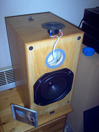

You model it like it is flat baffle. The idea is 90 degree phase fills the power hole that you get with exact phase aligned. So sounds natural.
Flat Impedance and Flat Power response design.
All experimental, but I've always liked BW3. It was a standard at the BBC years ago. But I had this intuition that maybe 90 degree phase meant you should turn the tweeter 90 degrees. Who knows?
