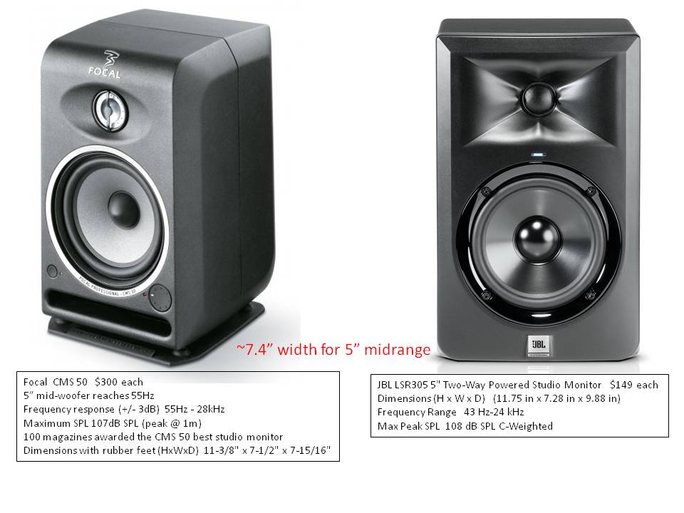

Charlie, you are correct that a normal 5" midrange in an equalized small sealed box is best suited for very close range listening.
Widening the front baffle to 6.5" allows using standard modest cost 6" midbass like the "Anarchy" with +/- 12mm to deliver strong bass with high watts, or SOA midbass like the Satori MW16P to deliver exceptional clarity, with modest cost construction and modest cost cabinets.
bcodemz, your test quest shows the high sensitivity to front baffle width, and advanced thin-wall cabinet availabililty for high quality sound.
Popular monitors with 5" midrange average 7.4" front baffle width.
Bass Reflex Port used for increased efficiency even with extensive DSP + amps.
JBL LSR305 5" Two-Way Powered Studio Monitor $149 each
Dimensions (H x W x D) (11.75 in x 7.28 in x 9.88 in)
Frequency Range 43 Hz-24 kHz
Max Peak SPL 108 dB SPL C-Weighted
rear pipe port
Focal CMS 50 $300 each
5” mid-woofer reaches 55Hz
Frequency response (+/- 3dB) 55Hz - 28kHz
Maximum SPL 107dB SPL (peak @ 1m)
100 magazines awarded the CMS 50 best studio monitor
Dimensions with rubber feet (HxLxD) 11-3/8" x 7.-1/2" x 7-15/16"
front slot port

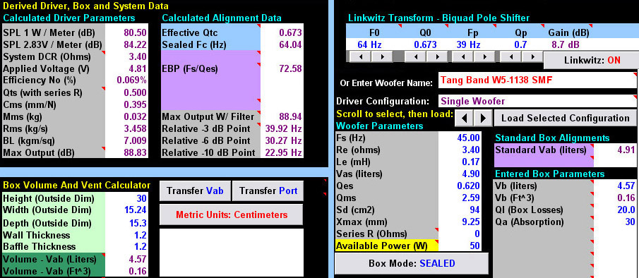

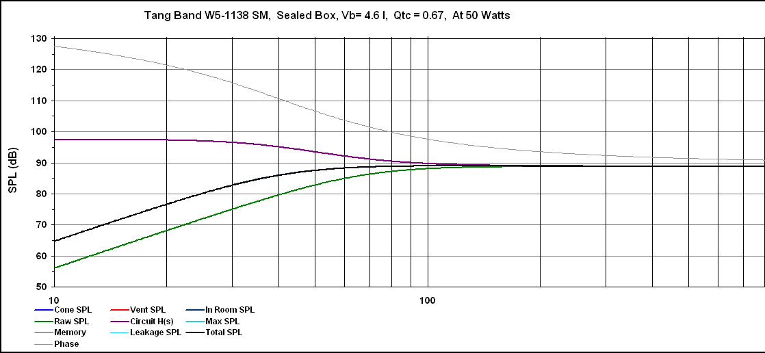

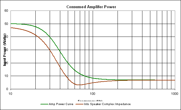

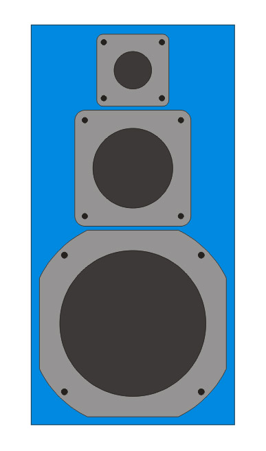

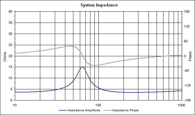

Mini 3 way
Tang Band W5-1138 SMF; modified frame
Morel MDM 55
Morel MDT 39
Cabinet out of 12 mm ply with bitumen sheets inside.
