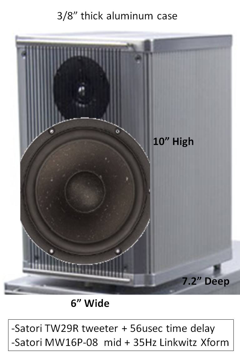

LOW COST.... parts from my my closet + 16mm plywood:
BOX EXTERIOR = 432 cubic inches: 6" wide x 10" high x 7.2" deep
-SB-Acoustics...SB26STCN...1' dome tweeter(option: 16mm time-step baffle)
-SB-Acoustics...SB15NRX-08...5" midbass...equalized with 35Hz Linkwitz Transform.
(~$80 in speakers + simple 2Khz LR2 passive Xover + amp with linkwitz transform + cheap plywood cabinet)
HIGH COST...some machining + custom 3/8" thick aluminum+braced_sides case.
-Satori MW16P-08 with portion of the Left+Right front flange machined off.
-Satori TW29 1" dome tweeter with ring-portion of the front flange unscrewed.
(~$280 in speakers + amp with linkwitz transform + EXPENSIVE aluminum case)
