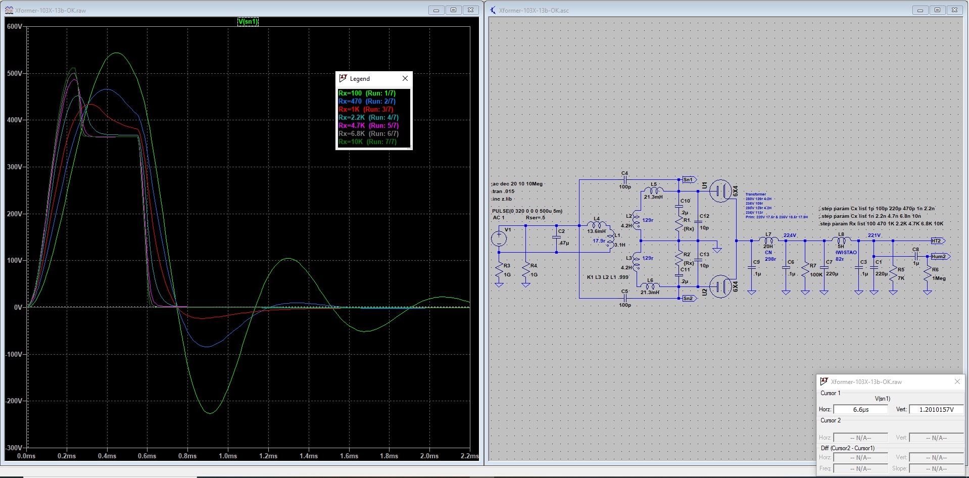

Zung, why would you obtain measured parasitic components and then use a simulation to determine an RC snubber across a secondary HT winding without also doing an in-situ measurement as per the quasimodo style ring test ?
Why not? 🙂
I actually have the Quasimodo, but I tried to broaden the scope and use it as an EMI filter as well, after realizing the commercial filters all ring.

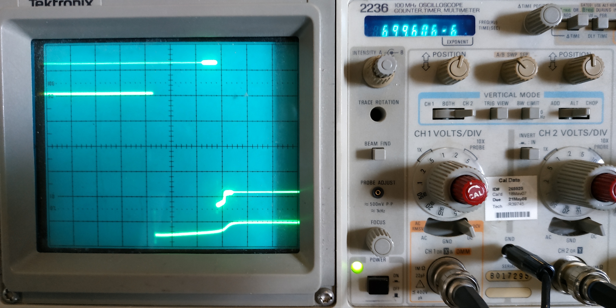

Showing a scope screen without any description on what is being shown and what the test setup involved is imho just a waste of space.
Not anymore than the kind folks who are repeatedly posting "all amps/topologies/parts sound the same". 🙂
The pic comes from a previous post where I compared a fast diode and a Schottky, both tested with a Quasimodo. To waste a bit more screen estate, here's the 150nS FR608 fast diode under the exact same conditions.
832246d1586448433-jc2-hpa-headphone-amplifier-fr608-jpg
Mark has generously shared Quasimodo with us (takes the guesswork out of snubbing, Zung) as well as a survey of transformer ringing to find the best (actually least-worst) diode available for a very affordable 3Euro (here: All articles | Linear Audio - thanks, Jan)...
I'm aware of both items; I'm just trying to include EMI filtering with the same topology. There's no more guesswork than the Quasi for the initial value of the cap, plus the modern comfort of the ".step" command that lets you compare different values.
Could someone explain to me the reasoning behind making the snubbing critically damped? If overdamped to any degree, the only downside is that the resistor gets warmer. What am I missing?

Zung, you seem to be using a different test jig for diode testing than the default Quasimodo setup used for snubber testing - is your setup described anywhere? I presume the test jig is hammering the diode under conditions that won't be experienced in normal amp power supplies? Did you only have an 800V pn diode to compare to a 20V schottky?
Chris, the snubber capacitance lowers the resonant circuit frequency (with the winding leakage inductance), and diverts transient current through it (rather than mainly being consumed by the winding), and I'm likely missing some other subtleties. There may be no noticeable disadvantage to having the snubber grossly over-damped. Aiming for a critically damped response is just an easier visual target to aim for. 'Critical' does not imply 'exact' imho, as the test jig conditions are not exactly the same as the in-situ conditions.
It's also worth appreciating that the quasimodo scope plots are meant to look 'severe' so as to observe any transient response - in normal amp operation it can be quite difficult to discern any transient, depending on the circuit/conditions, and I've found it very difficult for valve amp type B+ supplies to identify any rectifier transient even when resorting to a soundcard/spectrum analyser to look at the noise floor.
I only use the pulse generator part from the Quasimodo. Yes, I confess I'm sloppy for using whatever diodes that's loose on the bench, but then again, all Schottky's have a Trr ranging from low nanoseconds to high picoseconds. It's only an order of magnitude thing.
Critical damping gives the fastest dissipation of energy. If you overdamp then you're basically increasing the resistance, so you're not burning off as much energy, making the snubber less effective. (Imagine if you used infinite resistance, you would have no snubber at all!)
This experiment shows the influence of the series resistor(s). Actually, you can use a single RC network across the 2 hot ends of the trafo for similar result, saving a penny.
Anything between 1K and 2K is good enough for R&R
