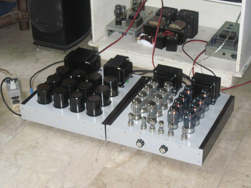

but here is what i do, i use high ampere diodes in my tube amps, why? because number 1 they are so cheap nowadays, number 2 higher rated rectifiers have lower losses and so runs cooler...and i am not referring to those high fallutin' rectumfiers either....
i built this 16kt88 triode wired pushpull amp using a 16A bridge rectifier....

Are you suggesting a ss diode dissipating 0.1W in a valve amp chassis is going to operate at a junction temperature that tangibly improves diode life when the diode is say 5A rated versus 1A rated ? Any comment about using a larger diode die size and how that may have other consequences such as increased junction capacitance or stored charge, or lower junction voltage at the time of turn-off?

it is my personal preference, not strictly based on engineering, but higher current diodes will have more thermal mass, and my posting is not in anyway recommending that others follow....
i am just following what PRR has said in past posts, "build it like a tank" within reason of course...
