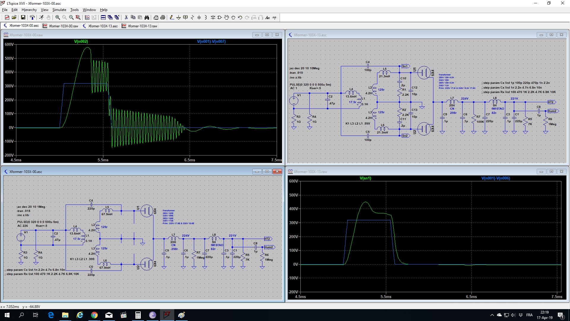

Use fast diodes and put an RC snubbing network across the transformer secondary. Easy.
Yes.
After that, there're still a bit of refinement:
  • For a dollar more, Schottky diodes eliminate switching transients
    832245d1586448390-jc2-hpa-headphone-amplifier-sr520-jpg
  • Then the RC snubber can be tuned to eliminate ringing from the transformer - This requires a LRC meter to measure the inductances and capacitances of the transformer
    attachment.php

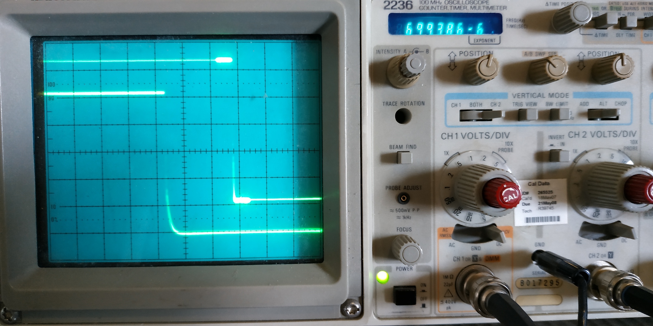

Zung, why would you obtain measured parasitic components and then use a simulation to determine an RC snubber across a secondary HT winding without also doing an in-situ measurement as per the quasimodo style ring test ?
Showing a scope screen without any description on what is being shown and what the test setup involved is imho just a waste of space.
No diode solution 'eliminates switching transients'. The issue is more about how a diode solution softens the forward current step transition when current reaches zero, and whether there is any aspect of reverse current recovery that may also occur.
Mark Johnson on diodes in Linear Audio Vol 10
Mark has generously shared Quasimodo with us (takes the guesswork out of snubbing, Zung) as well as a survey of transformer ringing to find the best (actually least-worst) diode available for a very affordable 3Euro (here: All articles | Linear Audio - thanks, Jan). Here's the Abstract to persuade you to part with your money:
Power transformer secondary ringing was measured with 48 different semiconductor diodes; ringing amplitude was 10-20X lower with the best diodes than the worst. They all rang, including Schottkeys and HEXFREDs. A 1R + 2C snubber directly across the secondary completely eliminated ringing in every case.​
(My emphasis).
