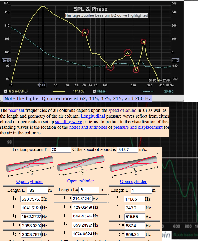

I did see the higher Q disturbances in the bass bin amplitude and phase response (acoustic) as well as apparent higher Q boosts and notches in the transfer function output from the Klipsch-provided DSP crossover (with about a 320 Hz crossover frequency, shown below)....Note the higher Q corrections at 62, 115, 175, 215, and 260 Hz that are (I assume) there to correct perceived min-phase amplitude issues.

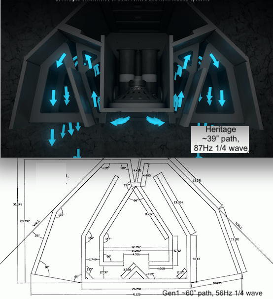

The correction at 62Hz probably is around where the relatively short expansion horn response starts to fall off and is augmented by the bass reflex port response. The other boosts and notches in the transfer function may be related to the various horn sectional resonances.
It would be nice if all the sound waves actually marched along like the blue arrows😎

There is no special DSP correction at 80 Hz, saying to me that this is much more likely a room mode (i.e., the owner's room) instead of a bass bin design issue. (I don't have anechoic measurements of this loudspeaker.)
..I think that's a quarter wave floor bounce cancellation of the microphone placement. When you move the microphone up or down, that notch frequency moves with it. Remember that all these measurements are taken in-room, not outside.
Late night oversight, should have realized the measurements have floor bounce and are off axis to the LF horn exits.
I realize few would be willing to haul these monsters outside, but it would be interesting to see a ground plane measurement near one of the bass bin exits.
