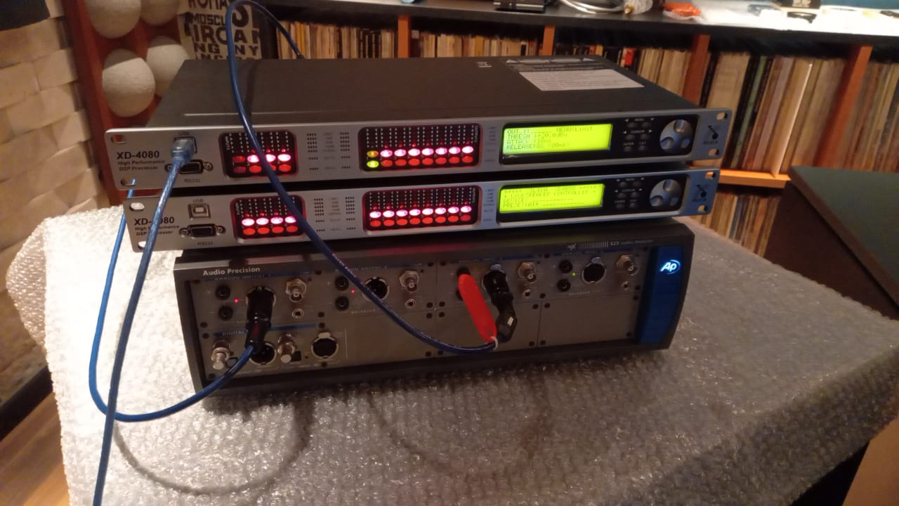

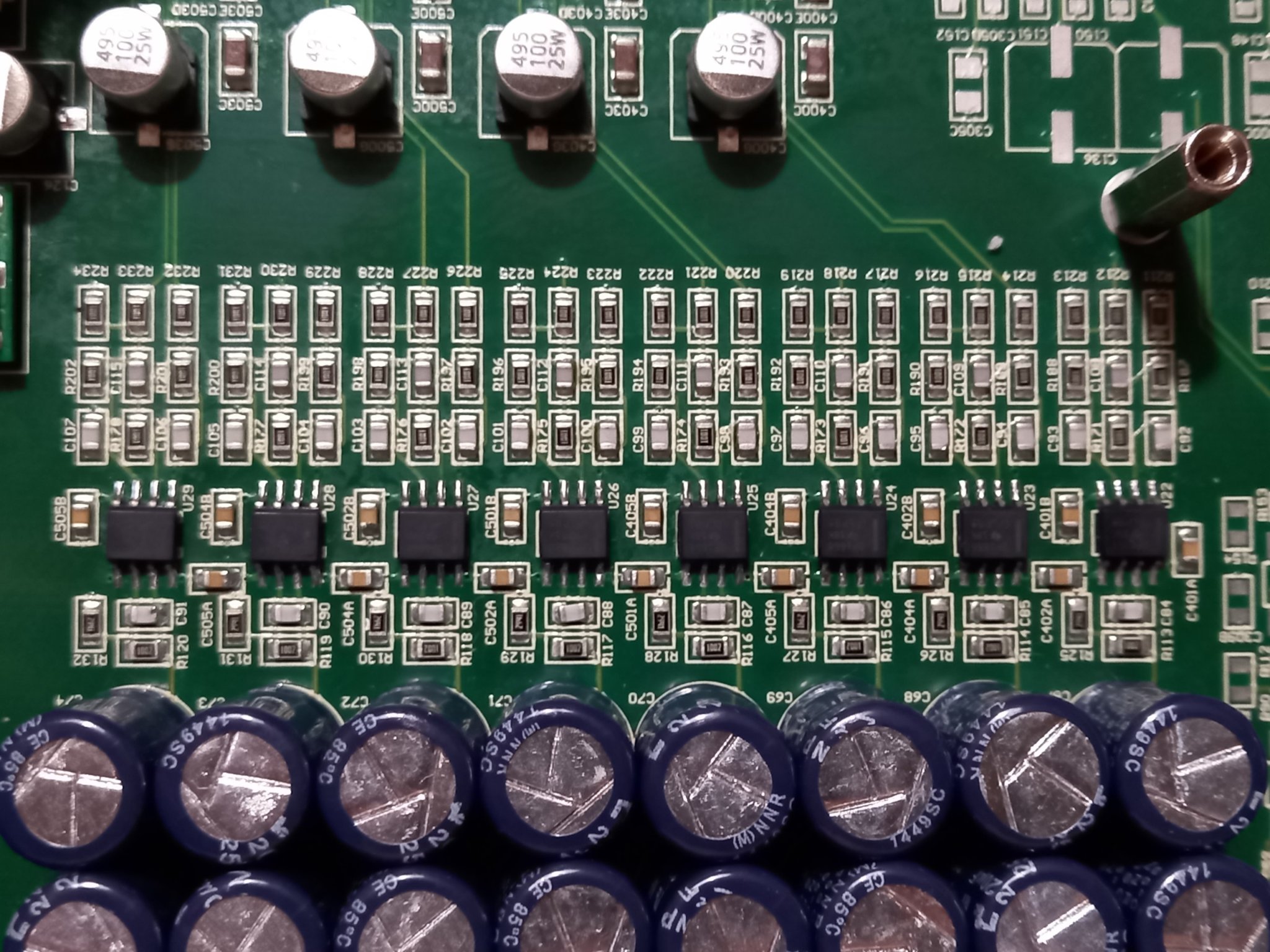

Hi Chris,
I have been following your journey with the Xilica DSP. I must agree with you this is a wonderful sounding piece of gear.
I am using one XD-4080 per channel (using its AES input) in a special arrangement to secure sync between channels. I never used the analogue inputs.
My system is not horn based it is instead a 5 way dipole and the Xilica does it all perfect. I listen only vinyl and I do not hear any degradation in the signal.
However (at least in my units) the XD-4080 used the RC-4080 IC as post DAC I/V converter and this is a NOT an optimal operational amplifier, far from it.
We changed all sixteen RC-4080 by the new OPA-1656 and the improvement was huge. No BS. We verified OPA-1656 through an AP and they were fully stable, no issues.

Thanks for the update/news on the Xilica, C.A. I do remember reading that the XP series is related to the XD series in that the XP's internal components used are more "cost effective" as compared to the XD. I guess you found out just what that means--and substituted the relevant parts.
I guess that I could open mine up and replace the op amps--like you did. I assume they are soldered in instead of socketed(?).

The OPA-1656 are terrific sounding IC. I learnt from them here :
https://www.diyaudio.com/community/threads/opa1656-high-performance-cmos-audio-op-amp.335416/
They are indeed pcb soldered, the 4580 package is a tad smaller than the SOIC but can be replaced without problems. And it worth. I took a risk changing the IC because you never know if the new ones will oscillate so we checked this out and they were fully stable. I considered no more upgrades than this for my Xilica's.

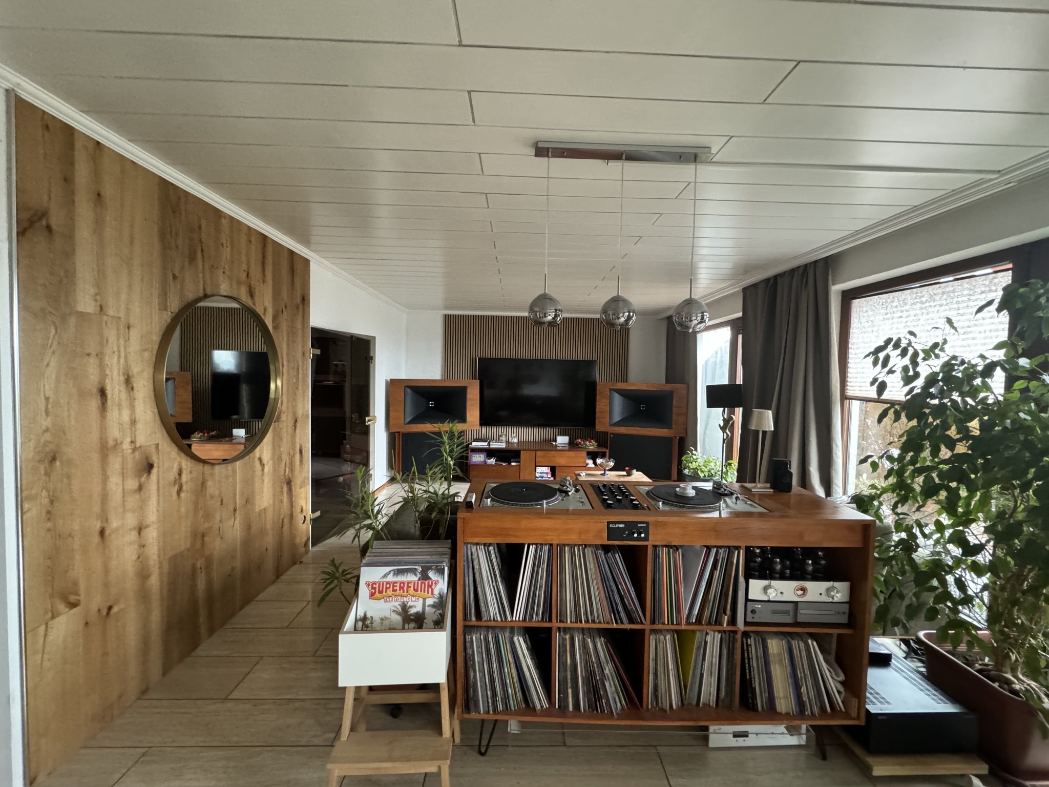

Hello to the Klipsch Jubilee fan community Greetings from Germany,
My Name is Boris Müller I was encouraged to build a Klipsch Jubilee myself exactly one year ago by a post on the Australian stereonet forum from Member Ohms and the Input from Cask05. Thank you very much and big respect to Chris Askew.
I start to build the K-402 horn, which is almost impossible to get here in Europe.
And use them with the Celestion AXI 2050.
I would like to encourage newcomers here not to completely exclude the Mini DSP Flex. I am using the device and am very satisfied with the result. I run it at 32 bit/96 kHz without Dirac. I was able to transfer all the calculated filters from the REW manually, which takes 5 minutes. But later I ended up with the Xilica DSP settings published here. These stettings simply sound better.
I use the Mini DSP flex toslink to the TV. SPDIF for the CD player and analog for the Technics record player. All noise-free and with a convincing result. I published my designed Lens for the AXI 2050 on Thingiverse for 3D printing. Keyword „Jubilee“
I'm currently thinking about a streaming device, an Eversolo DMP A8 streamer, which is supposed to have a DSP with filter on board!
Has anyone had any experience with this or thought about it?
The device is supposed to have a very good digital to analog conversion due to its DSD oversampling.
Boris
Foto shows only the K402 DIY Horn. Bassbin ist the next step in this project. At the moment i use the bass from a klipsch Cornwall 3.

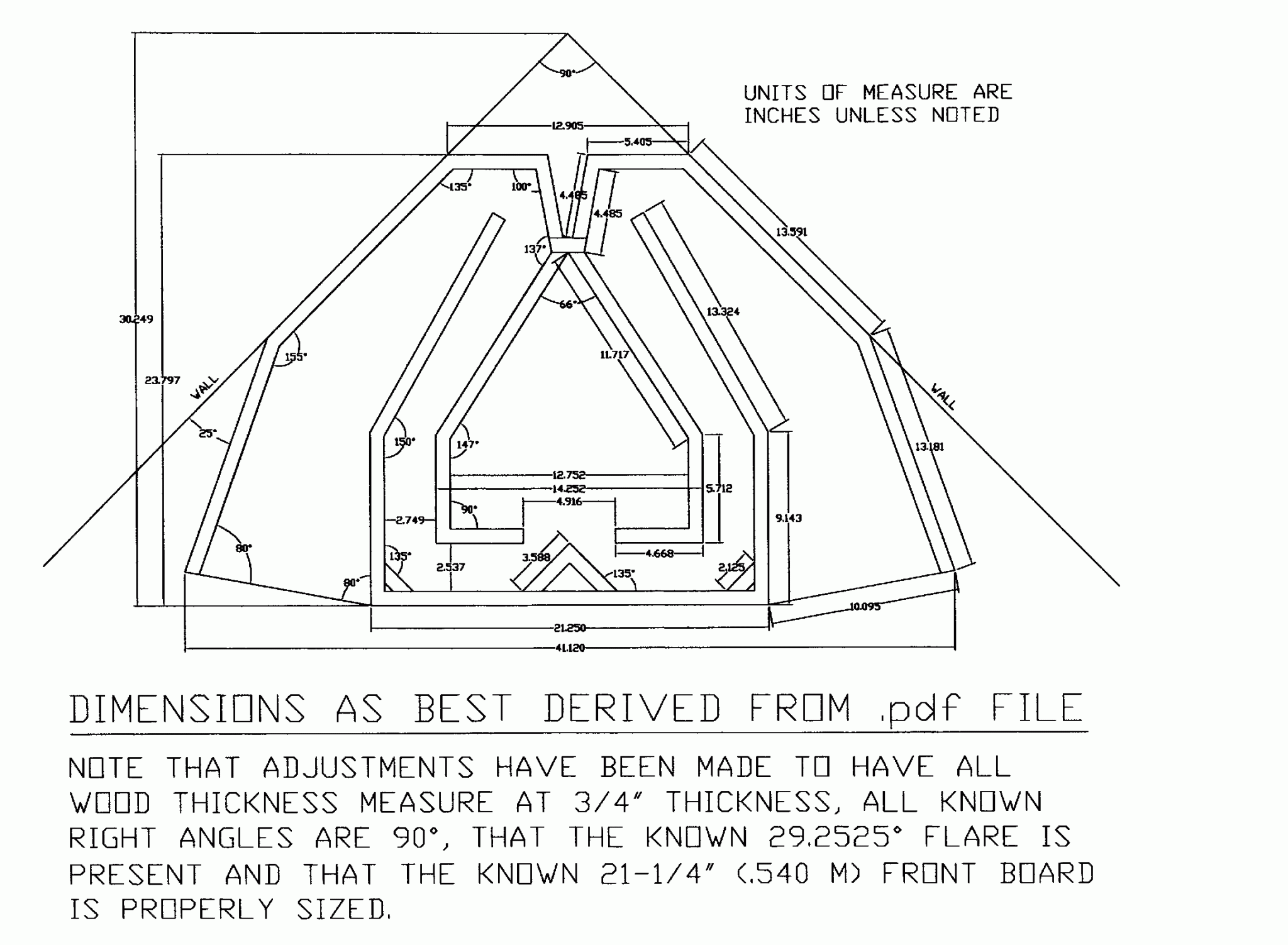

I think the problem occurs at the last 180 degree fold of the horn before you reach the mouth. I would lay out the volume expansion curve of the bass bin first to check to see perhaps where the disruption might be occurring--assuming it's due to a squeezing//non-smooth volume expansion profile).
If the problem is due to internal reflection along the folded horn path, then the volume expansion layout won't help very much in locating the issue. Note that I tried to help two guys remotely dial-in their clone bass bins that were designed based the above layout, and I couldn't get anything below ~55-65 Hz, even with lots of boosting EQ--which says to me it's an internal reflection issue (it should have strong response in a room corner down to 31 Hz. If I can find the REW measurement that shows the problem, I'll check the excess group delay to see if it takes off in this region--which would indicate a severe internal reflection(s).
Here is another approach or two on the folded bass bin design.
Chris

Be careful of using the cross-sectional bass bin layout on the K-forum for a KPT-KHJ-LF bass bin build (i.e., the first-gen bass bin) that strongly affects the bottom octave of the bass bin (i.e., 30-60 Hz when the bin is in a room corner). There is a severe low-frequency cutoff problem using that layout--the one shown below:Bassbin ist the next step in this project. At the moment i use the bass from a klipsch Cornwall 3.
Chris

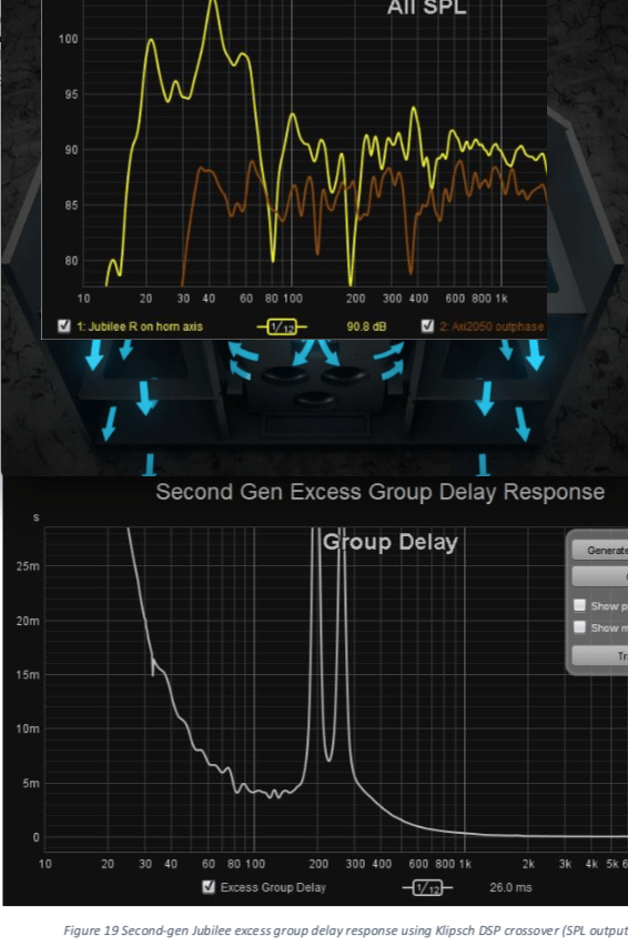

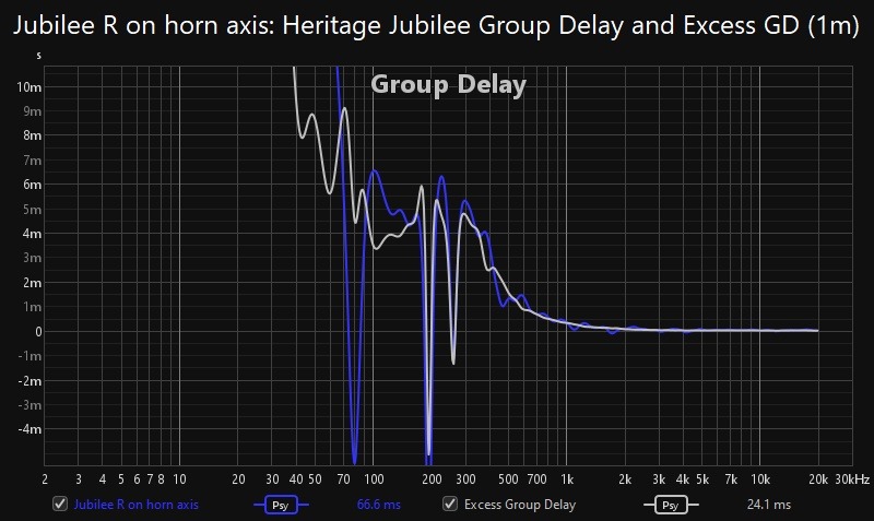

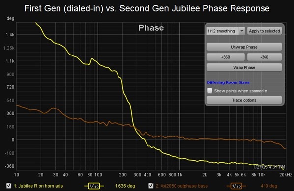

Chris,A good portion of the phase growth shown below for the 2nd-Gen loudspeaker is due to its 4th-order IIR crossover filters used (center frequency at ~320 Hz) vs. the "zeroth order" crossover filters that I use on the 1st-Gen loudspeakers in my listening room. But below ~100 Hz, most of that phase growth between the two bass bins is traceable to the internal bass reflex ports in the 2nd-Gen bass bin--which cannot effectively be EQed out:
Nice work on the upgrade papers!
The 2nd-Gen bass horn's 30+ms excess group delay ringing ~200Hz also seems to correspond to a -25dB deep response cancellation.
After recently reviewing the port response of my 2-way bass reflex MEH (post #1226)
https://www.diyaudio.com/community/...rtual-single-point-source-horn.264485/page-62
found two large port resonant peaks (pipe resonance) at 335Hz and 634 Hz, out of phase with the woofer output causing response cancellations.
Similarly, I also suspect the 2nd-Gen bass horn may be amplifying out-of phase pipe resonances from the three port tubes in the throat resulting in the nulls around 80 and 200Hz.
Do you think that is the case, or are the excessively long group delay tails at 200/275Hz a result of the horn geometry?

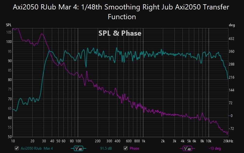

The orange trace of the first-gen dialed-in Celestion Axi2050 driver using the Xilica XP DSP shows a -8dB null in the 350Hz crossover range, what is the cause of that?
Thanks,
Art
Hi Art.

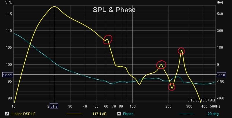

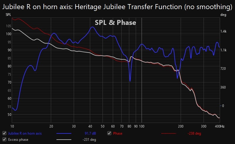

I did see the higher Q disturbances in the bass bin amplitude and phase response (acoustic) as well as apparent higher Q boosts and notches in the transfer function output from the Klipsch-provided DSP crossover (with about a 320 Hz crossover frequency, shown below), which I would not expect to see in other Klipsch-designed horn loaded bass bin corrections (i.e., La Scala, Belle, K-horn, KPT-KHJ-LF, and MWM):
Note the higher Q corrections at 62, 115, 175, 215, and 260 Hz that are (I assume) there to correct perceived min-phase amplitude issues. There is no special DSP correction at 80 Hz, saying to me that this is much more likely a room mode (i.e., the owner's room) instead of a bass bin design issue. (I don't have anechoic measurements of this loudspeaker.)
Here is the 10-400 Hz acoustic transfer function plot of the "Heritage Jubilee" taken in-room (no smoothing):
When evaluating loudspeakers that someone owns, I believe that in-room measurements are appropriate, since that's where they listen to them. The 1m measurements are a compromise to minimize nearfield boundary reflections (floor, ceiling, walls) for apps like REW to yield better phase response plots.
Chris
I think that's a quarter wave floor bounce cancellation of the microphone placement. When you move the microphone up or down, that notch frequency moves with it. Remember that all these measurements are taken in-room, not outside.The 2nd-Gen bass horn's 30+ms excess group delay ringing ~200Hz also seems to correspond to a -25dB deep response cancellation.
I think it's the result of fourth order crossover filters used between two horns that are separated by a fair distance (K-402 on top of bass bin), with the microphone placed on-axis with the K-402 at 1m. There are sensitivities of this to microphone placement in this frequency region. I've included a plot of the group delays for another 1m measurement in-room (microphone on-axis to the K-402.) below:...Do you think that is the case, or are the excessively long group delay tails at 200/275Hz a result of the horn geometry?...
Probably microphone placement. Here's another measurement at 1/48 octave smoothing of the same loudspeaker on-axis with the Axi2050:The orange trace of the first-gen dialed-in Celestion Axi2050 driver using the Xilica XP DSP shows a -8dB null in the 350Hz crossover range, what is the cause of that?
