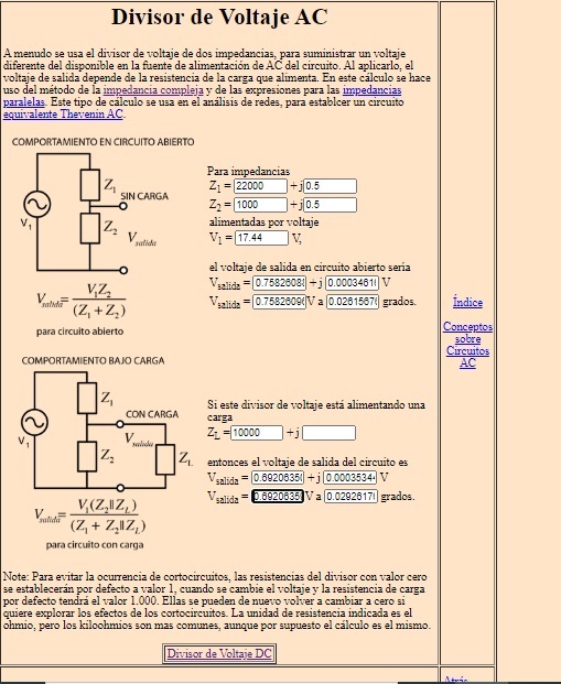

I had forgotten this .......😉 ( thanks rayma, perfect ! Behringer and other manufacturers have standardized 0.750 Volts to 0 dB, I think it will work , the DC calculator says that:
It should say 0.775 Volts, my mistake.
38 watts into 8 ohms is 16V.
Just to comment on the online calculators, which are very useful, would be exact 17.44 Volts .....

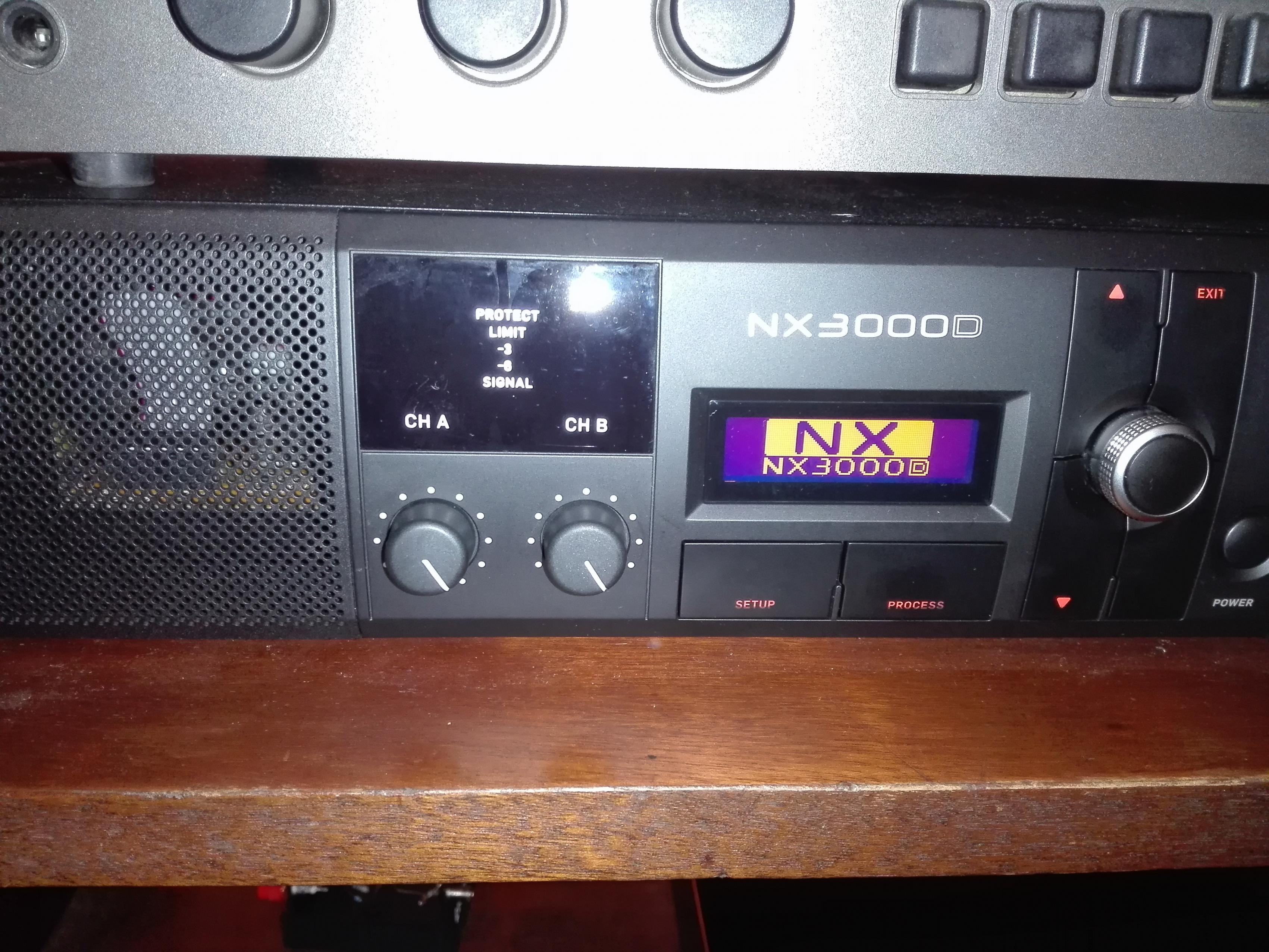

The amp is new, so I won't open - to look for trimmers inside - because it would lose the warranty.

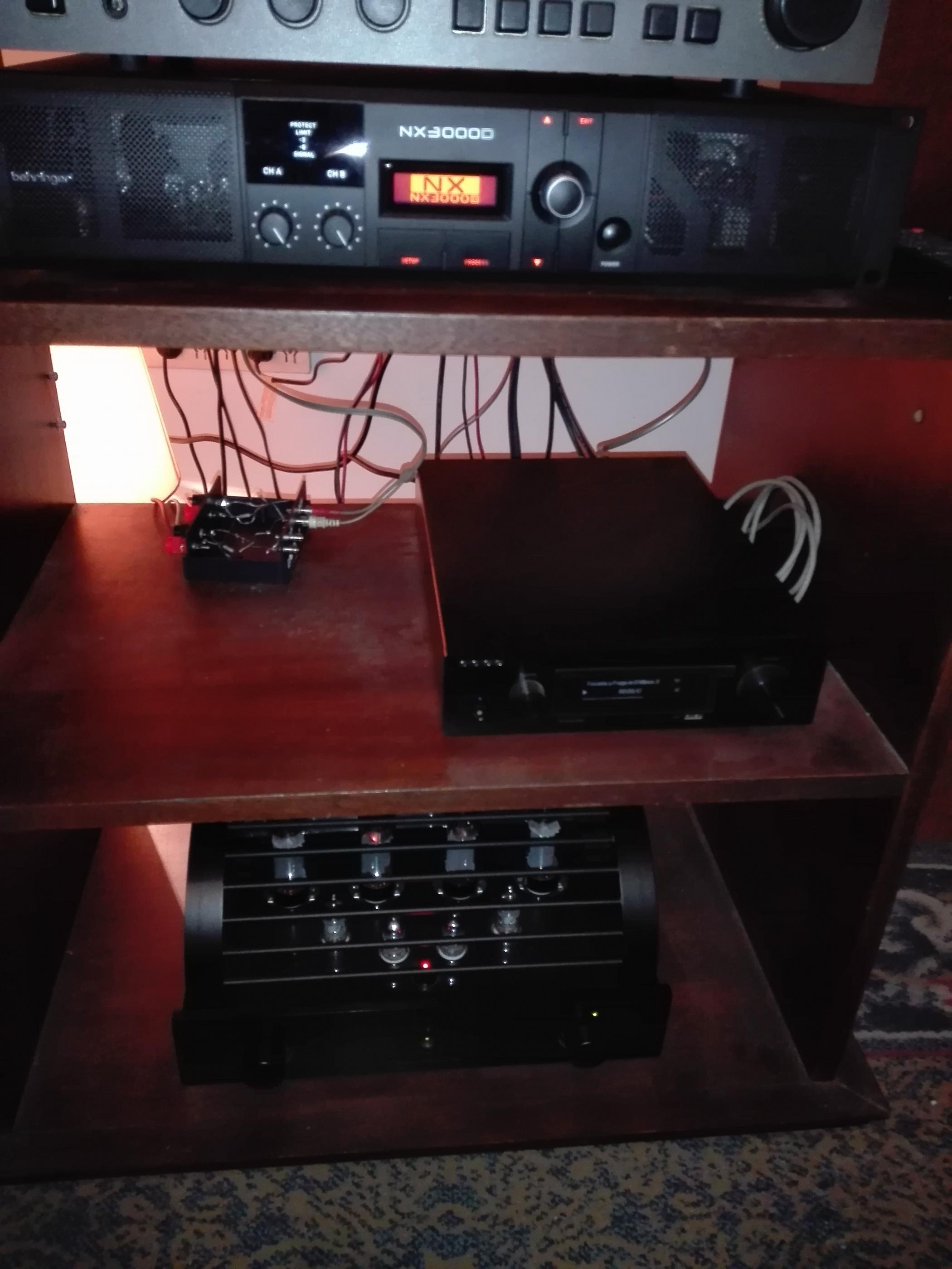

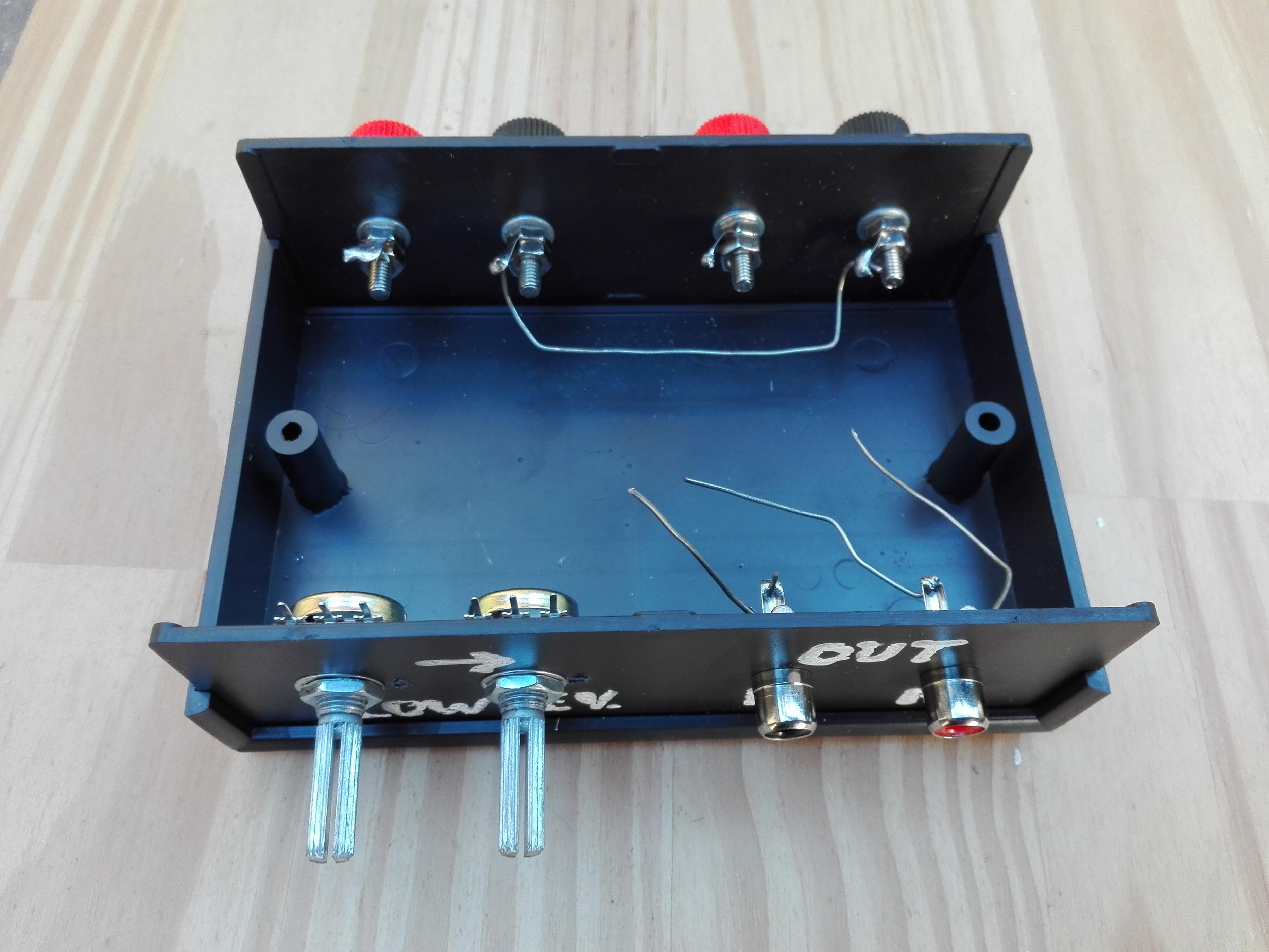

I have finished building the voltage divider and tested it with the tube amp.
With the potentiometers of the Bheringer NX3000D amplifier at maximum, the green light barely blinks (minimum gain, although the crossover was chosen between 20 to 60 hz with the DSP) The basic display of the same is not very intuitive, but once the you learn, it works great!

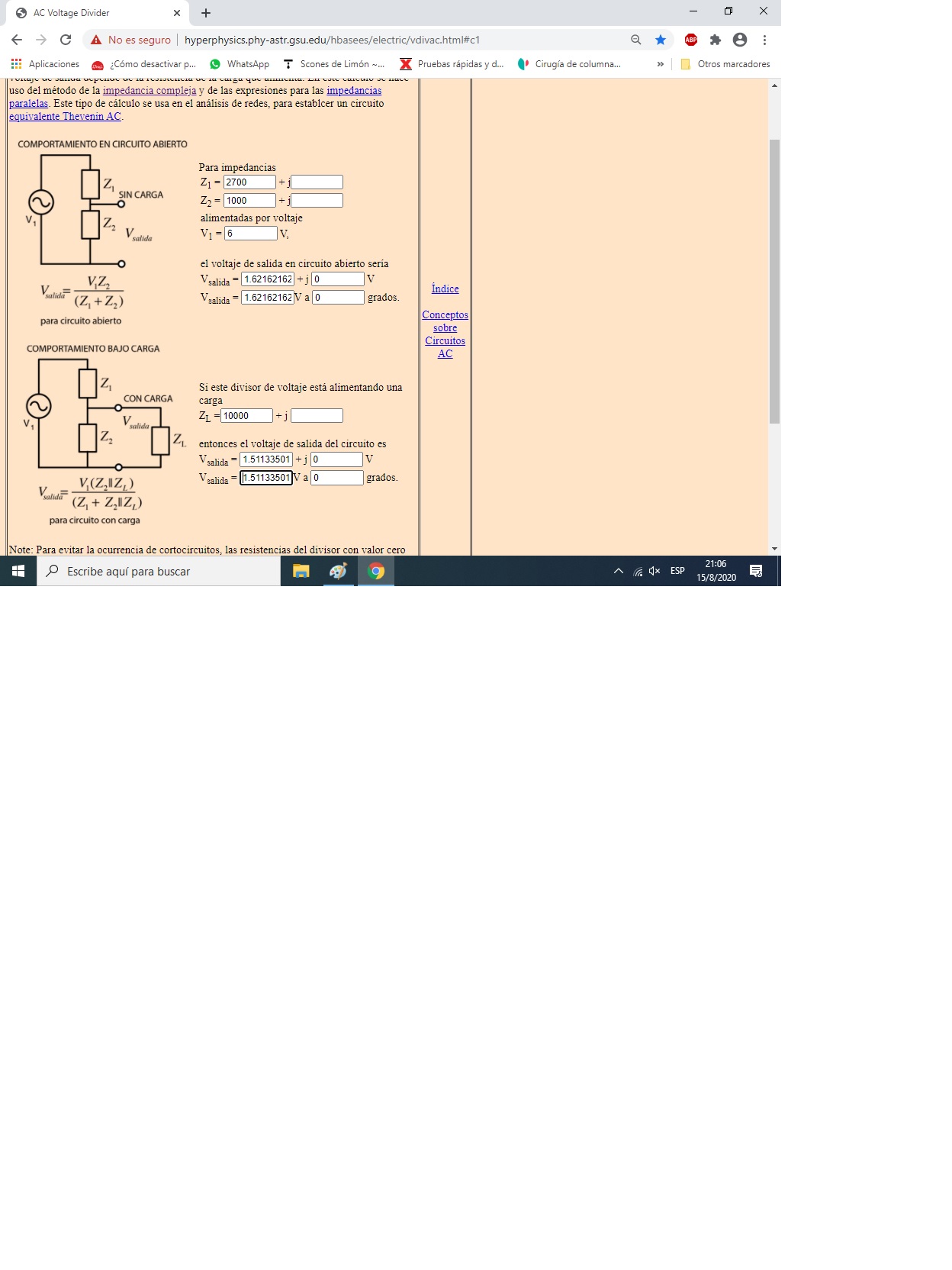

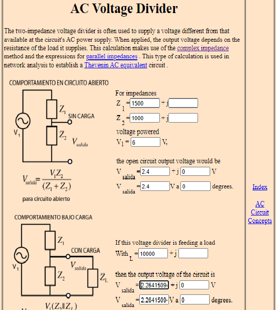

So I went to a new calculation, this time to achieve a voltage of more than 2 volts, because 1 volt being the typical output of a CD player, the red displays did not blink applying a very high SPL level of bass.
I leave you the calculations with which I will test tomorrow.

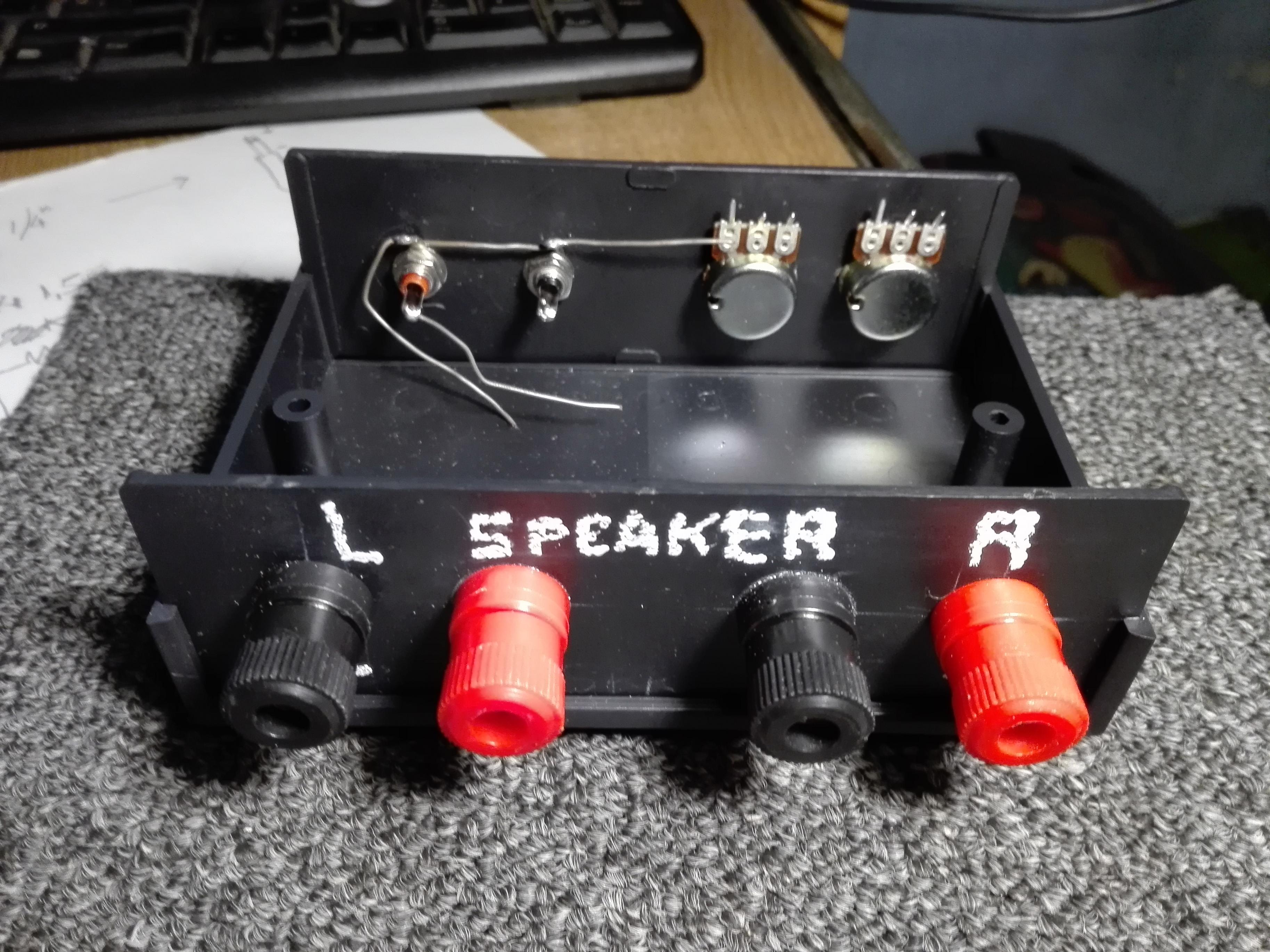

I have decided to try a 10 Kohms (linear) potentiometer for each channel, in replacement of Z1, so I can regulate to the optimum level. Tomorrow I will buy the same ones, I will put on a chinstrap and protective mask and I will go out to expose my life to Covid-19.
Pics and resistors used in failure.
17.44 Volts are for maximum power, that's wrong.
So I will use 6 volts of average and adjustable potentiometers to adjust to taste, much more practical. How did it not occur to us before ?

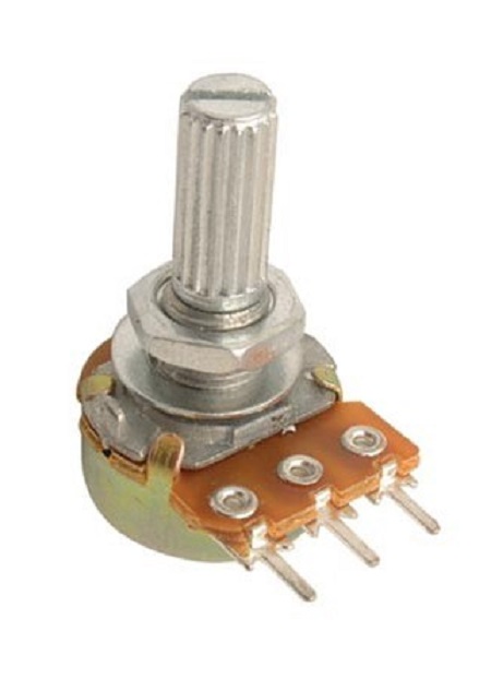

Can you believe that I had to make two visits to the electronics parts house ? 😡
The potentiometers marked 10,000 ohms had 10300 and 8600 ohms, too much of a difference, so i asked to change them, i got a difference between both of only 400 ohms ...😉
It was a bit difficult to cut the splined shafts, and I used a spell checker to paint the letters ...
Yes, awful !
But it will be hidden, it will not be seen ...😀
