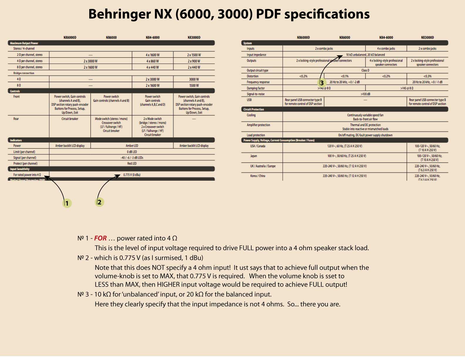

Hi friend, this is the only thing I could find, please look at page 40
https://www.parts-express.com/pedocs/manuals/248-7013--Behringer-NX3000D-Manual.pdf
But there isn't much else, I imagine it would be important to know the input impedance of the Behringer NX3000D in order to calculate more accurately, (I see the calculations are your forte).
Perhaps there is a typical value for XLR connectors ?
XLR connector - Wikipedia
I am from the era of RCA chips! They were the typical values ~ 100 KOhms , 1 volt .
Thanks again ! 🙂

Here is a SCREEN shot, annotated for clarity.
Hope you can clearly see it!
It is a screen shot…
Note that there are input 'volume knobs' on all models of the Behringer amplifiers. If you did not build a thing … but just split off the inputs to your amplifier, to also be input(s) to the Behringer stack, without needing resistor dividers or anything else, with 0.775 V sensitivity and a 10 kΩ input impedance, you're pretty much golden.
It was as I expected… actually.
I have never seen a commercial amplifier with '4 Ω' ionput impedance!
Usually 10 kΩ to well over 250 kΩ impedance.
Those are the “usual design numbers”
You might be asking, “why wouldn't all manufacturers standardize on one particular value?!?”.
That would be a fair question. The answer is surprising, yet very much a deeper inside view of the whole audio design world.
Ideally, we would want the lowest input impedance “practical”. Why?
To reduce, reduce and reduce to the minimum line-frequency hum.
The lower the input impedance, the less hum “makes it thru” from the outside.
Yet, the lower the input impedance, the more the source devices providing signal not only have to provide signal voltage but also power. Ah…
Then there are the realities of instruments without preamplifiers. My custom-wound guitar pickups can only provide the most tiny amount of current at any output voltage. They're very sensitive to the guitar strings, but unfortunately don't generate but a feather's worth of power. So, when the pre-amp, or amplifier they're plugged into has “only 10 kΩ” input, that just kills their output. Very low volume, and very muddy.
However, when the very same guitar is plugged into a “direct box” or a high-sensitivity (and quite common) guitarist's crate amplifier, their input jacks are designed for very high input impedance. 250 kΩ all the way up to 1000 kΩ. Then my custom pickups can sing!
The problem tho' is that the same box-amplifiers and direct-boxes are terribly prone to hum-pickup from the environment. One has to use quite-special and rather expensive quarter-inch instrument cables to squash (prevent) unpleasant levels of buzz and hum at high volume settings.
See?
We want LOW impedance inputs to squash noise. But when too low, the load on the source device increases … to unrealistic power production levels. And unamplified instruments, magnetic and piezoelectric pickups want really high input impedances to match their feeble (but beautiful) output.
Such tension!
Hence why almost every 'stage amp' (like the Behringers) has standardized on 10 kΩ / 20 kΩ input sensitivity. The same manufacturers have standardized on 600 Ω output power driving capability for all their mixer boards, and similar devices (shown in the pretty pictures in the PDF!).
As I said way above, 600 Ω output can drive 10,000 Ω input, easily. VERY easily. But 175,000 Ω output from one of my guitar pickups, can not drive a 10,000 Ω input without signal damage.

MY SUMMARY ADVICE … put a cable splitter between your preamp and amplifier, to 'tap' a second preamp output signal. Run that directly to the Behringer D-class subwoofer-intended amplifier. The Behringers have all kinds of front-and-back panel settings to assist. There is no need for you to first amplifier the source(s) thru your magnificent amplifiers, and then take that output, voltage-divide it, and send it to the subwoofer amp.

Finally I have purchased the Behringer NX3000D amplifier.
So I have to connect it to the speaker output of the Prima Luna valve amplifier.
Here they have provided me with a lot of valuable information in this thread, they are all appreciated and I am grateful for that.
So, I have to build the voltage shunt, I want to get as close as I can to the O.775 Volts for maximum output.
I found these calculators online, but should I use the more complex one, for AC (I don't know what j is here), or the simpler one for DC?

38 watts into 8 ohms is 16V.
It's incredibly improbable that you are using all 38W.
Your amp has 35dB of gain, which is ridiculously high. (20dB would be enough)
The NX3000D has 37dB of gain.
You will need to determine the difference in sensitivity between what the NX3000D drives and what the tube amp drives. Pad the output of the amp down a little less than that, then use the trim pots on the NX3000D to fine tune the levels. I would recommend a resistive pad of 1000 ohms total resistance.
16 Volts? I will then use 20 volts on the calculator as V in. in DC.
The amp should act as a general volume control, the Behringer's settings can be adjusted so as not to clutter up the input, I get that, thanks.
With R1 20 K and R2 1 K I get 0.982 Volts...
I'll play around changing values. You say you don't need to use the AC calculator ?
First make sure the output terminal 0 Ohm (common) tap is grounded, some aren't.
If so, connect the resistor divider between the 16 and 0 taps as follows.
Connect a 1k to the 0 tap, and a 20k to the 16 tap. Connect the
free ends of the resistors together, and to the hot cable conductor.
Connect the ground shield of the cable to the amplifier 0 Ohm tap.
If the level is too high, increase the 20k.

Behringer and other manufacturers have standardized 0.750 Volts to 0 dB, ( CoatGuy dixit ) I think it will work !
I will use these values, I will update you on the construction, thanks and take care Covid 19, please !
