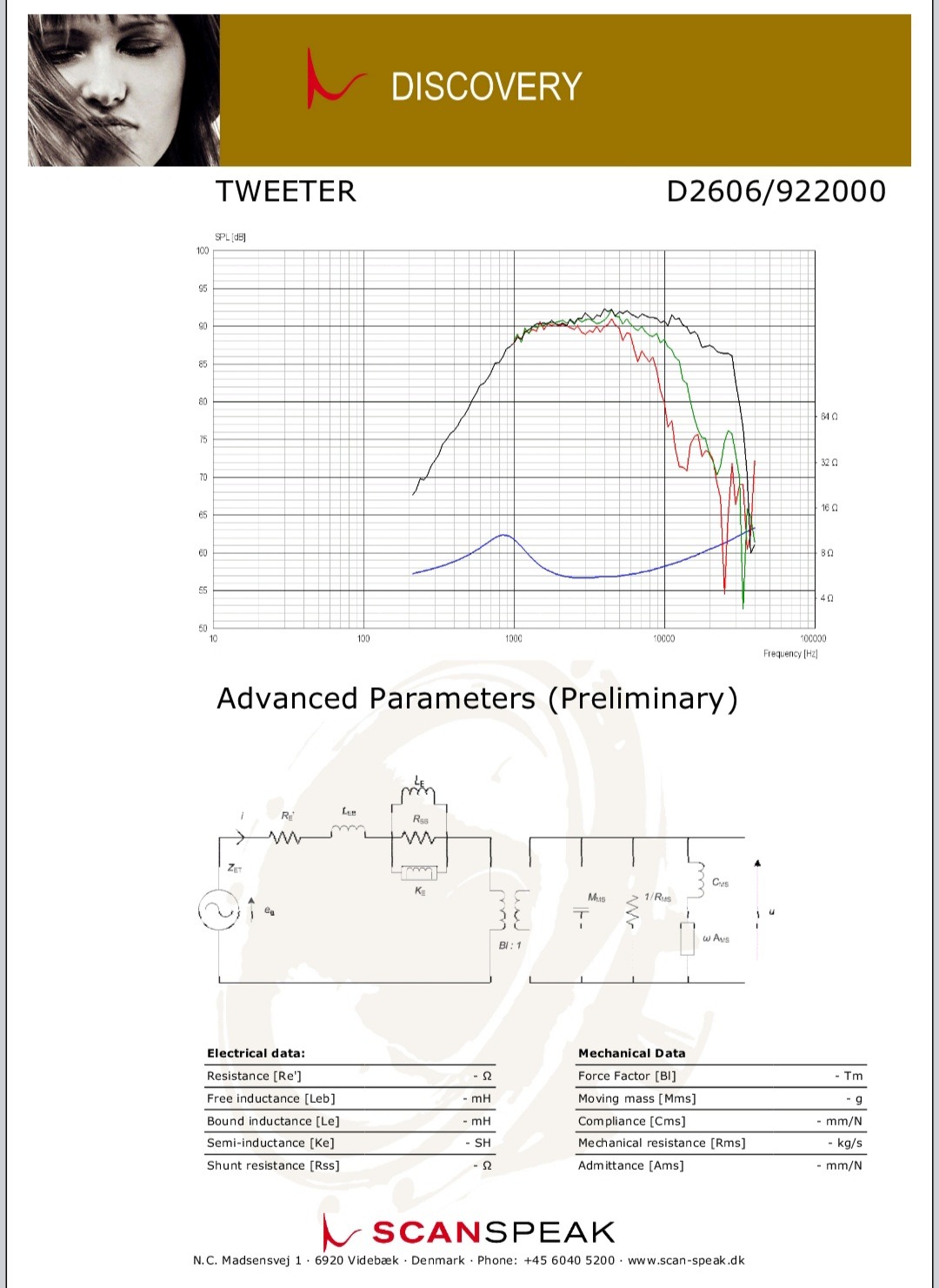

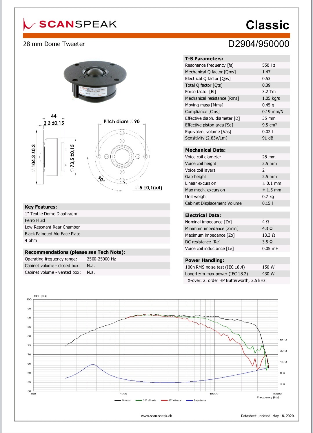

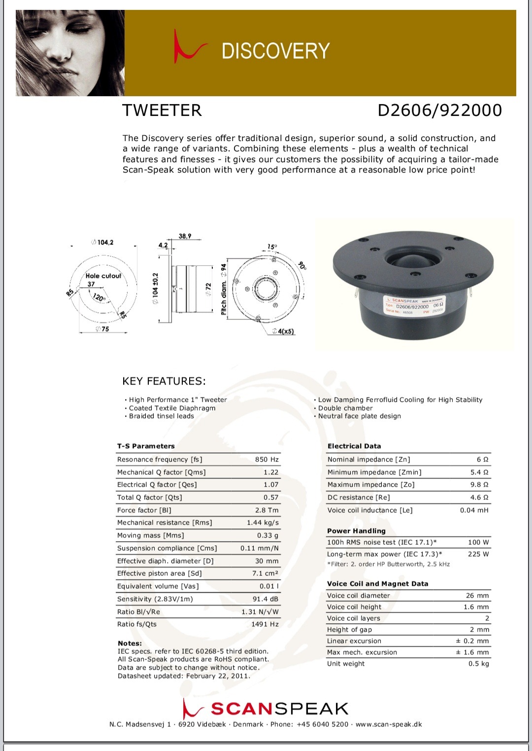

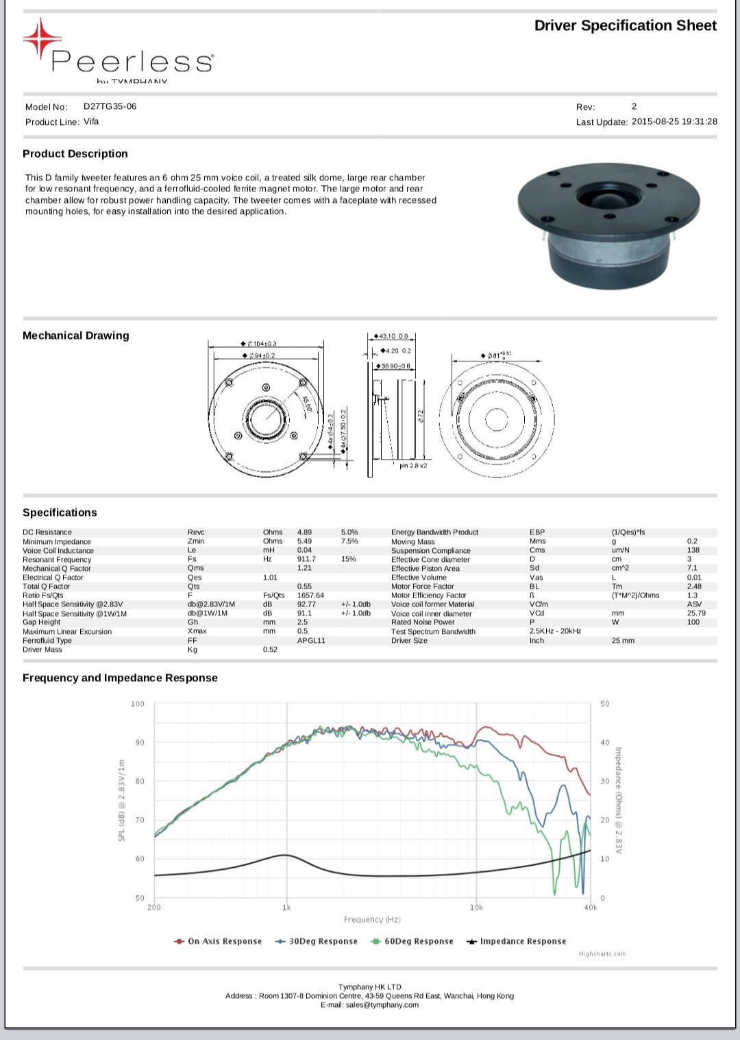

The SS 2904-9500 is a superior tweeter to the D27TG35 (45 uses different faceplate). Older version of Vifa D27TG35 had ferrofluid. The D2606-9220 is said to be the better Scan Speak equivalent to the current chinese Tymphany D27TG35. I would try the 9500 instead but some crossover tweeking would likely be needed.

The Seas Millenium could has been nearer from the original and has a strong Xmax, not the 0,1 mm of the 9500. Unfornatully Seas became mad and sell it 400 euros today for an average distorsion profile. The price took more than 200 euros in less than 10 years which is not justified...better to avoid there are better cheaper choices
The 20 euros peereless 25dxtg looks very similar to the original Seas datasheet wize at least and has good thd.

As others have said and know, these are Vifa D27TG35, Very easy and cheap to get replacements here in Australia.

I had a pair of SS 2905-9500 on the shelf which after looking at spec sheets and response curves etc, seemed like a really good match but better.
It was decided to put these in as an interim as there was nothing to lose.
To keep things even I swapped out both.
Way better than the vifas.
Far smoother, more extended, far less issues with the lower end.
