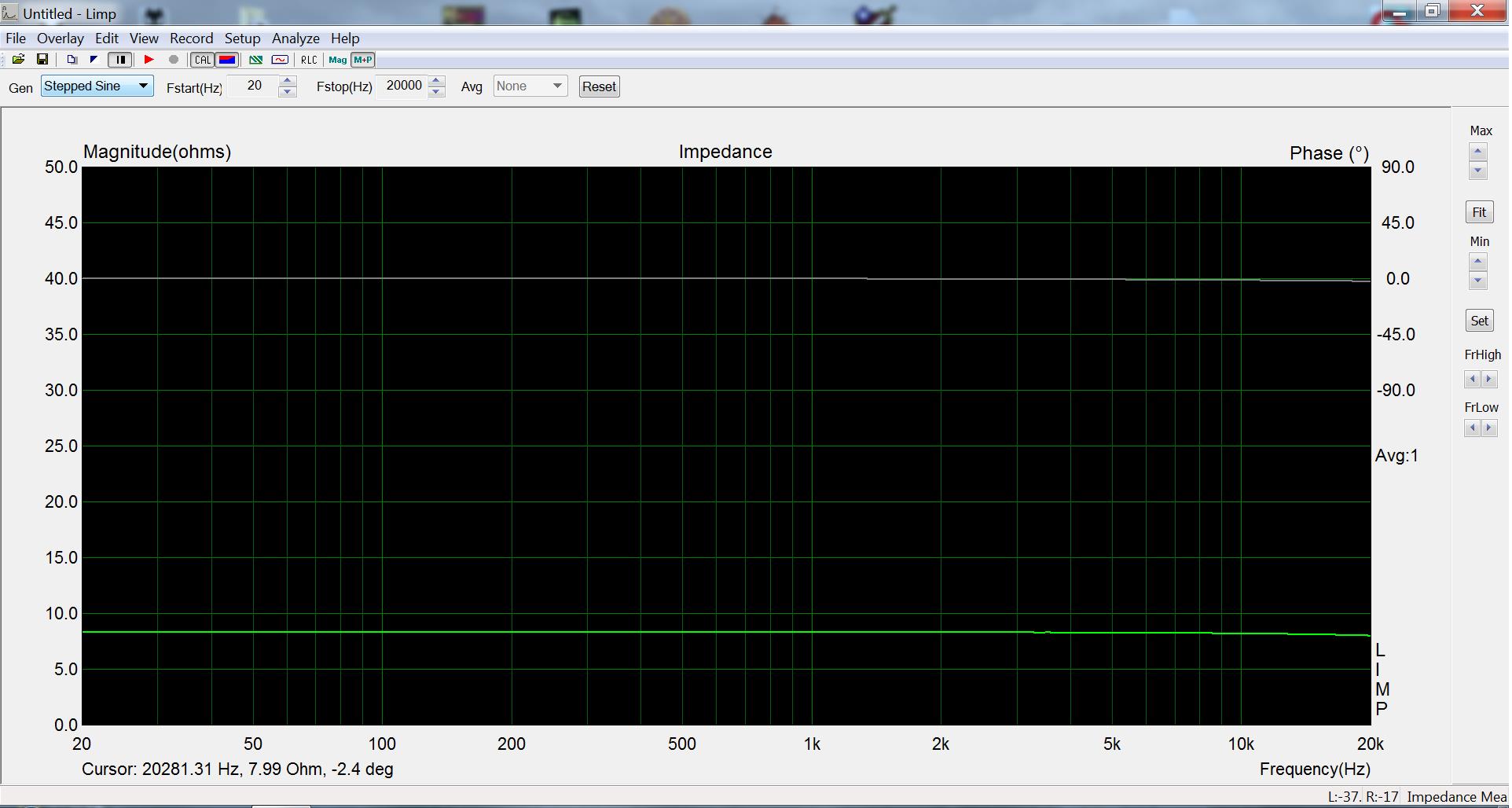

This one measures pretty cool https://heissmann-acoustics.de/test-seas-noferro-900-h1025-06/
But will hardly work with a 6 db fikter with its high Fs...so ask too filter work but at least has a flat impedance and power response.

The Seas Millenium could has been nearer from the original and has a strong Xmax, not the 0,1 mm of the 9500. Unfornatully Seas became mad and sell it 400 euros today for an average distorsion profile. The price took more than 200 euros in less than 10 years which is not justified...better to avoid there are better cheaper choices
The 20 euros peereless 25dxtg looks very similar to the original Seas datasheet wize at least and has good thd.

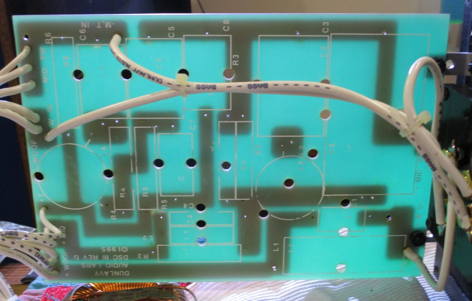

What puzzles me a bit.... going through all of this, did you ever consider replacing that awkward single-sided PCB and the equally awkward cable tie fastenings to PCB with something more adequate?I, and I suspect, many others have really enjoyed some of you destroying yourself over this 🙂

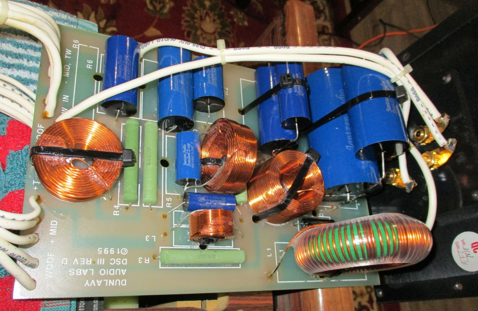

I looked at the crossovers, and by look I mean fully disassembled.
Every part was tested using my $800 b&k LCR meter.
That explains the bass inductors cut lead.
Everything tested fine.

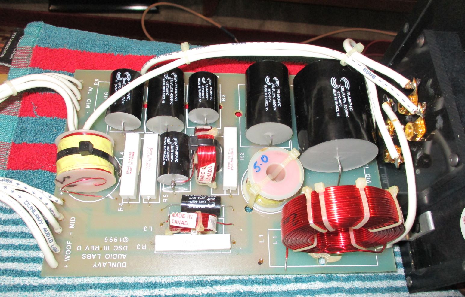

I decided to upgrade all the parts.

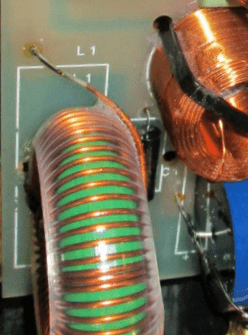

I Hate solen caps, I Hate bennic resistors, Some of the inductors were hand wound and had loose windings.
I didn't like the 0.56DCR of the bass inductor (Which is over the general 10% of driver to inductor DCR that is often quoted as acceptable).
I used Jantzen Standard-Z caps (the little black one is a Cross-Cap as Standards don't go that low)
Jantzen Superes resistors.
Jantzen air cores that if required I unwound to the exact inductance of the originals (to the 4th decimal place).
The DCR is within a few percent of the originals.
The only deviation was the bass inductor which is now a C-core at 0.07DCR
The end result is an absolute revelation.
So much smoother and cleaner through out the entire range.
Far tighter bass with more depth and control.
My friend came back and had another listen and was astounded at the improvement.

I'm aware that HiFi speakers may not see the same rough handling and operating conditions that PA speakers will see but IME this type of XO construction is a fail-safe repair timer... it will break, sooner or later...

Friend recently bough these Dunlavy SC III speakers.
He had them delivered to me as he was away for work.
On arrival they were given a thorough check over.
They sounded awful. And I mean really really awful.
Quick listen to each driver revealed one dead tweeter that was measured as being open circuit.
As others have said and know, these are Vifa D27TG35, Very easy and cheap to get replacements here in Australia.
