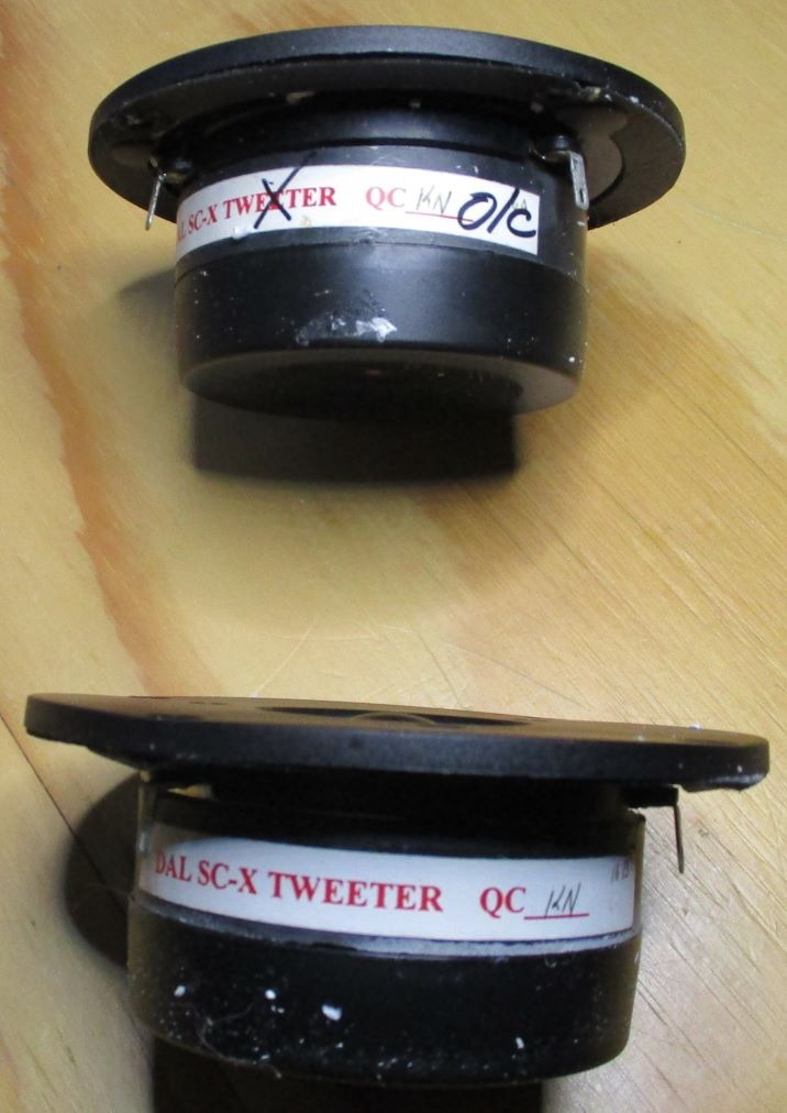

Quick listen to each driver revealed one dead tweeter that was measured as being open circuit.

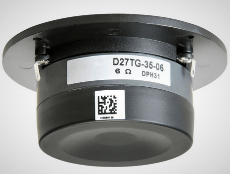

As others have said and know, these are Vifa D27TG35, Very easy and cheap to get replacements here in Australia.

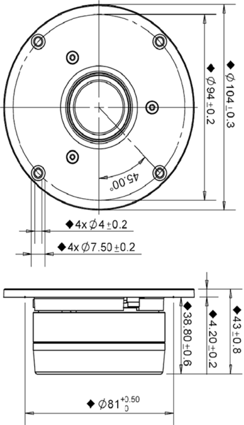

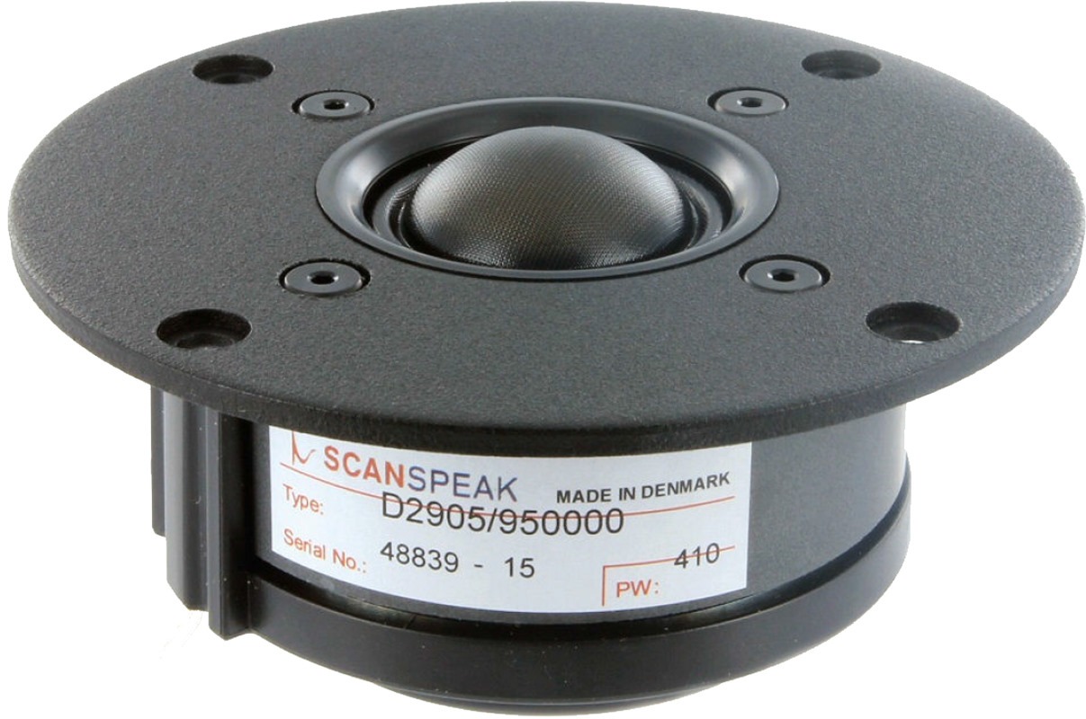

I had a pair of SS 2905-9500 on the shelf which after looking at spec sheets and response curves etc, seemed like a really good match but better.
It was decided to put these in as an interim as there was nothing to lose.
To keep things even I swapped out both.
Way better than the vifas.
Far smoother, more extended, far less issues with the lower end.

Problem with the newer version of that tweeter - it isn't nearly as good as the older Vifa SS version. The dome construction, surface treatment and material are very different. And yes, they were hand matched in those speakers. This is why I have 2 pairs of the old D27TG45s as backup for my last pair of Duntechs. I recently bought a Tymphany branded pair of D27TG35s and they sounded pretty bad in comparison, especially down in lower mids. The magnet asys are also a bit different on these. Duntech used to put a layer of dampening on the tweeter back chambers to cure the slight 2k peak.
