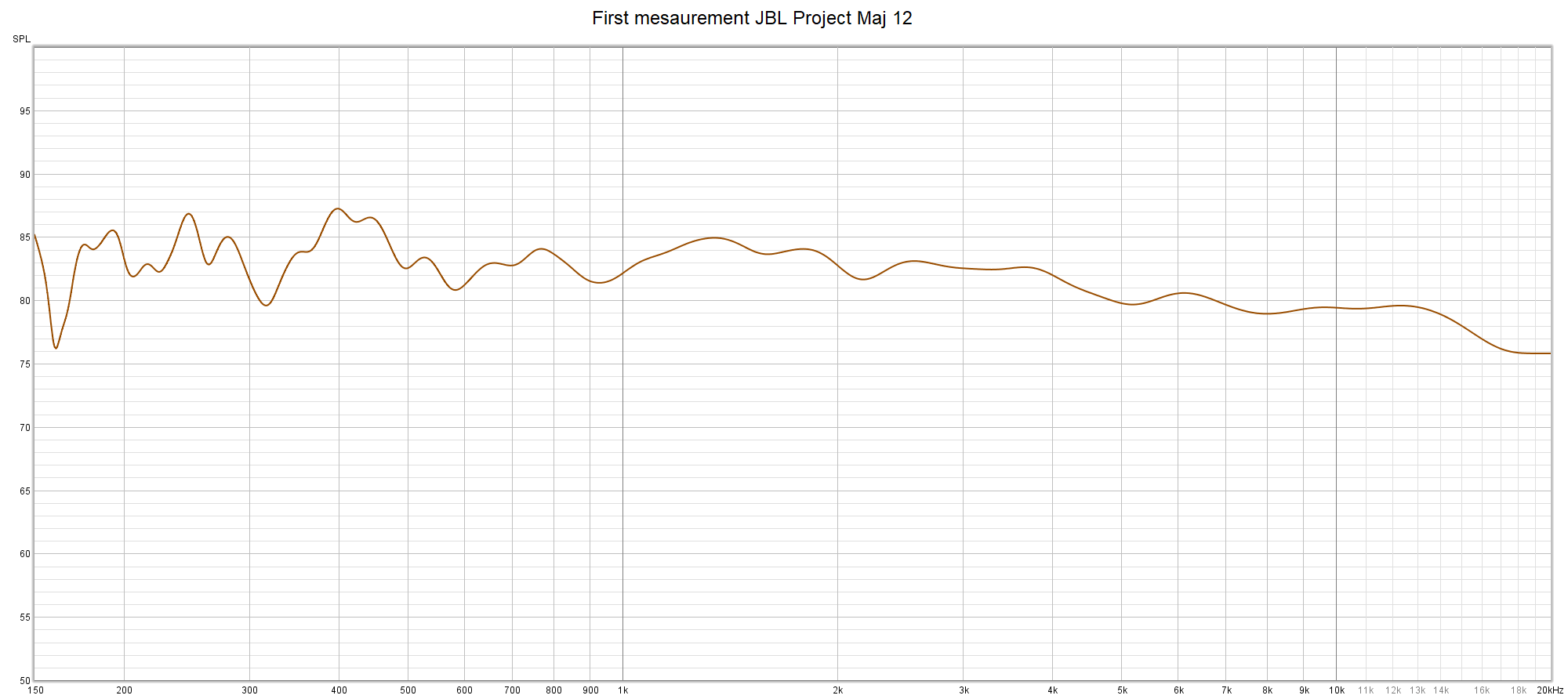

This was in my room yesterday, mic at 90 cm 2,7 meter from speaker.
But ask´t for i don´t know from "where" i should mesaure.
Listeningpossition, at 1 m as usual, 2-3 meters ???
Regards John
I would place the microphone at sitting ear height (about 44"/1.1m) above the floor (where your ears will mostly be when listening to them anyway), and check to see if that height is approximately half-way between the midrange and tweeter driver apertures. If it's high or low from the centerline between the two drivers, then split the difference up or down between the initial height and the centerline height.
Then I'd place a lot of absorption material on the floor between the microphone and the front of the loudspeaker, at least 1 inch/2.5 cm thick and about 2 m wide. The microphone should be at 1 m from the front baffle. The more absorption you use, the better the phase/group delay measurements will be.
If you can, I'd try to remove any all-pass phase shifts between the drivers if you are using DSP crossover by dialing in appropriate delays on the higher frequency drivers--and remove any near field acoustic reflectors within 1-2 m (40-80 inches) from either the loudspeakers themselves or the listening position(s).
Explanation for the above:
The phase of the higher frequency drivers will always lead the lower frequency drivers, so the precedence effect will strongly favor the higher frequency arrivals, i.e., you will perceive the center of the loudspeaker at the tweeter/midrange height, not at the centroid of the loudspeaker's drivers.
In order to measure phase response accurately, you need to remove early reflections from the floor and nearby room furnishings/walls, hence the absorption on the floor from the loudspeaker to the microphone and 2 m wide.
As the frequency gets lower and lower, closer to the room's Schroeder frequency (approximately 100-200 Hz for most rooms that can handle that size loudspeaker), the beamwidth broadens rapidly, thus negating any advantage to putting the measurement microphone nearer the centerline of the drivers. The radial distance of the lower frequency drivers to the 1m nearfield microphone position will straighten out to be about the same distance to the listening position--relative to the higher frequency drivers.
In the crossover interference bands, you will measure a great deal of variation of SPL vs. both vertical and horizontal microphone positions, so just being on-axis with the measurement microphone is the best bet. Get used to it--or trade in your loudspeakers for coaxial MEHs... The closer together you can get the drivers, the more realistic the sound field from all aspects of listening to them in-room. Having to have your head in a vise is the antithesis of good sound quality, I've found.

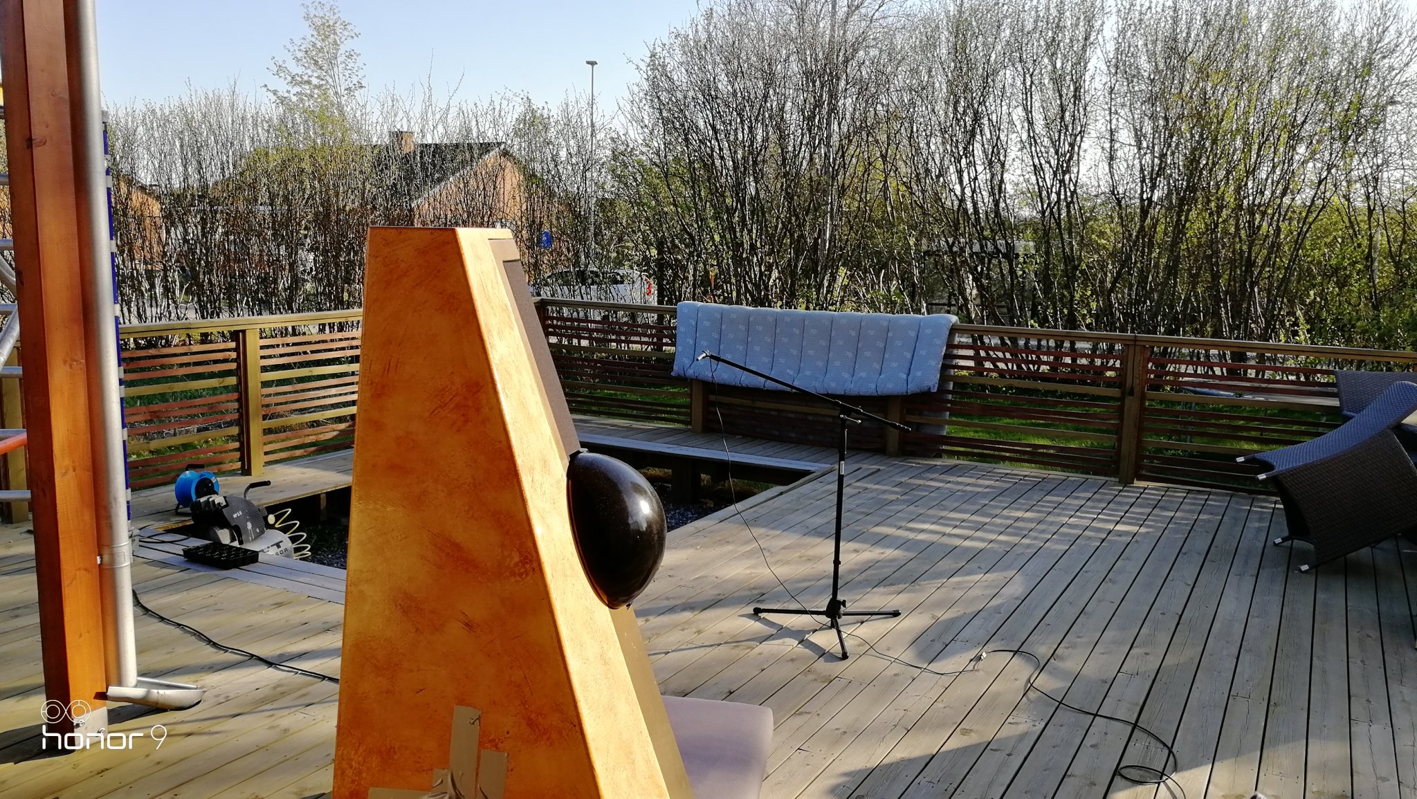

Hard to try to mesaure outside on my porch with cars comming all the time, and the neighbor started running a pressure washer hahaha.

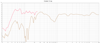

Also a floor/wood at the place, but here are 2 mesaurements.
One is from woofer mesaured from mic 50 cm, and the other from 1 meter mic in front of tweeter at 121 cm high.
Tweeter is JBL 2405h and "work" from about 7000 hz.
A deep dip at 800 hz, but have not see it before ?
Regards John

I'd employ whatever that is draped over the railing back there. Lay it on the deck in front of the loudspeaker and remeasure at the appropriate height .. your listening axis.
Is there any way you can raise the whole loudspeaker up? .. table .. chair?

Its impossible it weight 150 kilo.
Had to take in the speaker inside again over night, its night here in Sweden and weather is unreliable.
The lowmid sits only 30 cm from "floor", so center 15 inch lowmid is 48 cm.

Calculate the floor...
Can you explain how to calculate that Allen ?
Regards John
Maybe have measurement axis over that pit to reduce floor bounce?
Damn, i not think of that!
It should have been better for sure.
(the pit is after a large bubbelpool, and not so nice to have now)
Regards John
Calculate the floor
800 hz wavelength is 43 cm, 15 inch lowmid is 48 cm from "floor" in the center begain at 30 cm ends at 68 cm.
Is it that ?
So if measuring distance is 1 meter, height of driver cc 48 cm and microphone is 121 cm up, .
344/1+1,22-1 = 343,48 ? ( something is missing there, math is not my best strength at this level)
And what is "half wave frequency" ?
50% of 800 hz in my case?
