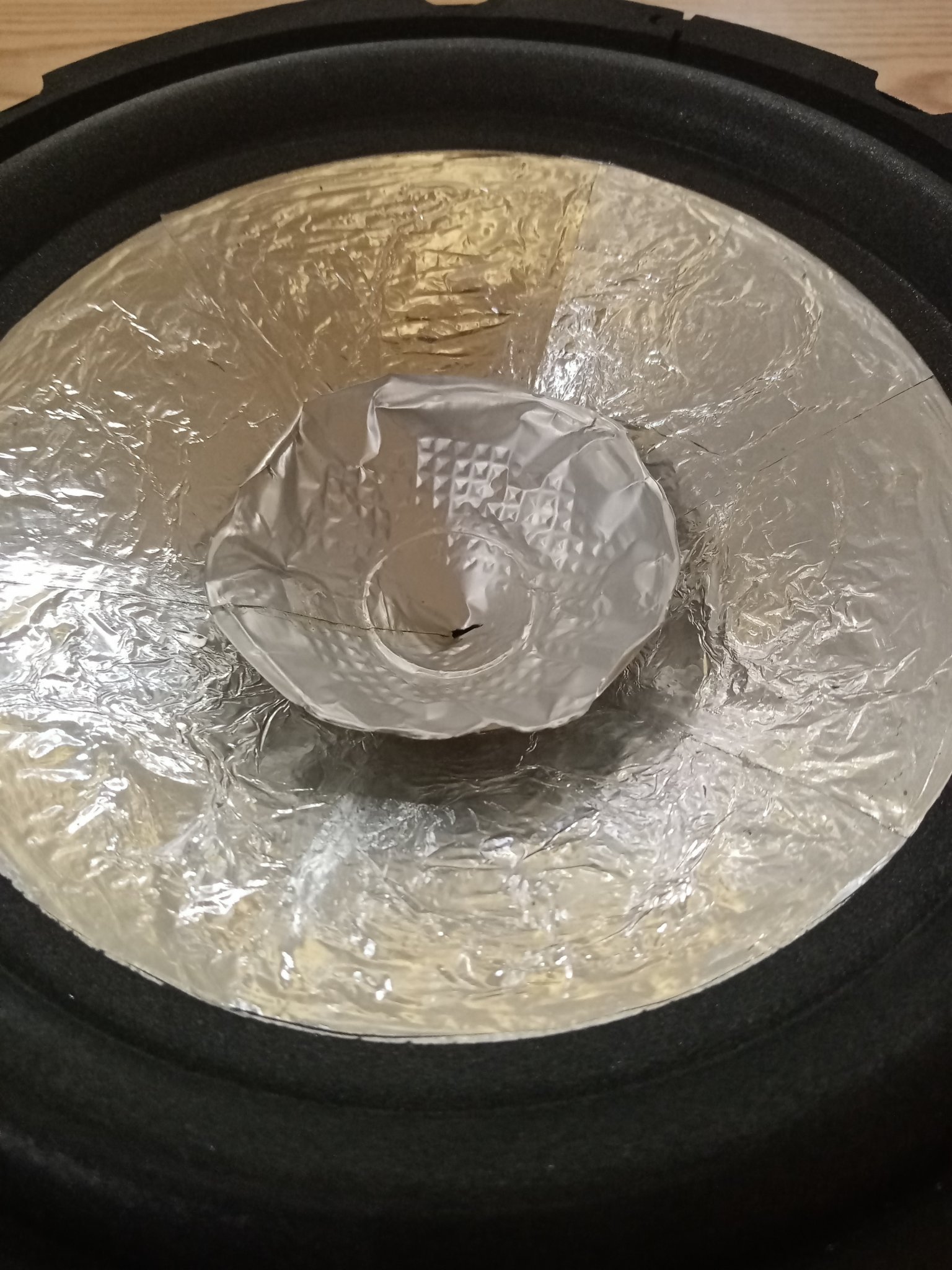

How to make a whizzer cone

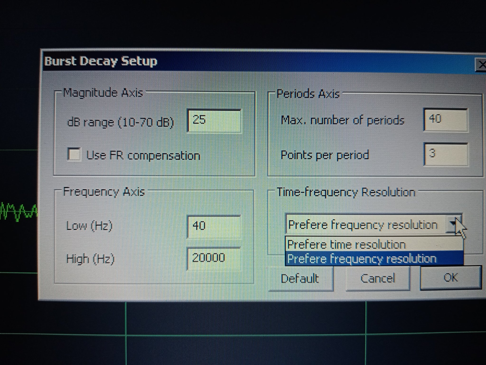

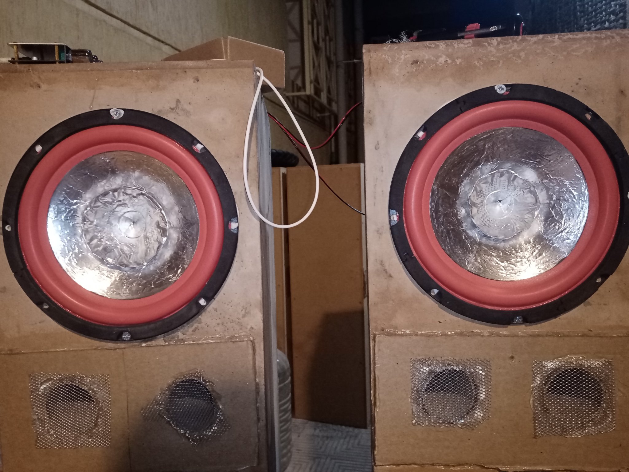

@kgrlee

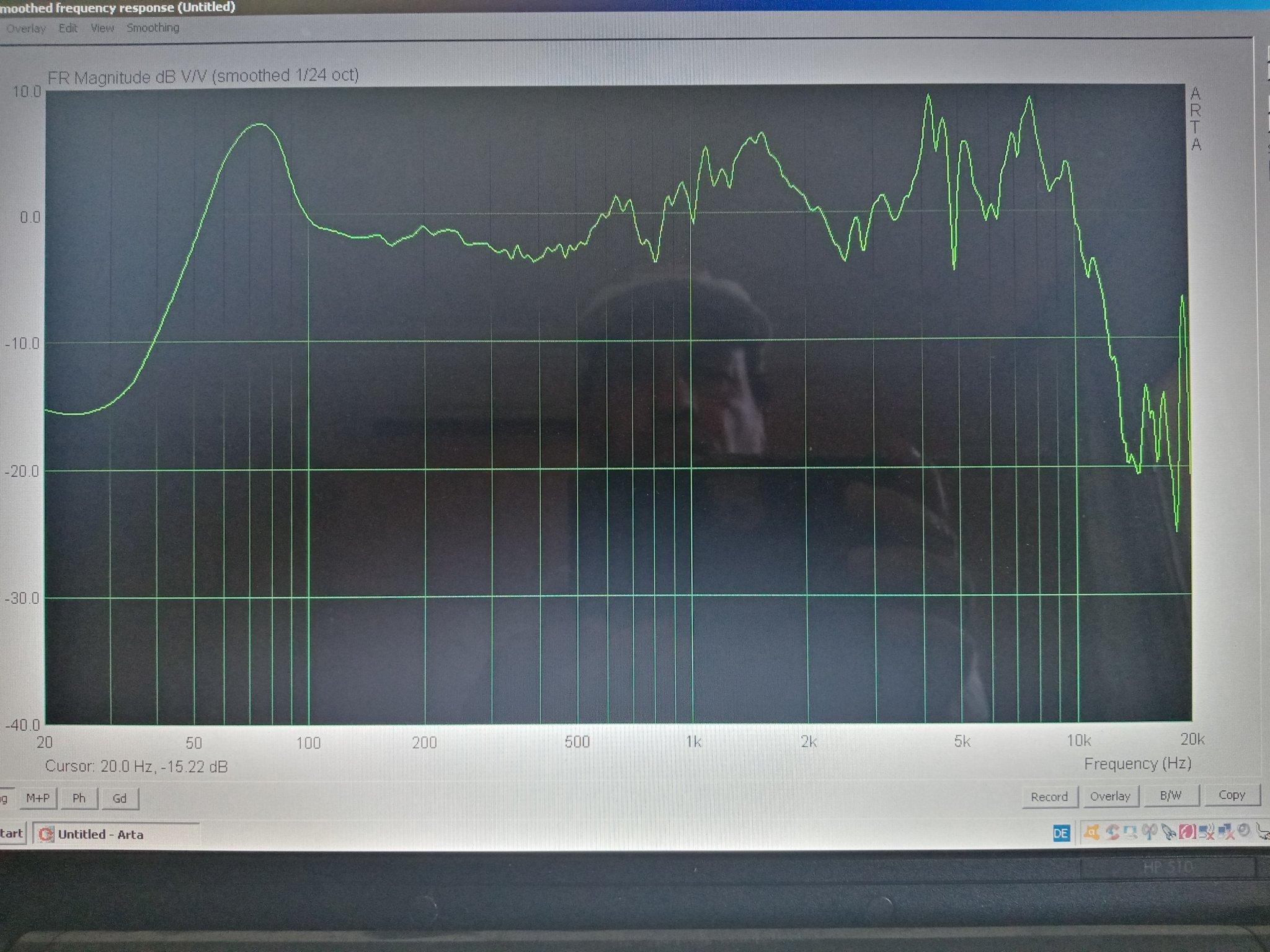

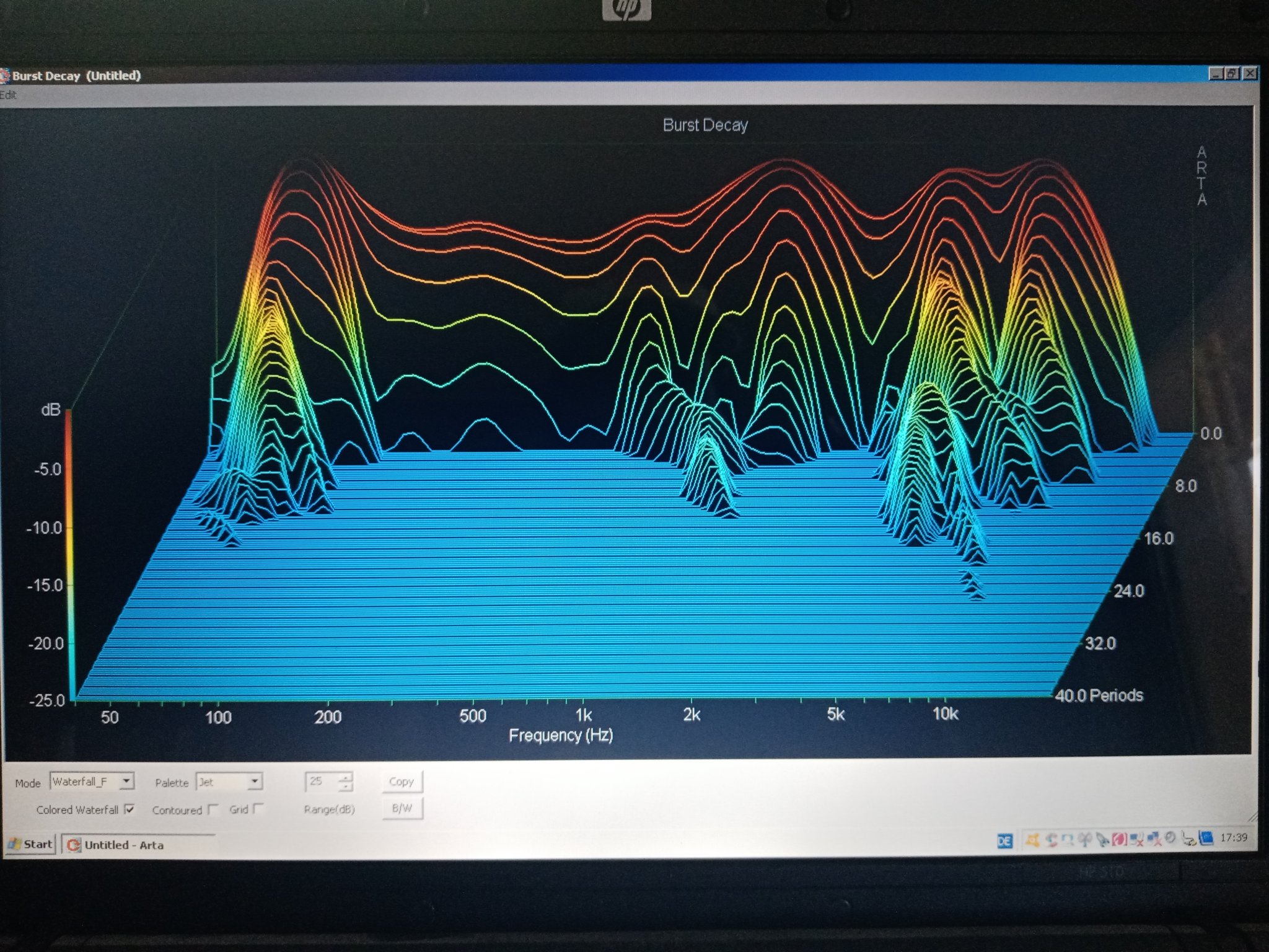

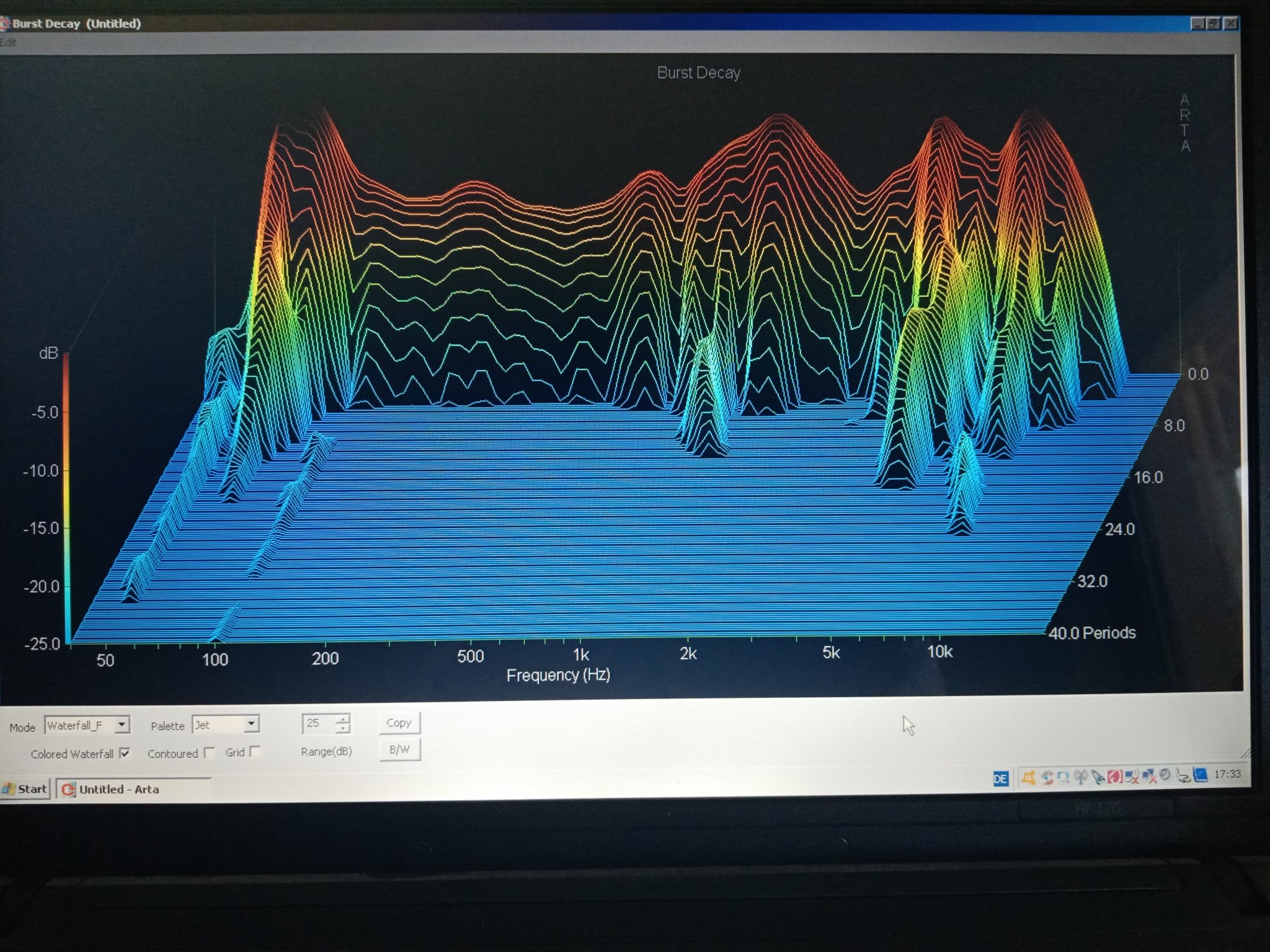

Checked waterfall alternative to "periods".
With my ARTA there is no choice. Only between more frequency resolution or better resolution of the time domain at the cost of frequency response. Nice to see, never clicked that.
Here measurement same driver with smaller whizzer cone.
Bigger whizzer extends to 13khz. The smaller one only to 10khz and the frequency response is less smooth. The bigger whizzer seems to contribute to more dispersion of the mids.
Interesting waterfall with better time domain resolution it's easier to read.

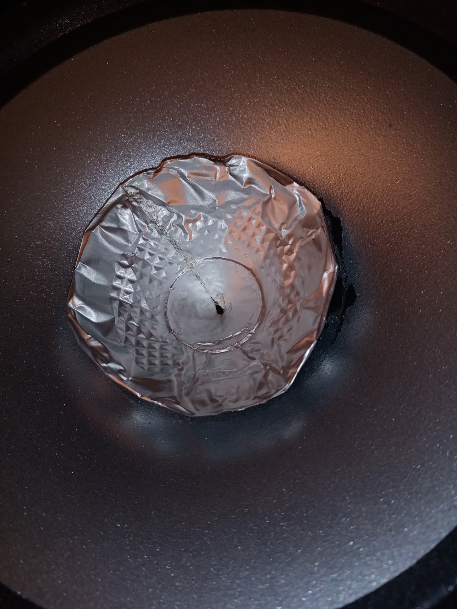

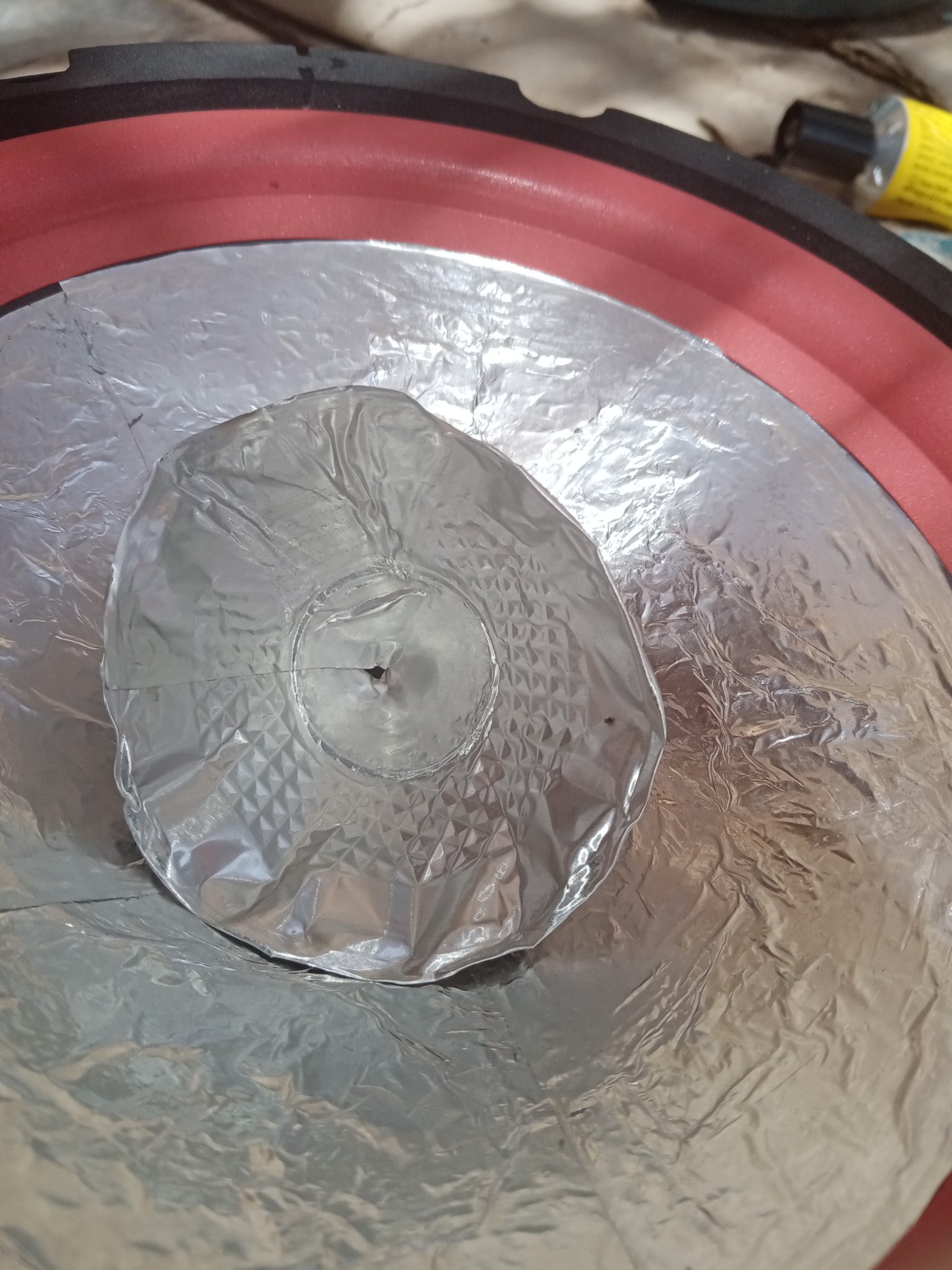

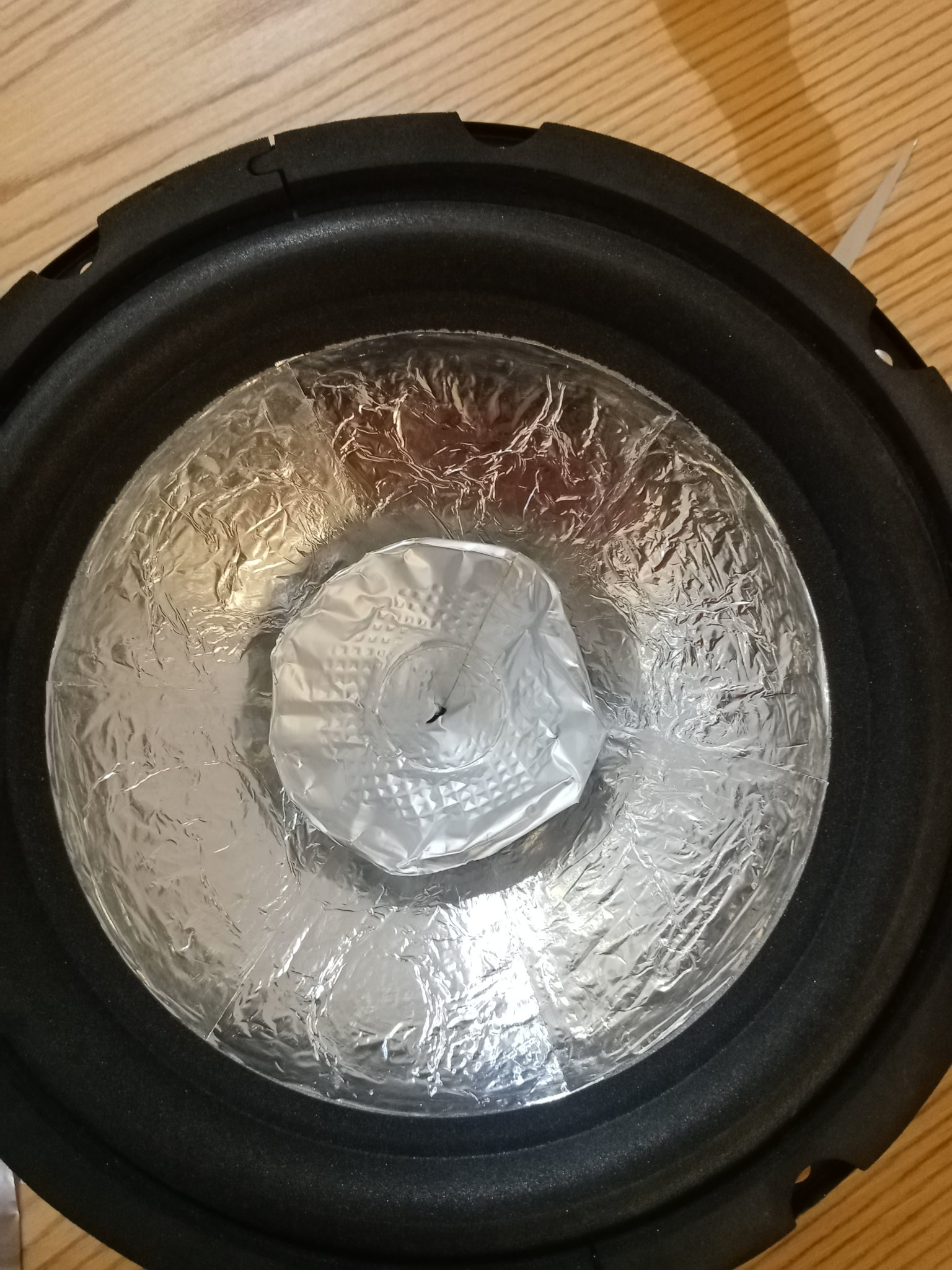

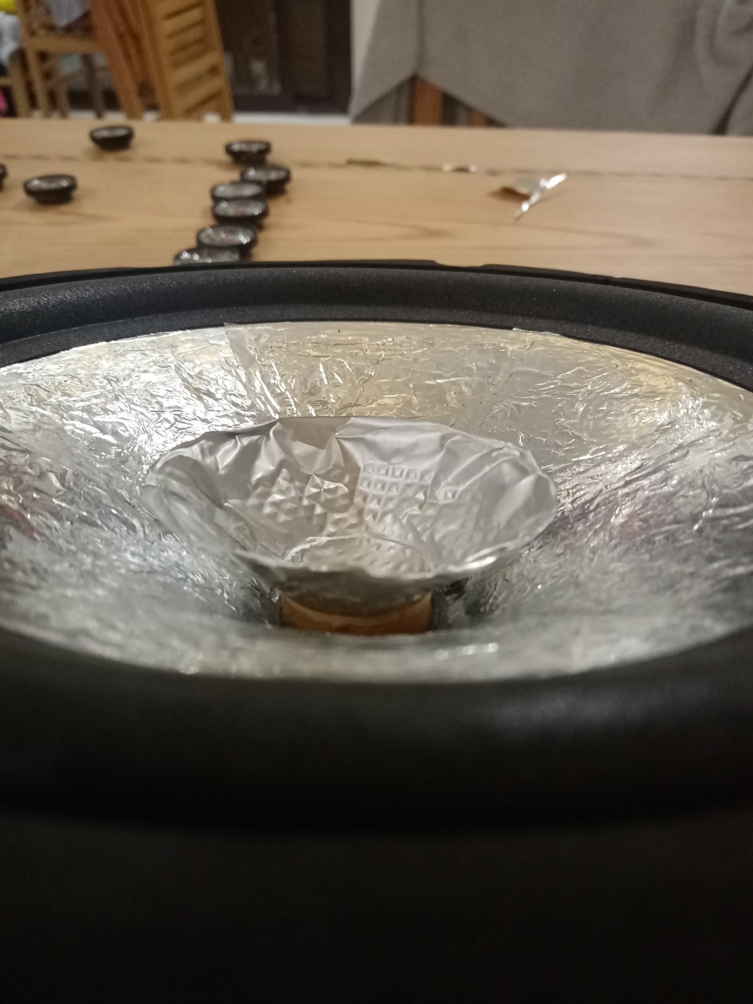

These drivers - although very affordable - offer decent quality. I am really fond of them giving
mellow suspension
ventilation behind the yellow spider
low loss foam surround
together with the tweaks its acoustically a fine driver sounding far beyond its quirky diy look

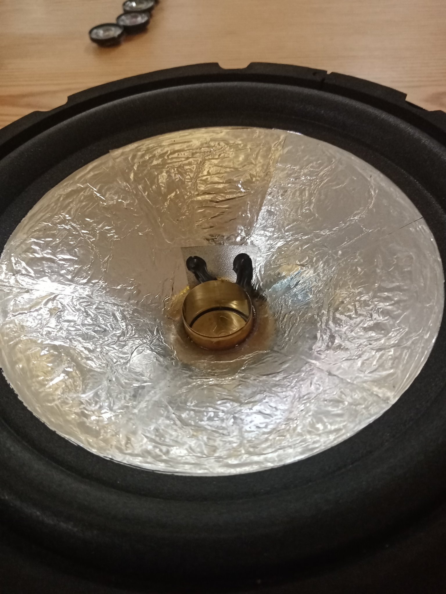

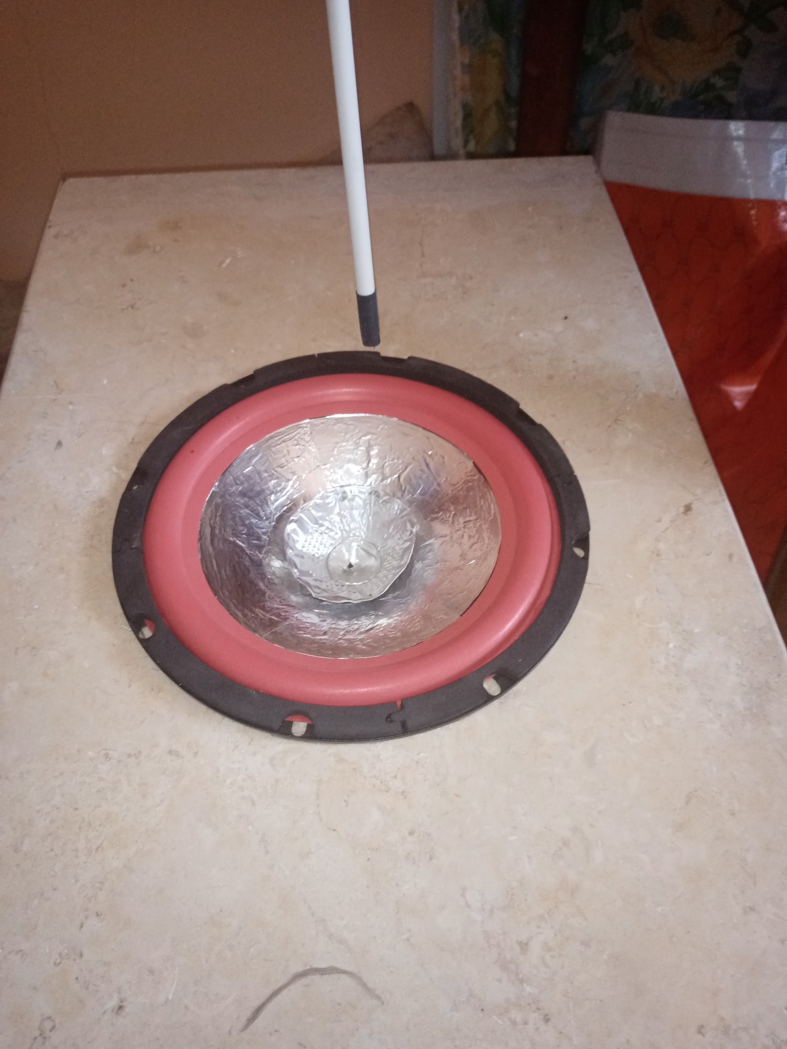

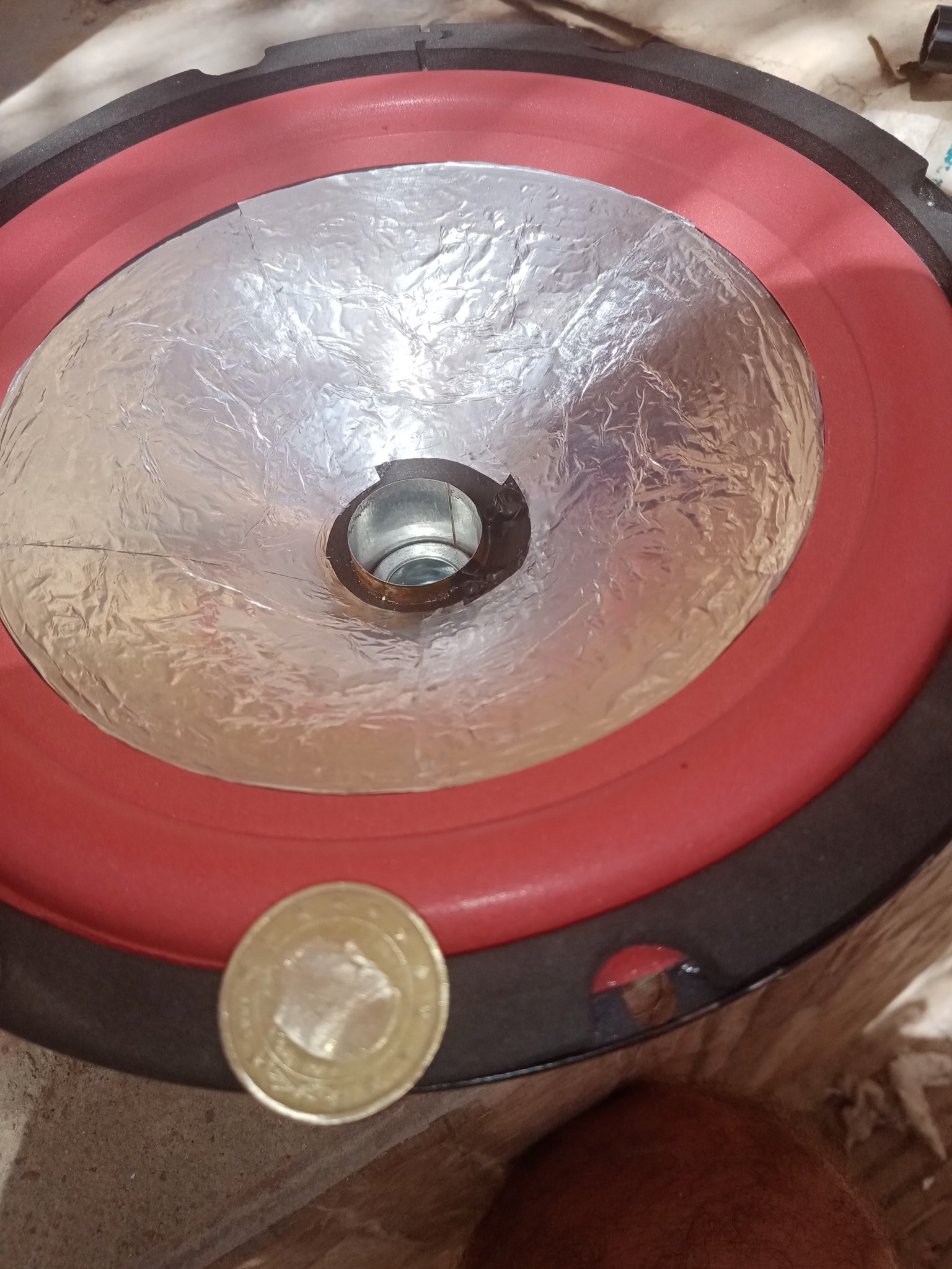

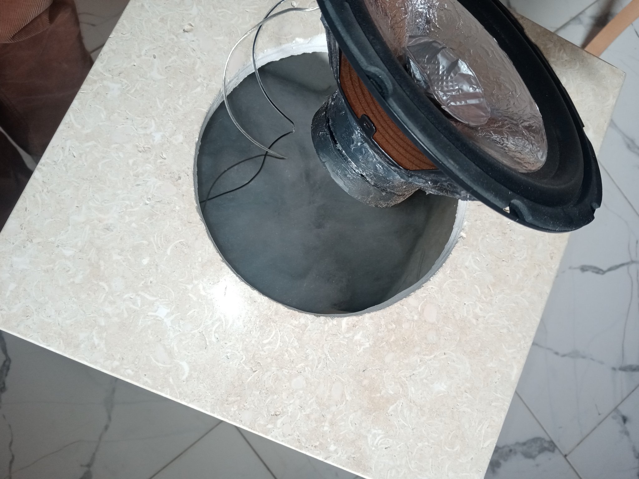

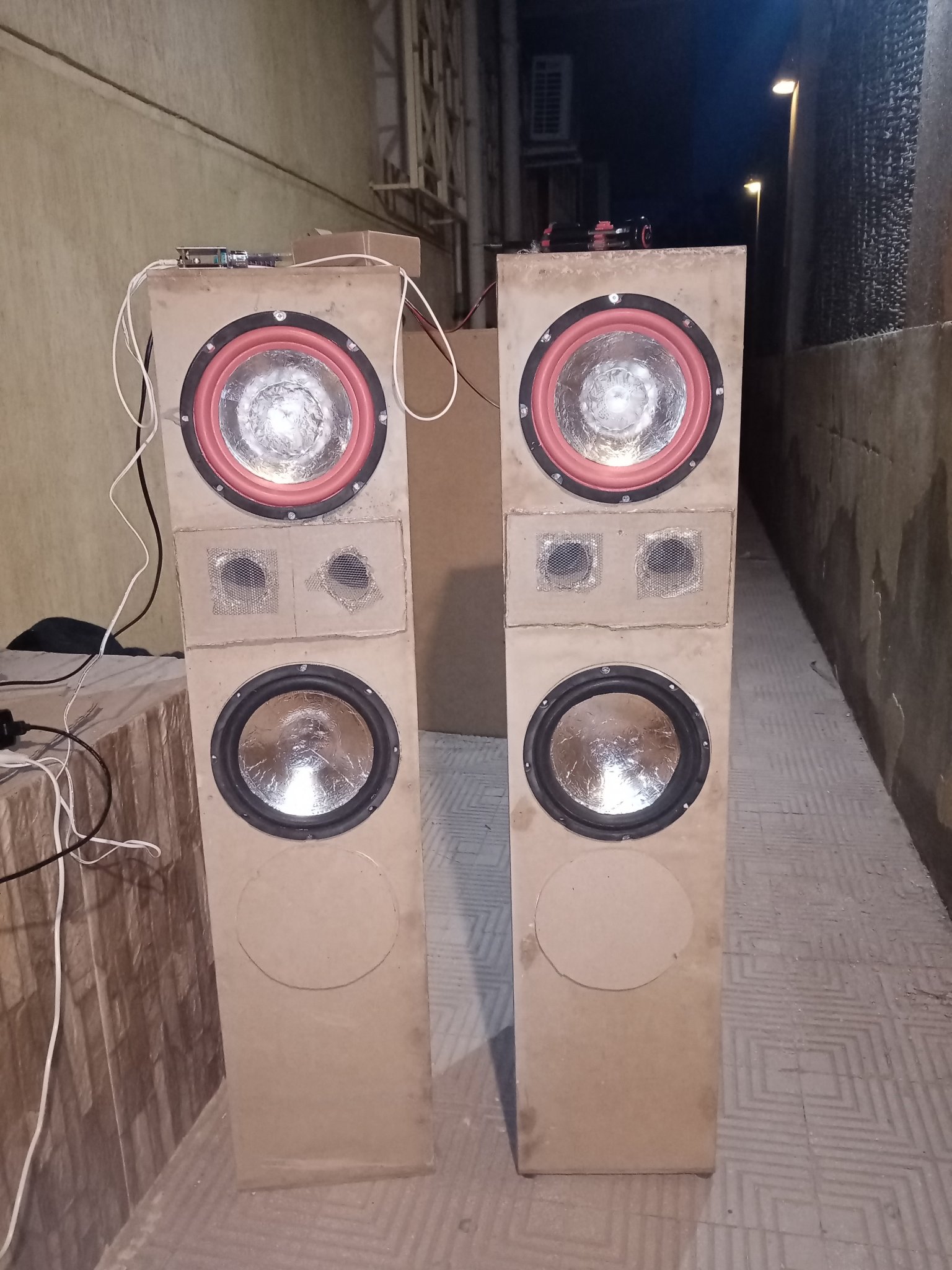

just added two more slits to the double cone (and glueing) exploiting the headroom of the amplifier for adding more highs. (502 MT mini bluetooth amp Whuzi Audio).
Fully turned up there was still a bit too much highs and trading this for more damped whizzer cone area.

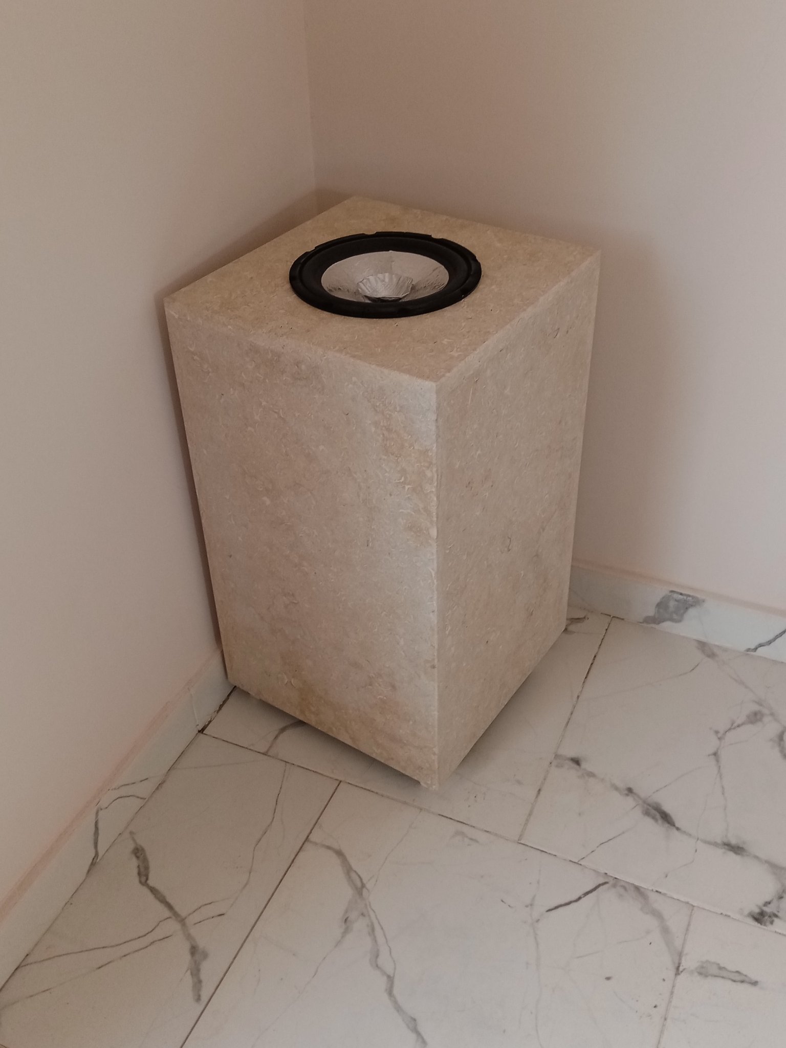

Up firing loudspeakers usually need off axis added tweeters (see Sonab type speakers).
I prefer to use amp power and EQ to correct the frequency response.
Decent result keeping point source advantage.
The up firing loudspeaker makes a nice big soundstage but still it sounds detailed and tonally correct due to naturally good step response of a real fullrange driver.
example classic sonab concept:

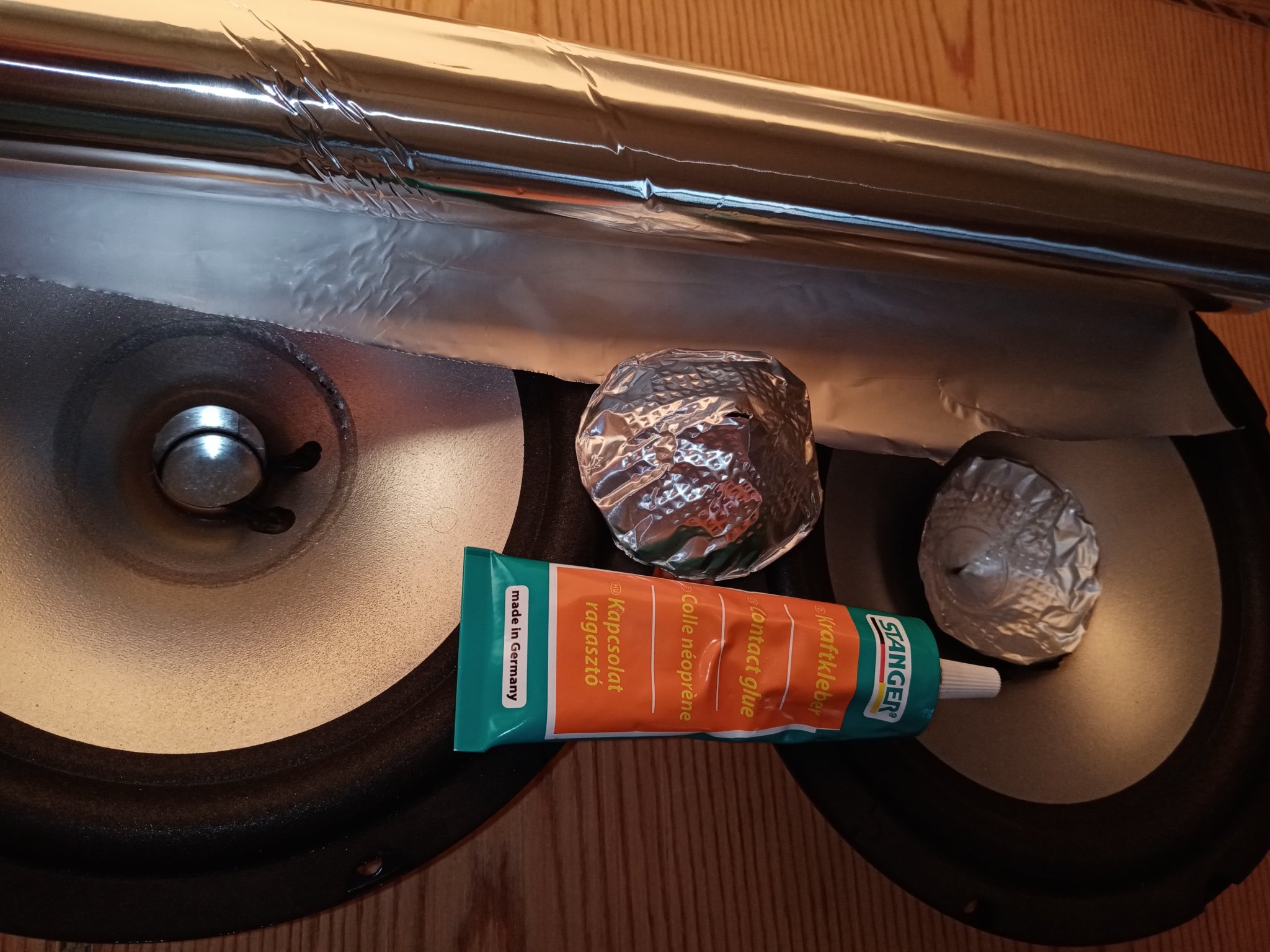

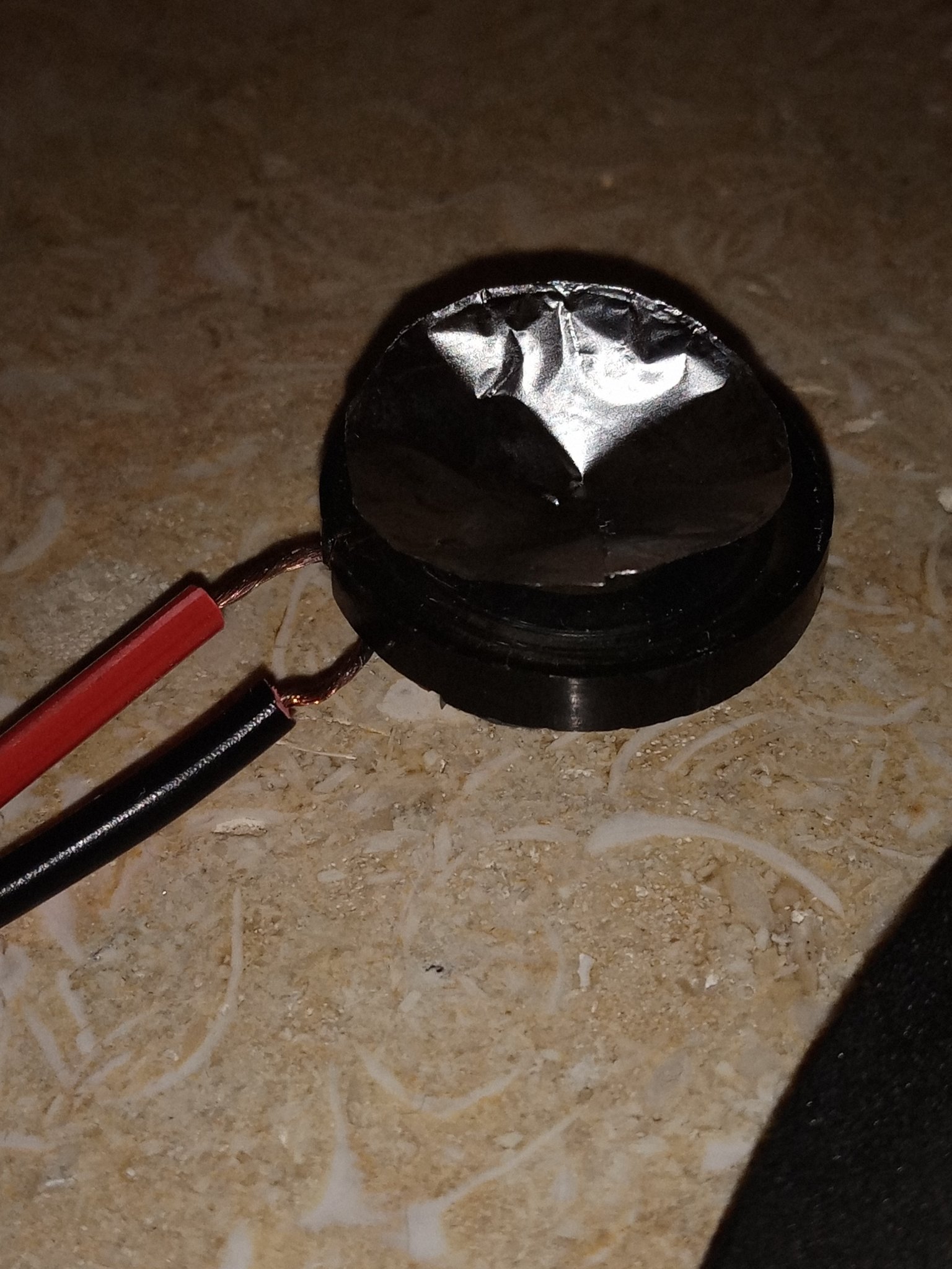

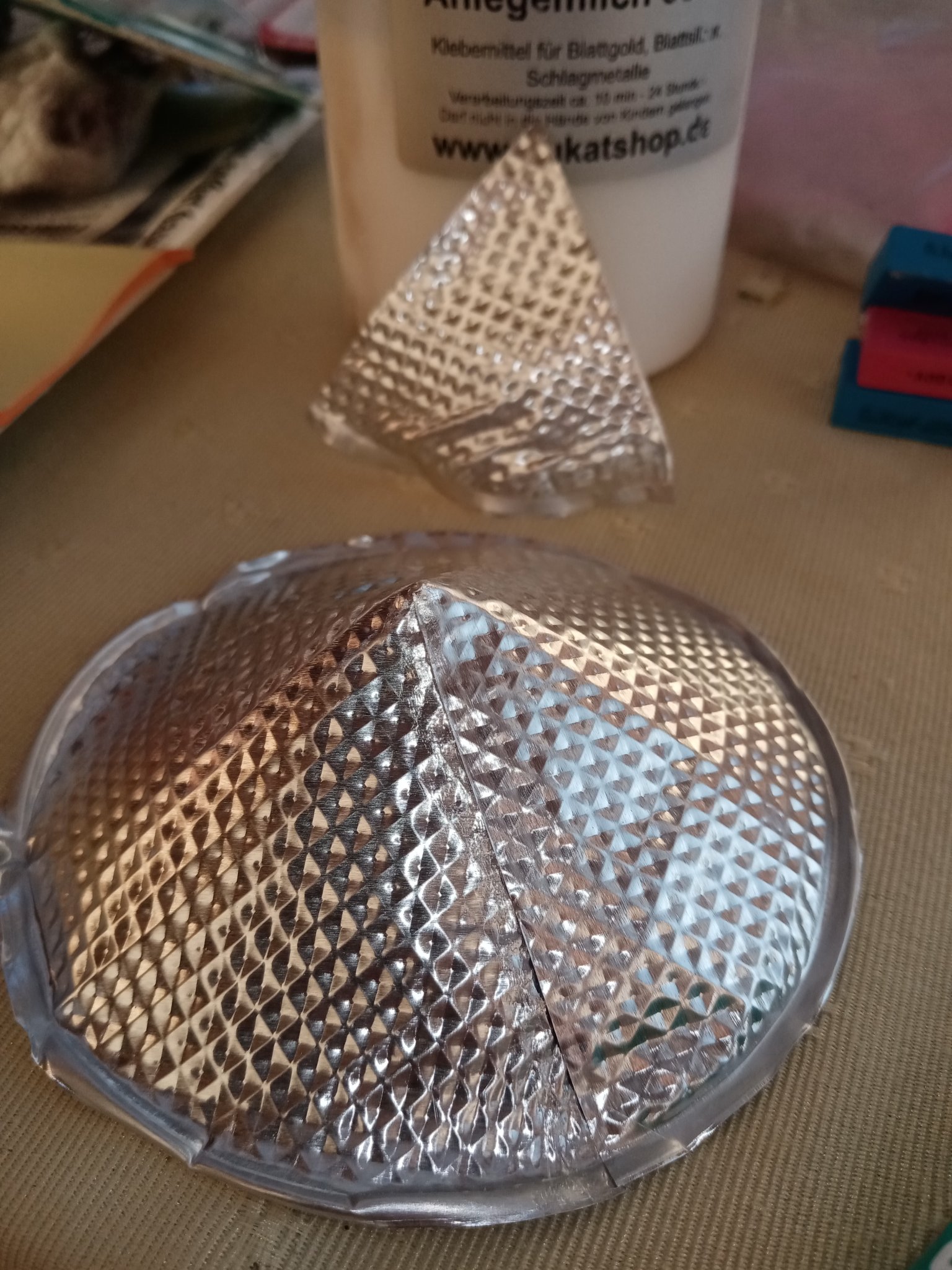

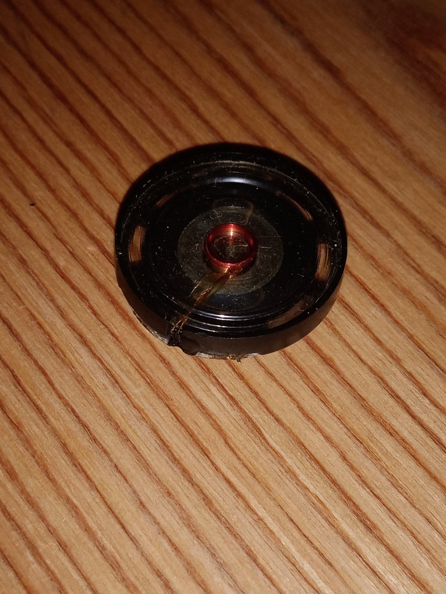

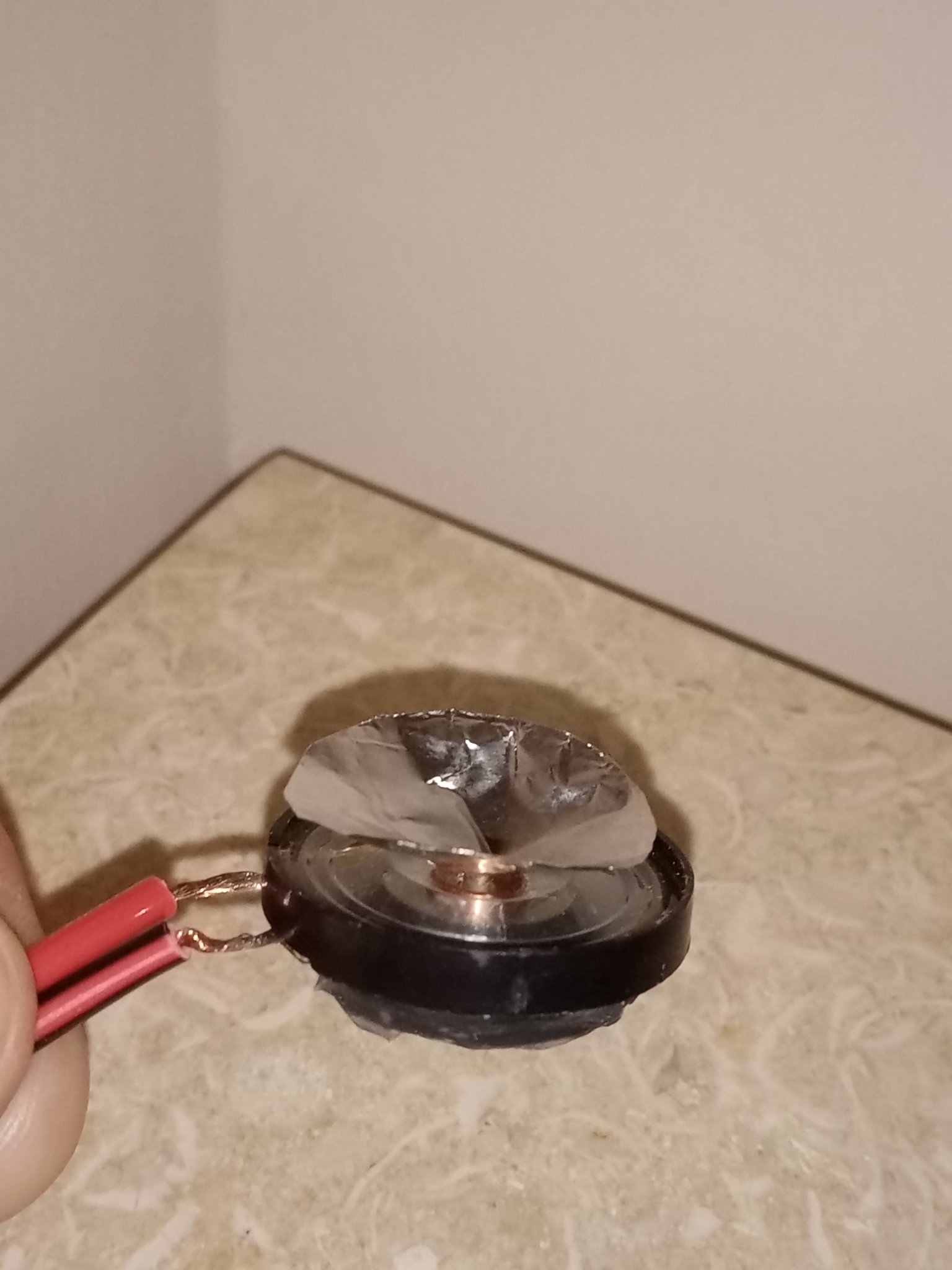

test of whizzerizing a tweeter (!)
On listening this performs good.
Just cut a round puece of foil, take a segment out and glue together and on.
Thats the raw tweeter (its a mini loudspeaker with closed back side with silicone seal)
Don't ask for measurements, this is pure fun testing a diy tweet for an omni loudspeaker
As the construction is lightweight only a drop of glue fixes the foil
Reactions: stv and wchang
The mylar tweeter alone has a soft sound, it has its characteristic sound signature giving a "nice" presentation.
With the metal foil the diy tweet gets attack. And its much louder, must be due to the triple surface now radiating.

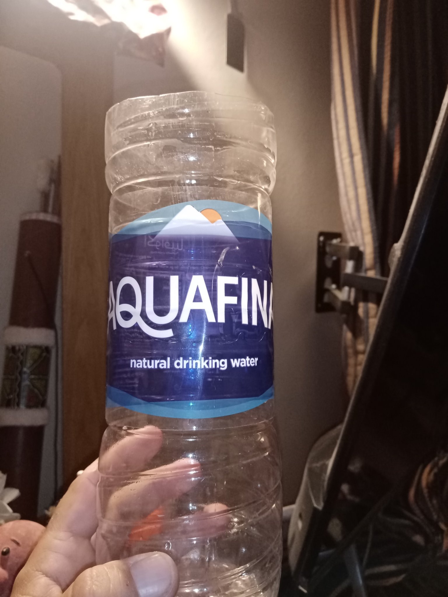

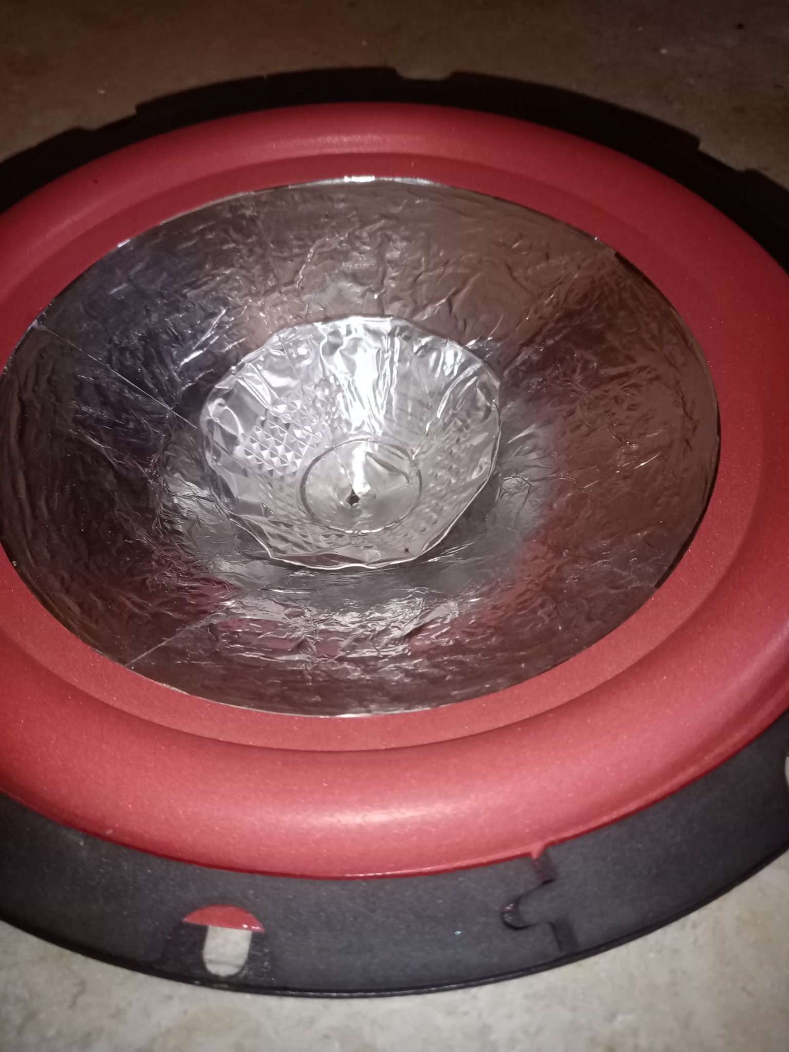

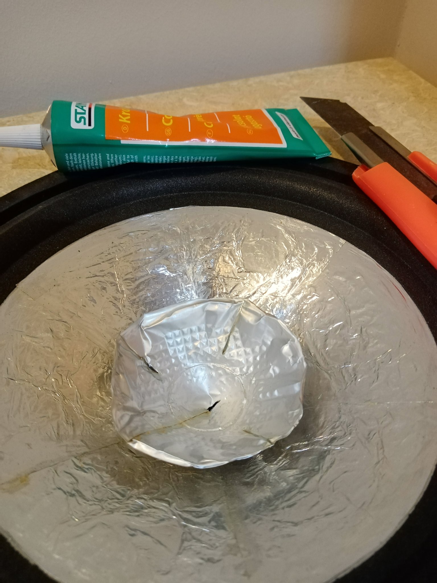

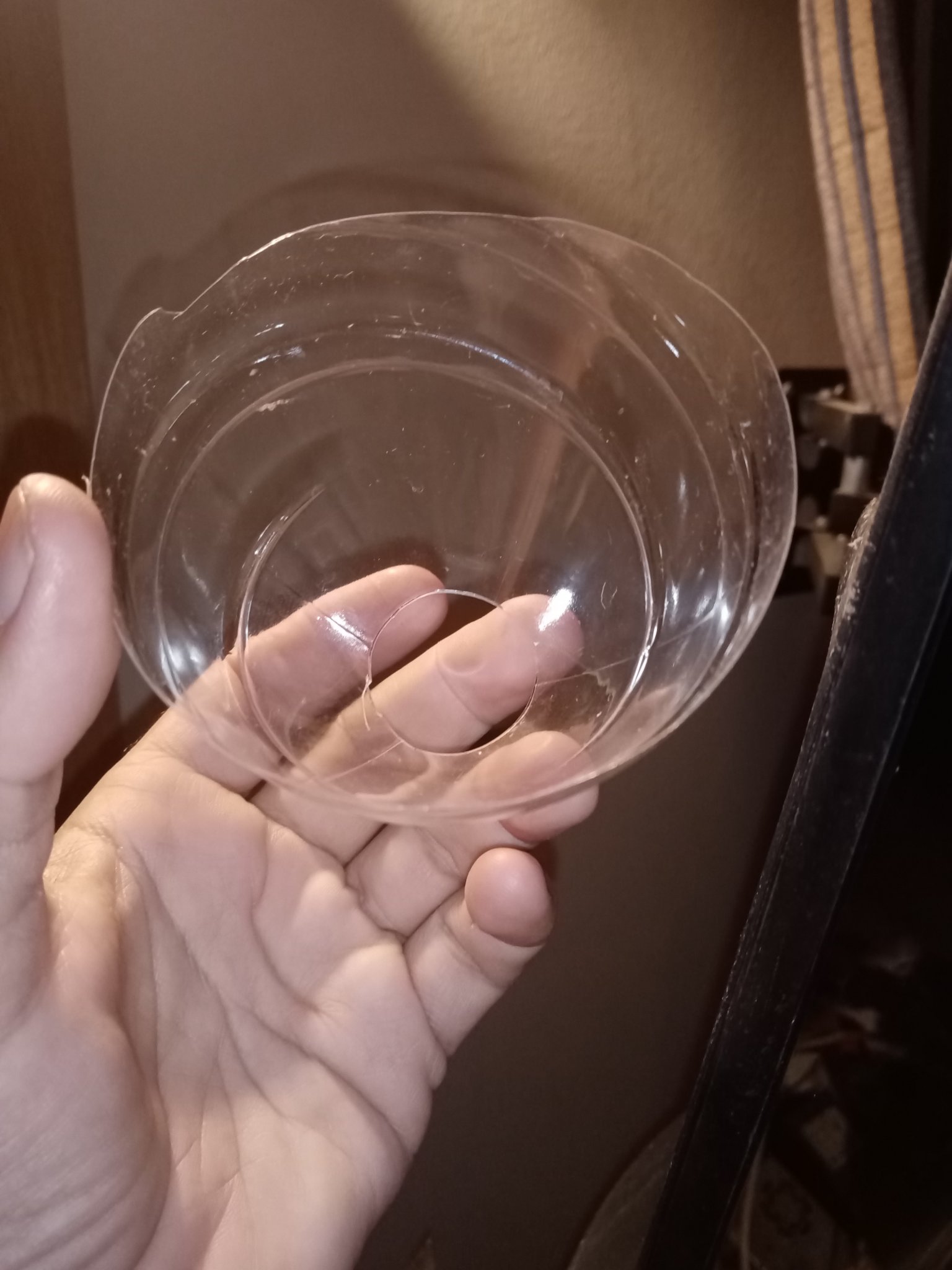

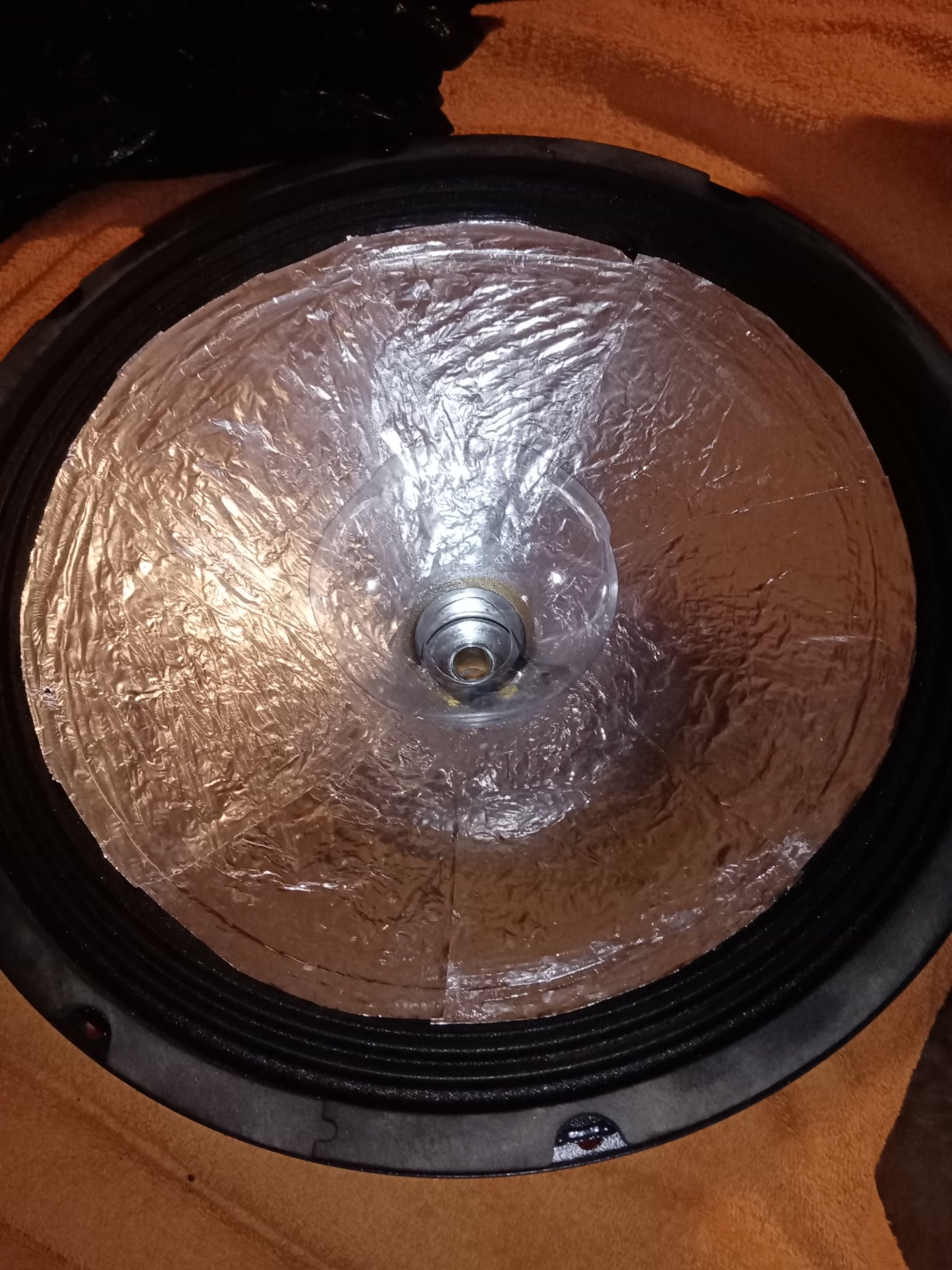

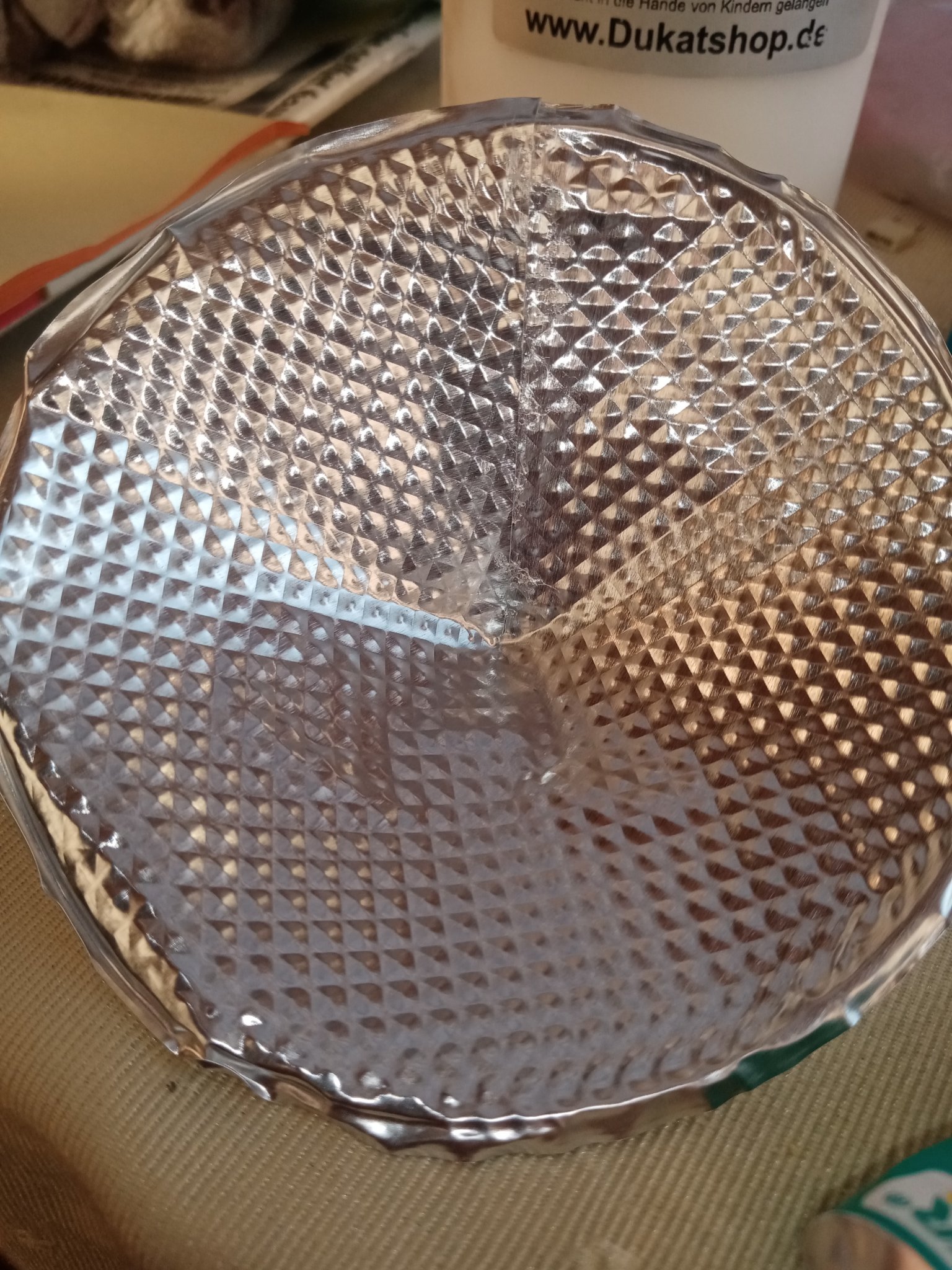

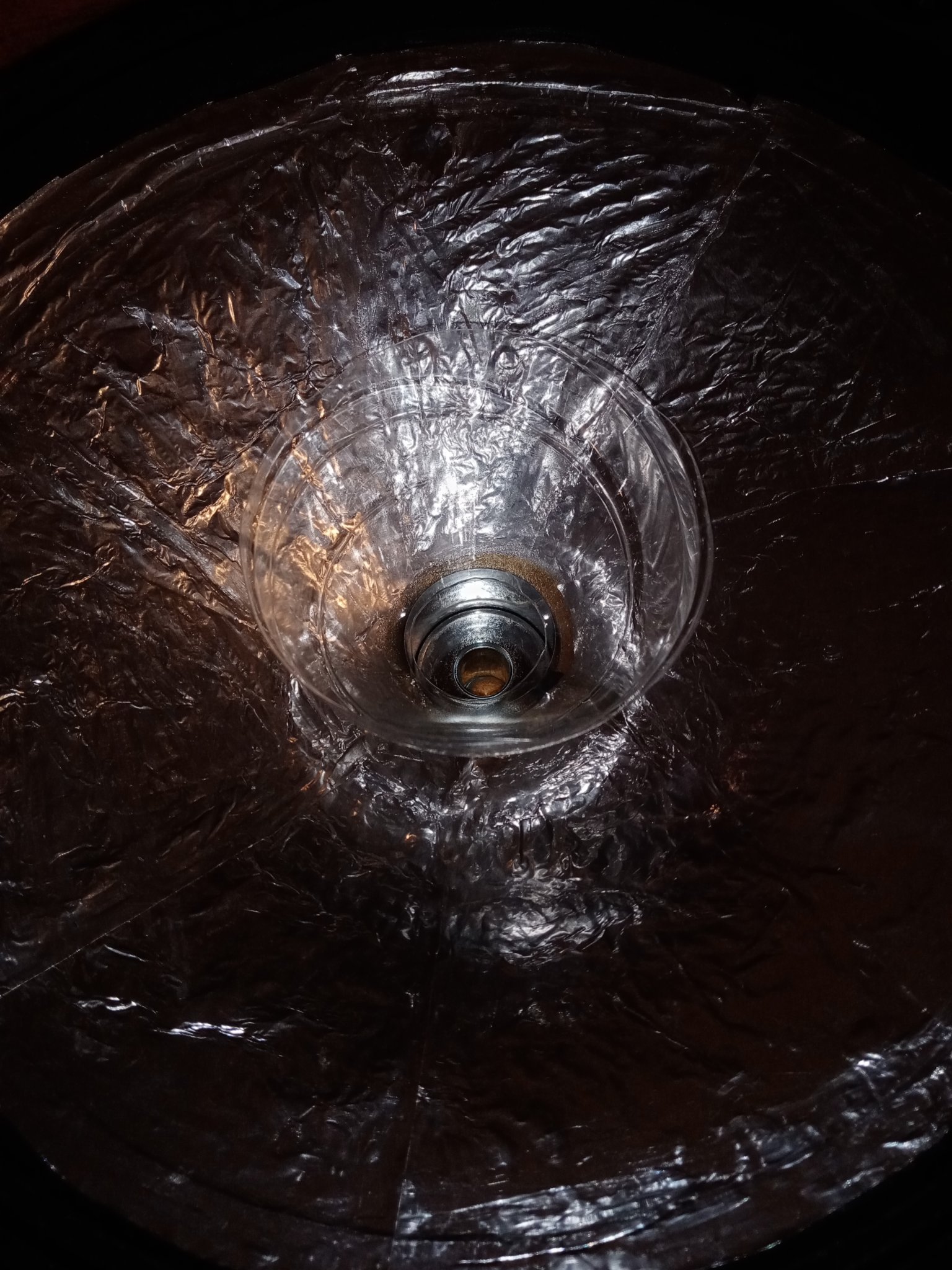

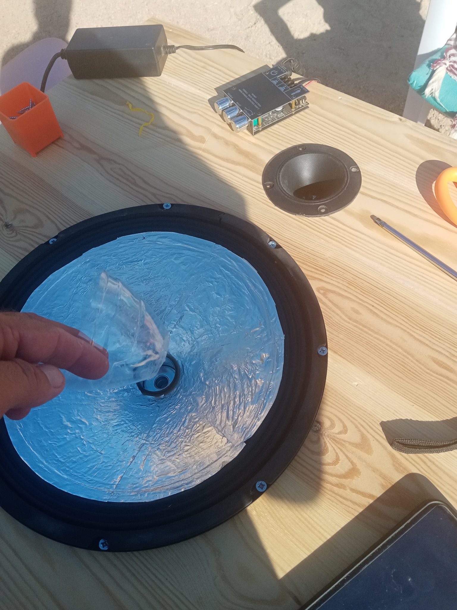

Preparing a 30cm bass driver for conversion to a fullrange driver. It will get a plastic whizzer cone from a bottle I will try it.
For above 5khz there will be a piezo driver.
The transparent design is attractive.

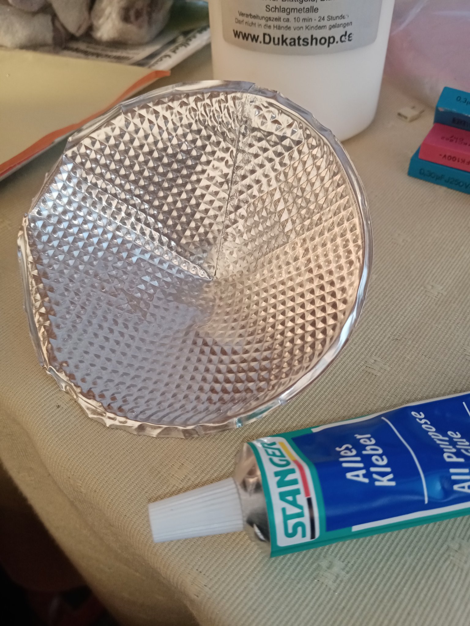

Will use a part from a bottle where the upper part is structured giving stability for free. Big difference to unstructured.
Its polypropylene, so sonically it should not ne bad.
for comparison the unstructured
I will use silicone sealant as I do not have any other glue at hand.
But it will work.
The whizzer will be neatly fitted to the voicecoil - the smaller the gap and thinner the bonding film the better it will be.
This silicone will be used:
