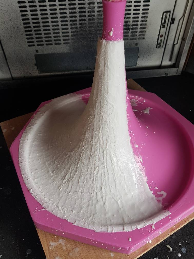

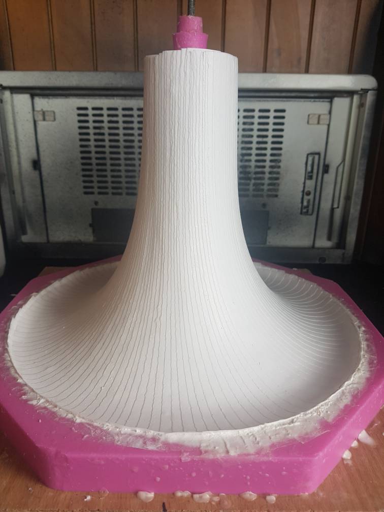

Thanks, i'm using all my knowledge and energy at simplifiying the paper mache process in order to make all the existing horns for few bucks.
DIY Paper Mache Horn - The Paper Horn by Inlow Sound
My last horn (this morning) jump by itself from the mold at the end of the drying process (without any chemical product) and each prototype overall is cost less than 5€.
The horn is ready to use 12hours after the paper deposit (with takes around one hour) and the mold don't need any finish in order to have a perfectly smooth surface.

I've also been making paper horns.

What is your process?
Paper mache horns. - DIY Audio Projects - StereoNET
Paper machè horns.

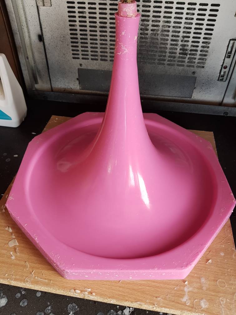

I put a nylon stocking and a balloon on the raw plaster mold, the finish is perfectly gloss and the horn jump by itself of the mold when you cut the nylon stocking.
Then the solid paraffin coating is fast, it allows to do the entire process within 24 hours.
Disclaimer : this is not (only) a joke, i've also used fast PVA glue (+20% of distilled water), it don't adhere on the ballon surface.

Until the plaster molds are dry, you can exercise yourself on a Champagne Jeroboam (3 Liters, you should not drink it all at once because you will suffer from uncontrollable eructations)
You can click on the photos in order to see the details.
The nylon stocking and a balloon on the bottle
The paper deposited
My horn is 550hz LeCleach. Unfortunately a balloon wouldn't fit. You have a very good idea. How many layers do you use?

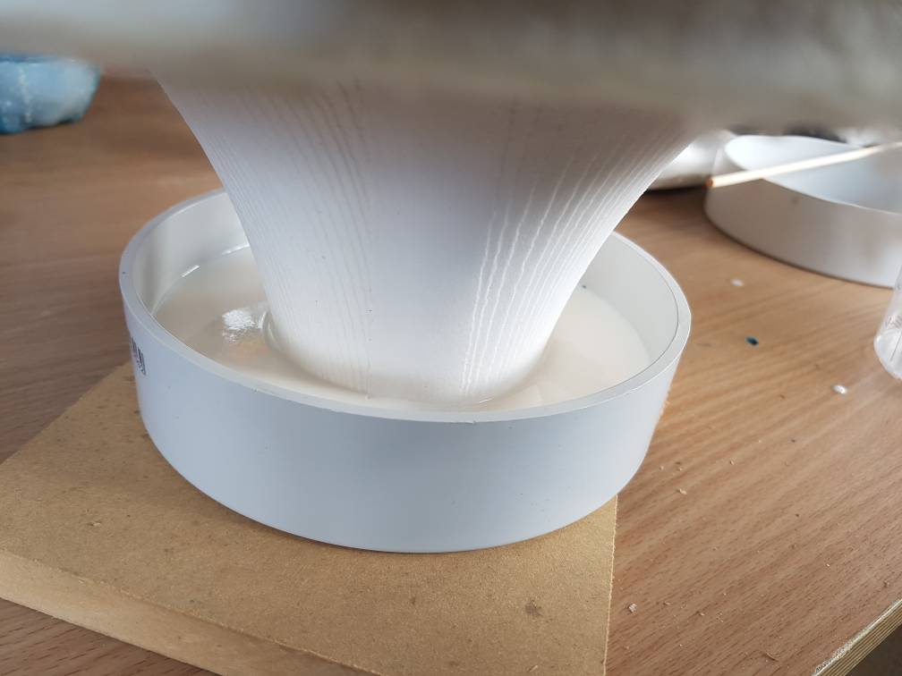

Four layers gives me around 1mm of thickness, after that i put a hot layer of parrafin on the outside (around 2-3mm)... 0.1€
You need to glue the balloon on the mold with some liquid latex for the LeCleach profile 😉 thoses i've used for my molds are 0.2€ and the nylon stocking is 0.6€
Your technique is quite impressive and your mold is beautiful, for my project i try to stay under 5€ (grand total cost for each horn)
I try not to think about a budget [emoji31]
My current horns are 14 layers thick. About 5mm at the mouth and 20mm at the throat.
