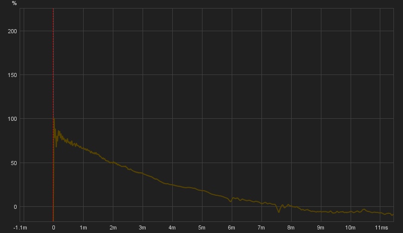

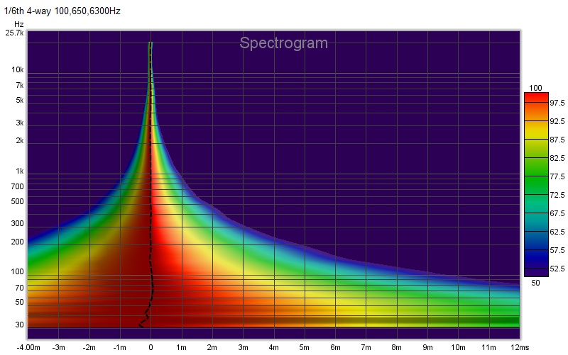

Another FWIW....an example of why I keep trying to encourage folks towards FIR and lin phase....
here's a 4-way's step and a spectrogram ....

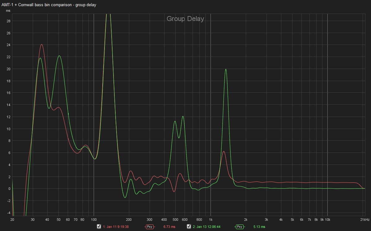

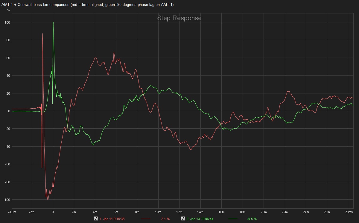

I'd like to illustrate the effect of using delay only (like moving the HF driver backwards) on the step response. The plot below shows an ESS AMT-1 on top of a Cornwall bass bin, both time aligned and with a time delay equal to 90 degrees of phase lag at the 800 Hz crossover frequency (312.5µs) or about 4.25 inches (10.8 cm) of set back of the AMT-1 relative to its time aligned position. The red trace is time aligned, and the green trace has an additional 90 degrees worth of time delay added to the AMT-1 (HF) channel--the red trace is offset by -1 ms for clarity:
The point is that simple time delay offset can mimic a perfect step response, but with the added price of greater group delay above and below the crossover frequency (red = time aligned, green = 90 degrees HF phase lag time delay at 800 Hz):
Chris

This is definitely not a perfect step response. I would call it an improved one.

I'd say the 'time-aligned-only' red trace in your first graph that I didn't repost, has a clearly superior step response ... although the time alignment still needs some small adjustment.
I do not see a significant greater group delay with the red trace in the Group Delay graph above...red appears to look much better...???
Green's phase trace must look really wonky....can you show it?
FWIW, I've found that using time alignment via peak energy times gives me similar rapid oscillations in a step response, prior to the step settling into its desired triangular shape.
Time alignment via intitial rise time (found using bandpass filtered impulse responses) usually cleans up the 'pre-step' oscillations.
