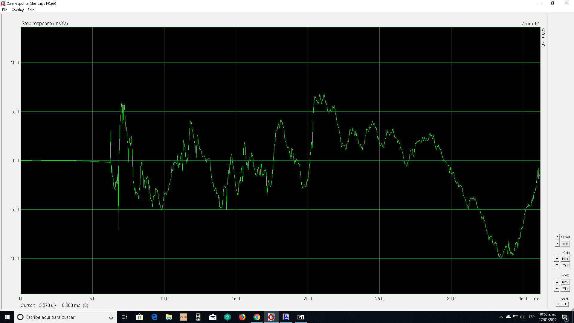

Your present step response can actually be read: <snip>
Is enough Chris?
Apart from that unexplained negative-going spike your step response looks quite reasonable for that crossover. There is the positive peak from the tweeter, followed by the negative-going part of the midrange after approximately 150 us and again the positive-going response from the woofer after about 700 us.
The only strange thing is that negative spike. The raggedness comes from reflections and diffraction.

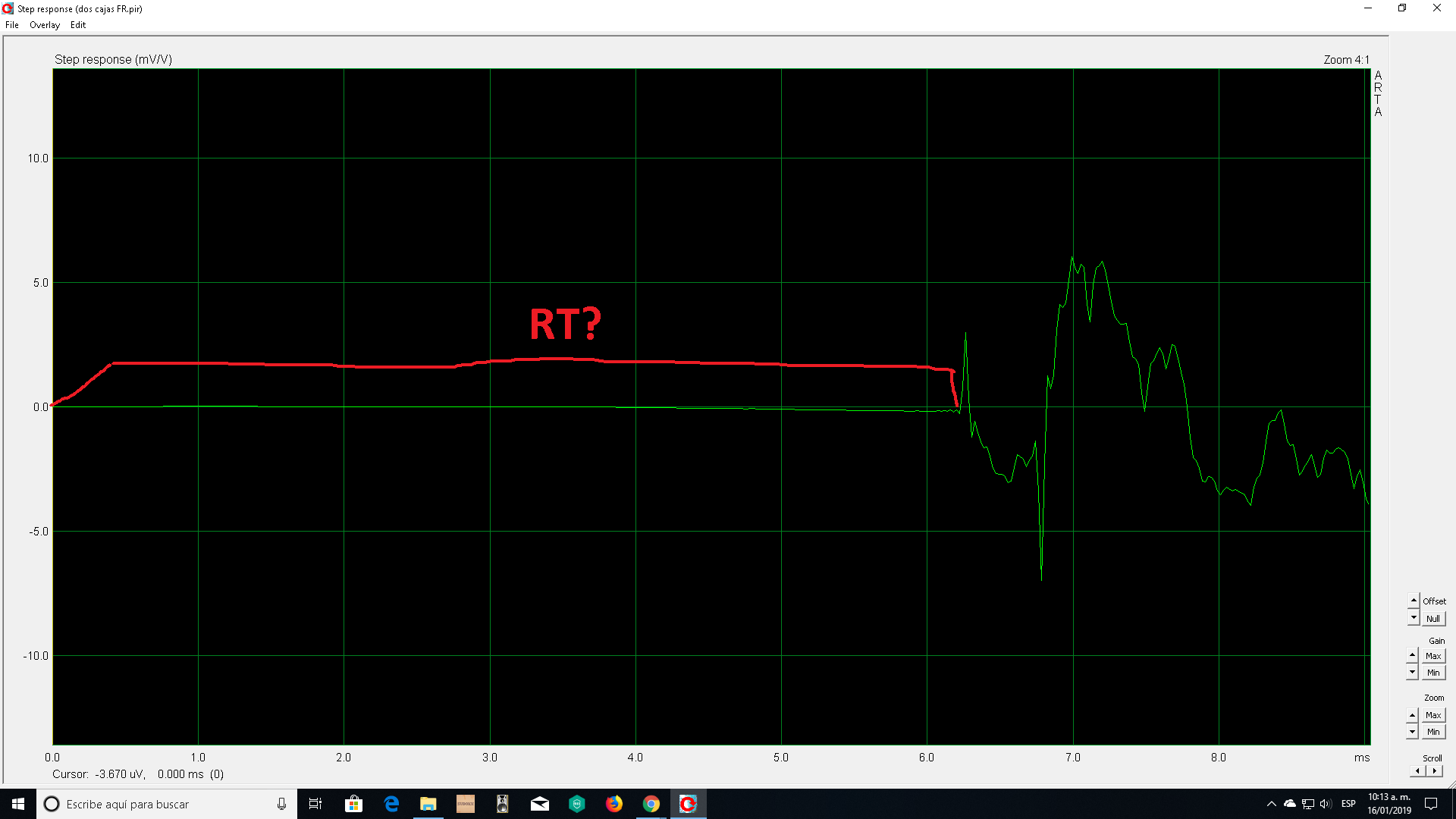

Maybe if the OP could share his frd and zma files, we could take a crack at it.
Also, what is the step response from the XO in XSim?
Attached FRD & ZMA files with step response of Xsim.

Be careful when making conclusions like this. You may make a misinterpretation easily.
Do you live in a cement square box?
Yikes!
Even though there might be ways to clean up the XO, your room needs a lot of treatment before attempting to fix anything else.
In this case, the room is much more the culprit than any XO you can come up with.
Yikes!
But my conclusions are quite close to what the maths predict for this crossover. You may be correct for my conclusion regarding the ragedness because the drivers themselves can also be guilty.

I believe that moving the tweeter back in each case by 25 cm will do a lot to close that step response down toward your desired (perfect) response.
I will second the comment about the noisiness of the room's portion of the step response by adding some absorption and perhaps diffusion, as well as adding extra absorption on the floor temporarily from the microphone to the loudspeaker and about 2 m wide--like a blanket, quilt or thick sound/thermal insulation material. I've found that this really helps with capturing the phase response of the loudspeaker.
Just as an aside, I've found that the impulse spectrogram view shows even more in terms of impulse response--for instance, a Cornwall spectrogram showing the effect of the long midrange horn/driver relative to the tweeter and direct-radiating woofer, nominally crossed at 4.9 kHz and 600 Hz:
The delay due to the crossover in your loudspeakers will also show similar effects in impulse spectrograms (as evidenced by the present step response), although probably less pronounced than the above at about half the time delays shown, plus a smearing of the HF tweeter energy due to that negative-going pulse so soon after the direct arrival pulse.
Chris

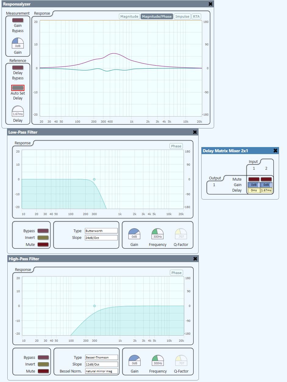

Here is an excerpt from the Harsch crossover thread:
Chris1. Set the low pass filter for the woofer as a 4th order Butterworth at central frequency, fc for the XO centerpoint.
2. Set the high pass filter for the tweeter as a 2nd order Bessel at fc.
3. Set the delay of the tweeter equal to 1/2 of the period of one cycle at fc.
4. Use all positive phase on woofer and tweeter.
It was confusing to me because I never saw you state a harsch crossover. And sure, a harsch is a special case of crossover using mixed types and orders, that also utilizes delay.
But using delay can't be generally extrapolated to compensate for 'phase growth' (assuming that's the phrase you've coined for increasing group delay?)
For example ...take the most commonly used crossovers... LRs or BWs. Certainly delay is not used to compensate for group delay using these....no matter what the order.
So it seems highly unlikely with regards to the OP, that he needs delay for the purpose of compensating for group delay ... Delay for physical alignment, sure......
FWIW, I've attached an example of the harsch at 300Hz, just for any interested...I had never looked at one, being so entrenched with with lin phase. Harsch looks pretty neat if you can live with the low order low pass.
