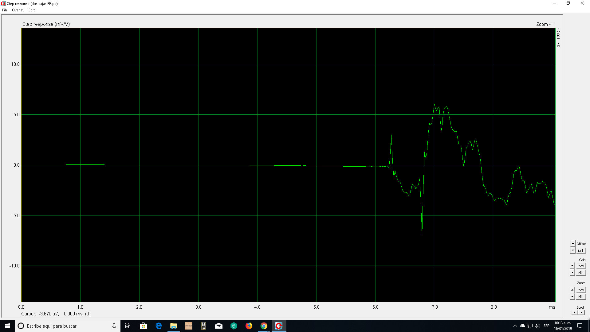

How to improve step response of a 3 way system.
Target:
Attached measurement

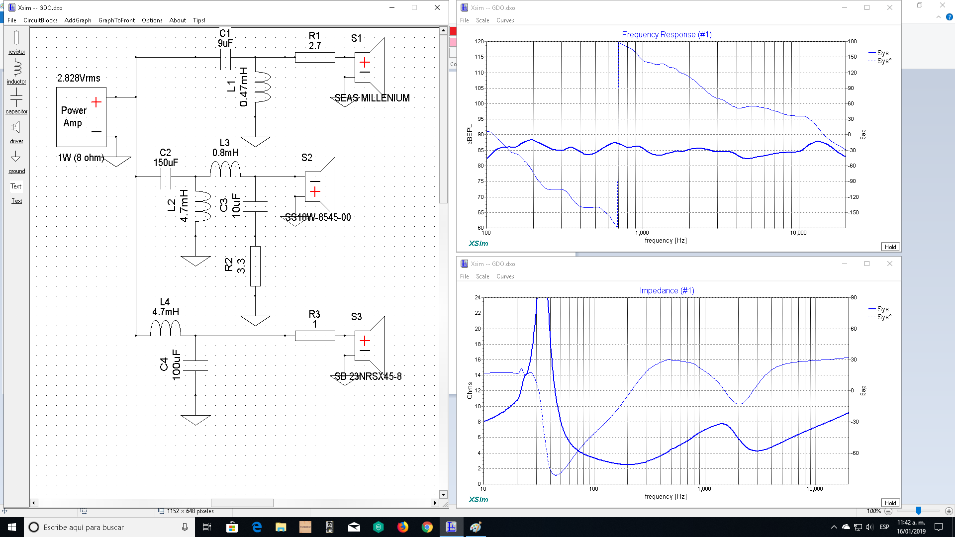

So if you want this, you need 1st order Butterworth acoustical roll-offs from the combination of driver responses and crossover and time alignment to the listening position.
Good to see your xover, but that's not tell anything about the individual drivers acoustical roll-off.

Your present step response can actually be read:
It really helps to have a picture of your loudspeaker in-room under test with all the nearby surfaces and microphone position in order to fully understand what you've got.
But as a stab in the dark, the following are guesses:
That initial spike is your tweeter's response, then the negative going one is the reflection of the tweeter's output off of something that's ~3.4 inches (8.6 cm) greater distance from the direct arrival path. I would guess it's the reflection off the back wall, but it could be other geometries. I would assume that you're using something like a dipole tweeter in order to see such a perfect negative-going spike at that...but I could be wrong.
The next pulse on the step plot is probably your midrange following at 10.9 inches (25.8 cm) of total delay, including the delay from your second order crossover network. The next driver (which we may not be able to see on the step response that you posted because it doesn't show anything farther than 2.75 ms from the initial pulse.
As far as compensating for the crossover network delays, you can move the tweeter back 10.9 inches to get approximate time alignment with the midrange(?). The next driver (woofer?), will likely be behind the midranges, but that distance can't be calculated without having more of the step response duration to look at--to the right of the initial pulse.

This step response is a little enigmatic.
I would expect the negative going peak to be from the midrange. But there are two things that speak against it: 1.) it comes too late because the group delay of the chosen crossover frequency would be around 0.1 to 0.15 ms and the peak is too sharp (i.e. coming from a source with too high an upper cutoff frequency).
But it can definitely not come from a reflection of the tweeter signal because it is inverted - except there is another inverted tweerter somewhere (reflections can only be delayed but never inverted).
And the delay of the woofer response at this low/mid x-over frequency should be around .7 ms. This figure would actually fit the time of the negative pulse. But its shape (too steep) and polarity speak against it.
Question: Are you sure the x-over is wired correctly ?

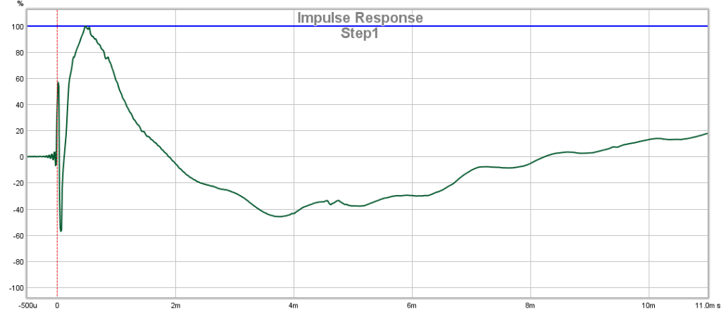

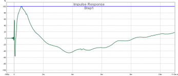

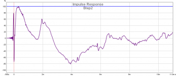

Looking at step response of the speaker, in isolation, is only misleading and does not allow any reasonable evaluation of speaker sound quality. Which one of those is the "best" sounding? What is the difference, in fact, between step_1 and step_2?

OP's measured step includes lots of early reflections, but long delay between first and second peak indicates that something is seriously wrong. First peak is typically tweeter and mid should follow it very closely, now there is almost 0,5ms gap. It must sound strange. Listen close to each driver, are they giving the range that they should? You can also measure response in nearfield 1cm from each driver.
We need info about the construction of the speaker and measuring conditions. Crossover might have a mistake too. Someone experienced should see it and take more measurements, at least with midrange inverted.
I'd say the first one is from a single, very well-behaved driver in an open baffle or closed box (i.e. a minimum phase bandpass). And if it is from a multiway system it is definitley one with a crossover that doesn't have any phase distortion. Nr. 2 is most probably form an LR4. And Nr 3 could be the same but with lots of room reflections.
