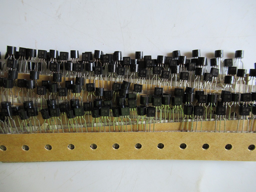

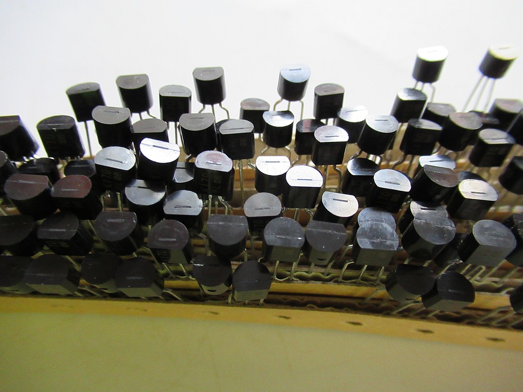

Genuine Tosh jfets have a line - maybe 2mm long - going sideways in the middle of the top. Fakes (strangely!) don't seem to.

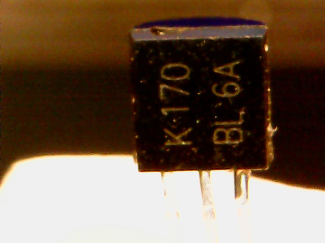

If 2SK170BL IDSS is out of Toshiba datasheet value - it is 100% fake, I measured more than 10000 of 2SK170BL and have never seen even one JFET out of range really the values I saw are in range 6.5-11.5 mA.
Yes, I noticed that you wrote that in an earlier post, and I have no reason to doubt your measurements. I’ll borrow a calibrated vmm from work just to make sure my measurements are correct. Also a dual psu in case I want to measure Vp

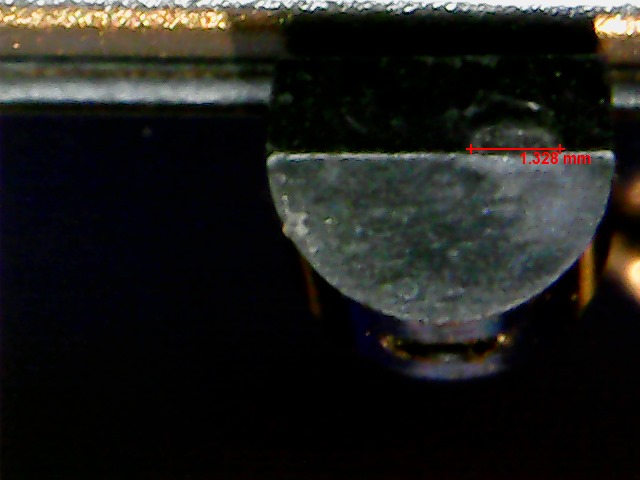

Here are two pictures through a USB-microscope of one of the transistors. It doesn`t have brownish spots, something with the lighting I think.

I sent the picture of the genuine jfet to the seller. He said that anyone could have made it, and that it proves nothing. Anyone know the source of the picture?
He offers a new set of transistors with IDSS in the BL-range. He will not send any pictures of the transistors, and it seems to me that he measures IDSS, nothing else. I could ask eBay to step in and try to get my money back, or I. ould get a new set that is likely fakes as well.
