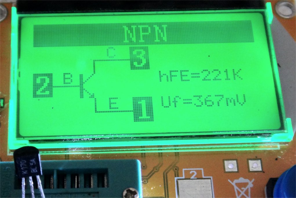

Fake semiconductors are routinely sold on eBay. So fake that even a Chinese tester can be used to detect an "outside the datasheet" issue like here, gate leakage current (~10nA).

Hi Aridace
Sorry, I have a couple of Qs:
1. Given your pic shows 'hFE' & 'Uf' ... how do you get gate leakage current of ~10nA?
2. What is the tester you are using - in particular, where would I buy one from?

Hi Aridace

The tester (LCR-T4 ESR Meter Transistor Tester, look on Google) runs several mA drain/collector current. In this case that required more than 10 nA gate current whereas according to the datasheet, Idss is between 6 and 12 mA. So I measured Idss too and it was 2.6 mA - way outside the specs for a genuine 2SK170. With plenty of comparable, genuine jfets at my disposal the conclusion was easy. BTW the tester above won't measure symmetric jfets like BF246, BF247, E430 - it displays such devices as 2 diodes with threshold voltage for each. But although the P8000 is symmetric too, it gets measured correctly and gives identical values with drain and source interchanged.
I have one of those cheap testers as well. Connecting the device you are testing by touching the leads to the SOT pads for surface mount yields different results than using the ZIF. I purchased a few 2SK170 from ampslab that showed as BJT using the ZIF, and JFET using the sot pads. Idss tests were all in range except a few slightly under 6ma. Is ampslab selling legit 2SK170?
No difference between ZIF or PAD use here when preventing contact of fingers with the leads. The datasheet shows 3 classes of the 2SK170: "GR" with Idss 2.5...6.5 mA, "BL" with Idss 6...12 mA and "V" with Idss 10...20 mA. The devices I received are stamped "BL" but have Idss not above 2.6 mA IOW the lower end of "GR". So even if they are jfets, they couldn't be used to replace the original Toshiba "BL" devices. The eBay seller gave a full refund.
