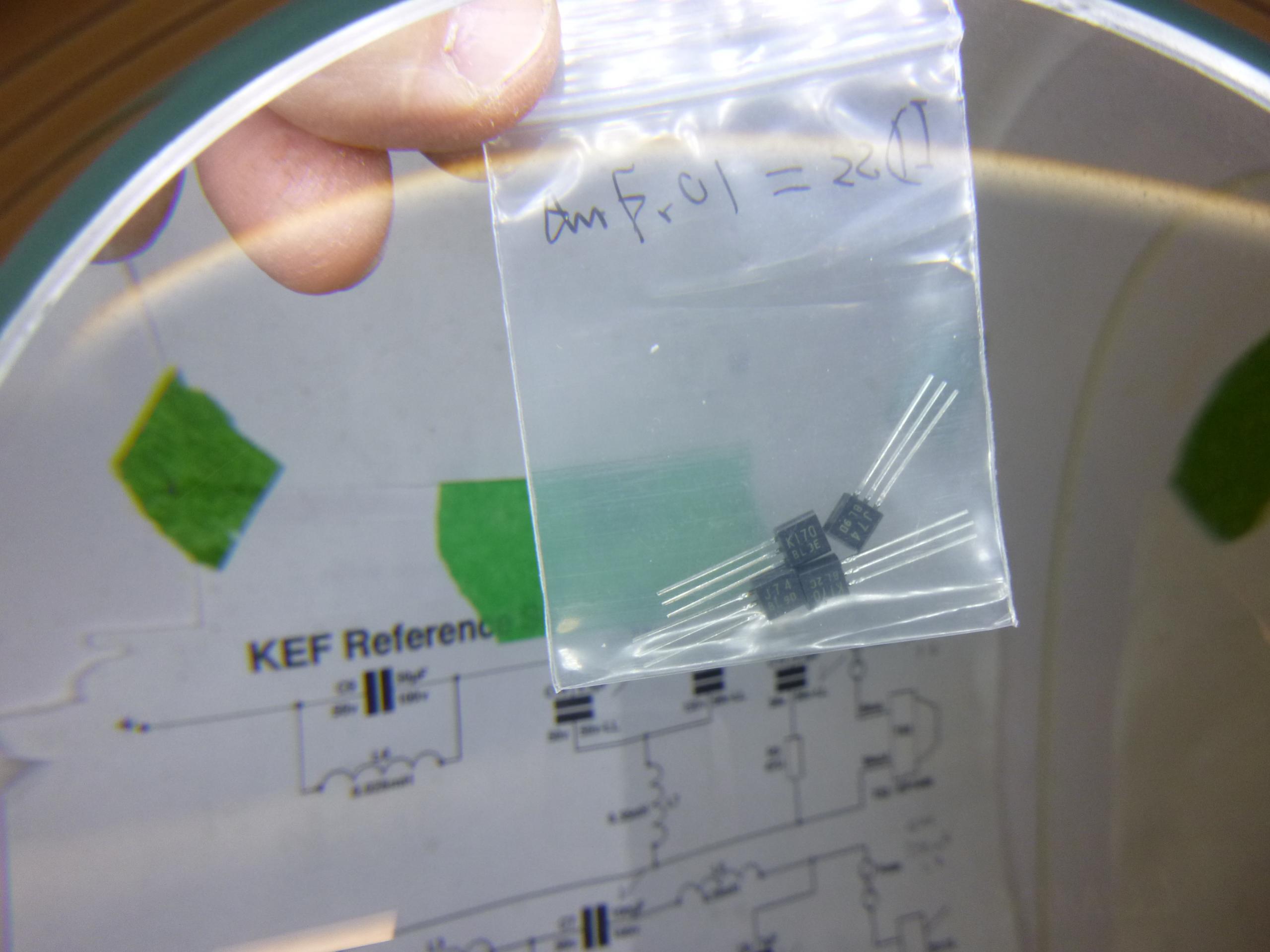

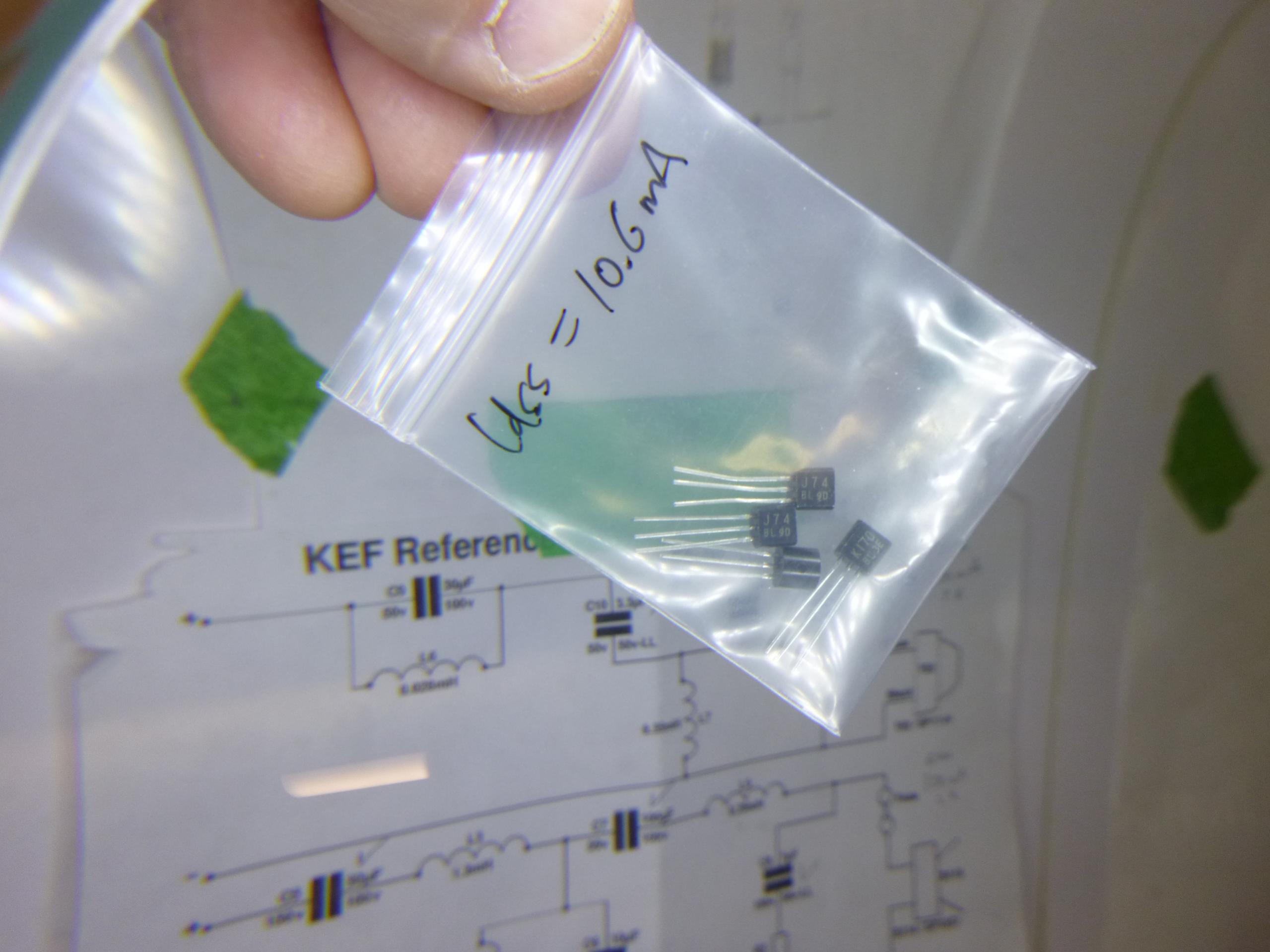

Fake semiconductors are routinely sold on eBay. So fake that even a Chinese tester can be used to detect an "outside the datasheet" issue like here, gate leakage current (~10nA).
So not sure about these parts. Perhaps the other tests should be done? Or is the cheap China tester just that - a cheap China tester?

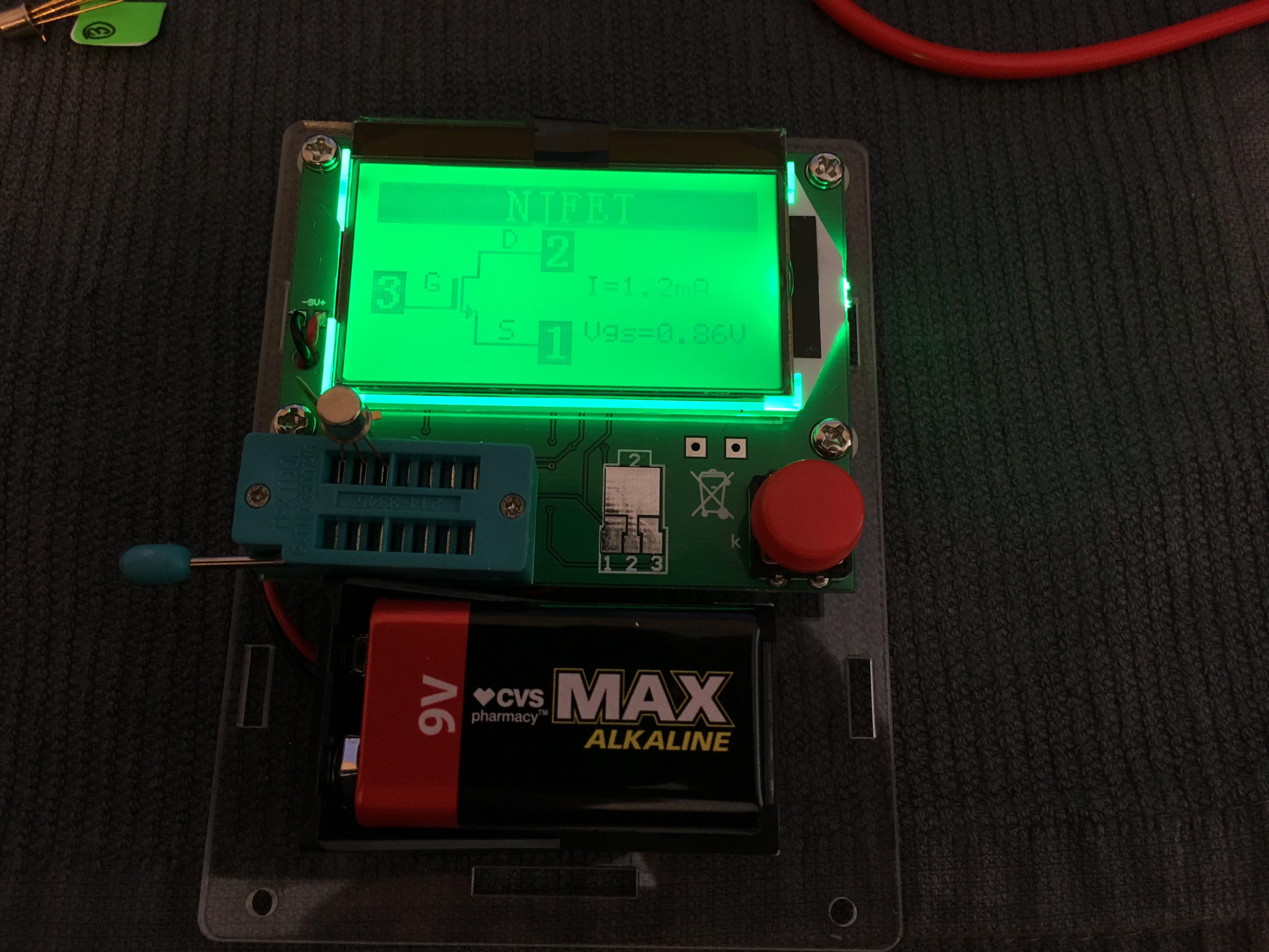

Following up on the cheap tester question. I have a few low Idss LSK389A purchased from NAC Semi I just tried to measure with the tester. (Using the low Idss because it will be used with higher Vds without cascode and wanted to keep the lower noise figure - datasheet for LSK389 states noise figure is at 2mA).
So here is a very genuine low Idss NJFET on the cheap tester. Perhaps it is the low Vgs that gives the tester difficulty. Wouldn't go by the tester alone, although it is a helpful device for quick tests, it is not very accurate.

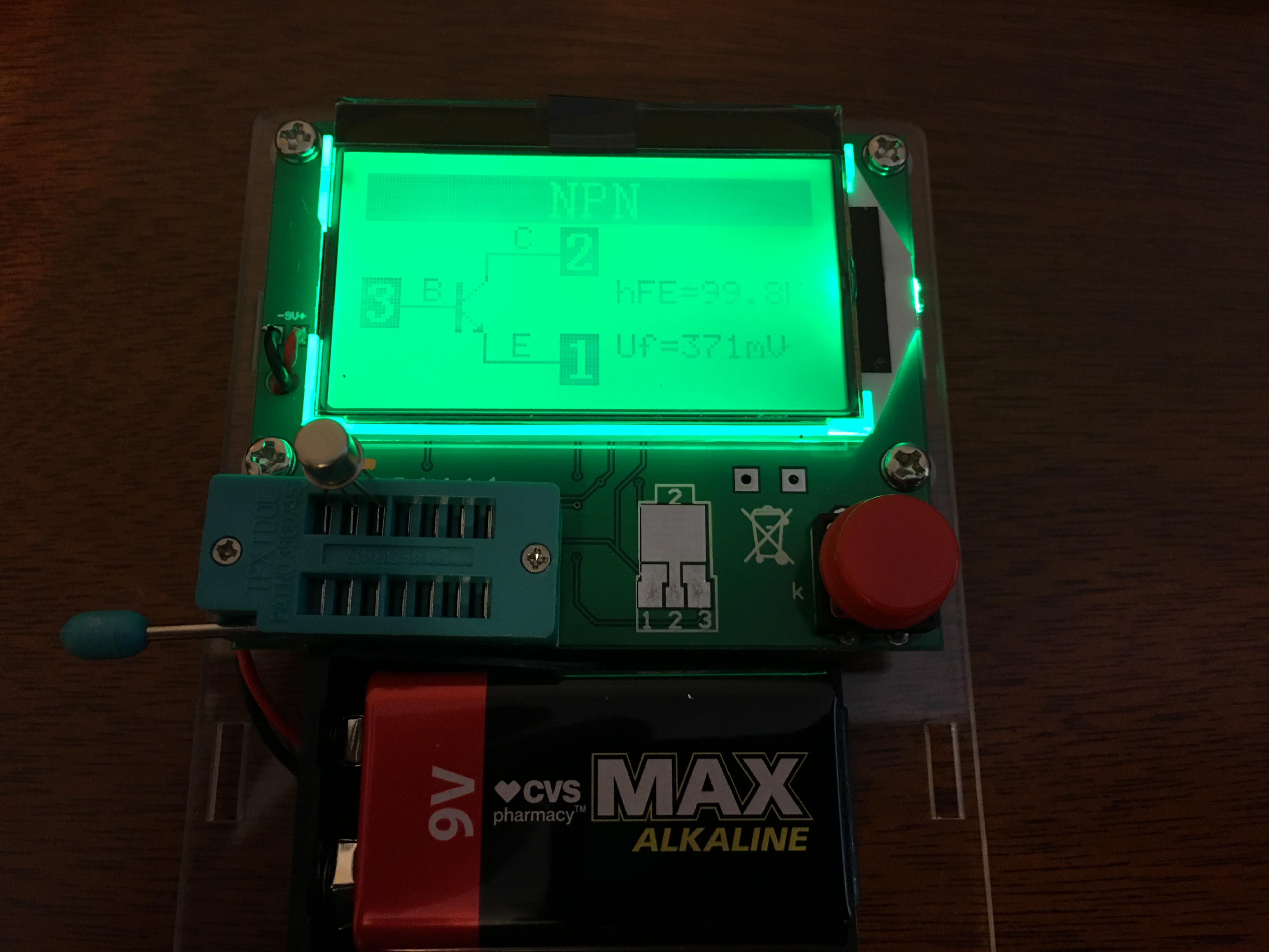

I don't understand the continued mis-understanding here you CAN'T test and N channel JFET as an NPN transistor. What is not clear about this??????
I was trying to show that these cheap testers were inaccurate so that others don"t use them for checking. Is that clear enough now?I don't understand the continued mis-understanding here you CAN'T test and N channel JFET as an NPN transistor. What is not clear about this??????
The tester determines the part type. I am not testing a JFET using an NPN test. If you are unfamiliar with these testers you are making things unclear.

Here's an LSK489 mounted the very same way in the same tester. Much higher Vgs.

...Apparently my testing error is quite obvious. If anyone could point out what the obvious testing error is it would go a long way in making the criticism constructive.

It's well known that these little totally automated testers do OK for 99% of parts, but sometimes go down the wrong path.
The tester does what you would do with unknown part and orientation: poke some juice at it and try to interpret it as some class of device, then measure like it was that class.
No, the user can't give the tester a clue.
These things were written by Programmers. Any transistor-man would know that hFE=99K is bogus, even 2K is dubious; but the programmers didn't know this.
I went into the notes and code once, it's all open-source. But too complicated for me. The algorithms and decision-points have been changed over the years, they are better. Maybe the one he has uses an older code; maybe so few people use high-Gm JFETs that this screw-up has not bubbled to the top of the bug-list.
IAC it is trivial to rig a battery and two meters (one is less convenient) and measure JFETs the right way.
