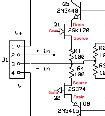

Also, sorry to necro-post (twice), but can anyone verify the G/D/S positions of the JFET's in the AM-1 modules? I just want to be sure, if possible, as they are not clearly marked and I just went with what I felt was correct based on the rest of the circuit - but it'd be better to have a confirmation from someone more knowledgeable, as well. Thanks for any help you can provide!
I have also seen many wierd configurations of (old) jfets in old circuits.
You can even flip the source and drain on some, without malfunction only a change of linearity. You can lookup the schematics for Johns Curls Blowtorch to see this.
But in the end it works best if you just use them with the source heading to 0 Volt through a degenerating resistor.
Well, I got an answer AND learned something. I actually haven't had much experience with JFETs yet, this is the first time I've assembled something calling for the use of them. Thank you! Also, not to nit-pick your schematics, I greatly appreciate them, but I believe you forgot the "interconnected line" indicator on the side of R9 not connected to the cap.

An image to clear out any misunderstandings:
