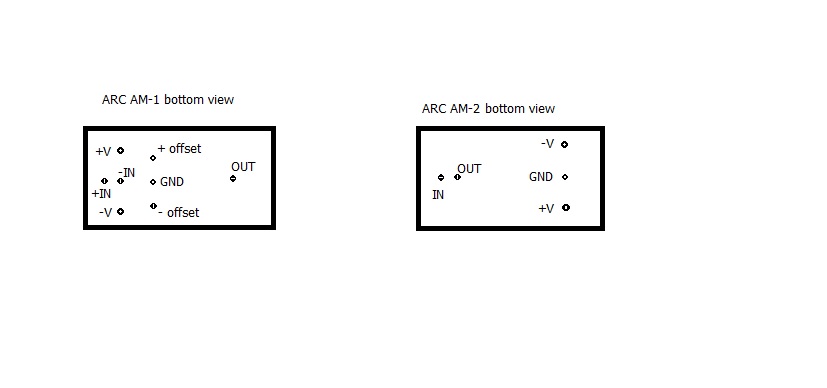

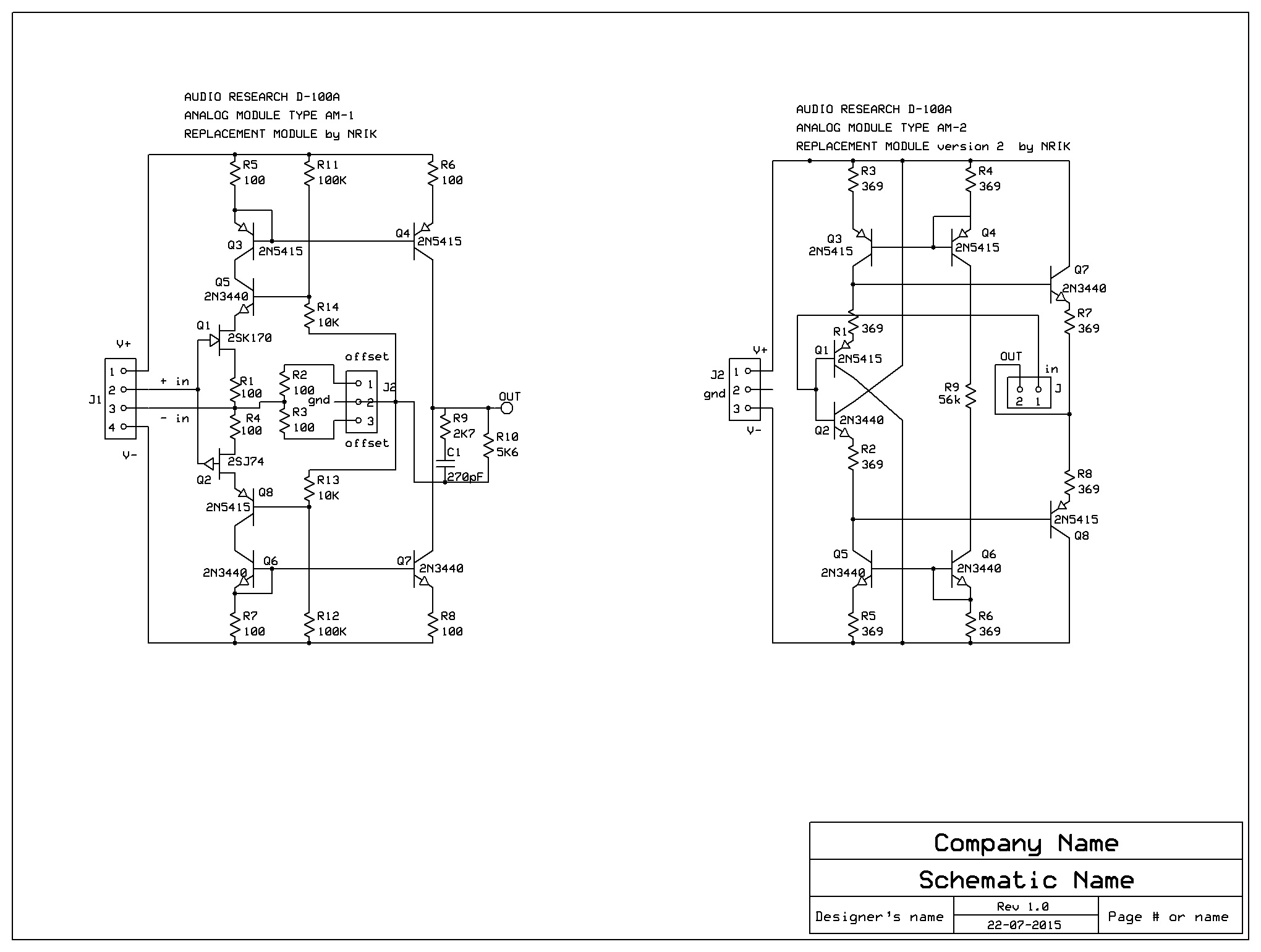

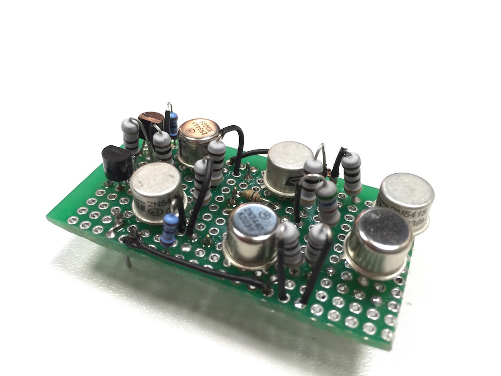

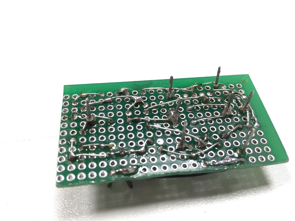

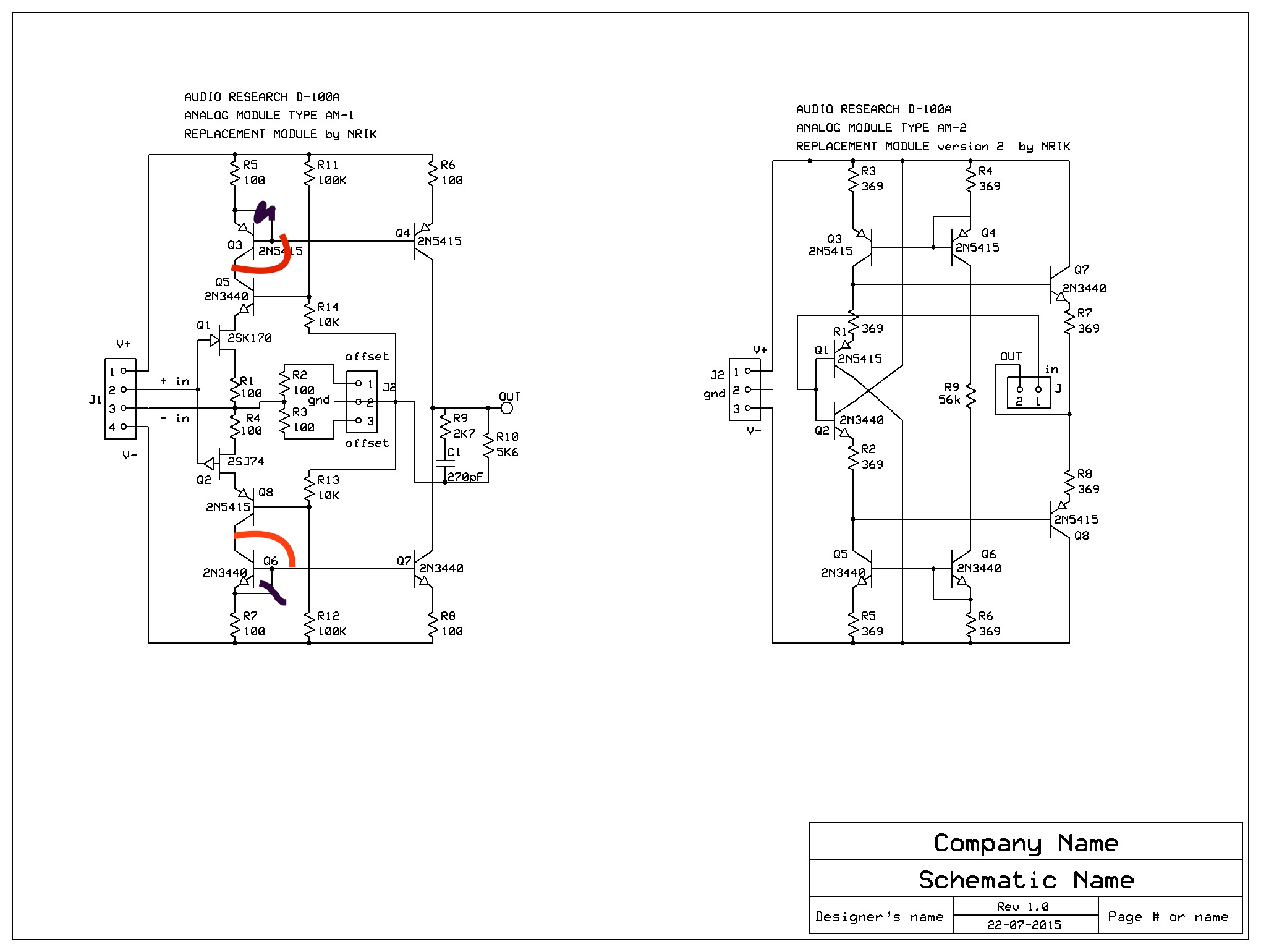

Right, so to answer all you who wants to see what my replacement modules looks like, here they are attached.
Use 1/2 watt resistors for 100 ohms and 369 ohms.
No heat-sinks are necessary for any of the 2N3440's or 2N5415's.
The J-Fets in AM-1 (Q1+Q2) can be substituted with other types, just trim R1 and R4 to an idle-current of 1-3mA and you are all good. The cascodes (Q5 + Q8) ensures a drain-source voltage around 5,5 volts.
Please also:
1) Check the supply voltages!!! I had collapsed voltage regs for AM-1 which gave me a much higher voltage and is probably the reason for the destruction of the modules to begin with.
2) Check your output stage !!! With the main PCB dismounted from the frame, you should definitely check that the output stage is working properly.
...both of these points require the schematic for the complete amplifier, which you can get here.
Please notice:
These modules are not 100% identical to the original ones, but I cannot get a complete circuitry and component types of those, so this is a valid shot, although improvements can definitely be made. Your suggestions are welcome.
At least the frequency compensation in AM-1 (R9 + C1 + R10),which is just copied from the original module, can probably be optimized to this particular circuit.
good luck 😎

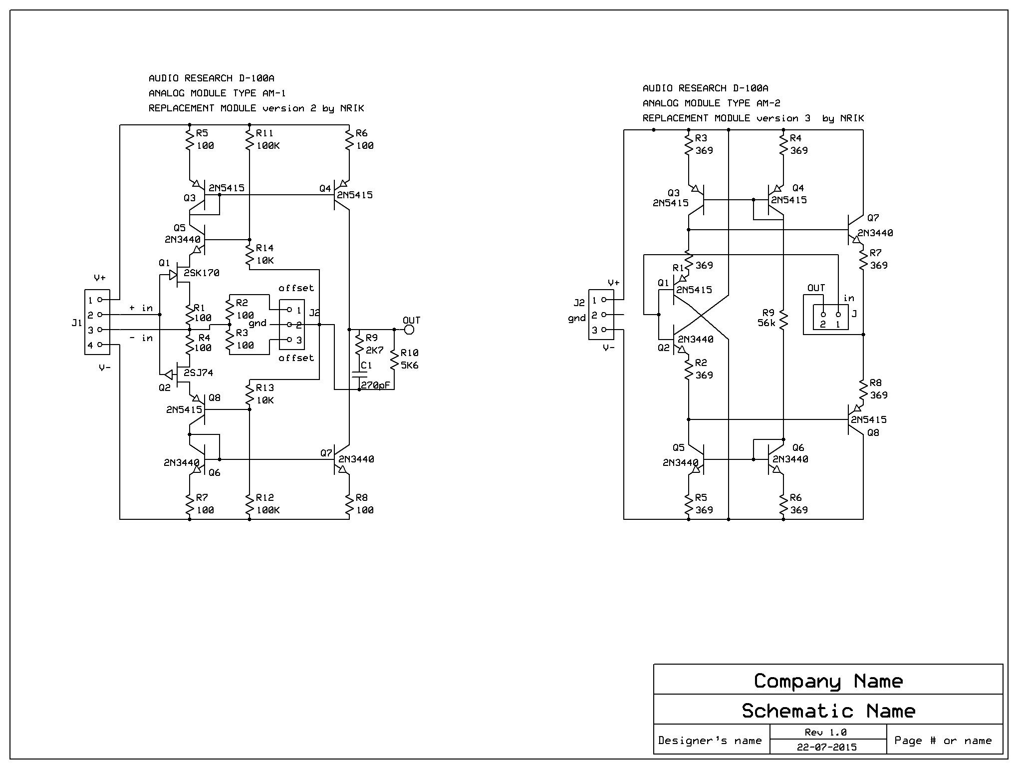

First improvement/correction...I reviewed what I actually build and this is it (sorry).
The difference is in AM-2 where the idle current is uncontrolled in the previous shown circuit. What I actually build - and which secures an idle current of approx 1.9 mA through both input and output transistors - is version 2.
...Oh I forgot to mention:
The amplifier is working fine with these modules and it is playing great.

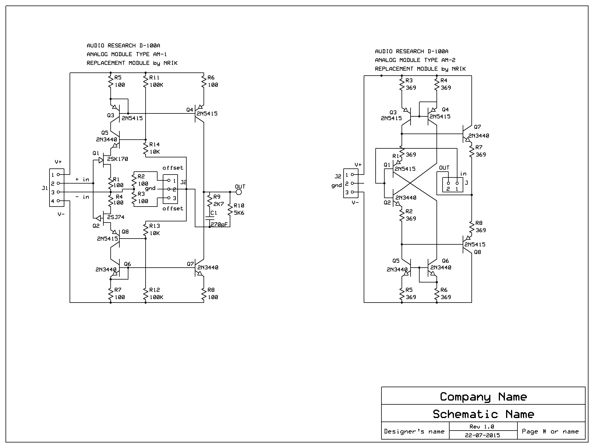

Many thanks Nrik. The circuit has an error AM-1.
I built one module test tomorrow.
Correct, that is an error - should be as muadib put it.
Module 2 has the same error.
Well spotted - thanks.
module AM-1 work, 🙂Correct, that is an error - should be as muadib put it.
Great to hear of another confirmed fix Maudib 🙂
corrected schematics:

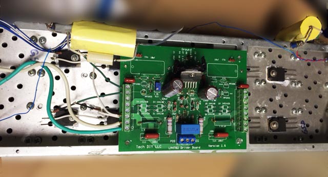

My D-115 had similar (broken) module. It now has a Texas Instruments/NatSemi driver chip.
D-115 ?
A tube amp !
Possible you thought instead a D-110 one
Raymond
Mine is a D-120, sorry for the mistake.
D-120 ? I understand now.
In fact, the latest version of the D-100 and thus the most accomplished.
Please Jackinnj, could you tell me what "Texas Instruments / NatSemi driver chip" have you fitted in place of this ARC dead module ?

Right now it has an LM4702 driving Renesas lateral MOSFETs. At one time it had an LM4702 driving TIP142/147 Darlingtons. As you know, the LM4702 can't provide enough drive current for ordinary bipolar devices.
Plan is to have LME49830 with Toshibas, but i haven't burned a PCB for this chip.

Hi Raymond
I used BL but you can use the others or they can be substituted with other types, just trim R1 and R4 to an idle-current of 1-3mA and you are all good.
