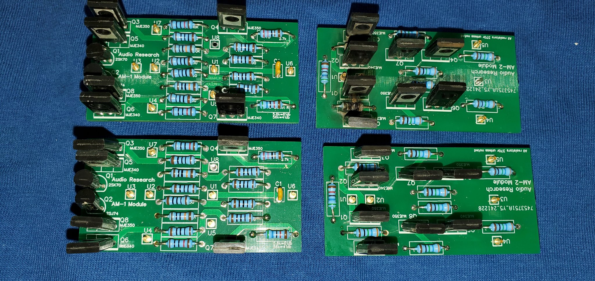

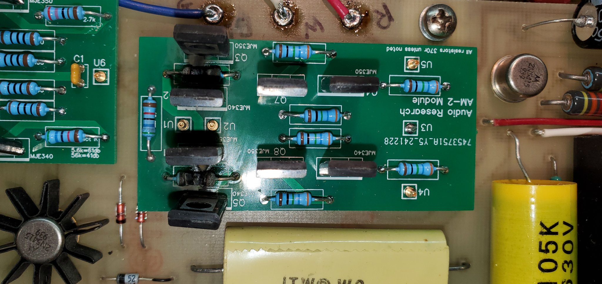

They were both mounted correctly. The 350 to tab side and the 340 not to the tab side. The right channel board did not blow up and was built the same. I haven't tried a signal on the right channel from my sig generator as I now have 6 volts dc offset as I stated above. My AM1 and AM2 original board were ok, I built these new ones as I was told they were causing my offset, but in fact it was transistors in both outputs causing this.If we assume Q3 is correctly mounted, then Q5 is not.

I told you earlier in the thread you had these installed wrong but you ignored it.

What was installed wrong the 340 and 350 transistors? The 350 were on the trace side and the 340 were flipped the other way. The right side board was built the same and did not blow up. Ya I have had enough of this thing and throwing $$$ at it. Should of never bought something that had over 130VAC hit it.
Can you provide a couple of pics of the AM1/2 boards you built? The top down view you previously posted makes it very hard to judge the 340/350 transistor orientations.

Here have a look. The left channel that took the AM2 board out, I also found a bad 6.2v zener CR11, I think there maybe other issues as in circuit some of the diodes touching that zener are measuring bad but, removing one it's ok, therefore something else is not right, again, probably why AM2 burned up.
