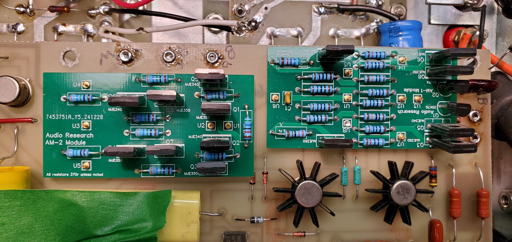

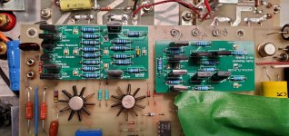

I agree, it's hard to check the transistors on the module boards but what I could see appeared to be ok...Could you possibly provide a coupled of pics for the AM1/2 modules that show the transistor orientations better?

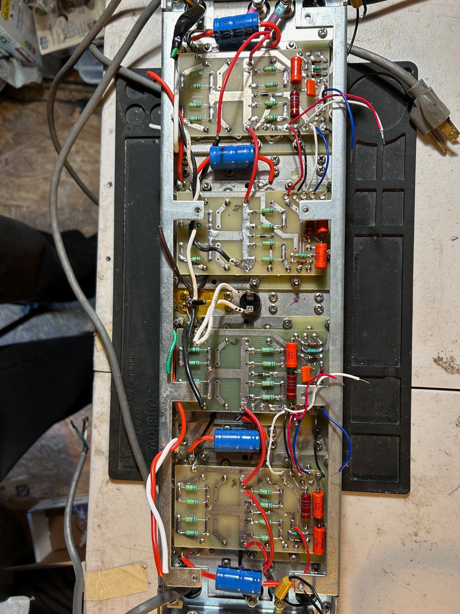

That pix is how I got the amp. All the top row of the 4 PNP in the middle been replaced with MJ1016, and the far right 2 NPN are now MJ15015.
Also I have replaced quite a few of the MJ15004 and MJ15003.The far right channel NPN are original and I got 2 extra that came with the amp.
I redid all the caps and resistors on the 4 circuit boards, soi not sure what is causing the dc to get into the output. I verified all the rest of the TO-3 that are not shorted.

I meant the ones on the AM module boardsThey all go in the same way. Here is a pix when I got the amp. I replaced the one diode which was ok and also one .1 cap which I just finished replacing it when I redid the boards, no change. I am stumped what else to check
The transistors are all ok on the AM boards. You can see the pix I posted. It's the TO-3 transistors that's is causing some dc to get into the output. Disconnecting that pre driver board with the AM-1, AM-2 new boards was not the cause of the dc offset. I believe my old AM-1 and AM-2 are fine, but I still went ahead and built the new ones and installed them. I went over every single TO-3 NPN and PNP and even changed a few to get the hfe closer. I had no shorts, so not sure what is causing the DC to flow from the collector to the emitter.

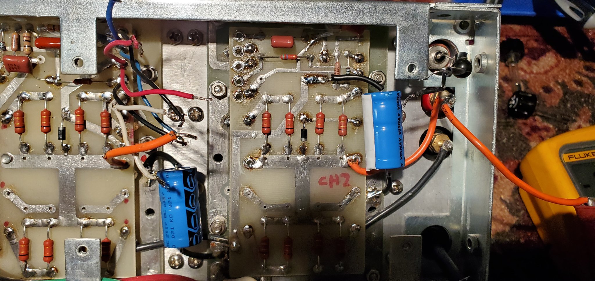

Working on the right channel for now and have disconnected all the jumpers between the 2 right channel boards. With a fuse in the neg supply I am getting the full -53v on the neg board. I have replaced all components, so not sure what is going on. When I had the board off all TO-3 were fine, no shorts, I cannot see how that -53 is getting on to output. I can't see anything. I may have to unsolder the board again.Mine didn't come with .47 caps across the 300uf. I think I did try one and it didn't make a difference. I might have a leaky transistor that is not showing up with an ohmmeter or transistor checker.

I just finished removing the far right hand board and no shorts on the 4 PNP. I am getting 0 ohms collector to emitter and leads flipped 1.1M.
The NPN at the top are original and they measure around 400k. Not sure if I should order 2 more to replace those, and one PNP , I replaced 2 PNP already and have 1 more I can put in, then all 6 devices in that bamk would be new.
