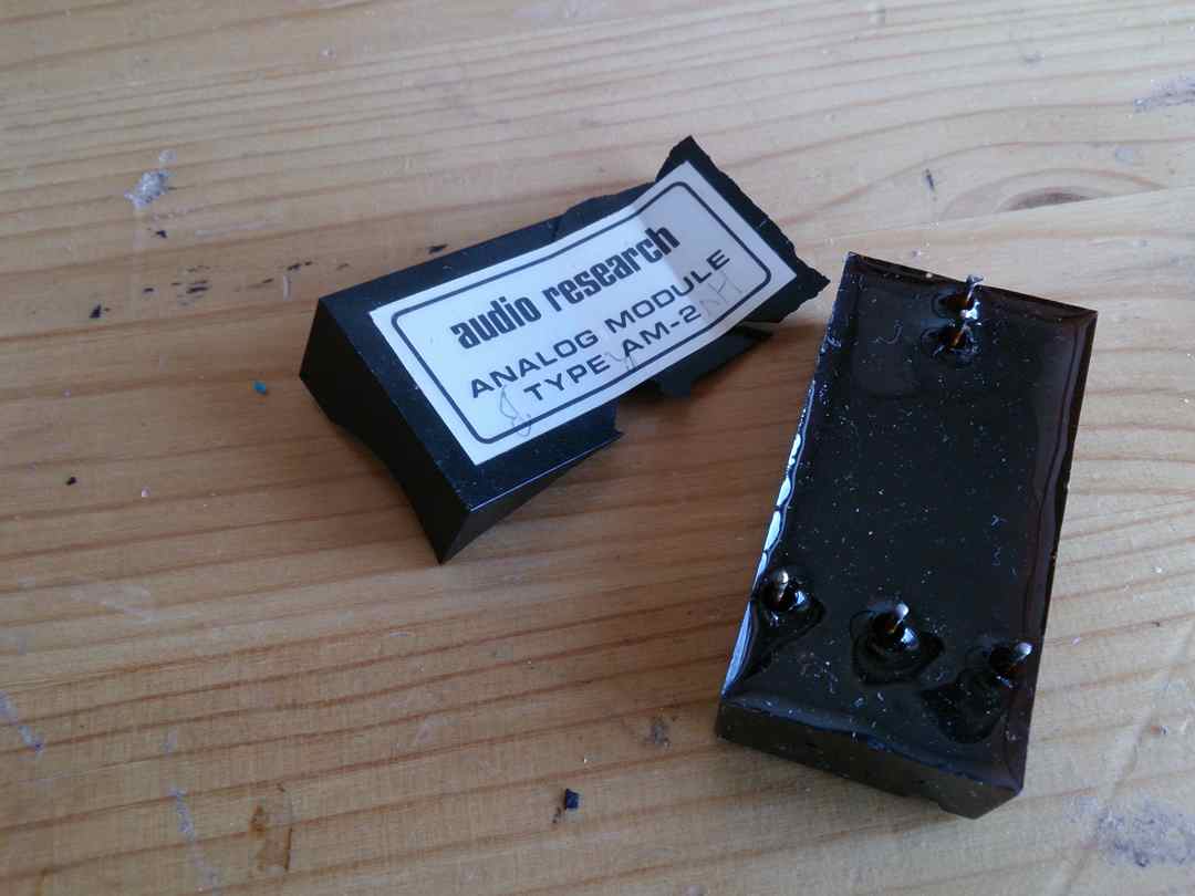

Bought a defective D100A with multiple defects, among them a missing module 2.
Tried paint thinner (toulene) on the remaining module 2 - no luck.
Mtubes it would be really appreciated if you would post some images or reverse engineer the schematic of the module.

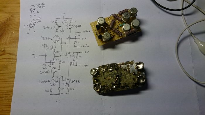

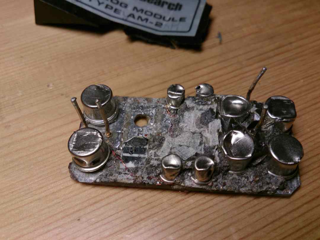

So without much luck etching the epoxy away I went at the module with a chisel. Pretty radical, and the module is wasted, but I was able to reverse-engineer the most important part, and now I can build two new ones, so it was the right decision.
At the same time it allows me to share my results with you dear DIY'ers.
I even found that some of the transistors still carried their type, so now I even bought the correct types for the rebuild.
Anyway check out the attached images and the schematic.
All the 369 ohms transistors ( R1-R4 and R7-R10) were on the same resistor array, with a couple of them still working so I could measure them. Unfortunately I cannot determine the 'small' transistors, as well as some of the resistors. R5 and R6 might even be zeners but they were chisel'ed away, together with the connections between the points (there was some loose ends of copper-threads sticking out of the residue here and there).
So a complete schematic it is not. However it is perfectly clear, that it is a Jung-buffer like the output-stage, just as I presumed.
And despite the missing connections it should be possible to recreate a circuit that performs just as well by redesigning the current generators.
Does anyone have suggestions?

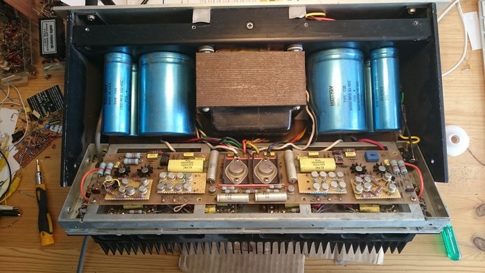

all-right: Long time no progress, but here we go:
At wintertime I chisseled the non-working AM-1 module and did as much reverse-engineering as possible, and it is definitely possible to recognize the topology and recreate a replacement circuit. (See bmp file)
Last week I finally also got around finishing up a replacement module ( not 100% accurate but it works as intended), and ofcourse I made two modules and pulled out the working AM-1 module ( any takers?)
The amplifier now works and plays wonderfully. 😀
Enjoy images and shoot any question.
