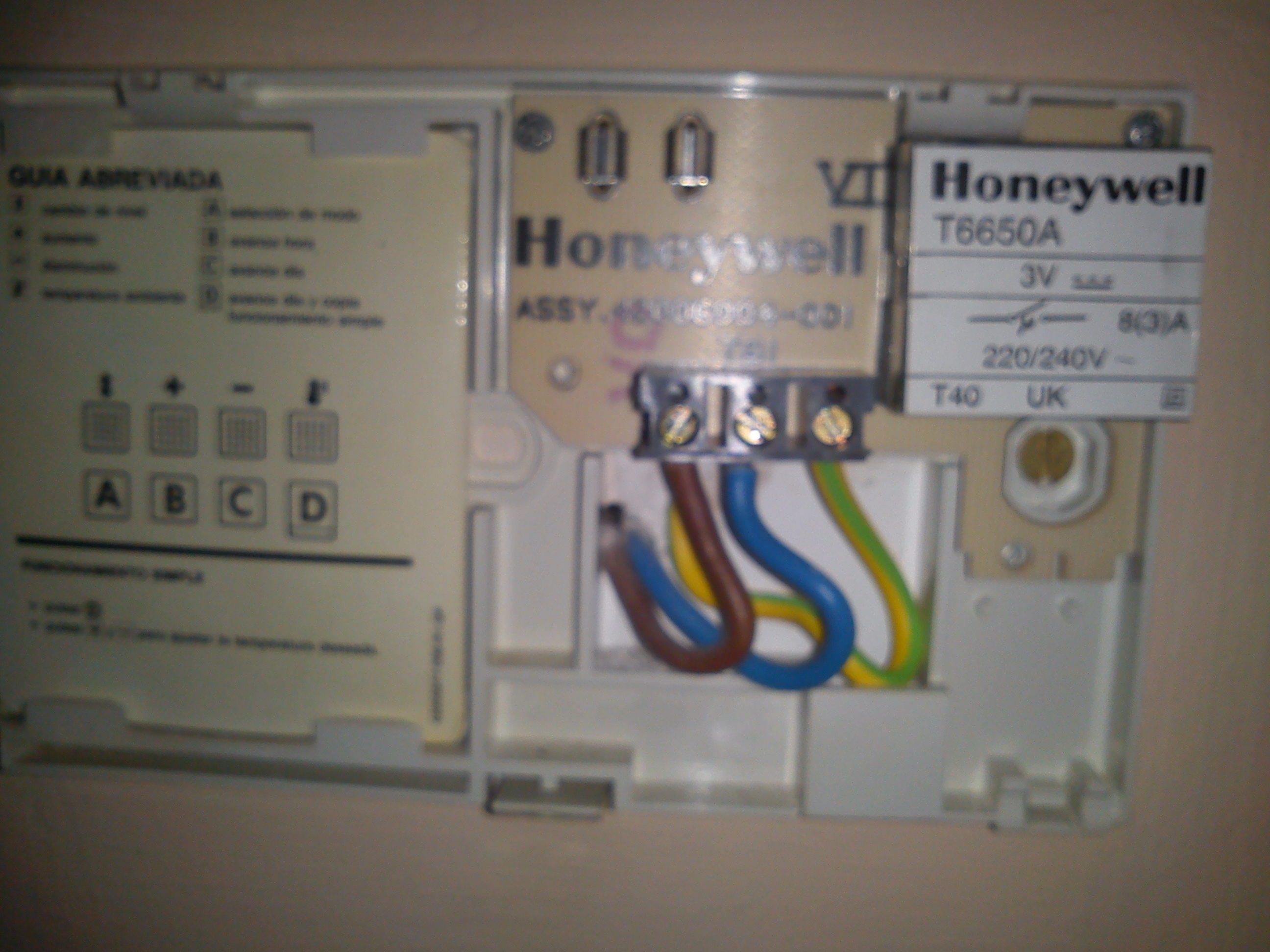

¿can you verified the earth point, is OK?.
If only this switch make the spikes:
you need a varistor in paralel with the switch of start burner in heater, or a varistor in the mains AC of heater.
With a varistor in the mains AC of heater still unlocks but I VERIFIED THE EARTH POINT IN THE TEMPERATURE CONTROL AND THE EARTH WAS NOT CONNECTED CONNECTED AND FIXED THE ISSUE🙂

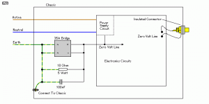

I read where to connect the zero volt line: "This is most commonly taken directly from the centre tap of the main amplifier filter capacitors, but should always be connected to a point where there is high current wiring back to the transformer"
Now the questions are:
-DAC box have 3 PSU: 1 positive digital + 2 analog (1 positive & 1 negative) where to connect or have I to connect in each mains filter cap?
-I'm using balanced & unbalanced outputs, have I to connect the zero volt line in each output ground?
-Have I to connect the zero volt line in each input ground?
Thanks for help.
