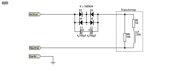

If I understood well what is at hand here is dropouts from Felipe's buffalo dac. Since i had exactely the same symptoms he mentioned, i though i would share what worked for me- i don't claim a dc block removes spikes, but rather dc is something to look at if the dac dropouts (among other things)
I found this hint by Russ here: Buffalo Sensitive to EMI? - Buffalo DAC - Twisted Pear Audio Support (2nd post) and since a dc block is so easy to build i did one immediately and that solved my problem presto.
I'm sure Felipe who is a keen diy'er has a diode bridge and a couple of caps lying around that he could test immediately 🙂 hope it fixes it.

Not fixed.😡
Damn. Did your read the rest of the link before? He fixed it like this " FIXED! I jumpered the ground terminal to the - terminal for each S/PDIF input and the problem is gone"
Could this also be useful in your case?

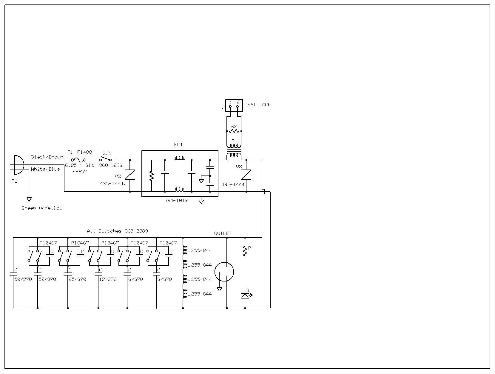

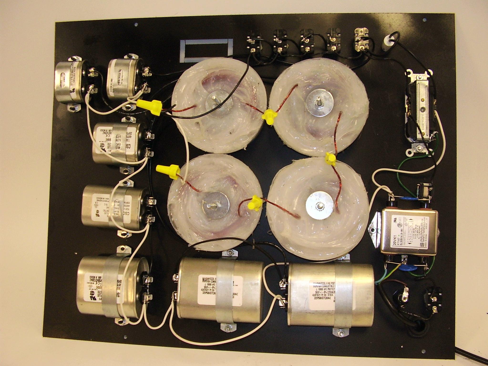

This is from an old Audioxpress article, it no longer seems to be on the web,
Here is the article less the pictures. (Size limits.)
Thank you simon
