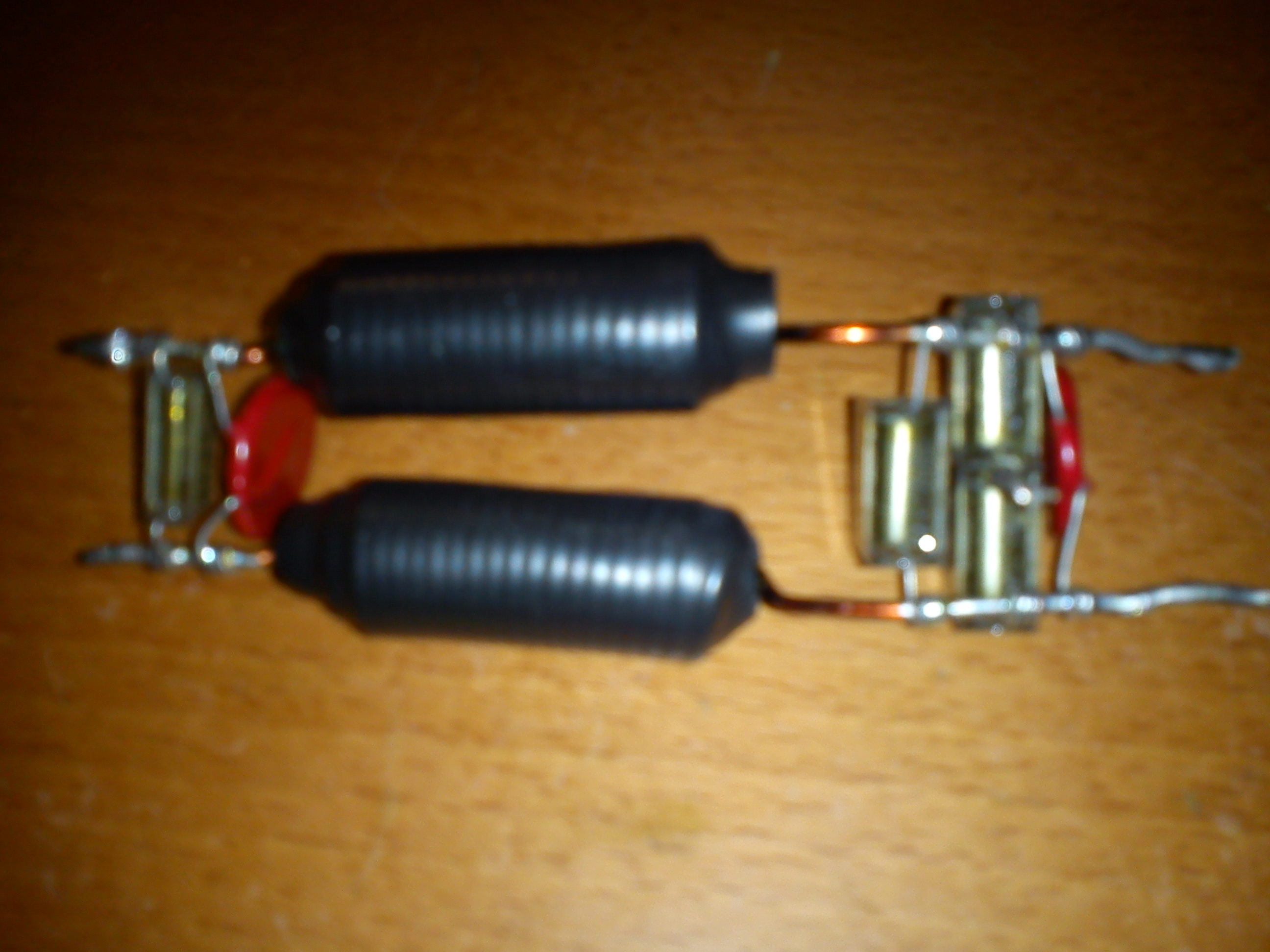

The Jon Risch filter is a reasonably good filter. But as others have said, the line-ground & neutral-ground capacitors must be minimally Y2 rated, an 'X' rating is not appropriate, but many X1 capacitors are also rated Y2. The 0.1uf for C1,C2 are quite high for a 'to ground' Y cap, Nigel's 4700pf(4.7nf) value is more appropriate.
The nominal 275 vac rating of the referenced varistor is fine, but if I could address that known spike at the source end, I'd use a 300vac rated version to minimize the 'wear out' of the varistor.
If the spike is caused by contact closure on your heating system, that spike is single ended (differential), rather that common mode, and the minimal leakage inductance of that JWM 8108 1mh CMC, 4.5uH, is unlikely to help

Is your filter circuit intended for source components only? The 1mH differential inductors (do you mean both to be single 1mH CMC?) shown in your schematic are going to constrain the current draw of the typical solid state power amplifier.

Two pics of an identical Jon Risch power conditioner that I have as spare.

For source components, I do try and get about 1 mH of differential inductance, along with 20+ mH of common mode inductance with appropriate X & Y caps. But for linear, cap input power supply fed solid state amps, differential inductance above 25uH has been problematic. YMMV
Have you actually used this filter in an audio system?
No I have not. I just input it as a starting point.
