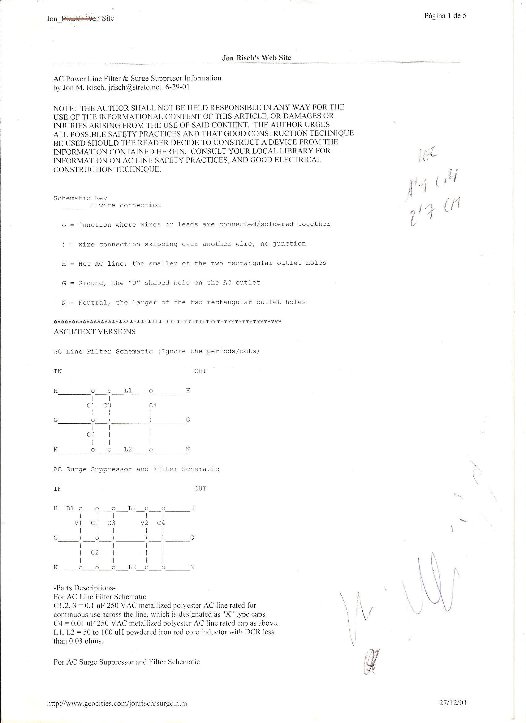

I have a dedicated/separated AC mains for my audio system, when I use my BIII DAC I have AC spikes that causes dropouts, I know that AC spikes are caused by central heating when starts the heating, I remember that I can connect 01,uF 400VAC in the AC inlet where is connected the central heating but don't remember if I have to connected between hot & neutral or other way, could you help me?

Jon Risch's AC Power Line Filter & Surge Suppresor

A common mode choke can help?
I have this 1mH 10A 0.01Ohm: 8108-RC - BOURNS JW MILLER - COMMON MODE CHOKE | Farnell España
If yes how have to implement in the Jon Risch's Power Line Filter & Surge Suppresor.
If you know other better AC mains power conditioner schematic will welcome.
