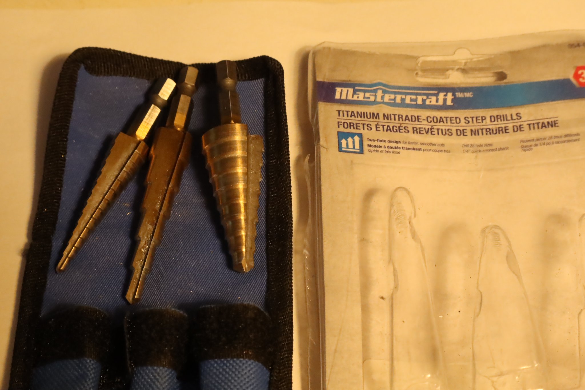

Stepped bits have also worked for me for drilling into thin sheet metal - round holes every time versus jagged holes with regular bits.
I have a set of stepped bits that start at 3mm diameter.
Reactions: tomchr

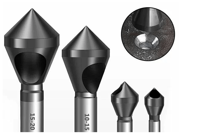

If you're gonna drill: start with a 3mm (1/8") bit. Use cutting oil, 3-in-1, something. After making the first hole with a twist bit, get a Step Bit to make the larger holes. A twist bit will bend thin sheet metal as it goes in, don't use big twist bits on thin sheet metal. There are many deburring tools out there, for sheet metal I like to use a Countersink Bit, but not one with flutes, they chatter. Use one with a hole through it, like this:
This will give you the smoothest edge.
Try to practice a couple cuts on similar material, if possible. Go slow. Have fun!
w
Thanks. What deburring countersink bit SIZE would you recommend for a 4 mm. hole ?
