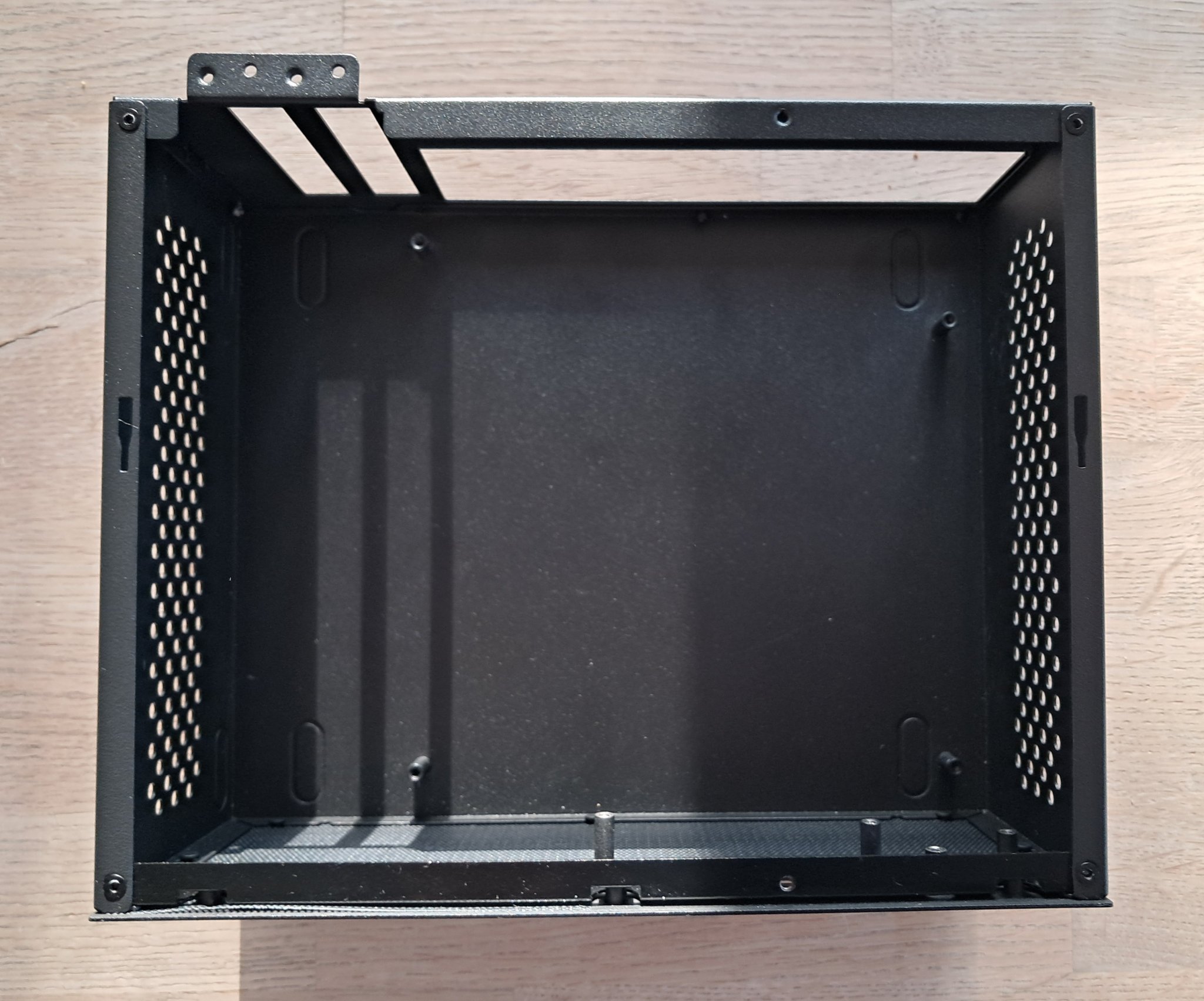

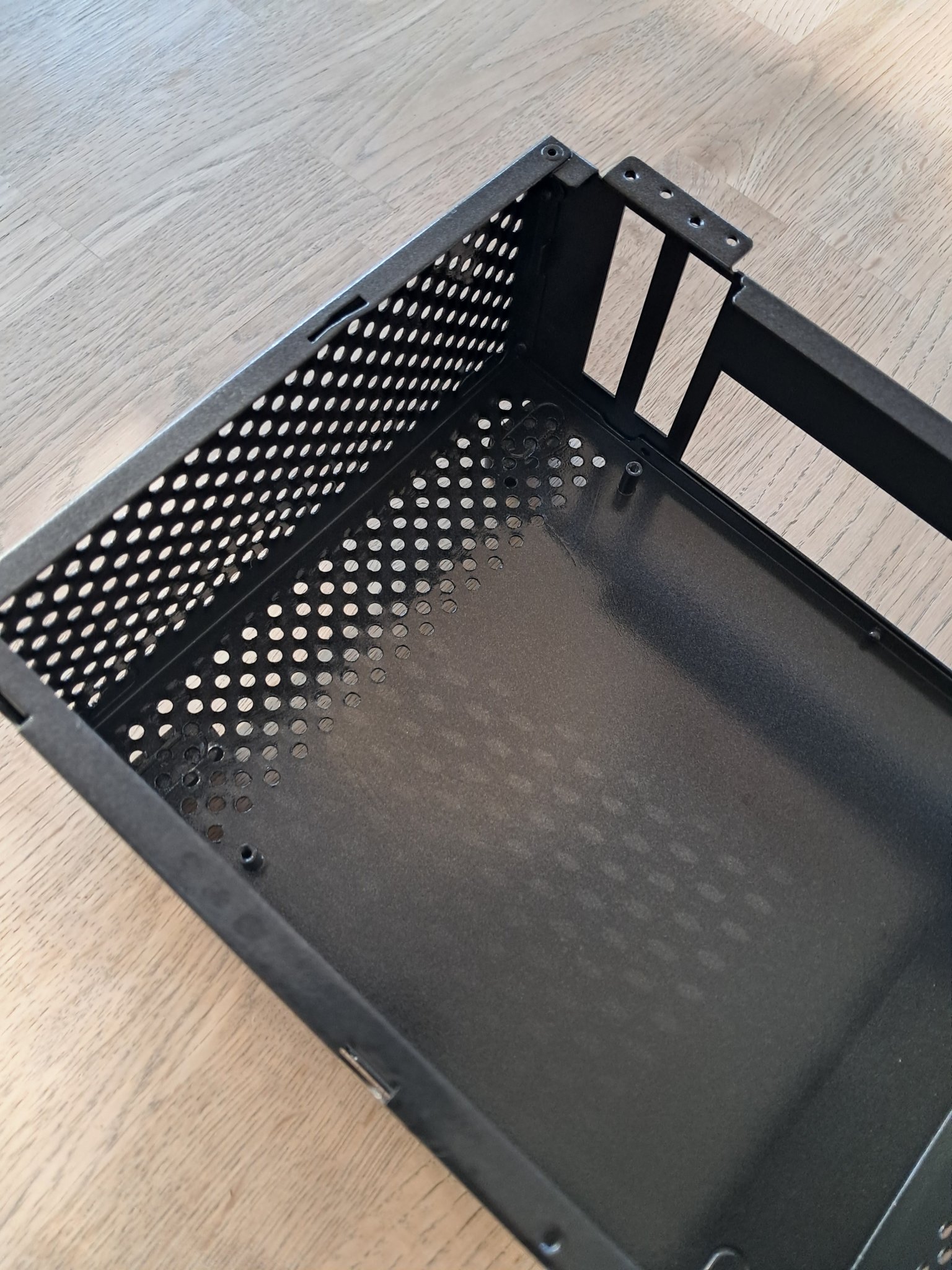

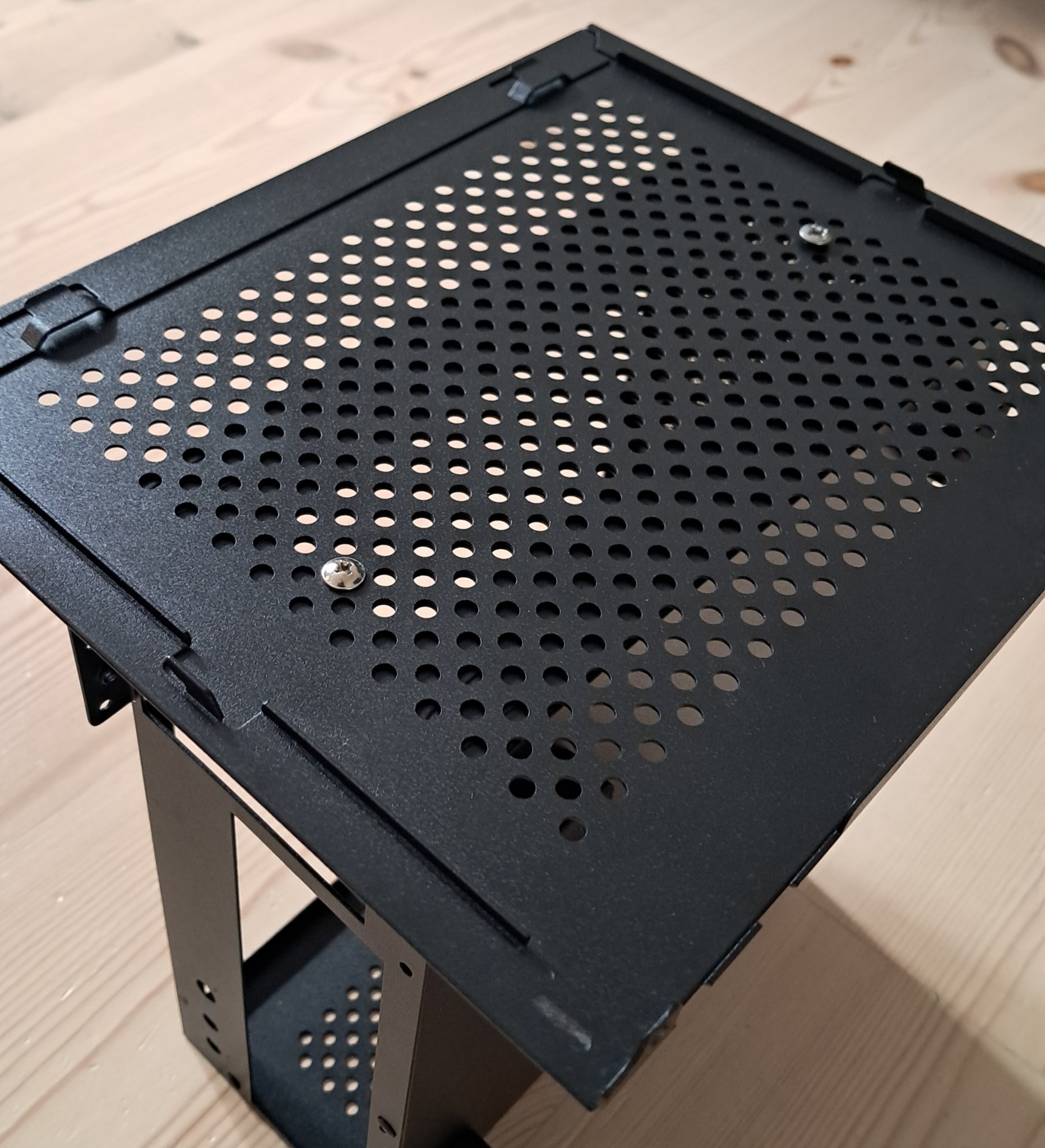

There are two solutions:
https://jurotissu.hu/
Fortunately I found smaller pieces but large enough for me in their debris box.
- Cut out the entire area, and cover it with a pre-drilled piece of steel (or aluminium) sheet from inside or outside.
- Take a piece of aluminium sheet, draw a matrix on it, tighten it to the steel sheet at many points, the closer to the holes to be drilled the better, and drill through.
