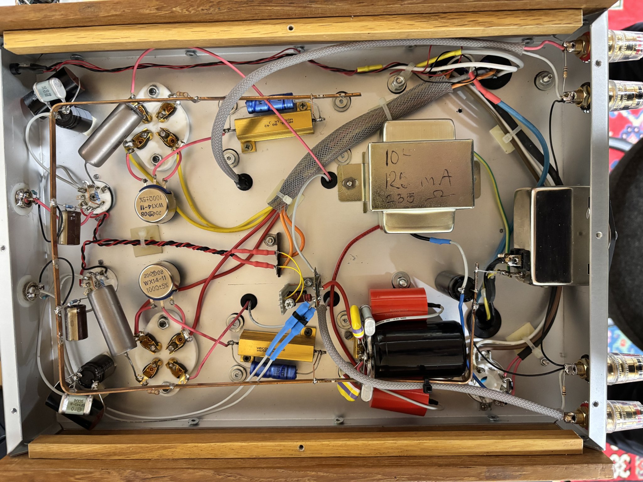

It’s been years since i soldered inside this amp so I’ve opened her up to conclude how it’s done.
First. The signal gnd (cleen) is directly connected to chassi (IEC) earth.
Second. There is a delay-pca connecting 320V (secondary) centertap to signal gnd 30 seconds after power switched on.
Input RCA is corectly done with only one conection to signal gnd.
Finally I found that the output transformer (speaker terminals) where floating, not tied to signal gnd.
So, with that I have two task to try.
Tie opt secondary to signal gnd and to separate signal gnd and chassi earth, as sugested.
Thanks all

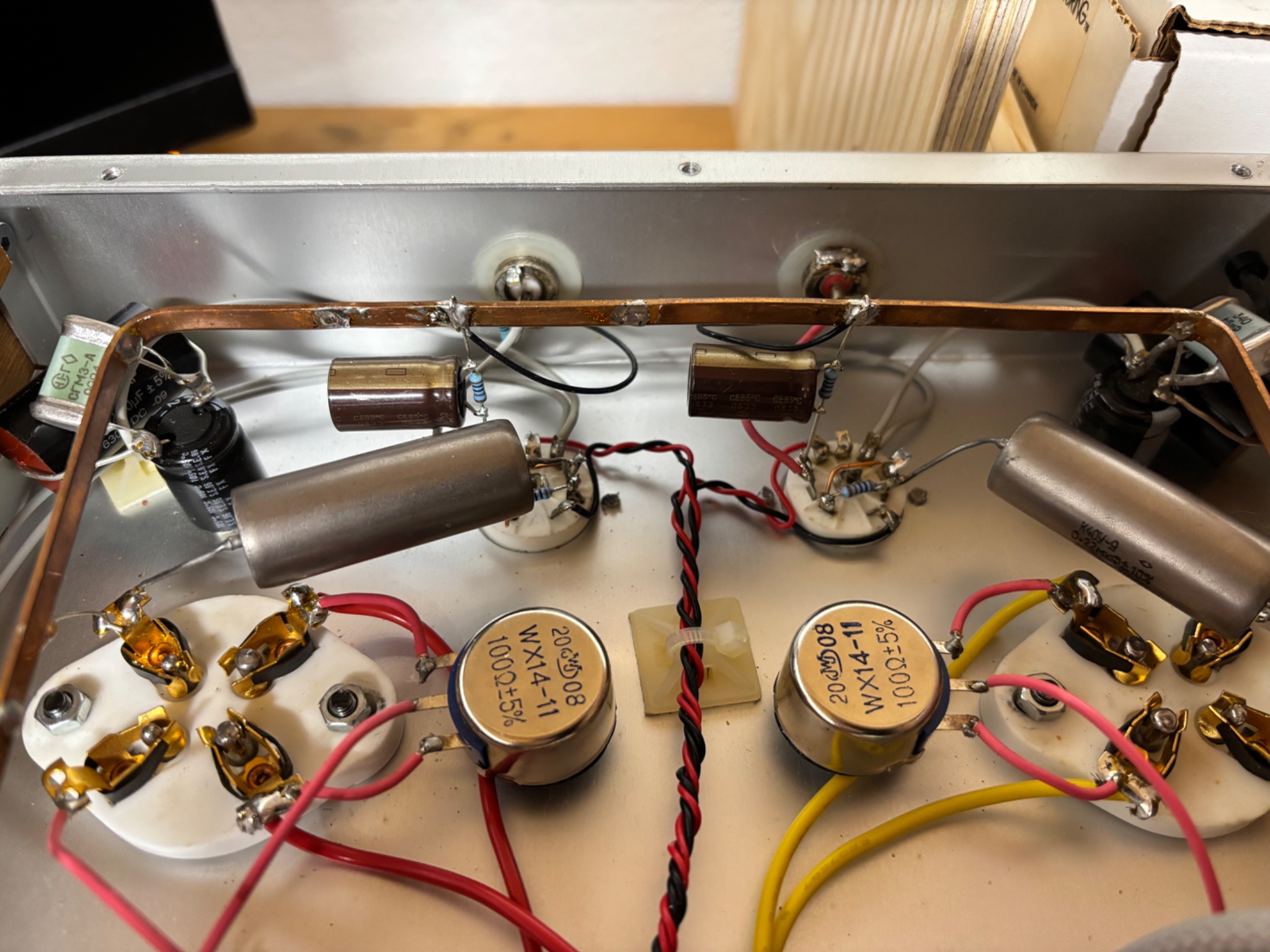

Even though the 2A3 filament current is balanced out to unhearable levels with my high sensitivity horns, I can’t stop being suspicious that this is where the 50/100/150/etc peak came from.
I’ll let it rest for some days. And when I’m in the right mode, I’ll try to change it from ac- to dc filament power.

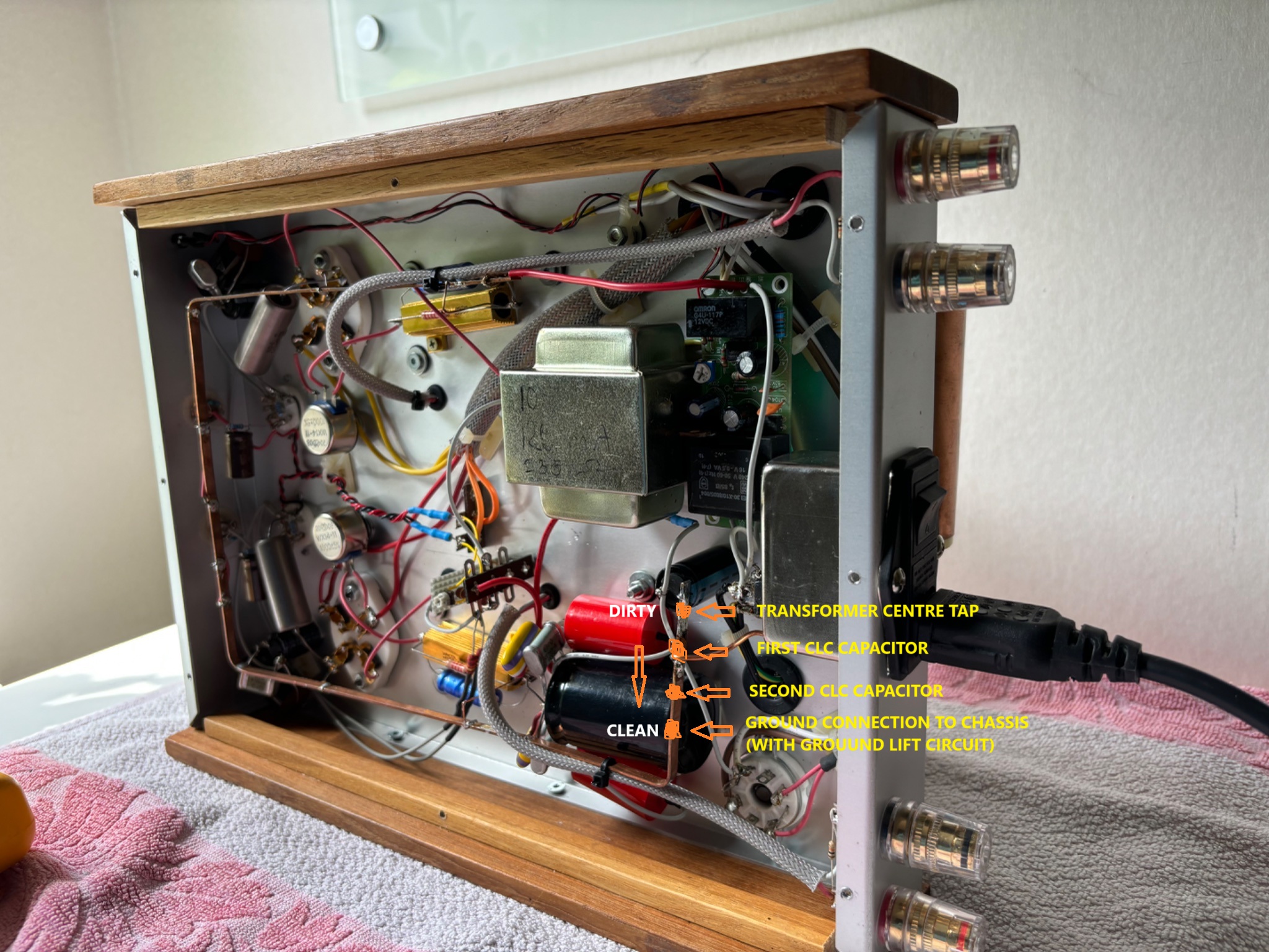

The locations of the power supply grounds to the ground bussbar are ciritical. All of the power supply grounds should not be made a one point. The dirtiest ground should be located at the starting end of the bussbar and subsequent power supply grounds should be place progressively along the bussbar.

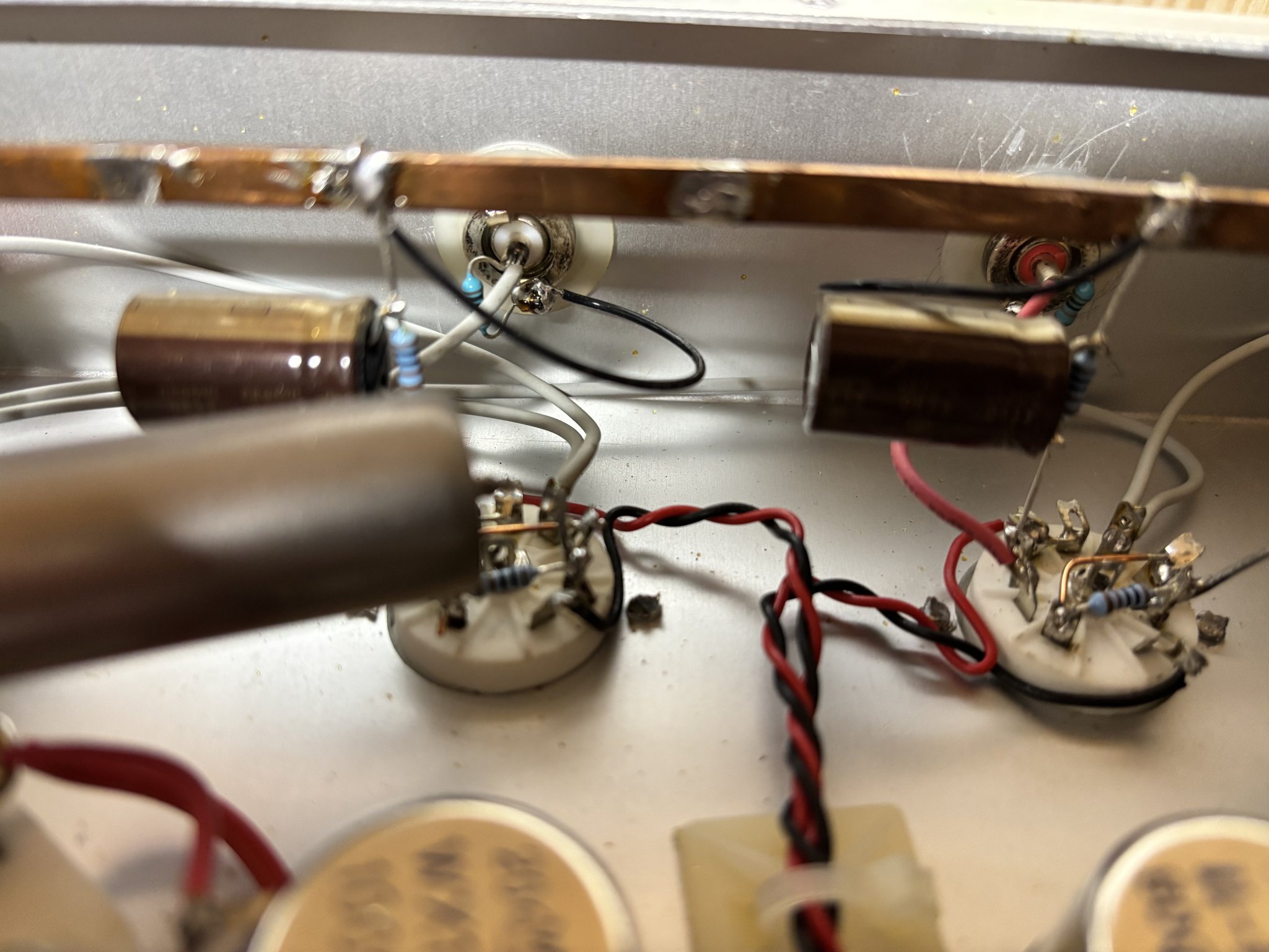

I think the photoes indicate the input sockets have central spigots which have been left unconnected ?

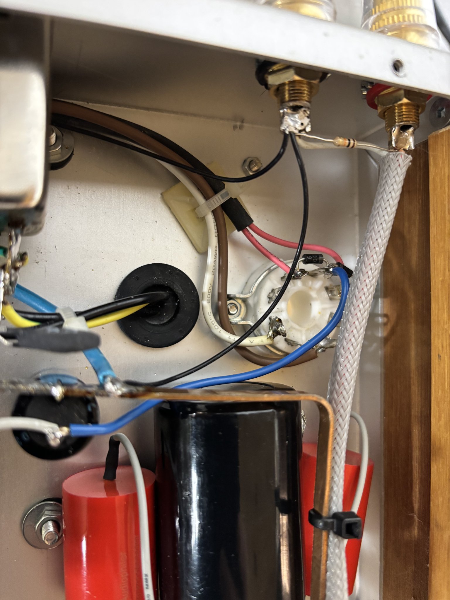

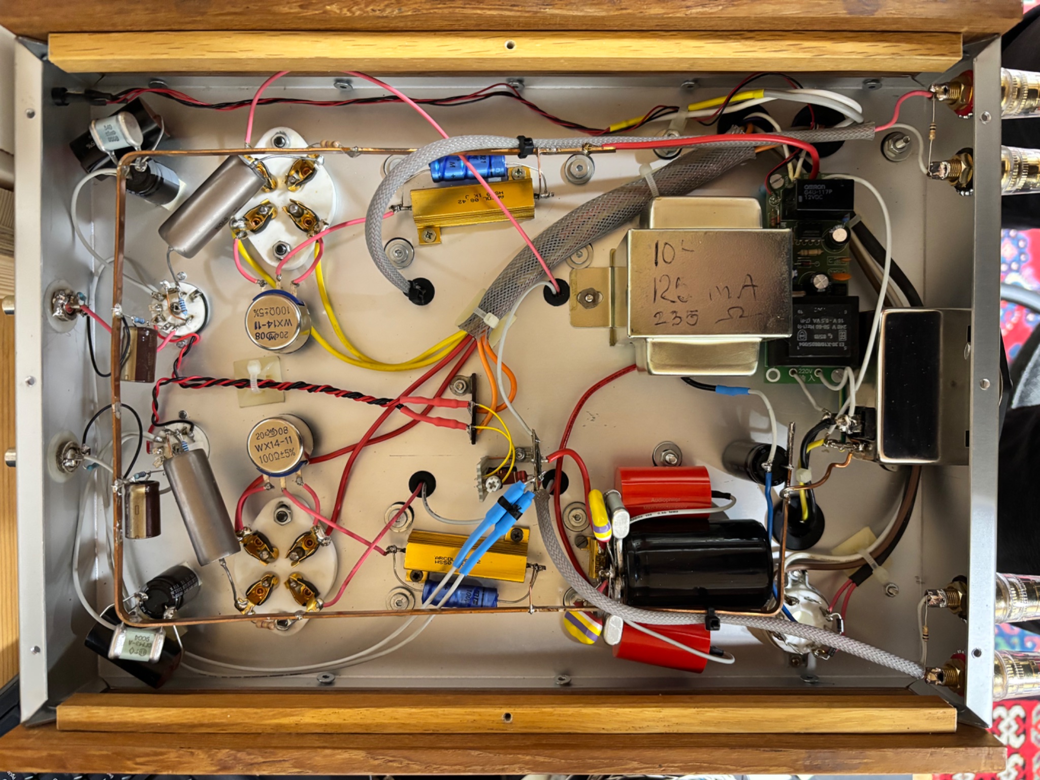

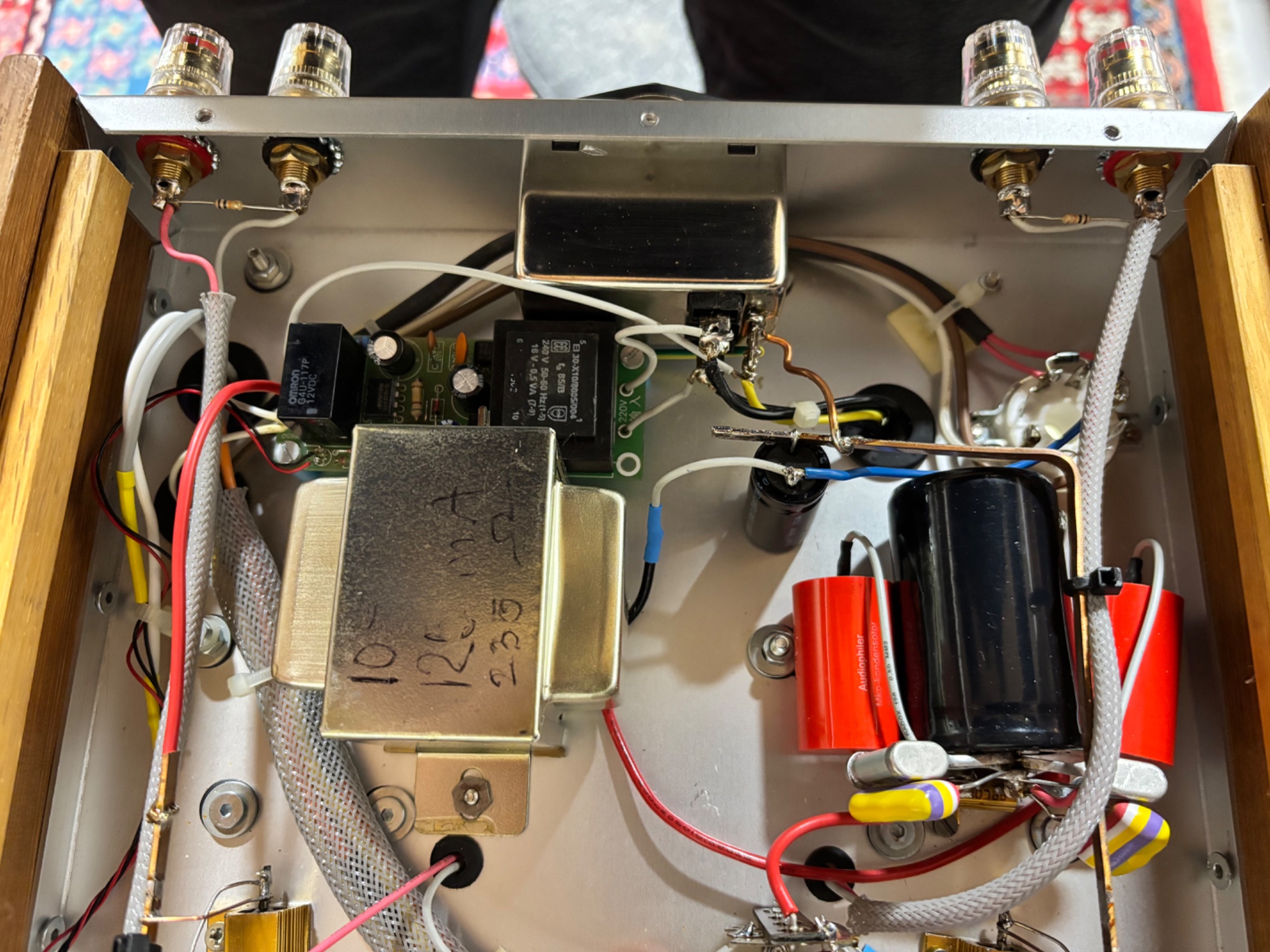

The opts secondaries are conected to the 0V busbar end (were PSU caps and conection to iec-earth (via a 5R NTC) is connected. The rca inputs are in the amplifier front and the speaker outputs/opts are in the back, hence they had to be conected 20cm appart on the busbar. Othervise a 20cm long cable had to be used, and I gather the 5mm2 thick busbar is a better alternative.
Previously it had a startup delay unit, connecting the PSU gnd to the busbar after 30 seconds. I’ll removed this unit and connected HT gnd directly to the busbar where the first PSU cap is grounded.
The input rcas (cold) are grounded directly to the busbar with short wires.
The spigots you saw was old solder. The real conection is on the lower side of the connector.
I doulechecked the hum canceling pots for the 2A3 AC heaters. But in this procedure I’ll tried to move the pots, to see if an unbalancing could influence the unvented peaks. However, this didn’t change anything.
The rectification of this amp were initially done with a 5U4 tube. However the HT was a bit on the low side so I changed this tube for silicon diods. The PSU filtering values are a bit hard to see without tearing the parts apart, but I can see that it is a C(20uF) - L(10H) - C(100uF) - R (?) - C(100uF). The last two C stages has additional PP- and mica- caps parallel to it,

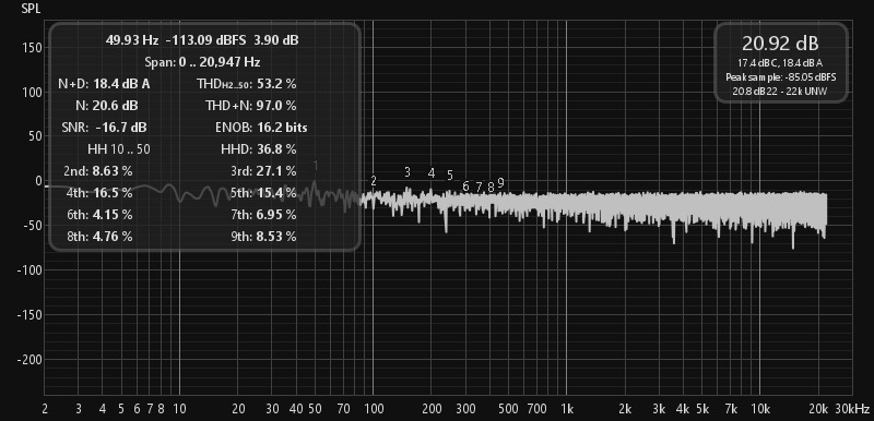

With all this done I can’t see any obvious improvements in measured values.

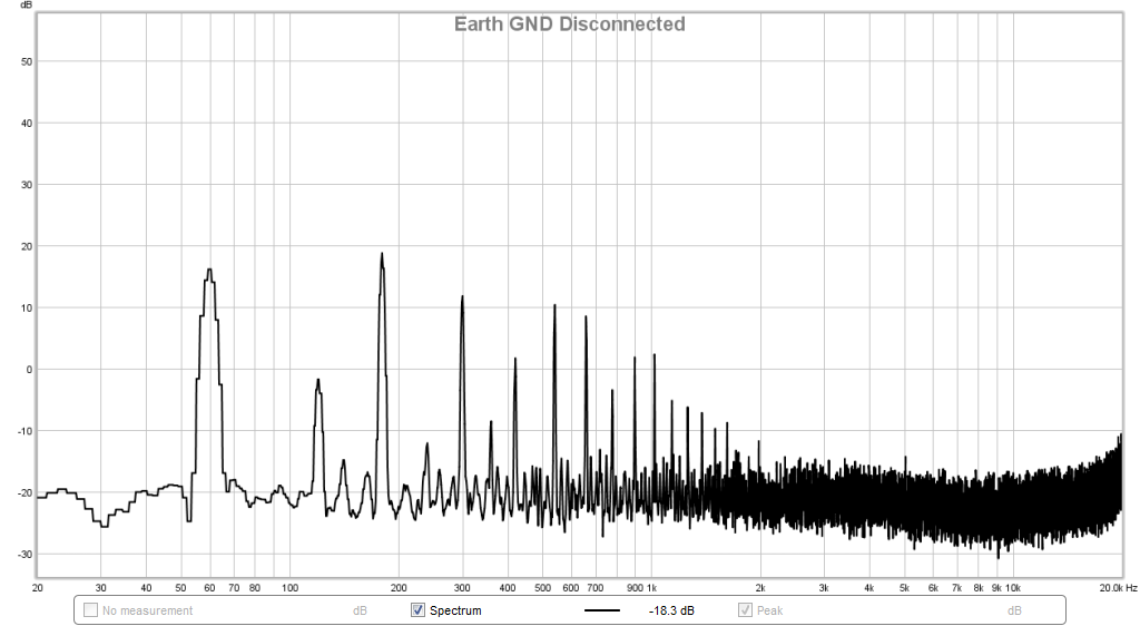

This is measured with amp turned on, but no 1KHz stimuli.
I’m not sure if the absolute values are calibrated, but the 50 Hz peak are in the range of 4-5mV.
This measurement is done with 1KHz stimuli on and 1W output to a 8 Ohm load. The 50 Hz peak is still in the -50 dBc range.
Are the power supply capacitor grounds and power supply ground to chassis as what I suggested in post #1926?
Where is the speaker ground connected to the buss bar? I see two black wires at the speaker negative terminal. The speaker ground should connect to the buss bar at after the last power supply capacitor. Where is the second black wire connected? I do not see a need for a second connection.
OK, I see that the second black wire connects to the other channel speaker ground connector. It is a small thing but I suggest connecting the other channel speaker ground directly to the buss and keep the ground wire away from the AC/IEC connector.
I do not see a ground loop breaker circuit between the power supply ground and chassis/power line ground. I do see the power supply ground still connected at the "dirty" end of the buss bar, not at the "clean" end.
Perhaps we should start a separate thread to address the noise and hum issues of this tube amp as this thread really is to discuss use of REW for measurements. Now that REW has shown that the noise floor is really dirty and full noise, let’s debug in a different thread. It is interesting for sure. The noise floor reminds me of the time I was working on Pass M2 and the onboard signal transformer was picking up a lot of mains EMI from the toroidal trafo nearby. The noise went away when I moved the trafo outside of the chassis or switched to a SMPS.
Noise floor looked like this:
Reactions: DNi
I see a direct benefit if pixworld can present a set of REW plots that are based on a valid plot of noise floor, as that then allows confidence in interpreting subsequent before/after plots for noise floor improvements or distortion measurements. The path taken to show a valid measurement setup noise floor is imho worthwhile as that seems to be an issue that besets a few when it comes to displaying low level harmonics.
At the moment afaik, pixworld's most recent plot in post #1928 may include noise due to a ground loop related to signal input and speaker output via the internal busbar. The OPT secondary is only being used for speaker connection, so it can be linked to the busbar by any low signal wire as that wire won't carry speaker signal, and would only carry parasitic currents from internal transformer capacitances, as well as avoiding a floating speaker output and any safety risk related to that aspect. So imho, linking the speaker circuit over to the input signal point of connection to the busbar avoids any busbar noise polluting the REW plot when the soundcard/PC is all floating. And making the effort to take a baseline plot with soundcard output and input connected to the amps input only then provides a fair assurance that nothing else is polluting the measurement noise floor.

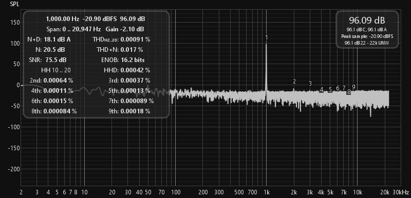

Not sure when John M added the action function "Set from RTA" to the 'Add harmonic distortion' feature of the Sine tone generator in REW, but I just had my first play of that function. Some years back I had manually 'tuned' the harmonic magnitudes and phases to minimise harmonic distortions into the noise floor when trying to deduce how low I could get THD from my EMU0404, and see how near I could get my soundcard to a 'poor mans' version of Victor's 1kHz oscillator.
To John's credit, the 'Set from RTA' does an excellent job at automating the process of adjusting residual harmonic magnitudes and phases to give the best THD performance capable from a soundcard, or test jig in loopback. I'd anticipate this could lower your test system's distortion level by 10-20dB for fixed frequency/level measurements on equipment.

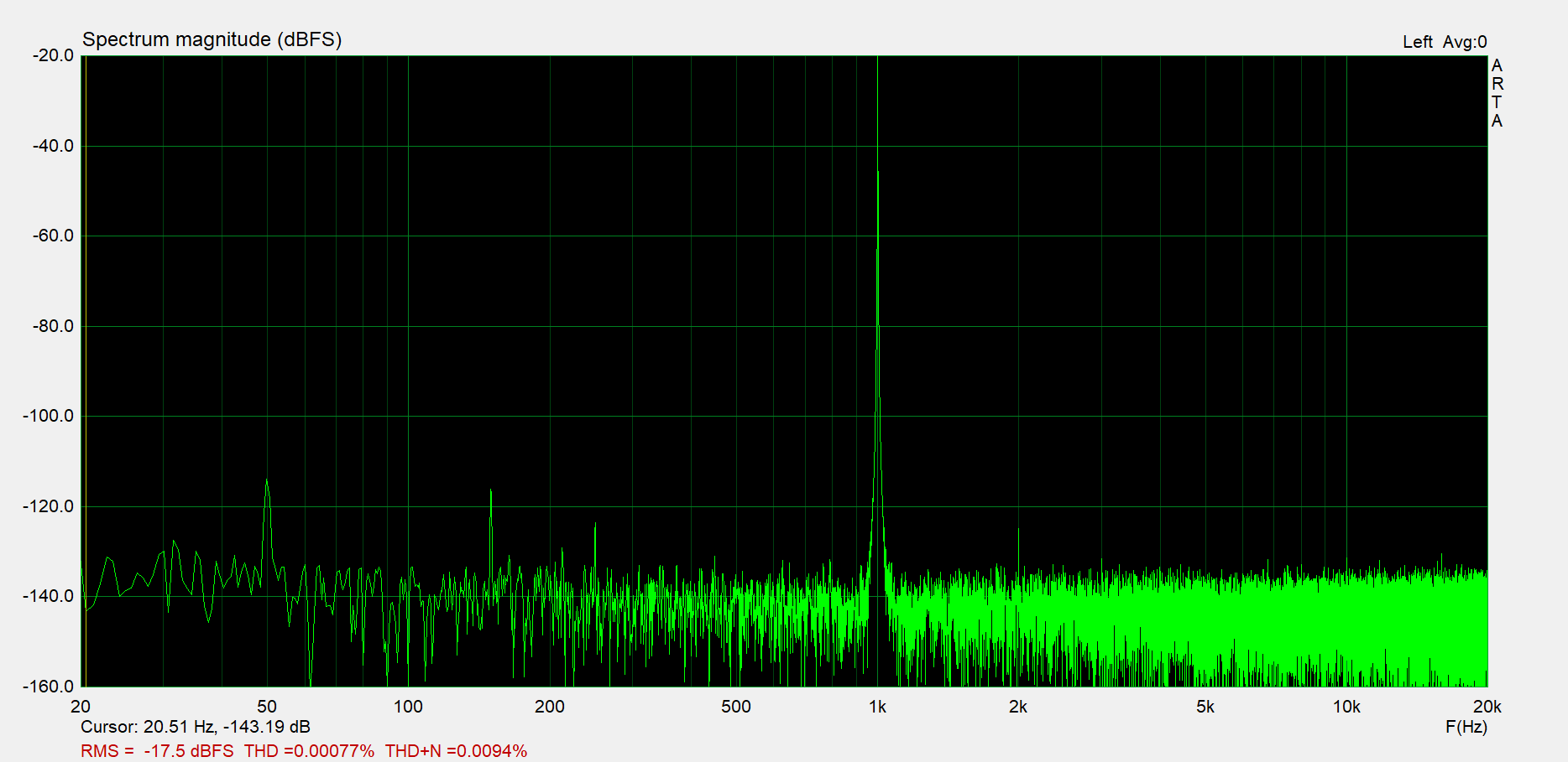

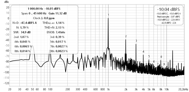

I am trying to setup a measurement rig with rew and using iD4 mk1 interface. This is the reading I am getting without any connections to input and output
And this one when connecting the output to the input directly using a cable ( no load is used ), and using the signal generator of REW
Is the noise floor too high? or is it because some setup issues?
