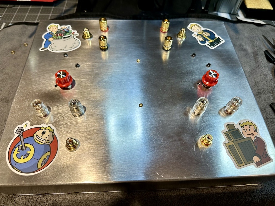

Also the magic box, headphones version is done:

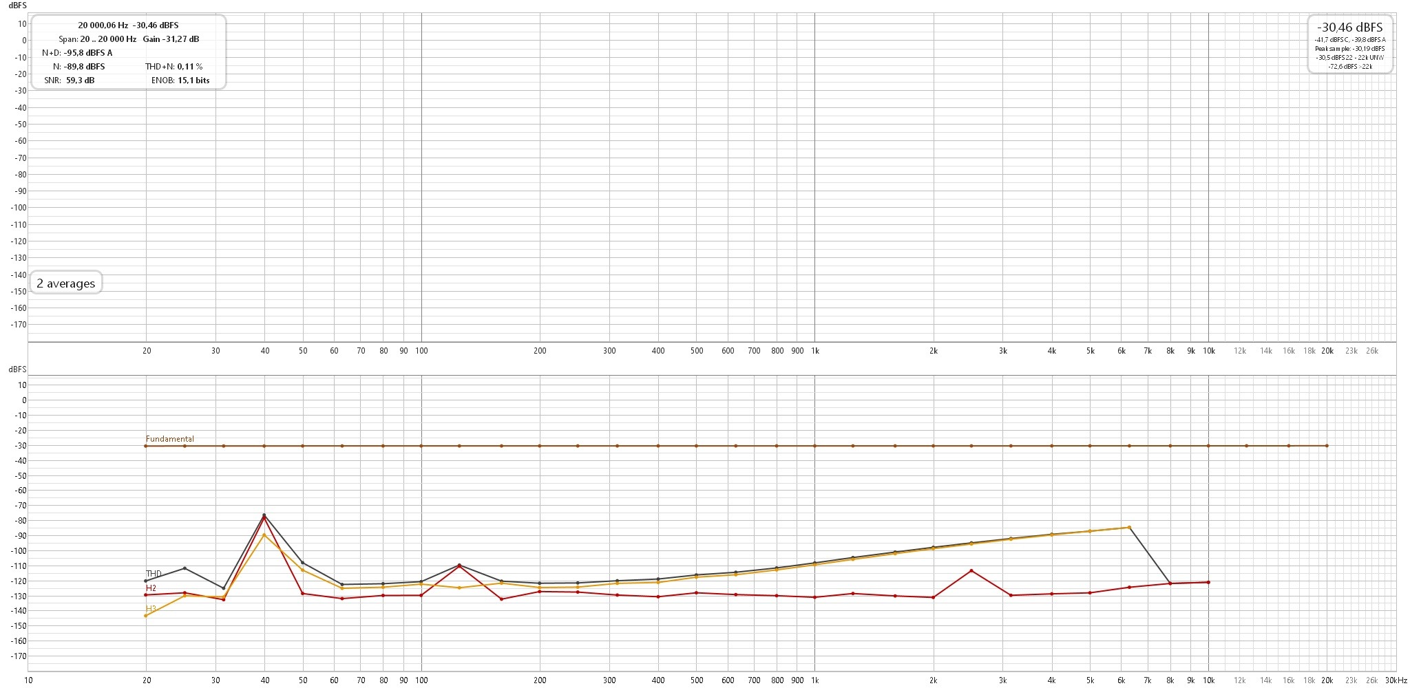

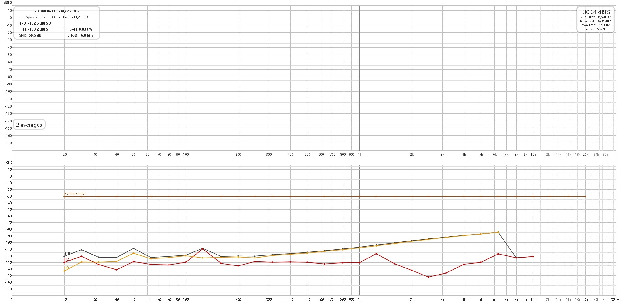

I built a measuring bench with REW, a Scarlett 2i2 and a load of 8R 100W in a box to measure amp boards.
The problem is that depending on the type of attenuator, I don't get the same result at all (see the two measurements).
I made two -20dB attenuators to compare them. One with 1K/110R and another with 10K/1K1. The REW and Scarlett settings are the same.
So, I don't know where the truth is.
Stef.
