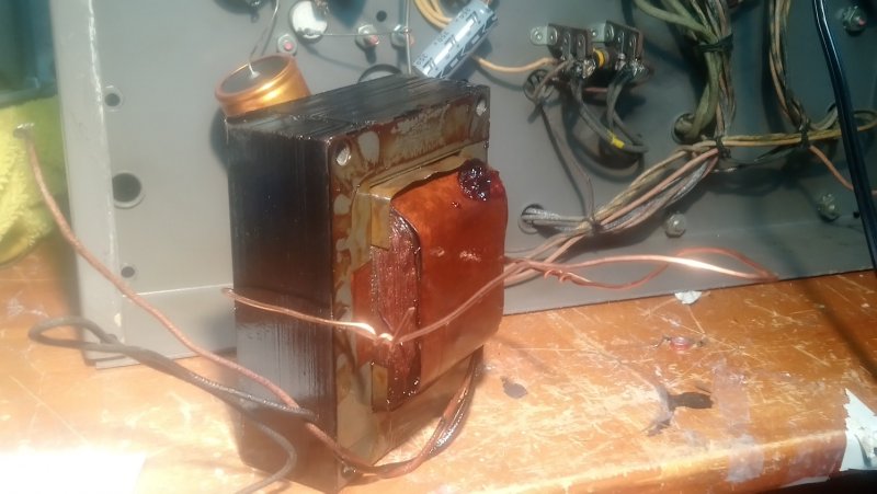

I finished the first coating of the first choke yesterday, and gave it a try today.
I would call it an unqualified success. The buzzing is 95% gone, and now all I can hear is the power transformer hum. I checked it against the other amplifier, and on that one the choke buzz still dominates.
While in the past you could hear it anywhere in the room, now you have to be within 12 inches, with the furnace shut down to kill ambient noise.
I think that due to the high magnetic forces in this choke, to get better would be very difficult if not impossible.
Still, I'm going to give it two more treatments, just for insurance.
Thanks to all who have contributed to this thread. I will update once I've made more progress.
At the moment I cannot do the power transformers, since the vendor sent the wrong vacuum chamber, and the one I have is physically too small to fit a power transformer.
Note: that blob on the bobbin is wax from the original setup, I didn't try to clean it off for fear of damaging the fragile paper. Same with the staining on the laminations, that's original varnish which was deteriorating and is now locked in. That paper would disintegrate by touching it before, now it's like I laminated it with plastic.

So yesterday I decided to apply a second coat to the choke. The first thing I did, was put the choke into the oven, to warm it up again. The toaster oven I bought got too hot, and the varnish on the bottom where it was in contact with a metal pan turned liquid - apparently it wasn't yet cured all the way though, it became a gooey mess.
I wiped off the gooey stuff, and gave it another dip in the vacuum tank. The second coat took well, and there were a lot less bubbles this time. I then brushed some extra varnish on the surface.
A day later, the surface has skinned over and dried well, but I can see liquid pockets of varnish where I brushed it on thick. I thought a thick coat would help tame vibration, but I think I created a problem.
I tested the choke electrically, and it still reads good.
I'm going to let it cure for a week now, and see how it dries. I think I made some mistakes in my haste to get a second coat on. Hopefully there are not any long term negative consequences.

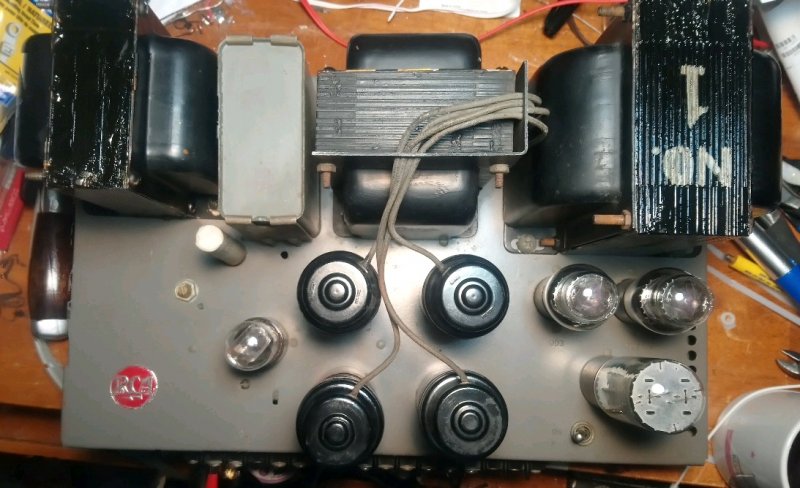

Here is the first amplifier, completed. The transformers have both been vacuum impregnated. Result is that buzz is 100% gone, and hum is about 90% gone. It used to sound like a defective magnetic fluorescent ballast, now it sounds like nothing unless you're up close. The one in the middle is the audio output transformer, and I didn't touch it, and don't plan to.
It does make a bit more noise at full power, but under real world conditions this will be entirely masked by the sound of the speakers.
I didn't paint the transformers. The varnish could LOOK a bit nicer, but I was mostly focused on performance, and I believe I got rewarded nicely.
I have the first transformer for the second amplifier drying now. Each time I do this, I refine the process a bit - I will probably be good at it by the time everything is done.
