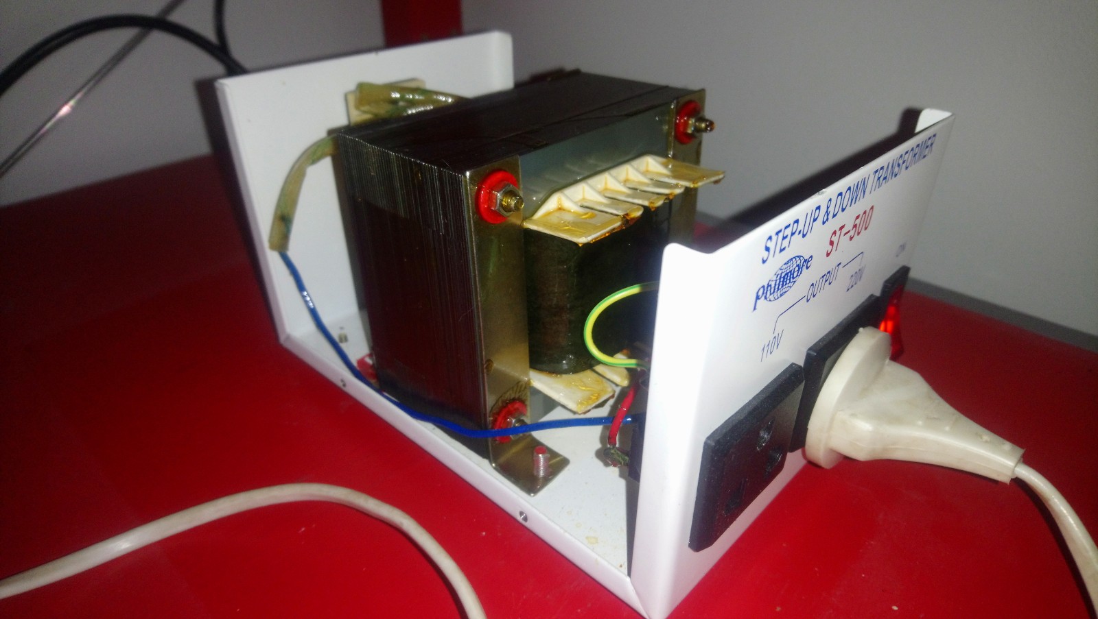

I added step 4.5, you're right 🙂
I haven't yet added a means for vibration, but I had a thought. I'm going to be using a large piston style compressor to drive the vacuum pump. If I can securely place the chamber on top of the compressor, it can kill two birds with one stone... heat up the varnish a bit, and also vibrate the heck out of it.
So today was the first trial. I didn't have the oven yet, so I preheated the transformer in the normal oven, to 65C, on a disposable tray.
The vacuum chamber is cool, it works as advertised. I cut a plastic milk carton as a liner for the chamber, and filled it with varnish. I then degassed the varnish by drawing a vacuum, and it swelled up with bubbles like a beer with too much head. It then settled down. Then I placed in the pre-heated transformer, and drew a vacuum again. This time lots of bubbling, from every pore of the transformer. After half an hour it was settled down to nothing, I let the air in, and pulled out the transformer. As the oven is not yet ready, I suspended it in front of an electric heater. So far, so good!

This morning it was totally dry, and really glossy. Everything is evenly covered, but I noticed that there's not a lot of mass on the windings, it got a fairly thin coat. The laminations are totally saturated however, and the screws are completely glued in with varnish. I did some small transformers and chokes at the same time, which did not get the pre-heating or heat to dry, those were done only with the varnish.
The acrylic lid of the vacuum chamber exhibited some crazing due to the solvent in the varnish. I am getting the vendor to send me a tempered glass lid, since it will be more resistant to solvents.
For the test piece, I'm not going to give it a second coating before I check it for vibration, and see how well the impregnation effort worked. I think for the RCA transformers though, I will do two or three dips, just to make sure it's absolutely perfect.
Another issue is my vacuum pump can't get to -30 inches of mercury, it can get only to -26. I think it may not matter though, a huge quantity of air escapes at this vacuum level.

I'm already blown away by how well the vacuum works at removing air from the transformer. The first five minutes are quite turbulent, as you can see by my short video I linked above. It then settles down to 15 - 20 minutes of fizz, followed by occasional bubbles, and eventually nothing.
What was really impressive, is how much air came out of the varnish before I put the transformer in.. it foamed up so high, I was worried I would start sucking varnish out of the container along with air. If someone is doing this, definitely make a point of degassing the varnish before putting the transformer in.
At this point I'm not totally convinced vibration is necessary, the vacuum alone was very effective, and allows the whole process to take place safely on my work bench.
One thing I will also mention, is I didn't thin the varnish, and was able to recover about 80% of it after the work was done. Some was lost to the container being impossible to fully empty, but a lot ended up in the transformers too. I started with a 1 quart can.

Well. I came home and it was totally dry, so let's try it!
Hum is 99% gone, this thing used to hum so you could hear it across the room, now the ear has to be closer than 30cm in a silent room.
Of course, 99% is not 100%. Ideas for improvement include better varnish, using multiple coatings, and trying to achieve a better vacuum. I think - 26inhg is only an okay vacuum.

Top effort, and quite within the realms of diy.So today was the first trial. I didn't have the oven yet, so I preheated the transformer in the normal oven, to 65C, on a disposable tray.
Can you conceive a way to suspend the transformer above the resin and pump both down prior to then lowering the transformer in ? That may achieve a better wicking in to a higher % of available space, although trying to make a comparison would be fickle.
Given that vintage transformers would be a target application, it would be interesting to get some views on cleaning away as much surface contamination as practical first, especially for transformers without bell-ends, or without full taped covering of windings.
Did any of your smaller test transformers come with mounting holes in the core? Plugging holes, or avoiding varnish buildup that caused hassles with fitting bell-ends again or removing clamping bolts to remount a transformer, may be a hassle in some situations.

Thanks for the encouragement. I am not sure of an easy way to lower the transformer after pumping down, but I will think about this. There has to be something.
See my post just above yours for a pic of the test mule.. This one is too new to have end bells. When I pumped it down, you could see the air coming out of the bolt holes, I suspect it is all one big blob of varnish now.
