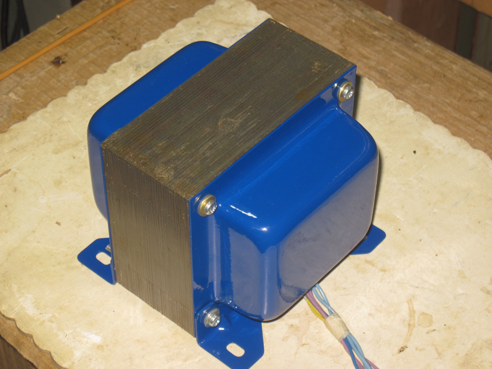

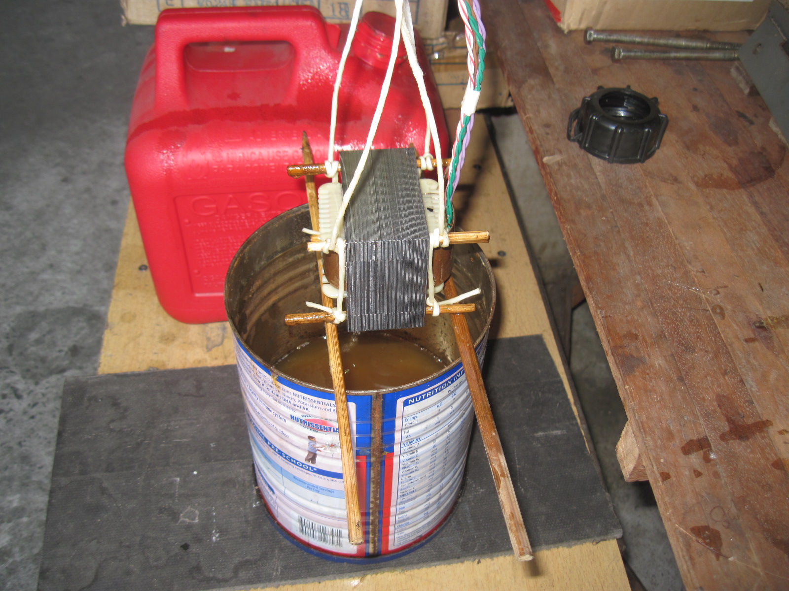

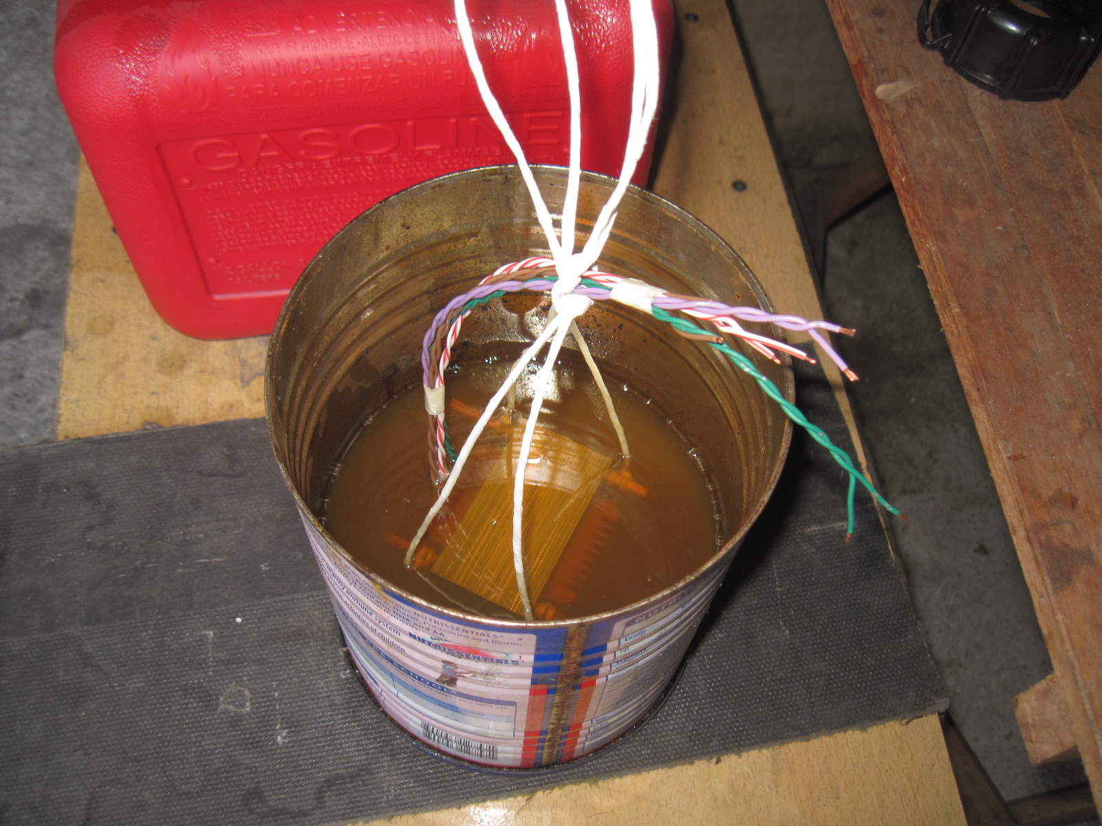

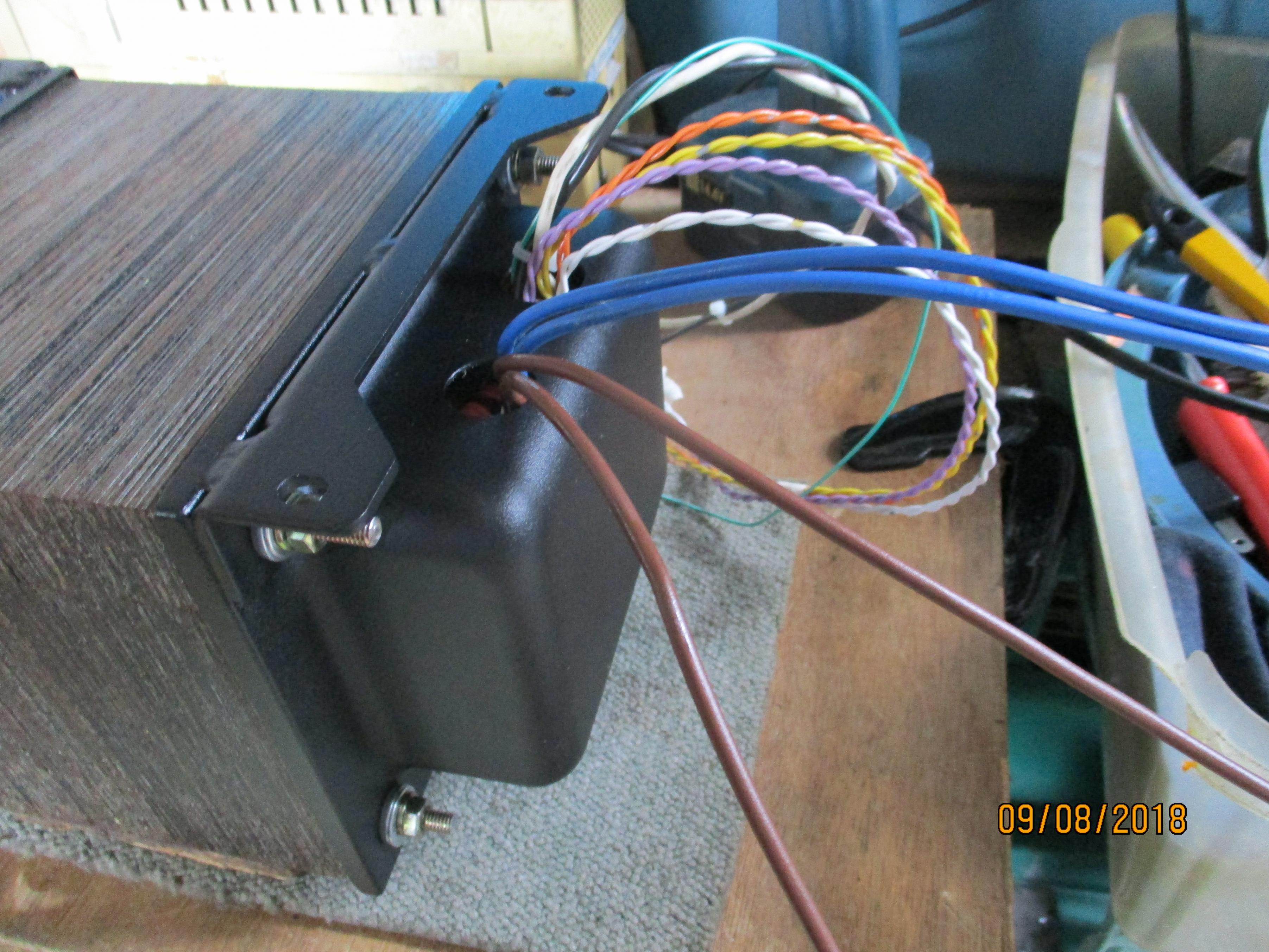

@FauxFrench, when i dip my traffos in varnish, i do it without the bolts and nuts and end covers installed.....only the windings and the laminations.....i use bamboo sticks in place of the bolts and nuts so the traffo can be handled...
Really nice looking final product. I like how smooth the blue paint looks too.
Do you wait for the varnish to dry before installing the covers? I appreciate all the photos, it makes it easy to picture.
a week under the hot sun....and the traffo is ready to assemble...

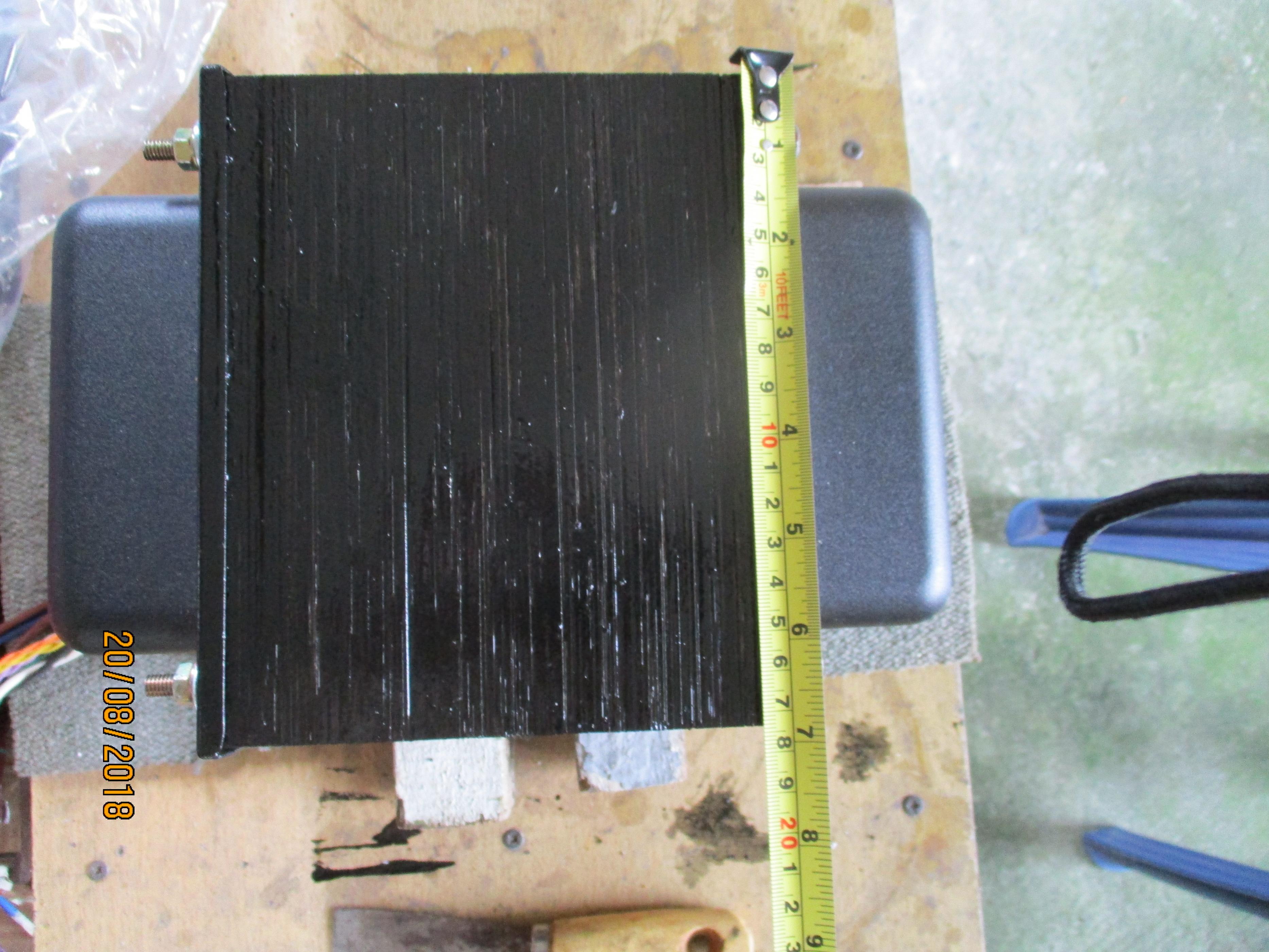

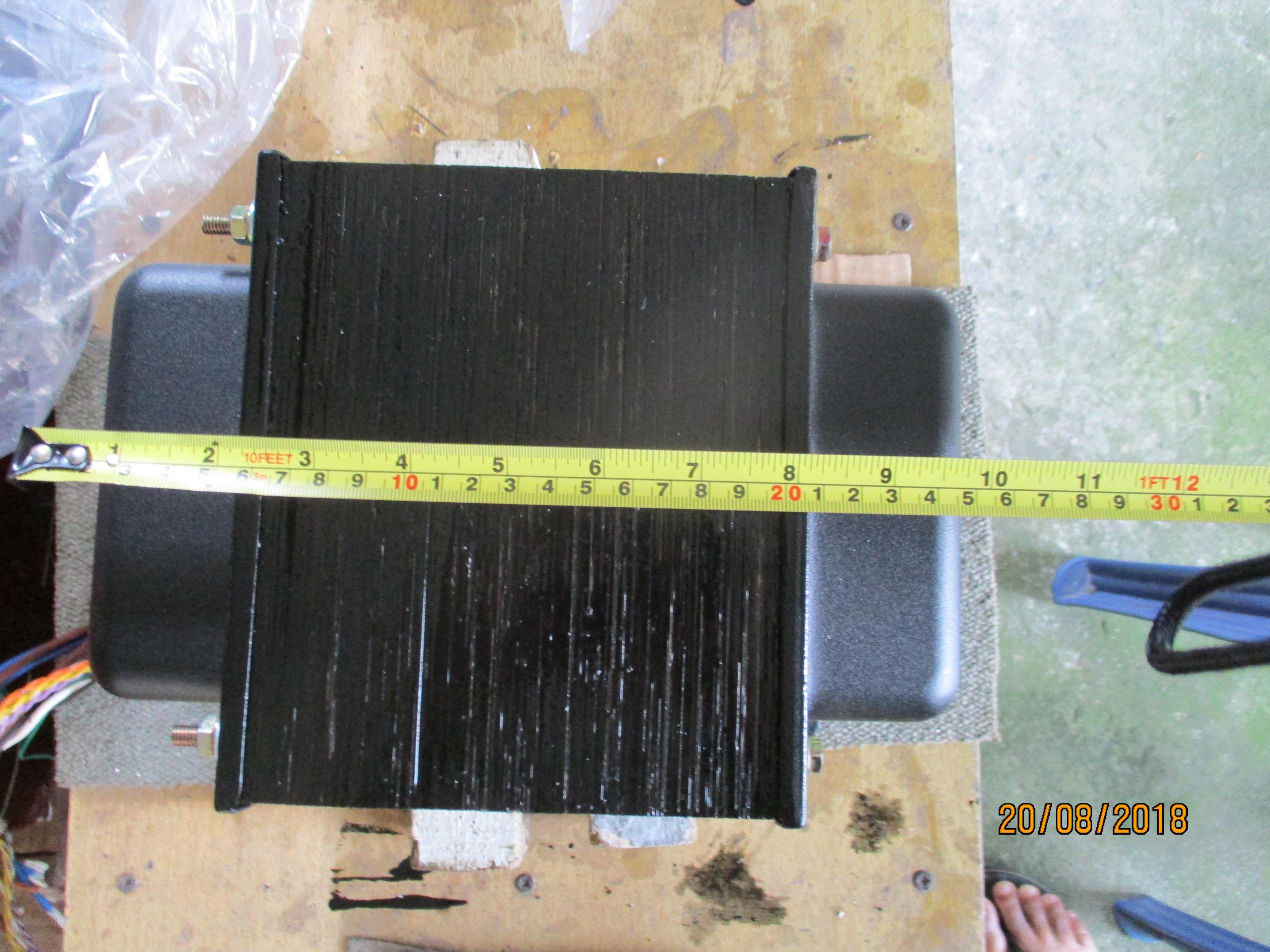

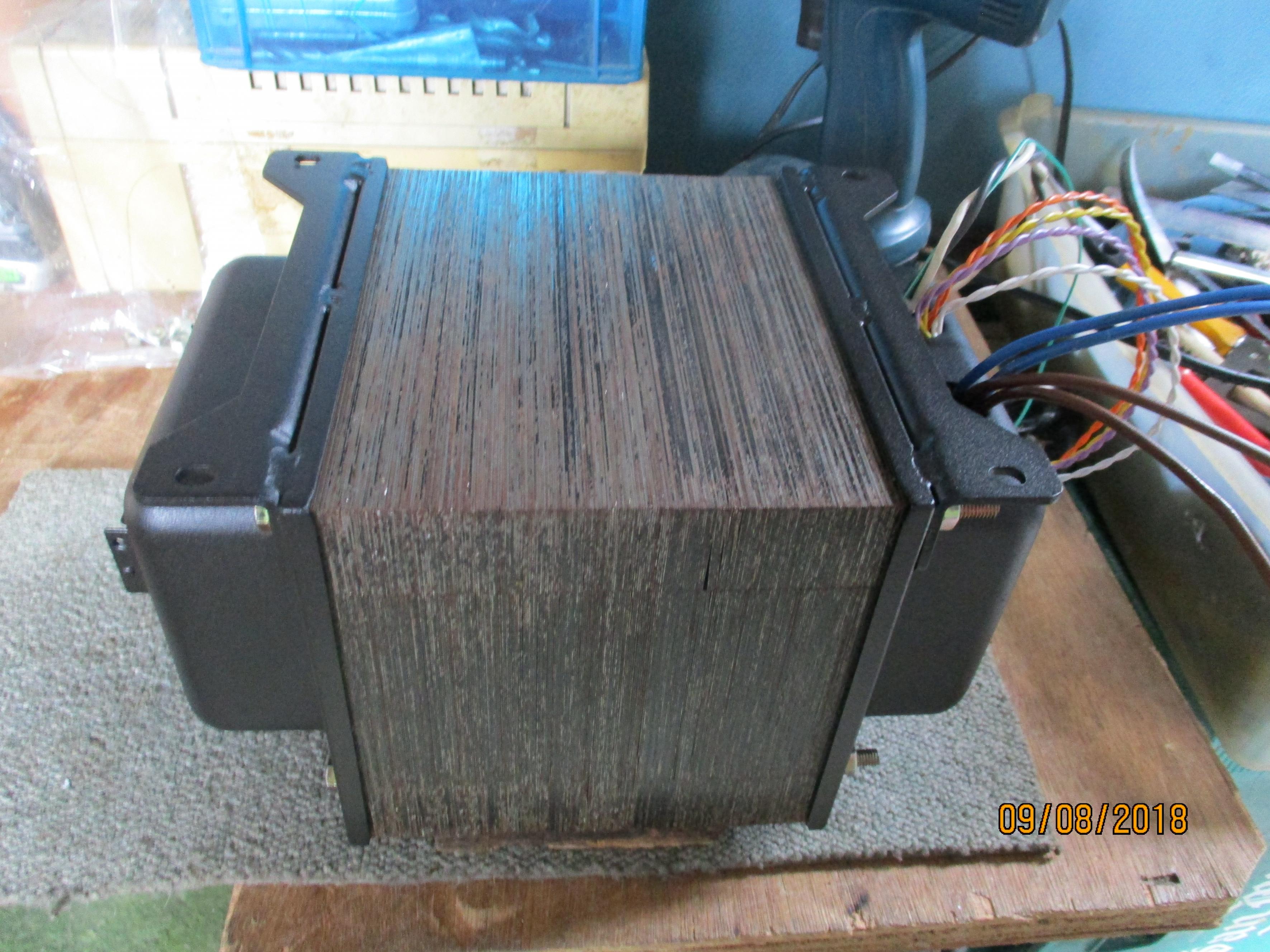

this is a 58 pound traffo i recently made...

This is a shame, I read your other thread, and saw what kind of work you do.. COOL! I've built plenty of amps, but never wound my own transformers, and yours look interesting.
Man that one is a monster, what are you powering, an apartment building? 🙂
Hi Tony,
You make very pretty (and large) transformers.
The bamboo-stick idea is really fine for your process. Using vacuum impregnation, I would fear that the resin gets in between the bamboo-stick and the hole-wall such that you cannot get the stick out again. Vacuum impregnation is really efficient in getting the resin in everywhere (also where you do not want it). This is why I advise not to expect possibility of any rework afterwards.

i assure you, i never had any problem getting the bamboo sticks out, i made them so they are snug fit even after dipping in varnish...
i made them in various diameters and lengths, sometimes i even used some used chopsticks, recycling/repurposing is a thrill..... 😀
I made them in various diameters and lengths, sometimes i even used some used chopsticks, recycling/repurposing is a thrill..... 😀
