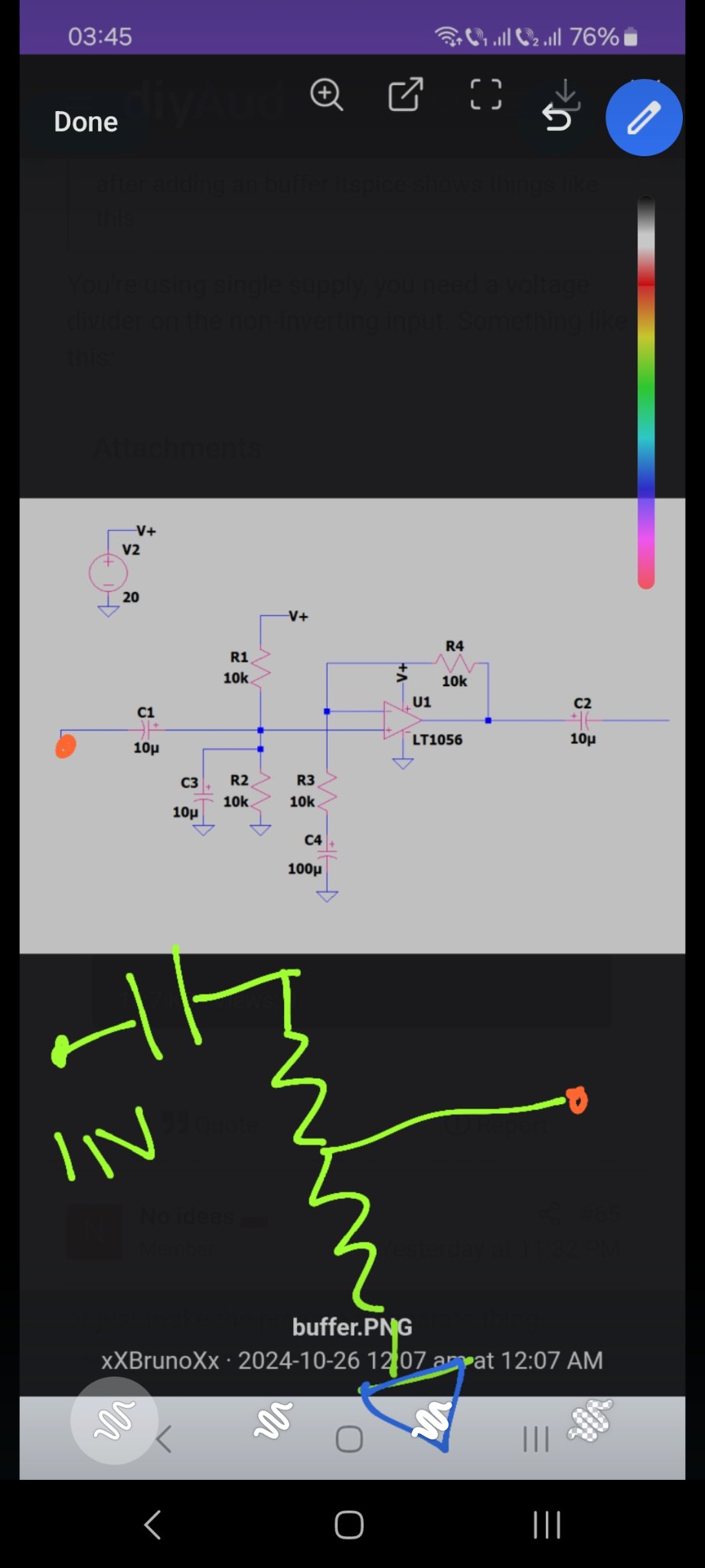

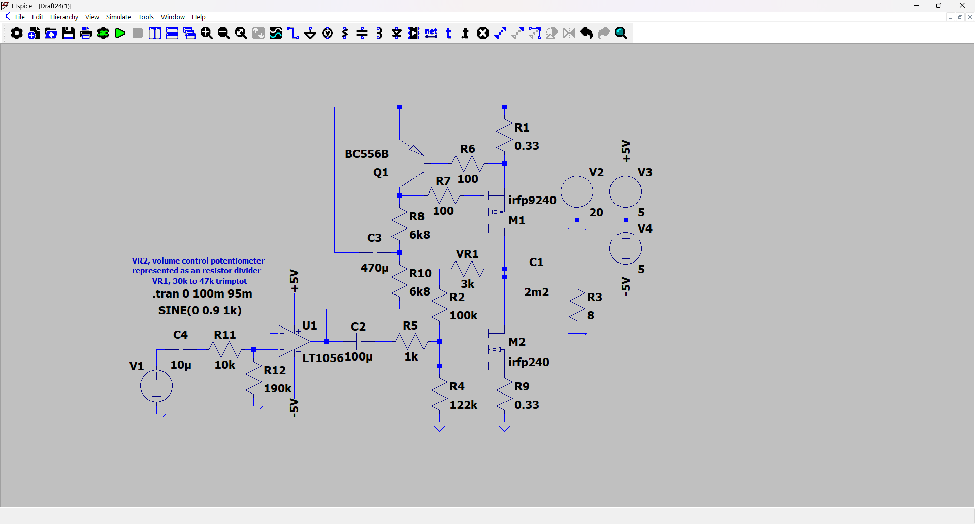

Becuse of this i would end up in capacitor hell if i would try to incorporate an potentiometer into your design.Yes but why, using separate power supply for the pre amp when you could incorporate it in your amp. ,
Treat R11 and R12 like a potentiometer
that would create an weird highpass filter which is what happens if i ignore the buffer stage in the first place
Nothing weird . Depending on the values of the input cap and the pot , it will be around 1 - 15 Hz.that would create an weird highpass filter which is what happens if i ignore the buffer stage in the first place
Or you can also make inverting amp and use the pot as variable resistor in the feedback of the opamp , changes the gain from 0 to whatever you want . -> changing the volume .
