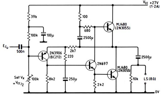

maybe i have a lot of NOS 2n3055's and all the mounting brackets neededThere' s smth that makes me believe that this class B 12 V car player of the 60' s beats the hell out of this zen design ...

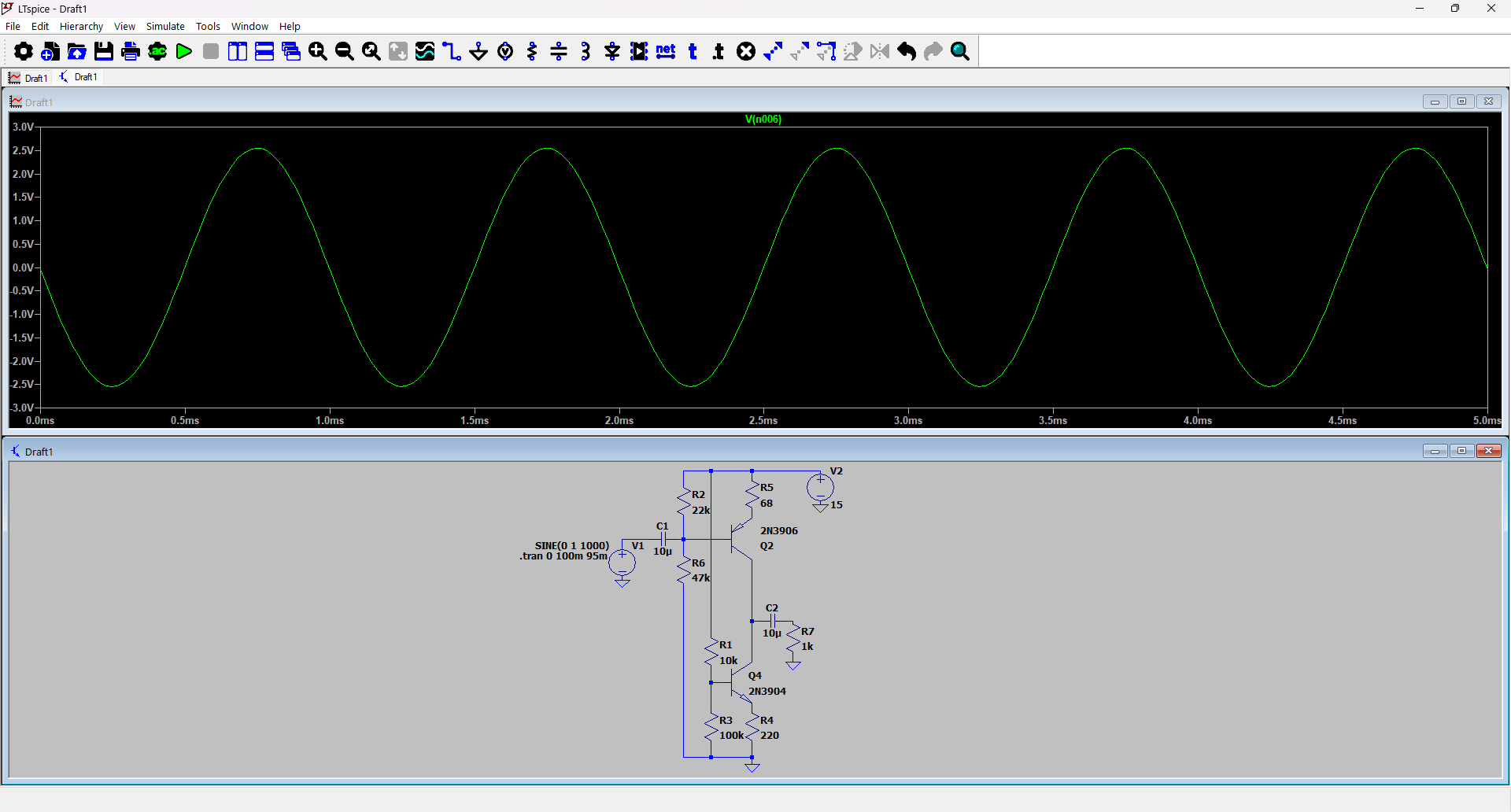

yes i also think that i should drive it with an op amp if i were to use an preamp anyway, main issue i have is weird biasing
yes the only issue here is volume controlso the signal source was not that great...

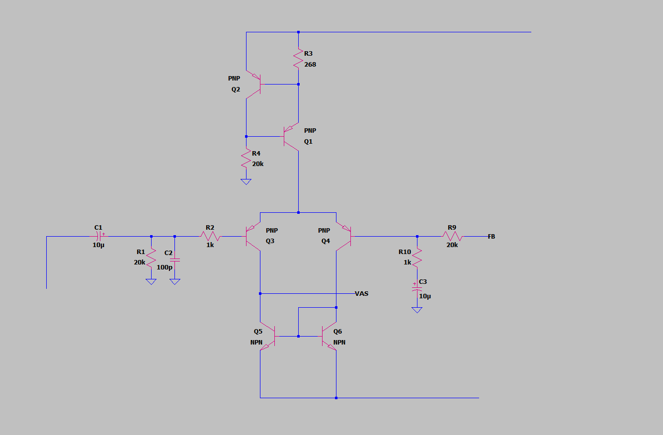

for class ab i have a bag of 2n3055. main issue is complexity becuse most designs add a lot of extras constant current sources etc. by simple i mean a long tail, pair diode/resistor biasing and an bootstrap circuit.

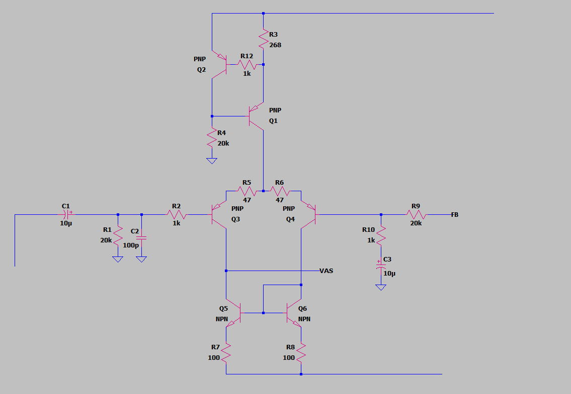

at this point i think copying the ltspice "audio amp" example and making few changes is the best course of action@No ideas Simplest Long tailed pair with constant current and current mirror, just 4 more transistors, and a few resistors.
