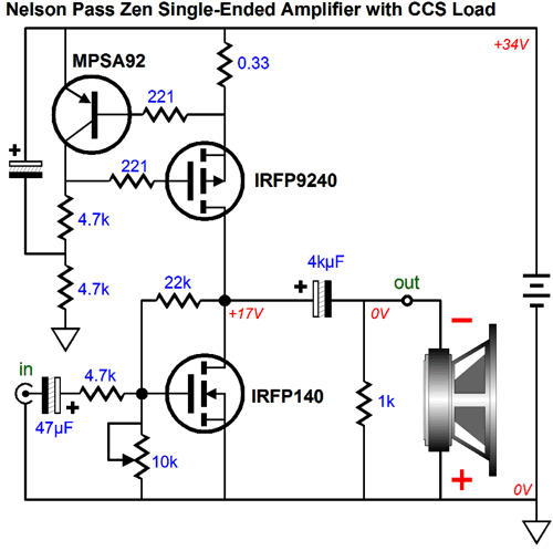

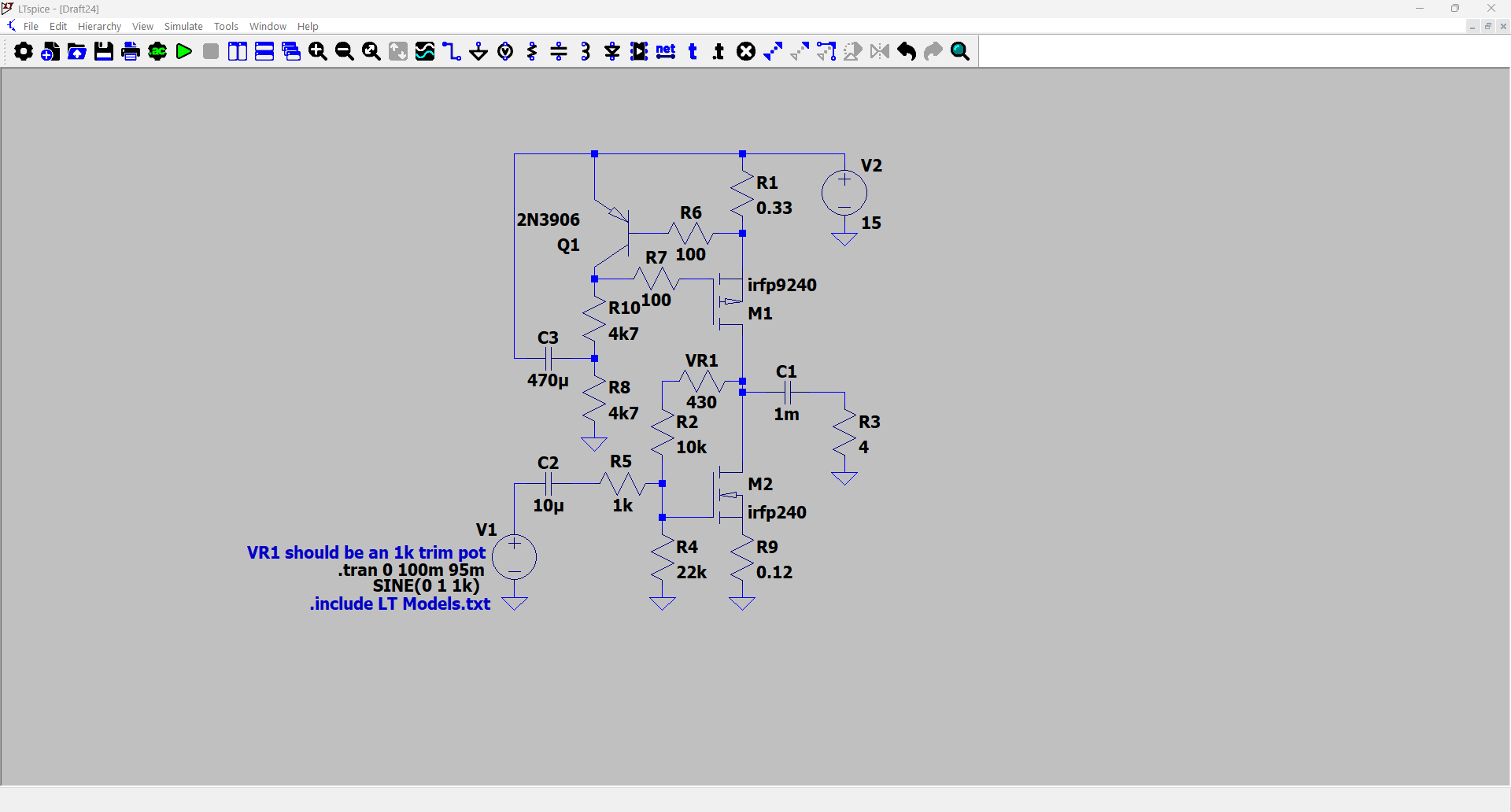

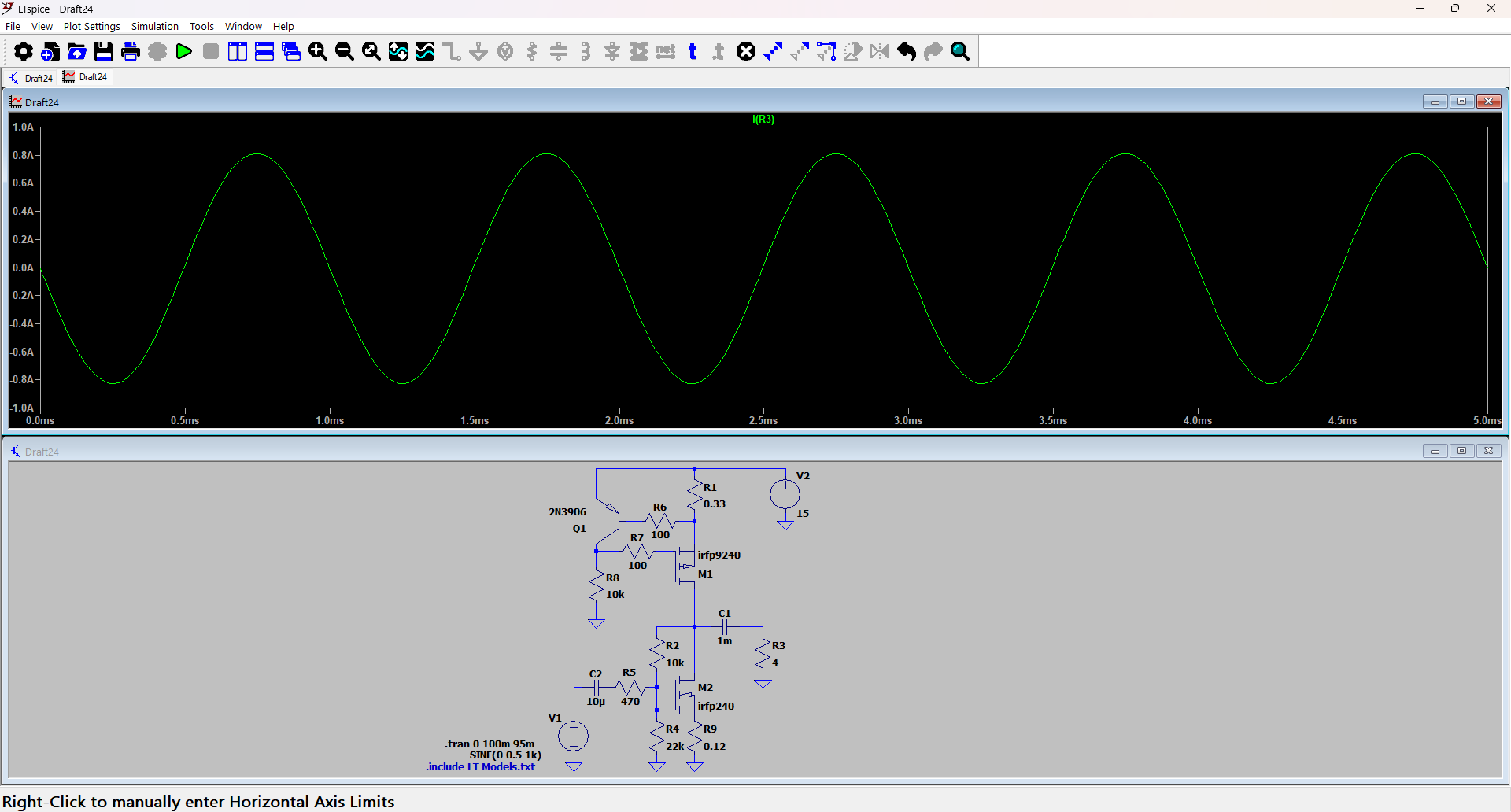

how to convert this amplifier to an 15/18V supply?
Yes but why, using separate power supply for the pre amp when you could incorporate it in your amp. ,
Becuse of this i would end up in capacitor hell if i would try to incorporate an potentiometer into your design.
Treat R11 and R12 like a potentiometer
