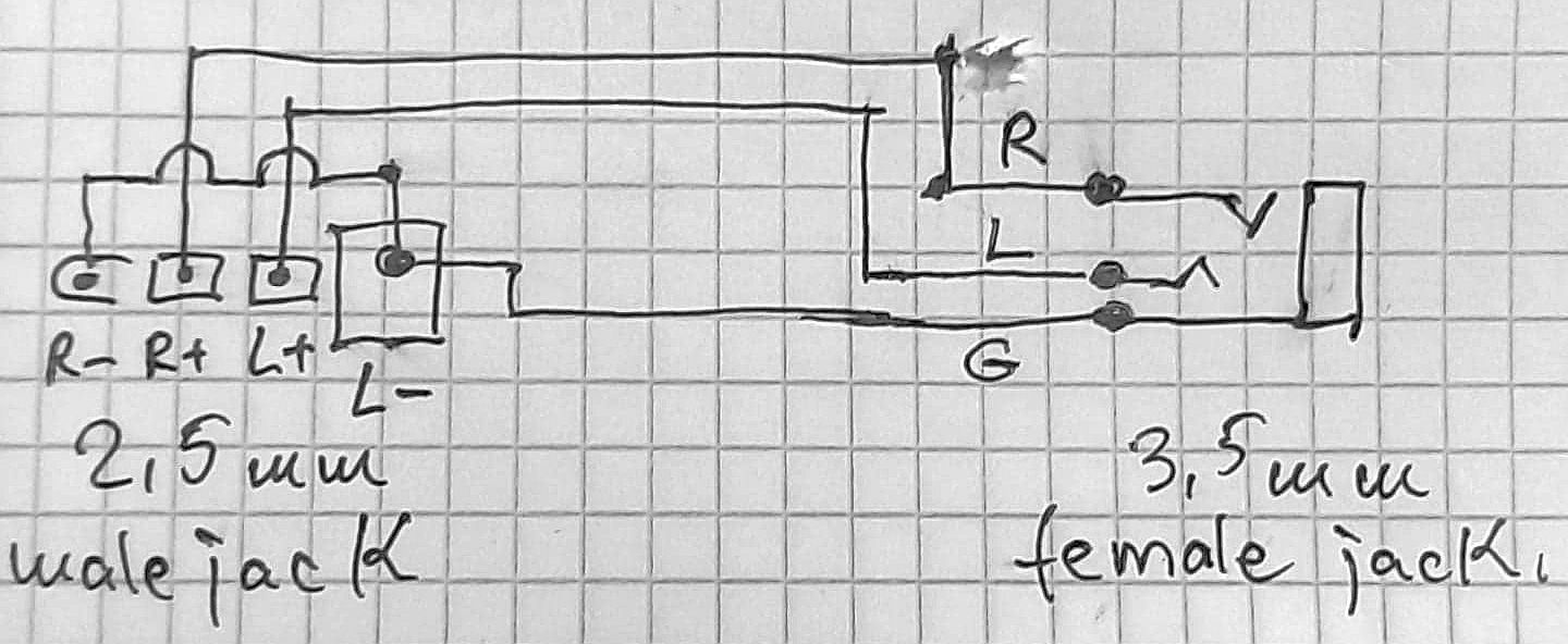

In the case of FiiO players or BT receivers, it seems the balanced connection brings more power, not because of the principle, but in this way they use two dac chips paralelled instead of a single one, as in a normal, SE conection. My question is this:
Can I do something wrong to the FiiO output by making an adapter from the 2.5mm output to a single ended 3.5 mm output?
In another words, is there some problem if I link together the two "minus" pins of the balanced output, R- to L-?
And, if I do this, can I still benefit of the 3 times more power?

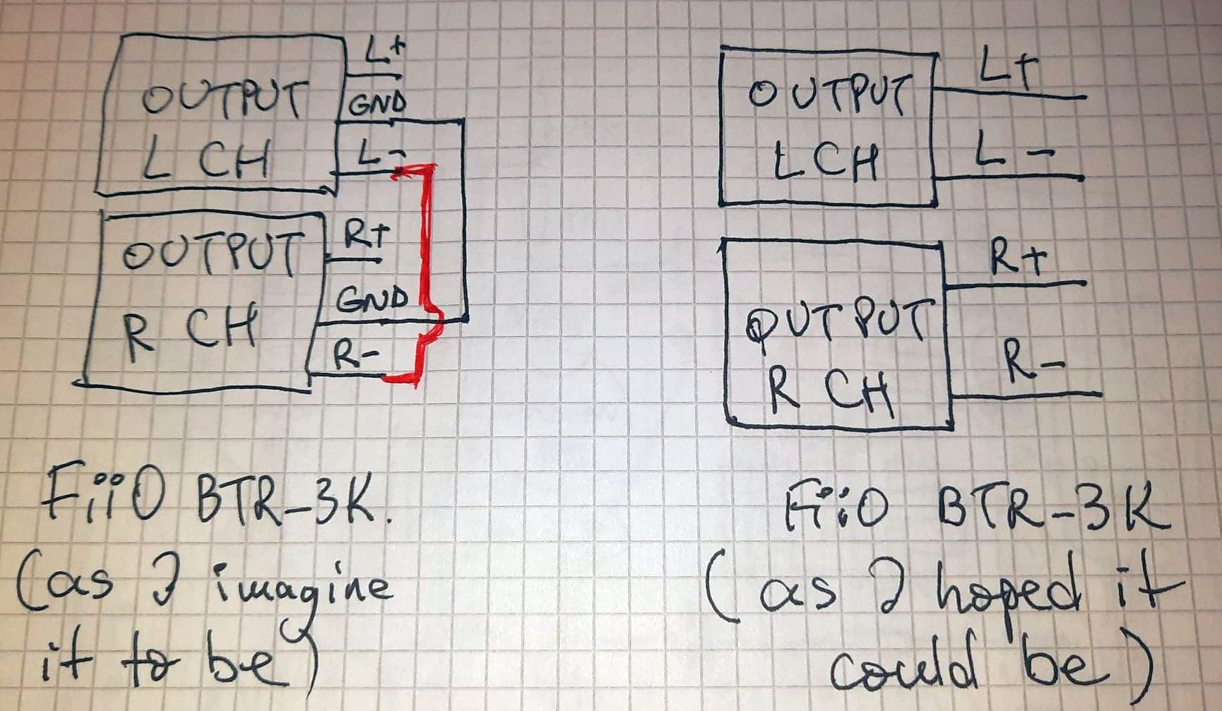

Whitigir, I know that. And I don't expect to make balanced from the unbalanced connection, just to know it there's any risc for the player to join L- to R- to make a SE output from the 2.5mm output in FiiO BTR-3K. The goal should be the 3 times more power from this output, compared with the 3.5mm single ended, which has only 25mW in 32 ohms.

^ If your goal is "more power", you will not achieve it the way you're describing. If you short the inverted signals to each other and to ground, leaving only the 'positive' waveforms referenced to GND, you have, by definition, removed 1/2 of your voltage swing. You can do the math to determine the resulting power differential. Yes, it will work, you will get music, but it won't result in more power.
Without a schematic, I cannot be certain, but there's also a chance that your product is already wired internally to short the inverted signals to ground during single-ended operation with the 3.5mm TRS plug.
tl;dr - I would avoid doing what you're describing if only because it will not have the result you hope to achieve. Buy or build the proper balanced cable if you want "more power".

I don't have a direct link to the GND of the 3.5mm...I imagine there will be something like two bridged outputs, I tie together L- and R- but I don't use the GND. Or, at least, that's I expect, and the headphones for this test will be high impedance, 250 ohms, so the double output voltage could be a benefit.
You ONLY get the increased power / voltage swing when using the proper cable and pinout. Build or buy one using the 2.5mm TRRS. Your diagram in #44 does not result in more power. You've just used a different male jack with (perhaps) the same internal wiring as when using the 3.5mm.

Perhaps I used some technically incorrect terms trying to make it easier, but instead caused confusion trying to explain L- and R- being actually shorted to signal GND. My apologies. Let me try to make it more simple.
Don't do that.
The R- and L- signals from the output would now be combined. They're just the inverted signals from R+ and L+. That combined pair is not a "clean" GND or OV reference. It's not the same as shorting the inverted signal to GND on the input of an amplifier like with an XLR to RCA converting plugs for an amplifier input. You're combining those two signals onto the same wire. You're not shorting them to a signal GND.
The combined L- and R- signals the way you have it drawn would now be referenced against the R+ and L+ signals independently for the L and R drivers. You can't just draw a 'G' on the diagram and that be a ground / clean 0V (or other) reference.. What you want is R+ referenced against R-, and the same for the left channel. That's how you get double the voltage swing with a differential signal. I can try to draw you a pic if needed.
NO, as previously explained (and even if it were wired properly). So, why not just use the 3.5mm jack that's already there?

OK, that I was afraid of....so, if there's previous reports that this doesn't work as expected, it seems that there is a common ground for both "balanced" outputs, so the real output seems similar to the microphones connection. In this case, if I link together L- and R-, the "negative" side will be parallelled and of course the quality of the signal will decrease, leading to distorstion...or worse.
My idea would have worked if the two channel could be totally independent....
No. That's where (not trying to be mean) your fundamental lack of understanding re: differential signal hurts you. There is no GND that is relevant for differential. The R+ is referenced against R- and the same for left as previously stated. There is not a ground (0V) reference. That's how you get double the voltage swing. If I have R+ at 1V against a 0V reference, the potential difference is 1V. If I have R+ at 1V against a -1V R-, I have 2V of potential difference. Make sense? Can't type too much more, b/c it's way OT now, and there's plenty of people and pictures that can do a way better job of explaining than I can.
Well, I understand the balanced connection, but I don't know what's inside FiiO....if it's like the left drawing, with a common ground for both outputs, even if not connected externally, then linking L- to R- will sound bad. IF the two outputs are independent for real, then it should work, like the right drawing.

Was AFK for a bit, as you were it seems. This is probably best kept for another thread. However, I will do my best (albeit most likely poorly) to try one last time to explain further....
Your diagram on the right that you wish it could be is actually precisely correct. That's the way it works with a differential signal. That's what you get from the 2.5mm TRRS jack from your device: R+, R-, L+, and L-.
Your diagram on the left is wrong as it relates to your 3.5mm TRS output. You have a 0V reference (a GND), but the L- and R- signals are not tied to it. If they were, then it would not be a 0V reference. I am sure there's someone that could explain better than I. My apologies. I hope my previous attempts at trying to describe a ground (0V) reference for a 'single-ended' configuration didn't cause you confusion.
