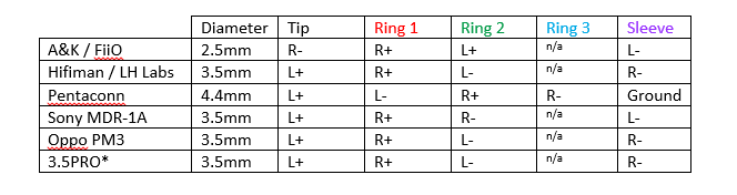

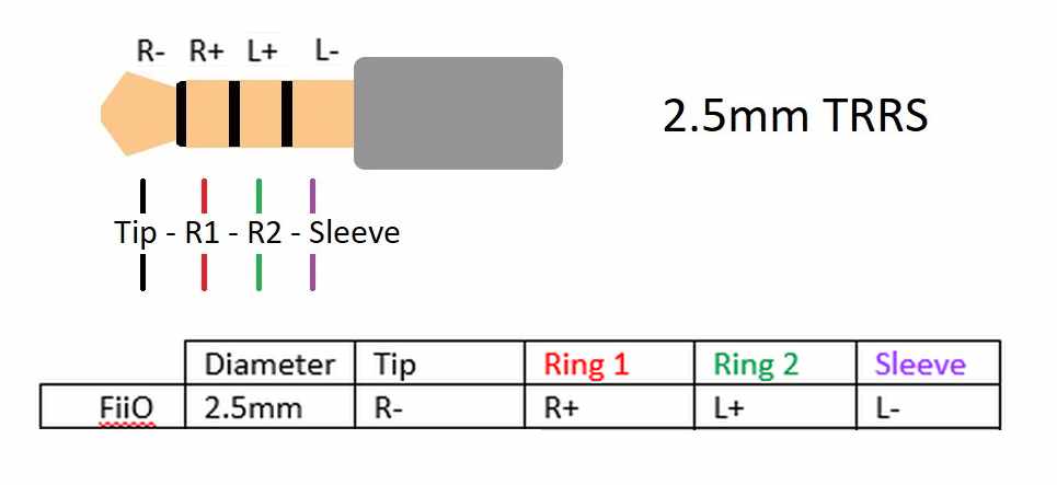

I had a long post written to help you with incorrect statements. Most of them don't relate to your actual goal. So, if you must proceed, here is an idea or two.

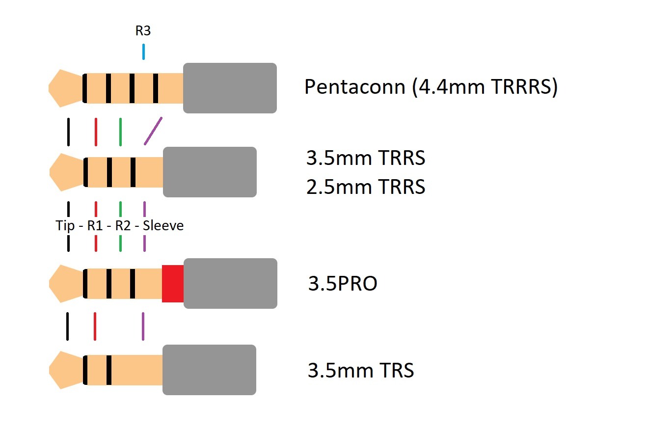

Get a 2.5mm TRRS plug and your favorite wiring etc and build a cable. Diagram below. It is 100% up to you to verify FIIOs pinout, but it's likely to the standard below. I think A&K had an odd one that deviated from below at some point, so it's important.
What I personally might do is buy something like this...
https://www.amazon.com/LC-2-5B-LC-3...t=&hvlocphy=9010632&hvtargid=pla-531244160288
Then I'd whack off the IEM connection ends, shorten to the length I prefer, and connect the wires to my HPs. Dress wires / add strain relief accordingly.
Note - the link is the first example that popped up. I am sure there are cheaper options, and I would not buy from a source that lists that it's a USB connection. :rofl: The only guidelines I'd follow are: to ensure it's a 4-wire cable intended for balanced HPs or IEMs: that it follows the FIIO pinout; and to not buy Litz wire, but that's just me. I hate prepping Litz / coated wiring for solder. Some love it. YMMV.
I have no idea what model HPs you have and whether or whether this will be worth your time and effort. Taking apart HPs can be a challenge. Actually, taking them apart is not too hard. Getting some of them back together to original spec is a bit of a job. 😀
It's been mentioned before, but ensure you have L+, L-, R+, and R- wired accordingly to each transducer. If you don't, the results could be disappointing.

Anyway, the drawings and diagrams you included have been very helpful to show what the connections should be for the 2.5mm Fiio socket.
