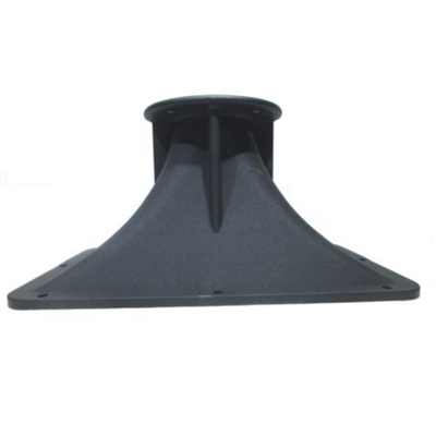

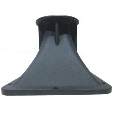

It seems as though there are not as many choices for a 2" throat compression driver as there are smaller throat sizes. [...] I figured some things likely have changed since the last update to this thread in 2016 and it was worth another ask. Any suggestions?
Seller zxpc on ebay has a few options e.g.
(A)
2" Throat Horn Bolt-On 18"x10"For Assorted Bolt On 2"Exit Drivers 90degx 40deg(398) | eBay
(B)
11" x 17" ABS 2" Bolt-On Long Throw Horn 90deg x 40deg For Many 2" Exit Driver 647356202421 | eBay
I used the latter horn (B) in this project:
Fairly big horn for 2" drivers - Album on Imgur
This is still in use, running >700Hz with a small 'full range' driver.
...though the 2380 should hold the pattern lower, so absent polar response/DI plots it would be my choice of the bunch plus short of one needing 100 W/1 kHz power handling can be XO'd lower, so recommend trying 7-800 Hz to shorten the C-T-C acoustic spacing.

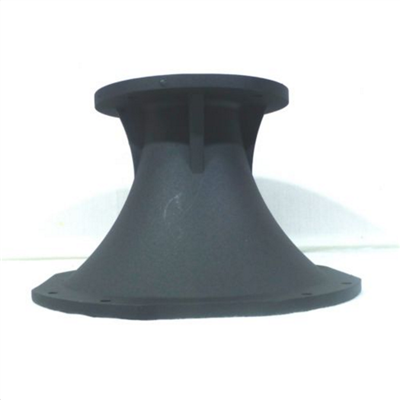

Another type I've considered are "audiopipe" and similar (car sound) horns, e.g.
Audiopipe 7.75" Octagon High Frequency Aluminum Horn for 2" Bolt On Exit Drivers 647356206511 | eBay

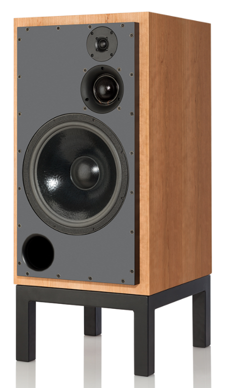

I like the shape, hate the bling. If I bought them, I'd:
grind off the shiny bits
repaint in basic black
rear mount (to a chamfered cutout) so it looked something like the attached image
That's an ATC speaker. The rear mounted midrange horn looks good, IMO.

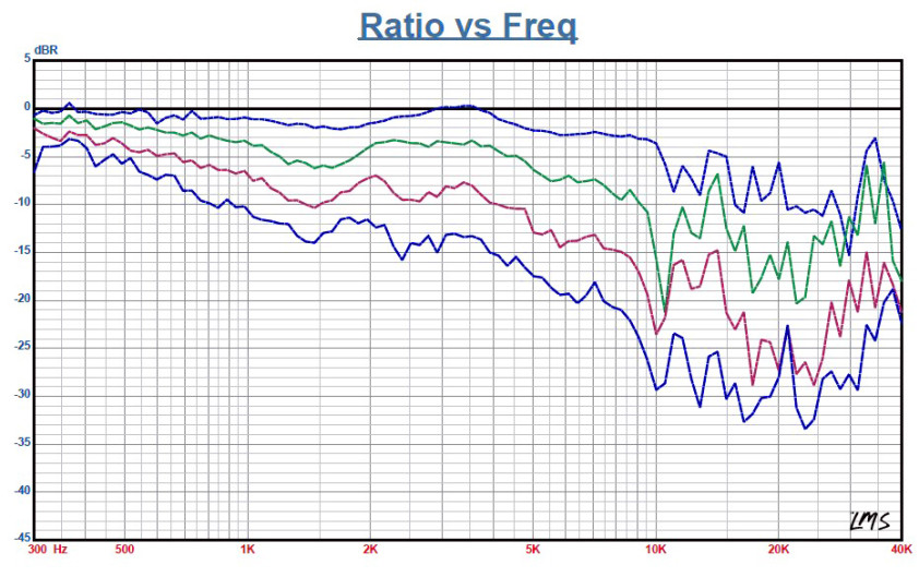

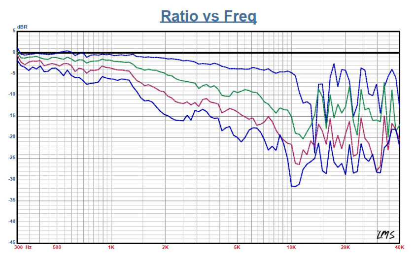

Exponential horns of similar dimensions should all be more or less alike. That is: if multiple manufacturers each make an exponential horn of the same length and mouth area, their LF cutoff points will all be the same.
The only differences will be in coverage angles, which, in the absence of a spec sheet, can be guesstimated.
e.g. the attached pics show that audiopipe horn flanked by the profile images of the H2EA (nominally 60x40 coverage, 700Hz cutoff). The audiopipe has a profile about halfway between those angles.
Also attached: normalized and off axis FR plots for H2EA, from Test Bench: Eminence N314T-8 with H14EA Horn and N320T-8 with H2EA Horn | audioXpress
