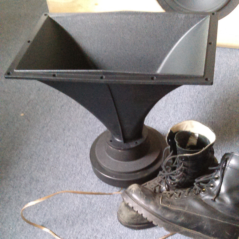

Thanks! I bought another horn that is similar, but with an exponential mouth flare from the same seller about three months ago, but didn't see this horn. That other horn isn't a bad horn from my testing but a little too large for my needs, particularly its depth which I attribute to the exponential mouth roll-out instead of tractrix.
I'll let you know how it measures with a 2" throat compression driver when this newer tractrix-mouth horn you identified comes in.
That's the one I got in January.
Different strokes: the depth is exactly why I got it 🙂
I wanted to get a horn that vaguely matched the throat angle of my drivers. I'd picked up an old pair of JBL 2445J. These have a ~5 degree throat angle, so they ideally need a <200Hz, slow expanding horn, like the Sato or the Inlow horns (about a metre long).

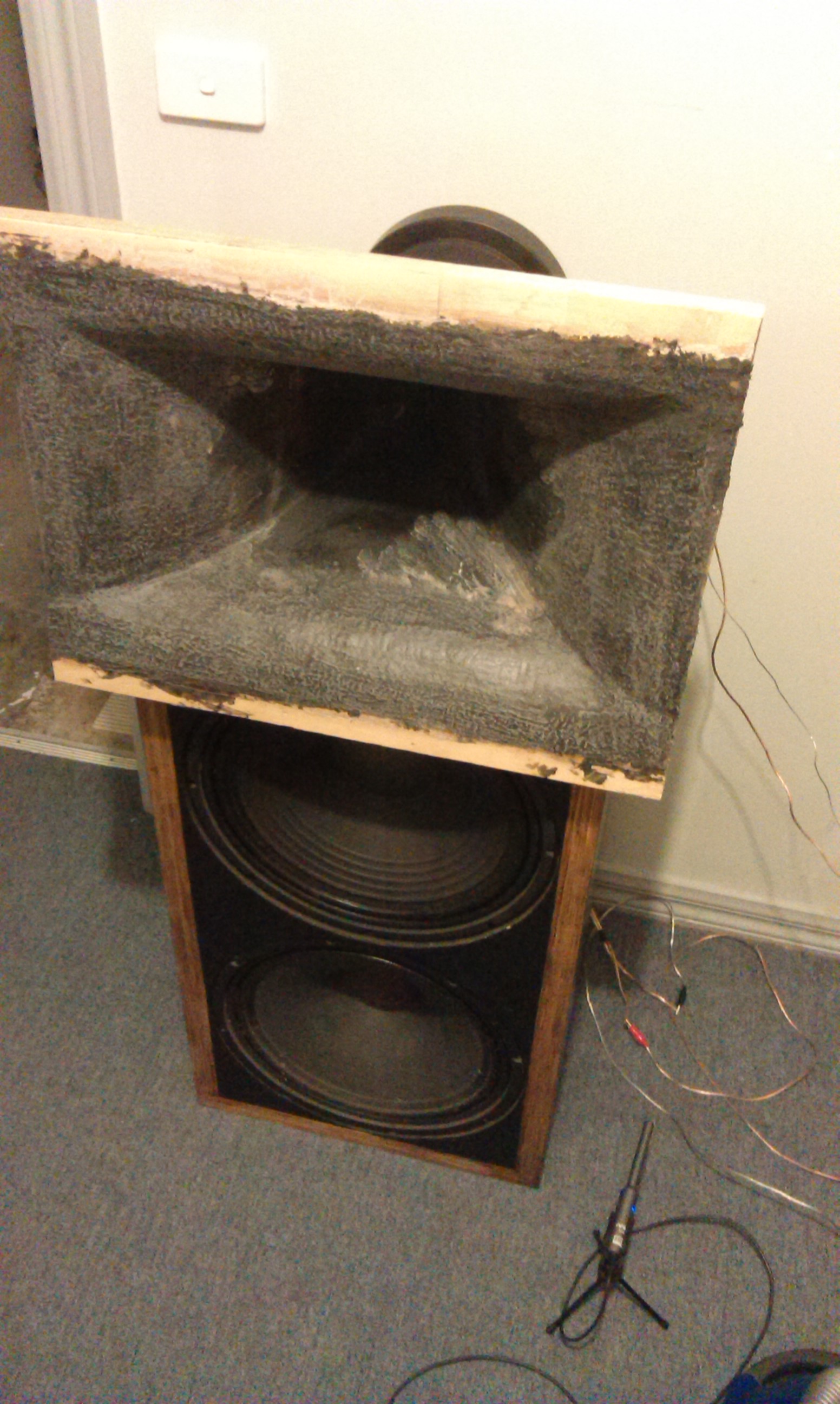

This is my ABS horn, stock & extended (bigger, but not big enough):
http://www.diyaudio.com/forums/atta...mounting-midrange-horn-kicker-boots-small.jpg
http://www.diyaudio.com/forums/atta...r-coaxial-mounting-midrange-horn-imag1373.jpg

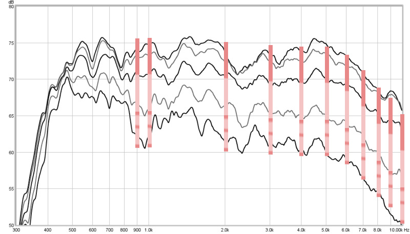

I think I understand your reasoning, but I suspect it is more complicated than that.

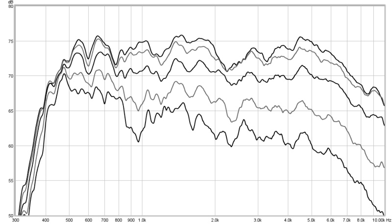

Here are polar plots I did with an old 2" driver on a new horn.
http://www.diyaudio.com/forums/atta...ange-compression-drivers-budget-jbl-polar.jpg
These aren't pretty - they were rough ground plane measurements. I took these measurements simply to get pattern control info, hence no eq or gating or other care was taken to get the baseline flat.
As you can see, the HF lines are parallel - so equalisation to flatten the on-axis response would also flatten the off-axis response. That is:
on axis, 10kHz was ~9dB down relative to 5kHz.
off axis, 10kHz was ~9dB down relative to 5kHz.
I think the HF spikes (>10kHz) of a titanium diaphragm 2" driver are more of a problem than beaming is.

All kinds of things make the measurements a mess, but I don't think that the mess mattered for my purposes - all I needed was for it to show me where the horn had good control (where the lines are ~parallel) and where it didn't.
It appears that, from 900Hz and up, if I were to get the on-axis response flat, the off axis also be within a few dB of flat.
Though I don't think it would be likely to change if the speaker is getting directed (not the mic), and away from the ground, for the off-axis curves. It would be interesting to compare the result with some gating applied, and/or in free-field.
The speaker and mic were on the carpet throughout. I shifted the mic in an arc in (if I recall correctly) 10 degree increments, from 0 to 40 degrees.
I still have the parts, so I might give this another crack (sometime after Christmas?) I'm still learning the various measurement tricks - I didn't know how to apply gating when I collected that info.
Next time, I'll also rotate the speaker, and not move the mic - I've realised that by moving the mic, I would have been capturing a different set of room reflections in each plot.
