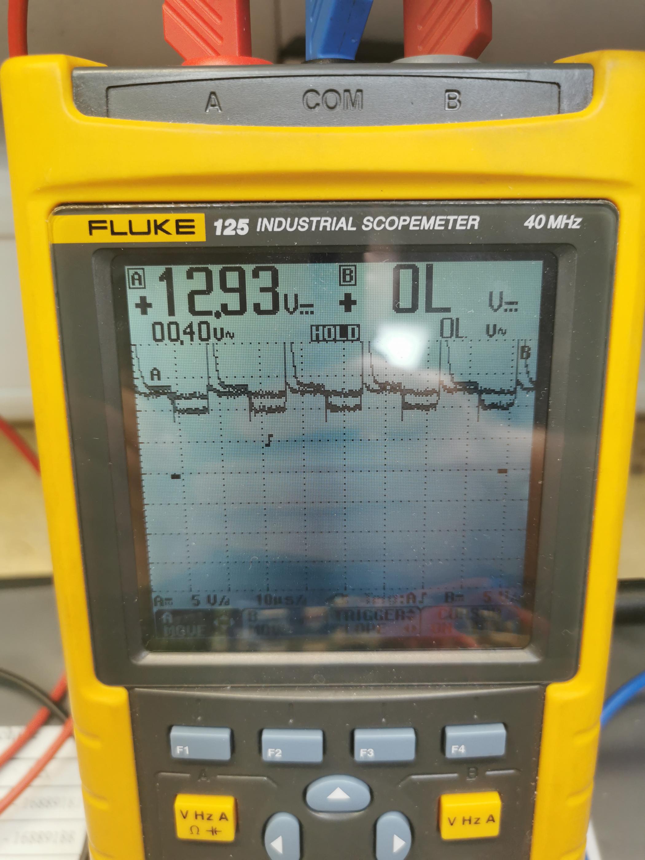

If the voltage is below the rated voltage and the correct polarity, it may be excessive ripple.
While powering up (looking across the cap with the scope), is the voltage across the cap pure DC or does it have a lot of ripple?

Is that with a resistor in the circuit (not bypassed)?

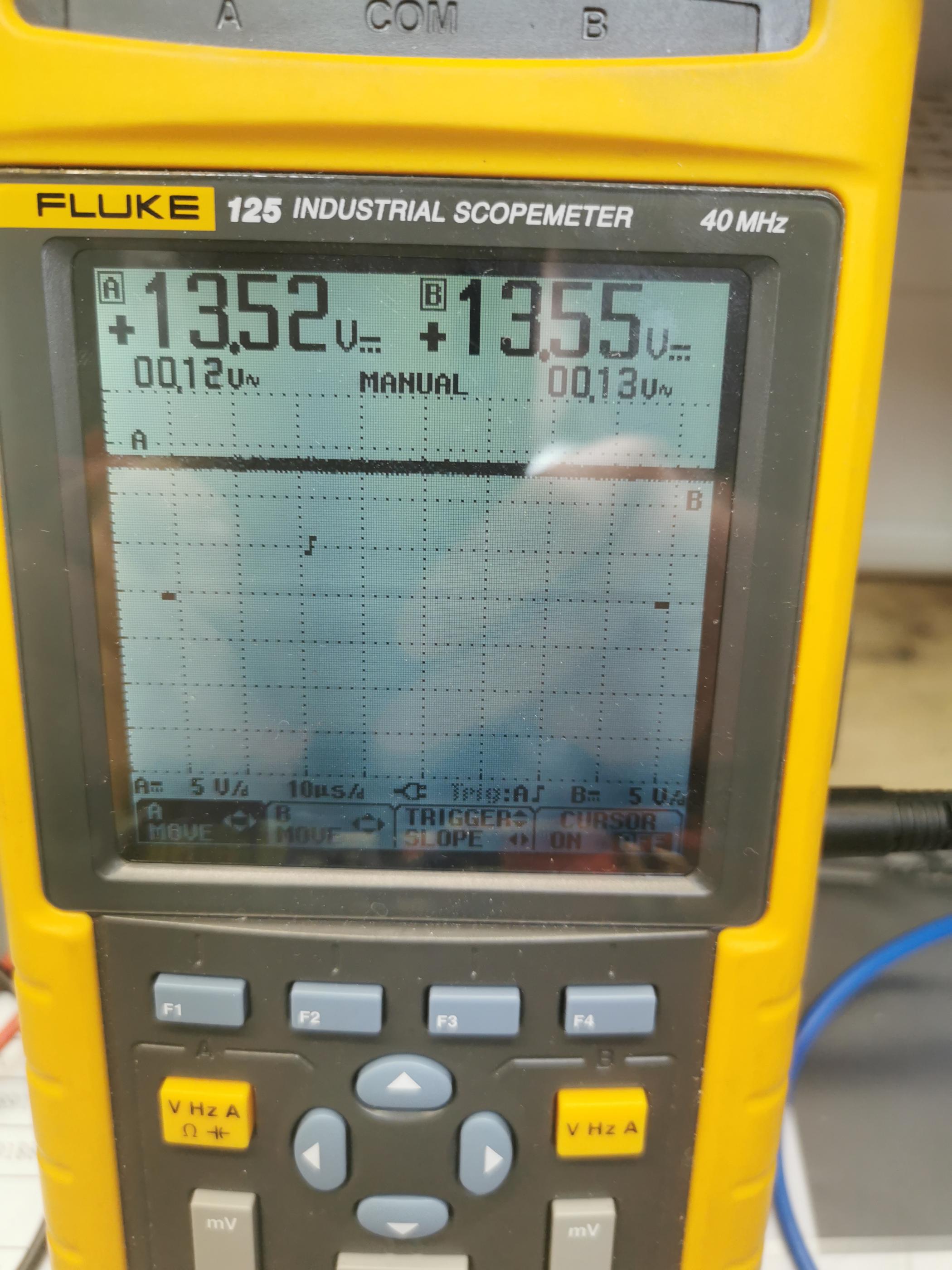

Check this across the B+ and ground terminals to see how much ripple there is there.
It's the same at b+. No resistor in circuit. .
Maybe I should install new capacitors in the b+ B- line..

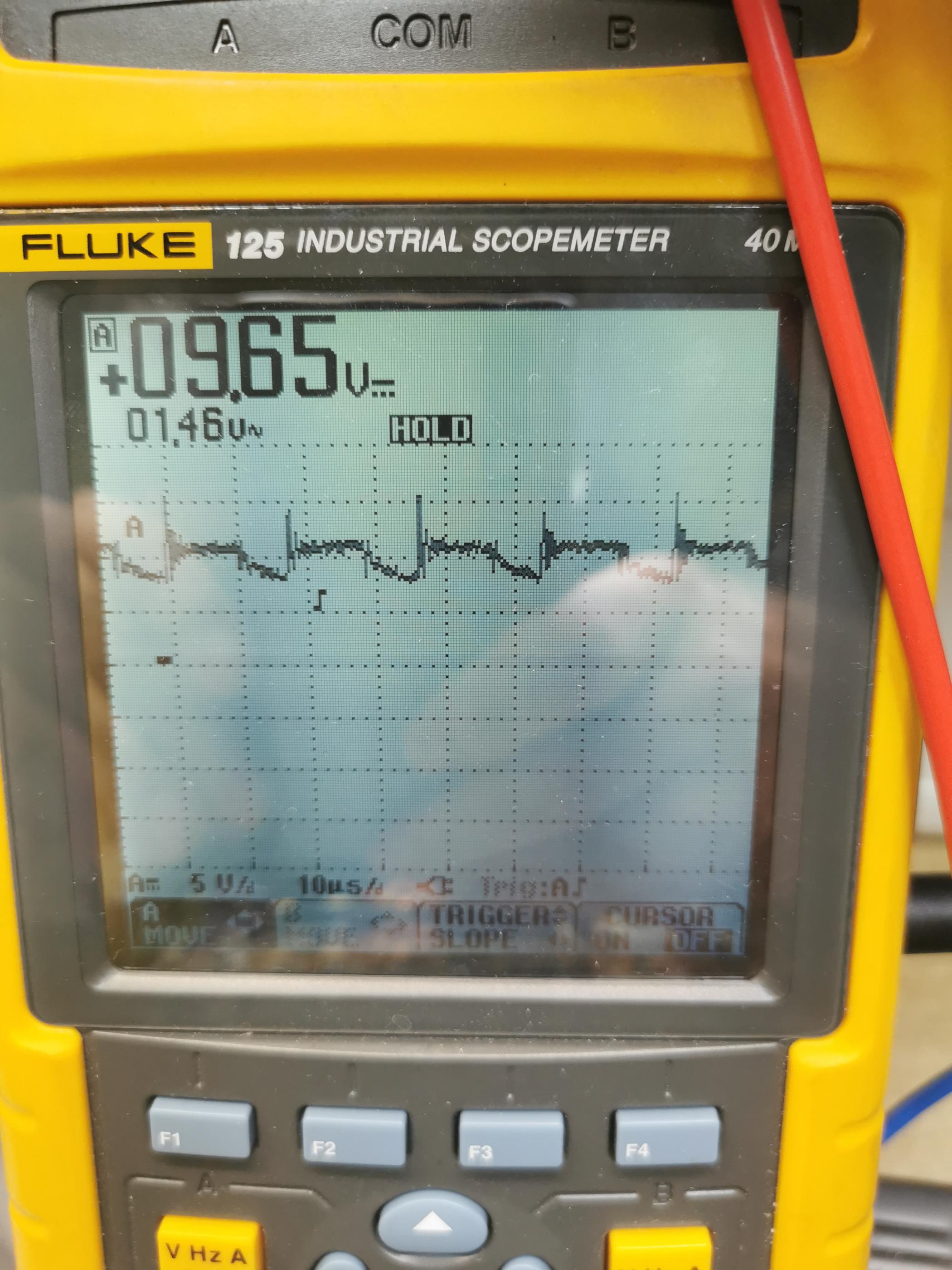

I'd reinstall a 4.7 ohm resistor and then compare the ripple on C2 vs the ripple on the B+ and ground.
If you have a large capacitor of about 6800uF, solder it across one of the primary filter caps to see if that makes a difference.
Perry, you are the best... With this cap inside, the amp starts without any problems.. Now I can check for the other audio bank..

For those who may not understand, the primary filter caps are defective allowing too much ripple to be present (the caps weren't doing their job, smoothing the B+ supply voltage).
