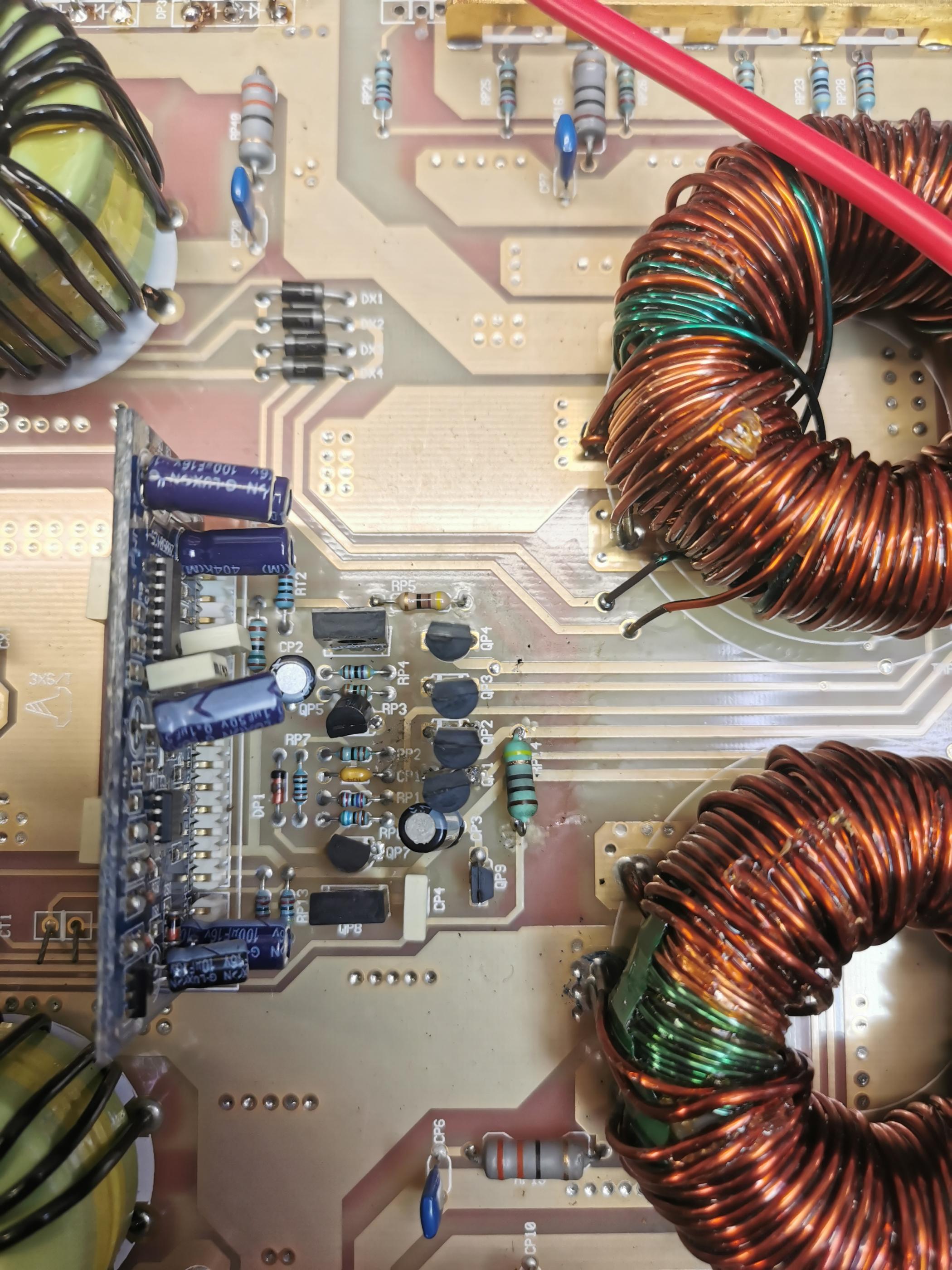

What'e the resistance between gate and source for the output FETs with and without the driver board?
I'm assuming that one driver board is still out of the main board.

The reason that the amp likely went into protection without the driver boards was because one or more FET had a charged gate. The only pulldown resistors are likely on the driver board (R29A and R30A).

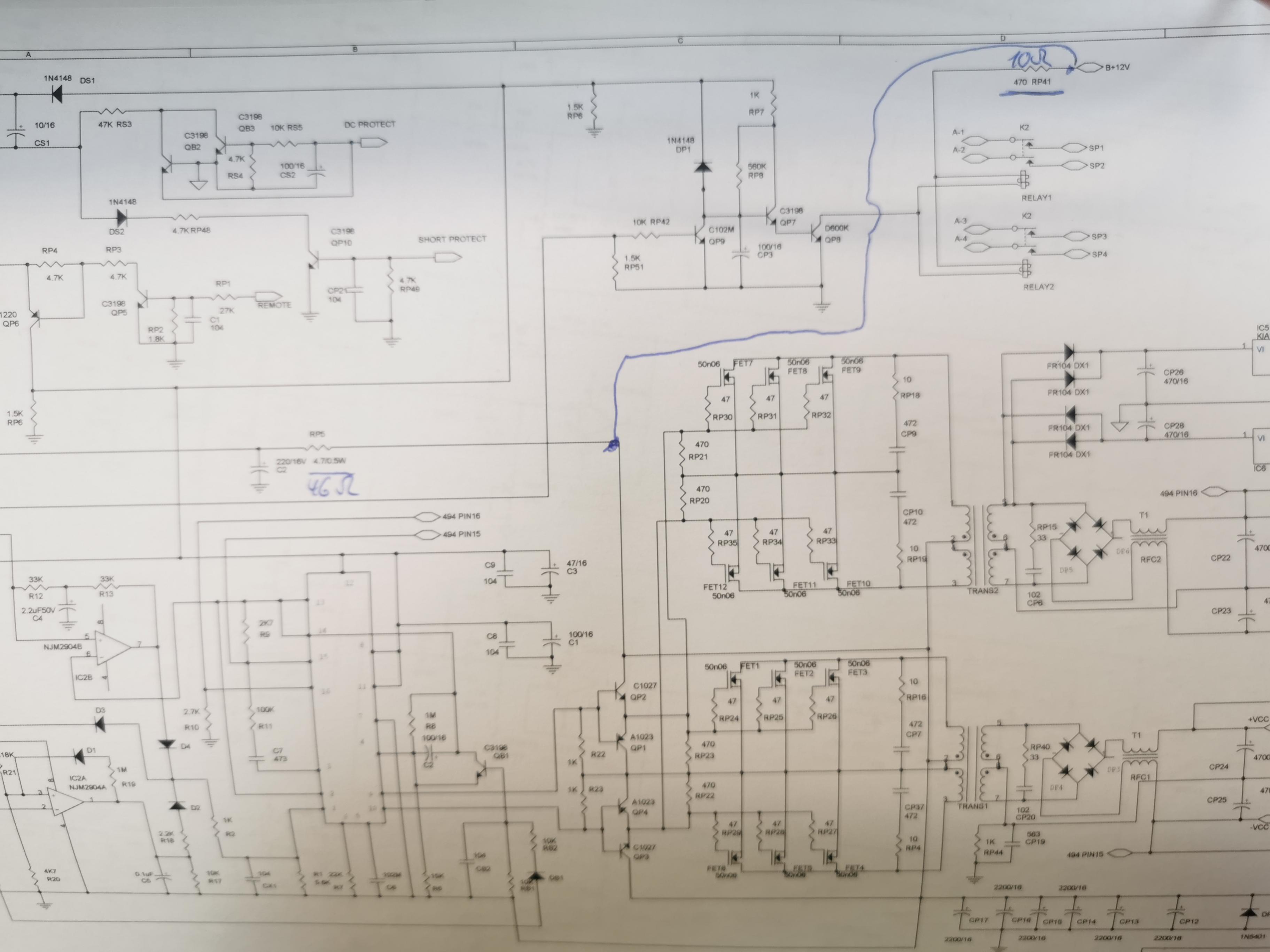

If you solder a bridge between the G and S of M1A and M2A on the driver board (with all components in the circuit), does the amp power up?

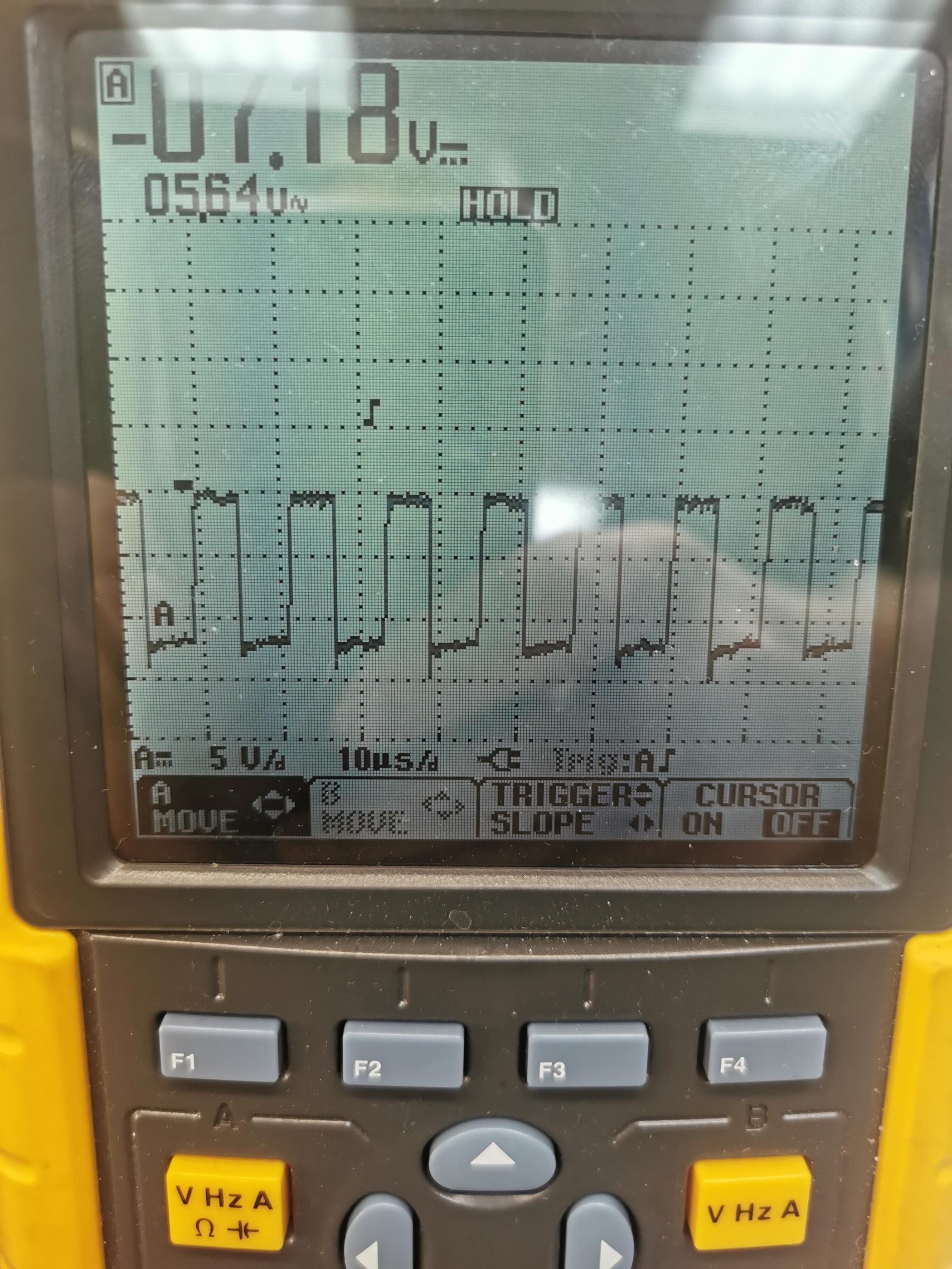

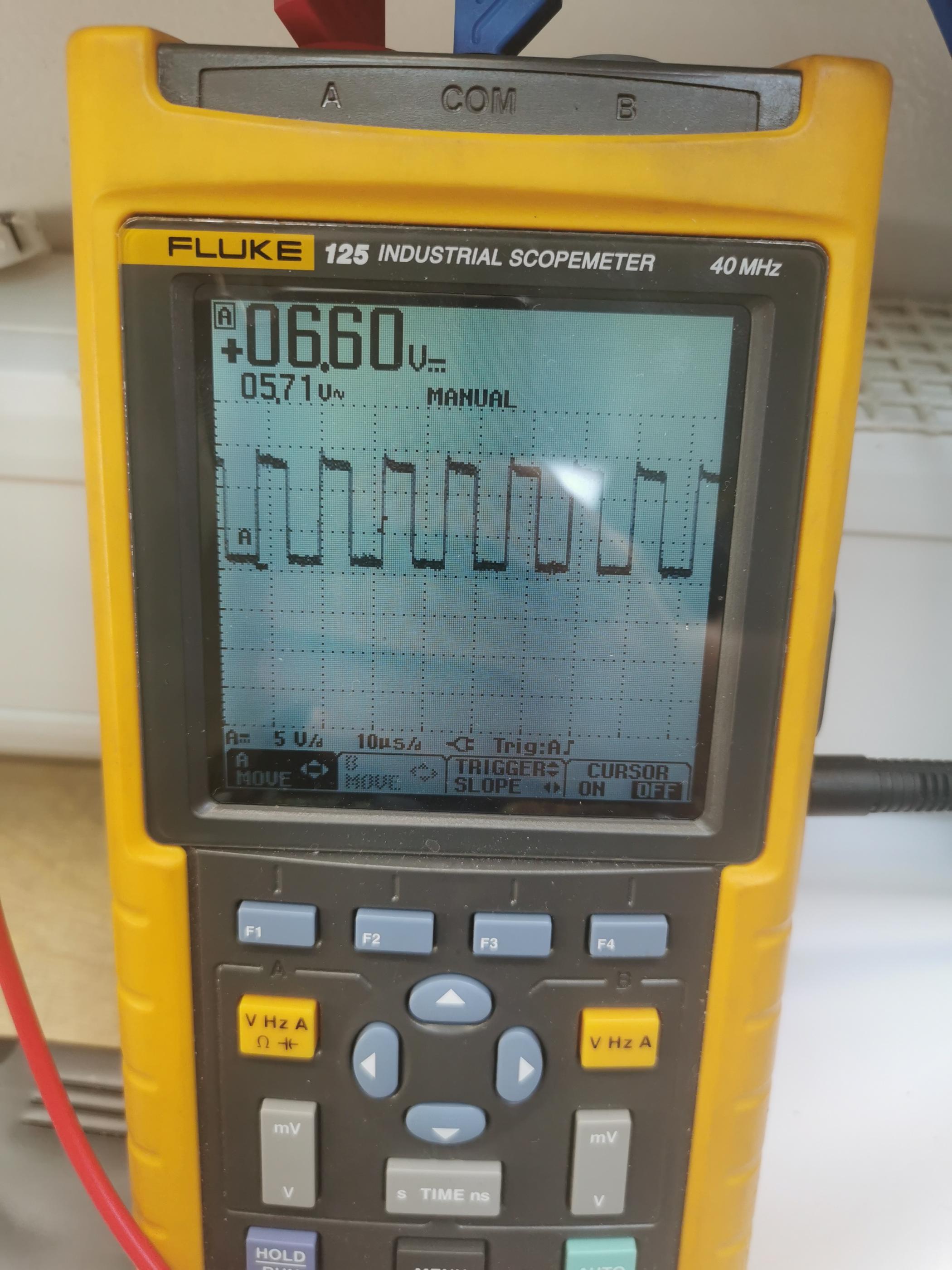

With the bridge inside, it power up. But I have no square wave at the gate of the audio output fets.
I don't think this is a problem but check the frequency of the PS drive. If it's too high, it can make the supply struggle.
Enable one board at a time by desoldering the bridges (hopefully the bridge is on the top side).

I think 47 ohms is too high to be in series with the driver IC. The 4.7 ohm is likely the right value.

I changed the resistor to 4.7 ohm. As soon as I connect remote, the resistor starts burning...
